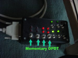

I used Atlas switch track. I have also used momentary DPDT switches. THIS is a MUST to used. A few years ago I posted how I made my digital controller. Why do I used the term "digital" controller? Because I used NAND IC (computer chips) to help show which track is switched. That's what the red LED's are for. The green LED's is to indicate power to the track. You can do a search here on The Gauge on how to build this. Is the Group wants me too. I can repost it myself.
