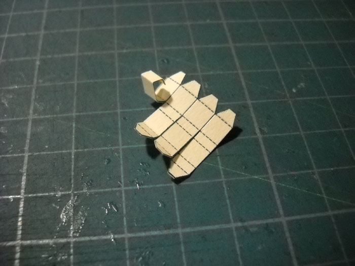

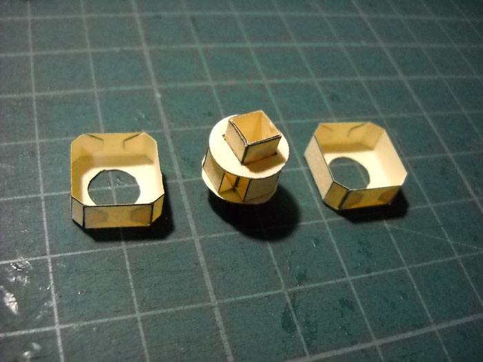

Hey! So I saw this a little while ago on Paperkraft:
http://paperkraft.blogspot.ca/2010/10/papercraft-action-figure.html?m=1
Does anyone have ANY idea how this thing is out together or designed? I've been trying to figure it our for awhile because I have a few 3d models if like to convert into articulated papercrafts, but I'm not sure how this is done! If anyone knows of a downloadable model that's similar that would be great too, as I couldn't find one.
Thanks :)

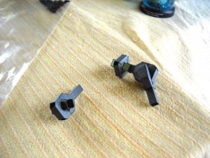

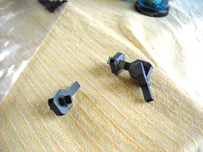

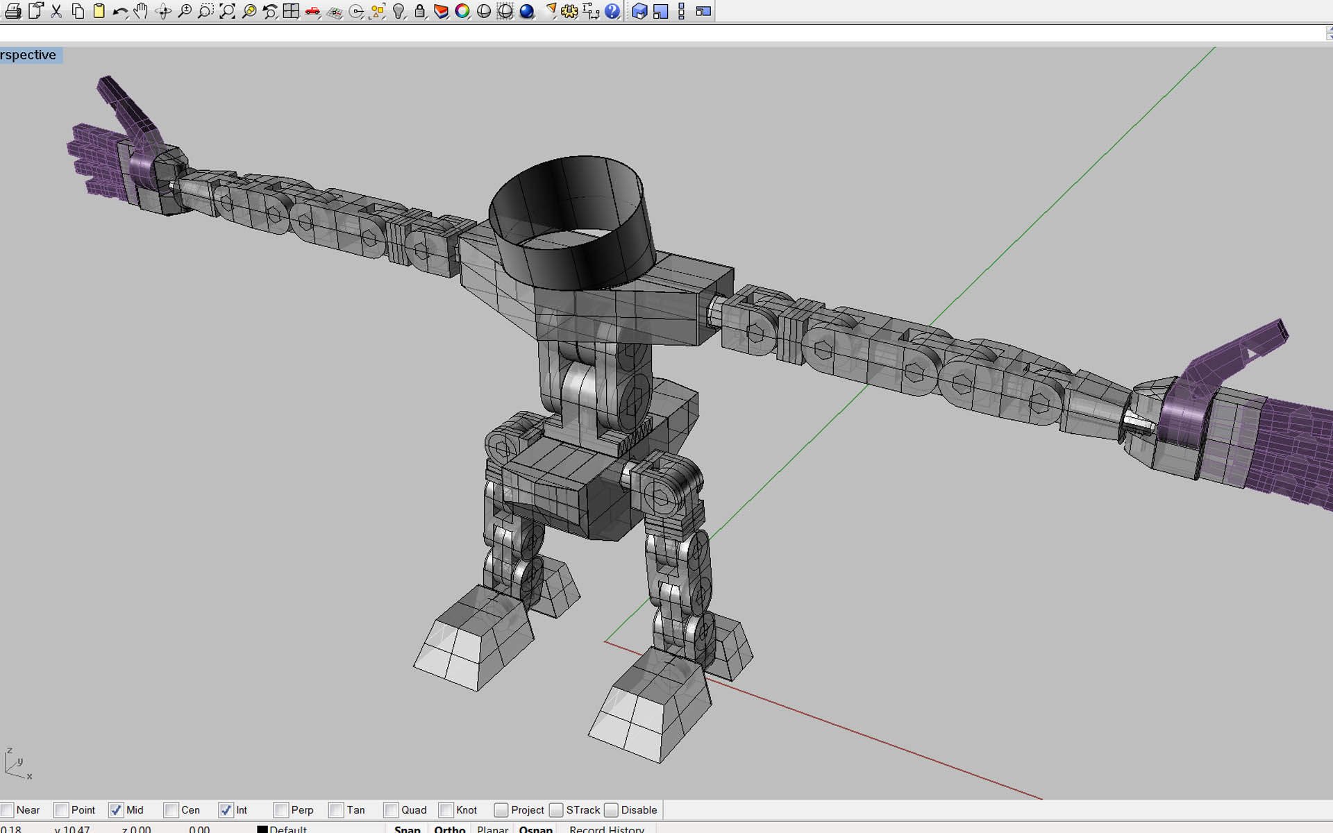

I did something like Dotubo. I seen that model long time ago from don’t remember where. But I think his is better. ….. think I gonna have to steal his design… shhh...
Reactions: Rhaven Blaack

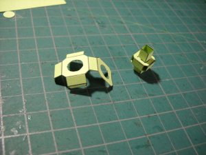

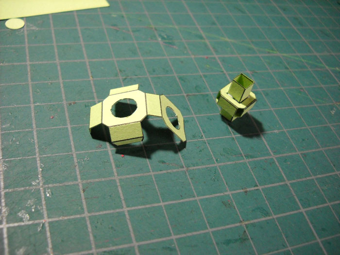

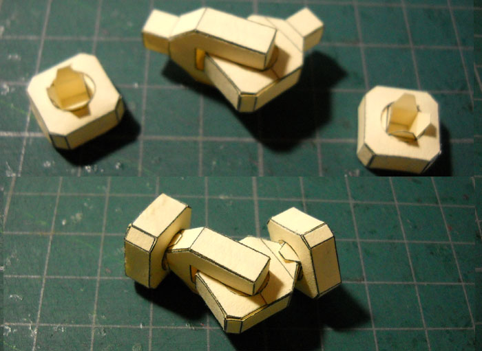

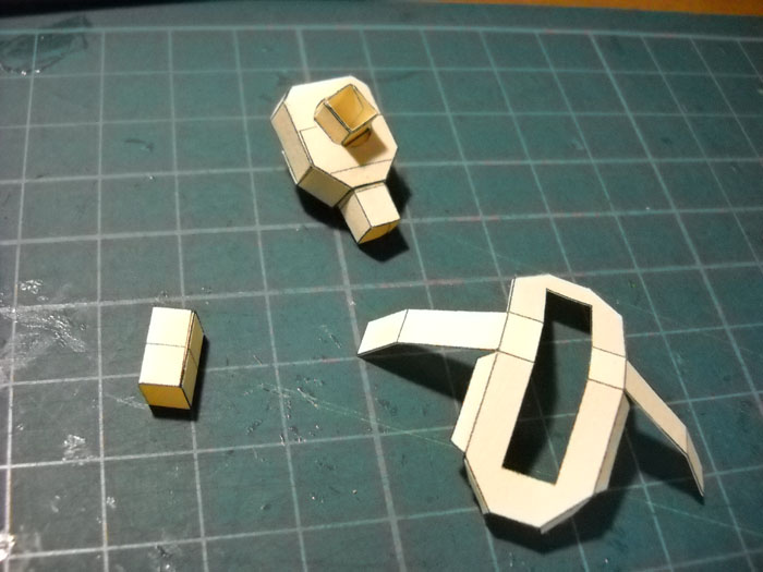

Found this and thought it might help...as I thought the original was a form of dowel in a box...dscn2277.jpg when the outer box is glued then the post is allowed to rotate..
add that to a swivel type joint and movement is almost unlimited...
jointphoto1012_2.jpg as far as changing the hands and feet etc.. I agree with Zathros...Magnets...the ones out of electric tooth-brushes are super strong!!

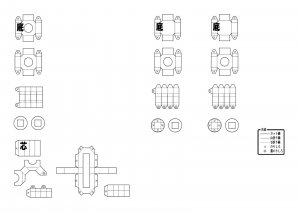

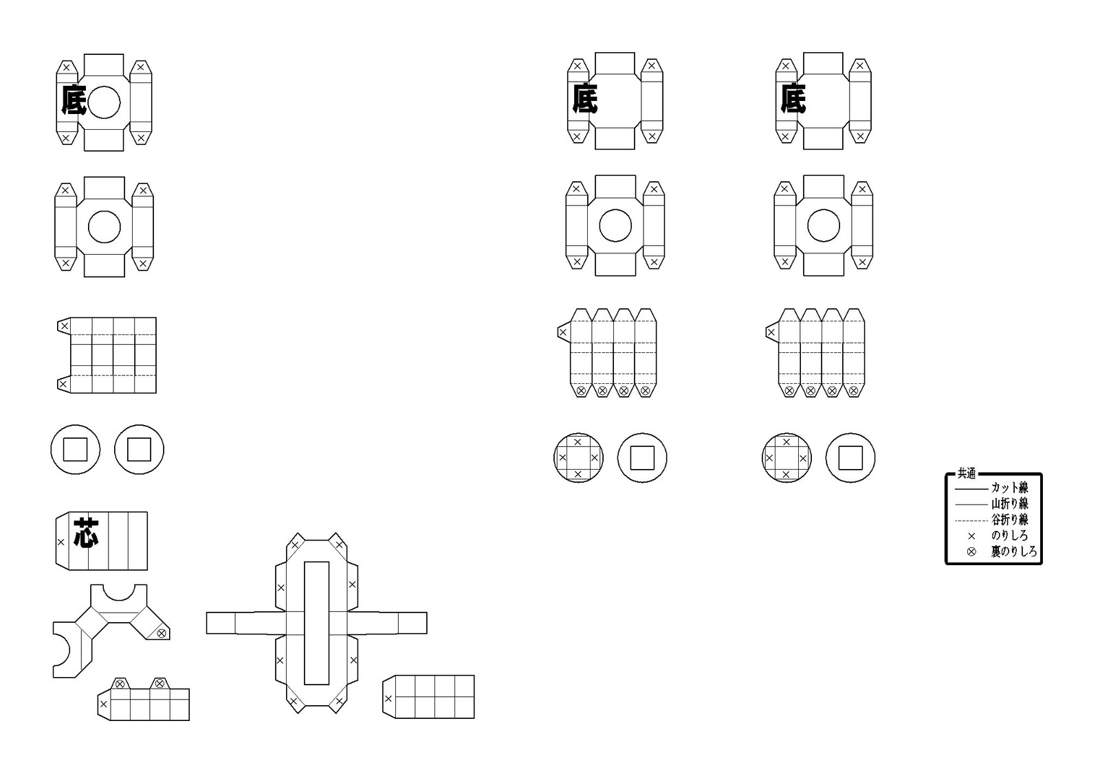

Here is a file to play around with...
10122.jpg Enjoy!...

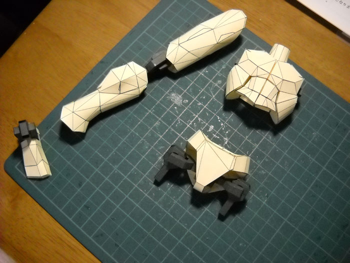

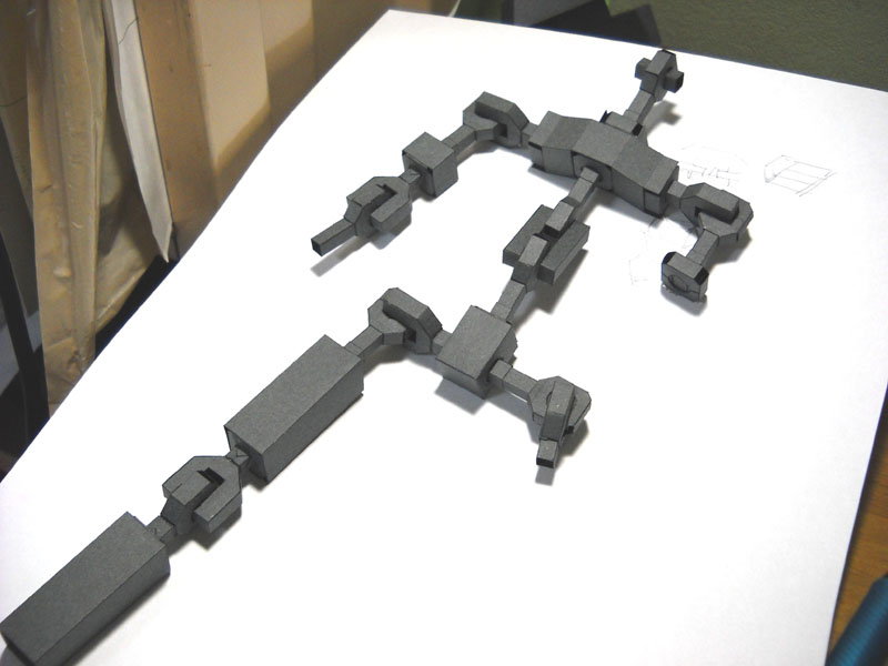

Hey, I remember this. I think I have this in my collections. Now I remember there is a large scale female action figure and I don't think that one use internal skeleton. I think I have it.... hope I have it :D
A great way to make automata like models.. Really cool! :)
3 of those attachments don't work. I wish you had bigger pictures of the first pic. It looks very interesting. :)
Sorry don't have large picture. And it looks like it will build up to a large doll. :D
