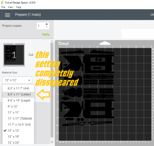

My brand new cricut exporer 2 only cuts squares. I swear I do everything it says, and it scans the borders and then cuts a square and shuts off.:hammerhead:What am I doing wrong?????

Well, thanks to Ron Caudillo going over everything step by step, we got it solved!
It seems that the hobby video is not what we paper modelers want to follow.
The mistake I made was at the screen ready to import the image into the graph paper scaling canvas lookin' step, I needed to use a magic wand tool to erase the background.
Also windows, portholes, openings, etc... so we made a test cut and that fixed the blank square it was cutting out , to the individual parts as it could read them.
The really cool thing is that now for something like the Jupiter 2 from lost in space, I can make a silhouette on screen and then slip in some metallic faced paper and it will cut out the parts without printing the ink texture on them.
So it will be a real clean cut and sharp paper outside appearance.
I also plan to make those led light boxes now in black paper for the windows on his enlarge 1701!
I wont have to cut out the printed inked paper windows, just back it up with the stencil black paper pieces and make a light box like I originally wanted.
REAL PLEASED WITH IT!!!

Found out a few things, if you want a really straight edge, the piece must be orientated up and down not across the page, so the straight edge you want is cut top to bottom, not one sideof the page to the other side.
You will have to redraw the piece's borders so there are no leaks when filled. Even ports and windows will have to be re-bordered for a clean cut. Otherwise, the fill will bleed out into the entire page and you will have a mostly blank sheet where your pieces were.
Bag your cuts by piece, so you don't lose any pieces. Cut out any part that you would need to be defined, as the fill will cover all your parts uniformly with a black colored fill. The same will go if you use a print with details, anything you want cut out or given depth, you will have to redefine the borders.

also I found out that the settings keep changing, so it might be wise to reset all the settings every time you cut a page.
