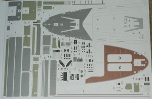

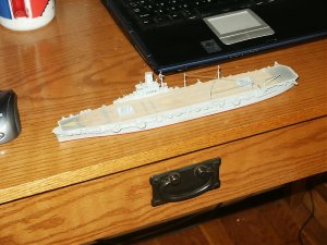

Does anyone here also have a copy of the superb looking Japanese carrier Junyo from Answer in 1/200 scale?
I am contemplating my next major project and am seriously thinking of building her. The kit looks daunting at best. If anyone else has built or starter it i was hoping they may have a few pointers I may need to know ahead of time.
I am not going to start it until sometime later this summer as I have to remodel our 42 year kitchen for a while.
I do have an old incorrectly painted 1/700 plastic model of her to assist me for her overall finished appearance.

Hi Joe.
The Junyo kit from Answer is generally very good.
Advantages: it fits very good, superdetailed, beautyful flydeck.
Defect: the hull plating has different shades, the boards/sides too.
