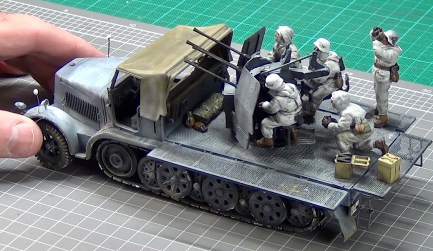

I am planning on using one of the @ARMORMAN ’s provided models to build a carrier for the WWII German 20mm anti-aircraft gun.
This is the model:
satir-truck-jpg.143532
And I hope to come up with something on this order by mounting the Tamiya gun kit and Tamiya gun crew kit on the back of the truck. Hopefully it will work. I like the drop sides on the bed, making a large work area for the crew.

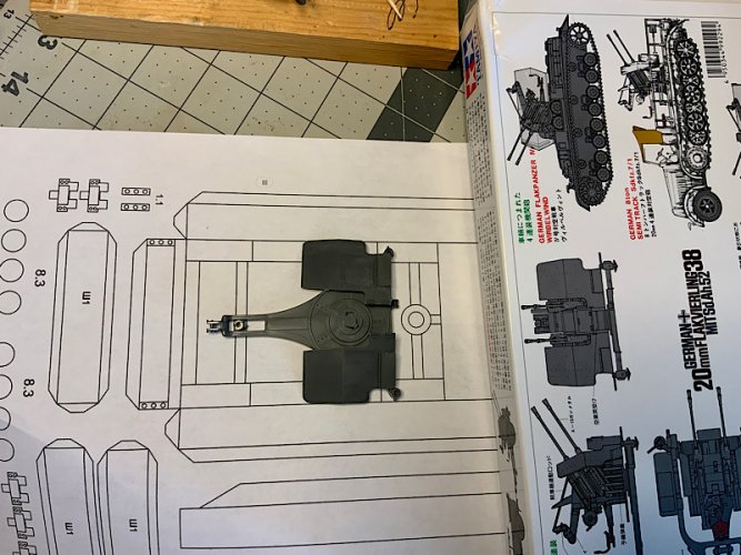

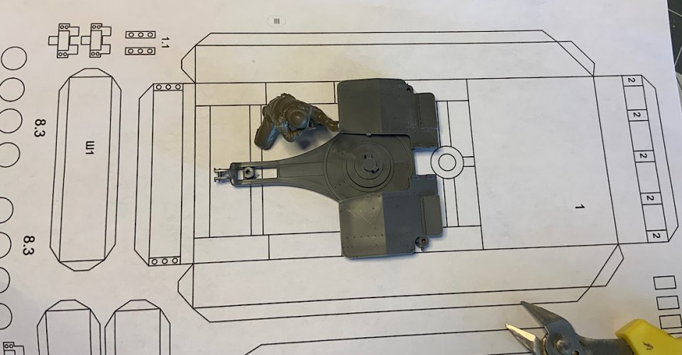

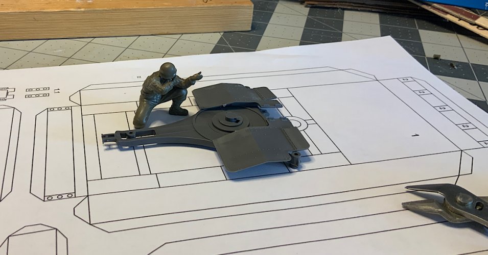

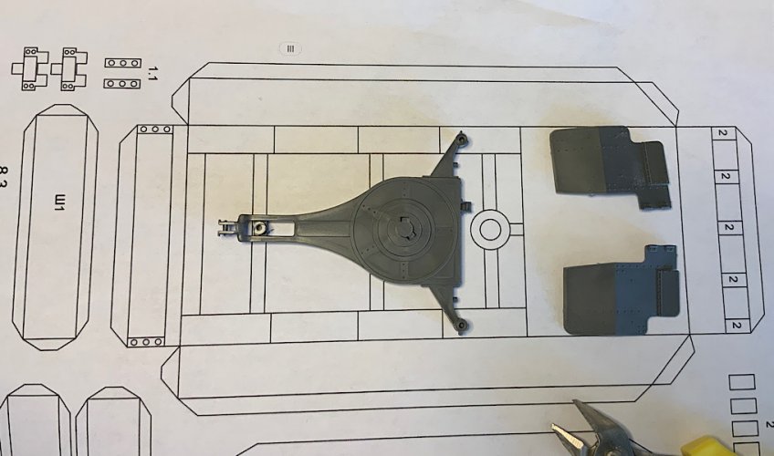

OK, here goes. After looking at that pic above again, and posing the base and shields from the gun kit on the test print of the Satir, I decided to go for it. I printed the frame page and compared it to the test print. I found that allowing the PDF file to print at “100%” size, it came out the same width and slightly longer than my test print, which I had used an app called “Print to size” to print. So…
After cutting out the frame and side pieces from the test page, I finally figured out how the frame goes together. This is a nice kit, it appears, but not having any 3d type views of the assembly makes it hard. For example, some parts of the frame bend UP and some DOWN, with no indication of that on the prints. I finally got it. I’m slow these days… (that frame as shown is displaying the UNDER SIDE of the frame) (the sides bend UP and the ends bend DOWN in that view)
Pics of the test page with posed parts and a kneeling US soldier model from a Tamiya kit. After looking at these pics, I decided to print the kit ‘as is’ and see how it goes. It should work, I think. (IF I can figure out how all the parts go together, LOL)

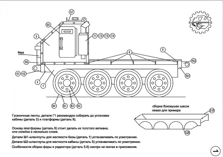

Satir Armored truck instructions in English with drawings
First page of instructions:
I recommend to assemble tracked belts, G1 parts before installing the cabin (part 5) and platform (part 9).
The basis of the platform (part 9) should be made of thick Whatman, or gluing in several layers.
Parts of the Sh1 frames for the rigidity of the base (part 1) should be installed at discretion.
Parts of the Sh2 frames for cabin stiffness (part 5) should be installed at discretion.
See the features of the headlight and radiator assembly (part 5.6) at the picts in the application.

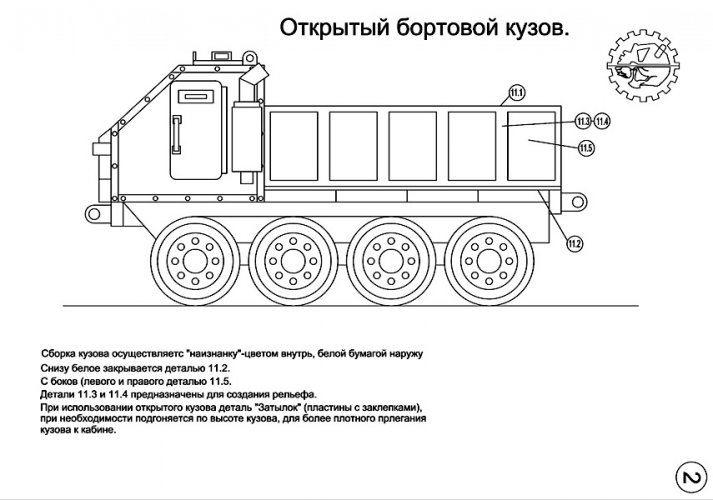

Second page of instructions: (Open side body.)
Body assembly is carried out with "inside out" - color inside, white paper outside
At the bottom, the white is closed with part 11.2.
On the sides (left and right part 11.5.
Parts 11.3 and 11.4 are designed to create relief.
When using an open body, the "Back of the head" part (plates with rivets), if necessary, is adjusted to the height of the body, for tighter fitting of the body to the cabin.

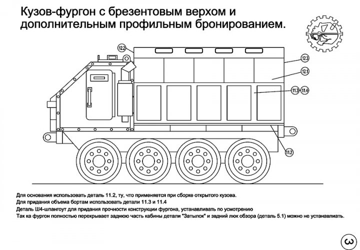

Third page of instructions: (Van body with tarpaulin top and additional profile armor.)
For the base, use part 11.2, the one used when assembling an open body.
Use parts 11.3 and 11.4 to volume the sides
Part Sh4 frame to give strength to the van structure, install at discretion
So as the van completely covers the back of the cabin of the "Back of the head" part and the star view hatch (part 5.1) can not be installed.

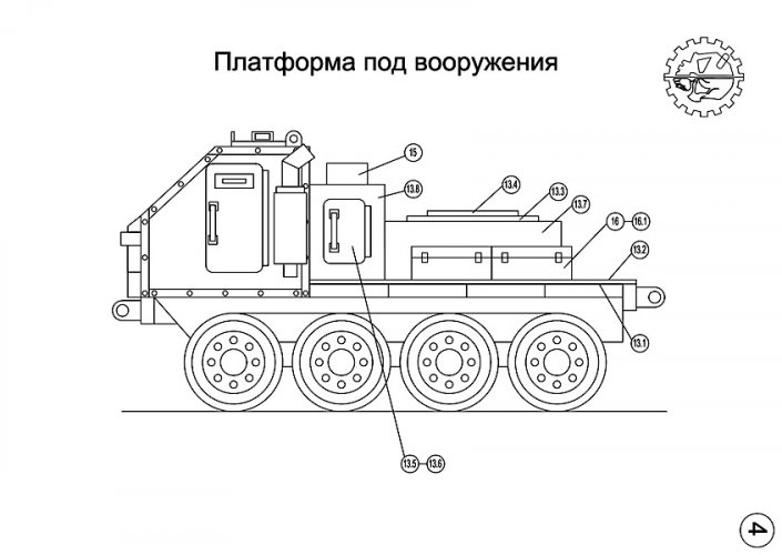

Fourth page of instructions: (Platform for weapons)
I will post pics later, but I am struggling with this thing. Essentially no instructions… I have to try to become the designer. Sigh… I’m having fun, but wearing out.
There are all sorts of parts scattered on the pages, and I have no idea what they are or where they go. I guess I will cut them out and start trying to fit them. Right now, I discovered that the front and rear bumpers are a lot wider than the body, but there are open spaces near the ends. I think some of those unnamed parts might cover the holes.

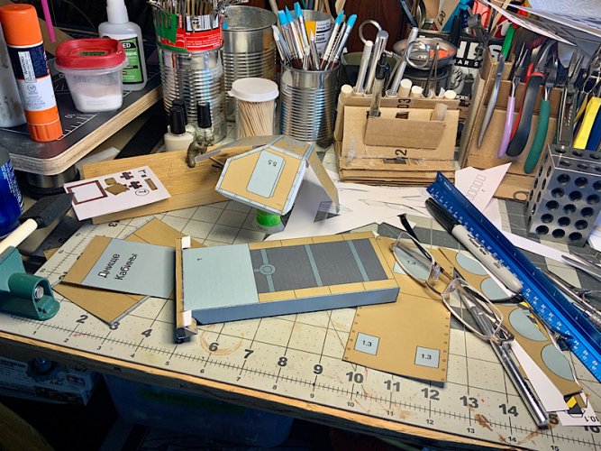

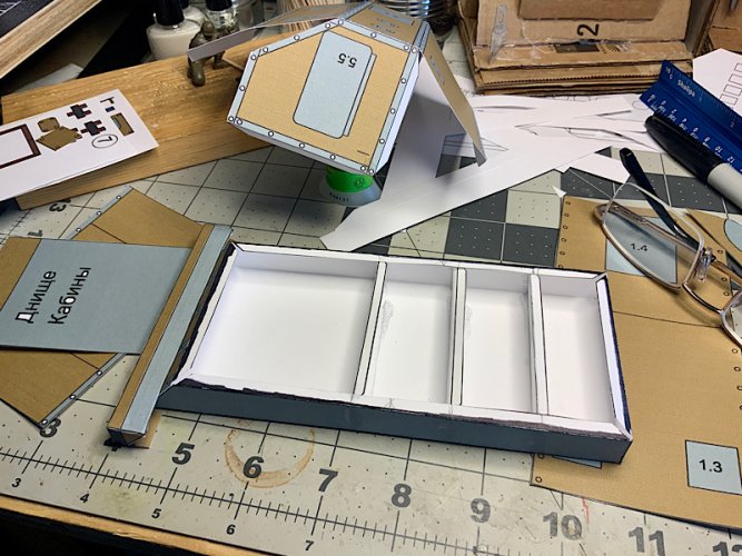

I now have the basic frame and front bumper assembled. The cab is as wide as the front bumper. That hangs out over the tracks, so I will be using the wide bed option, to carry that width front to back. From what the instructions say, the next thing I should do is fabricate the tracks, install the wheels and then the bed. I will probably install the belly pan to stiffen things before putting the wheels on.
I’m using CA glue for assembly, it works so good for stiffening parts too.

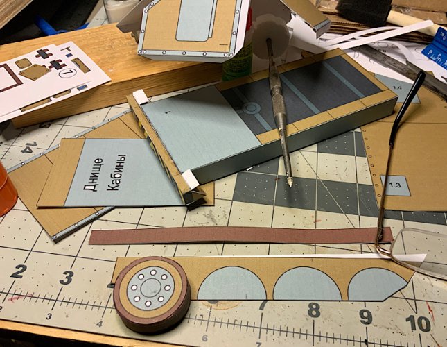

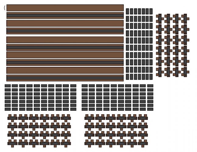

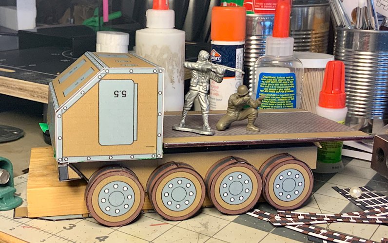

I decided to make the wheels into ‘real’ wheels. I cut styrofoam circles on my hot wire cutter and glued a tire and the sides of the wheels to one. Then I cut out the track parts and discovered that there is only half enough to make a complete belt of track. So, I have created another page of track parts and will print that tomorrow. If it works, I will add it to the PDF file, with all the instructions for the kit. I will have to figure out how the track parts go together.
This is what the page looks like. It should give me enough parts plus extras, I hope. This is a reduced size image for the forum. If this thing gets completed, I will make a new PDF with the notes and extras available here.
Well, again I got confused. It appears that there ARE enough track parts in the original PDF to make the tracks. For some reason I thought there was only half… whatever.
The tracks are going to take forever. Sigh…

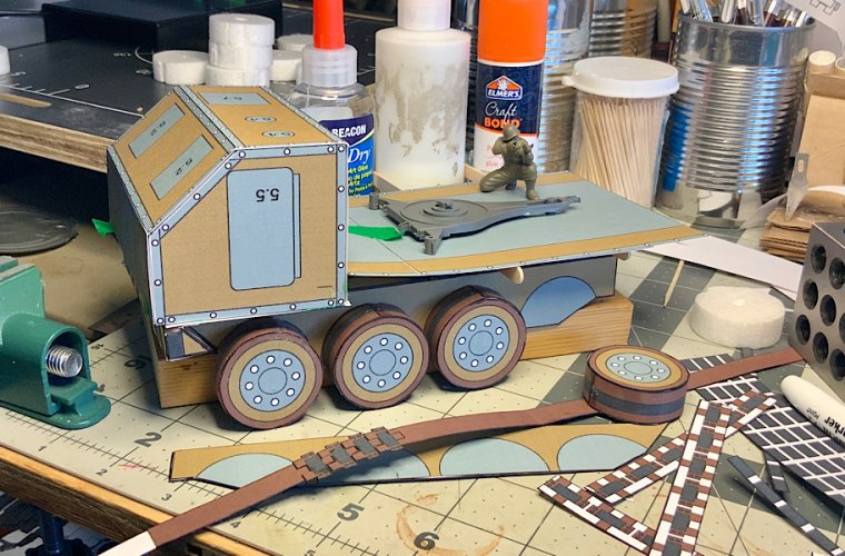

But, I have made good progress. I made and installed two more cross members in the frame and attached the belly pan. One wheel frame with 3 wheels is installed and the track building has started. I decided that instead of the suggested method of installing the track before the bed and cab it would be easier to do it differently, for me anyway. I will build the track loop and form it to fit the 3 wheels and use the 4th wheel to tension the loop, just like on a real track. It can be glued in once the tension is set.

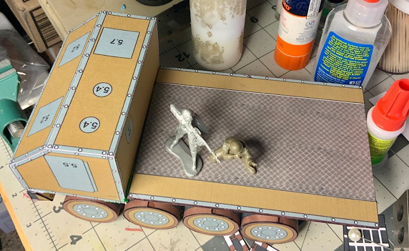

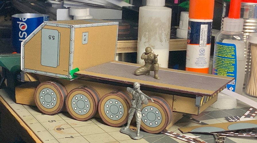

I’ve also temporarily taped the cab together so I can see what this looks like. I will probably also stretch the bed to give the gun crew plenty of space to work. The truck should be perfect, the cab is large enough that the entire gun crew can ride inside.
The pic shows the bed (just the card stock sitting on some temporary cross members, no chipboard in it yet) stretched and the gun base sitting on it.

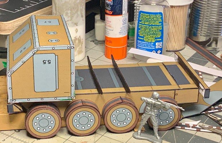

A little more progress. The bed is fabricated and ready to install. I got a couple more wheels done too.
Current status:
The cab is just posed as is the bed. I need to finish the cab and install it, and a couple more support beams for the bed before attaching it to the truck.
This truck could easily be built as an 8 wheel drive truck too, no tracks.

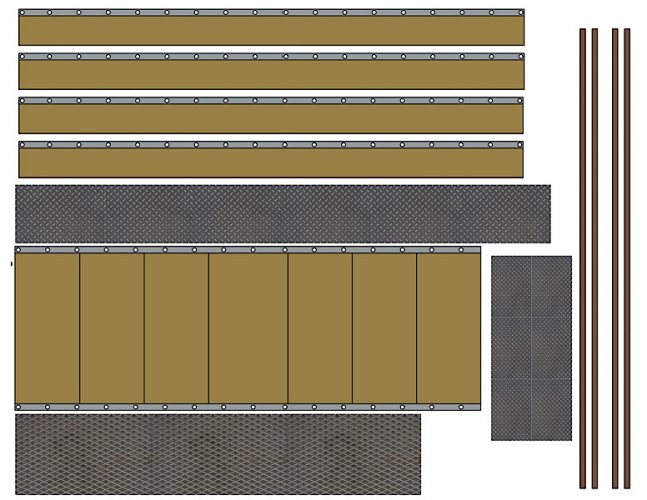

I use the modeling as an escape and have been thinking about the little truck. So, it was quiet this evening and I decided to extend the frame to support the extended bed. This looks much better. I used a printing app I have (print to size it is called) to take bits and pieces of the kit and place them on one page. That saves a lot of ink, by printing only the extra parts that are required.
I think this looks good. Oh, I will also be adding ‘mud deflectors’ in front of the track and behind it. For some reason the front bumper was designed as a mud trap… LOL
Thanks! ;) There is a nice gift shop in the hospital next to the one where he is now and my wife called them and arranged to have some things delivered to him. There are still good people in this world. The lady in the gift shop said they normally don’t deliver to the other hospital, but she personally would take the things to him.
Here is an example of what my image printing software can do. I load the images of the pages into the frame, size them properly then crop and cut what I want. This is an assembly of ‘stuff’ from the kit and the textures site. These will become the mud guard/fender things and just be spare parts.
