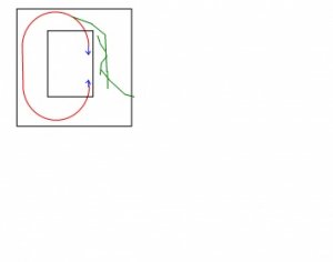

Here is a really basic schematic that is not to scale at all, but it shows how the lower deck track plan will be shaped. (for the NEC, you'd get an oval and maybe a spur, so its not needed).
Red is the mainline. Blue goes to staging, green is the branch to my old layout (this branch can be made smaller, or even just turned into a wye and have that be the end of it).

I'm thinking steel studs can be used for benchwork to make this all easier, faster, and cheaper. I think i just need to form a solid plan. I've been throwing ideas around in my head, but i have yet to start sketching something out.
Right now, i need to figure out how to fit an oil refinery and it's yard in an area that is two feet wide without making the scene to cramped. I'm thinking i might be able to "cut and paste" parts of my previous All-Conrail track plan. the double track mainline with 36" Curves will work fine.
The only other major industry i wanted was an automobile transfer facility. Its possible, but i think it would either end up deepening the scene (which is bad for the benchwork) or expanding to far away from the benchwork, isolating the upper deck. I'll probably start sketching and scanning plans by tommorow.
