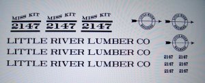

Hi Tyler,
Yes, I would agree with CNJ999 that you would do well with custom decals and they do not cost that much.
Stan Cedarleaf at http://gold.mylargescale.com/StanCedarleaf/WebPageDecals/CustomDecalsx.html is an excellent guy to work with. He asks for any pictures of artwork or prototypes you want to send and he can get as precise as you want in the size and shape of the decals.
I reposted the proof sheet he did for my Large Scale Shay. I hope to use him further for some of the 1:20.3 flat cars I am planning.
Good luck!!!
Doc Tom:wave:
