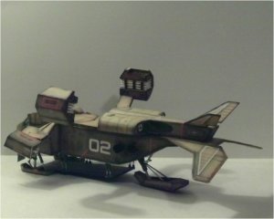

The next batch of skids update.

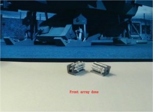

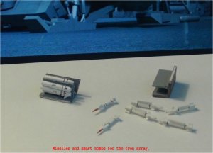

Here are a few more photos of the the weapons missile array. I have a bunch of more photos to upload but I have to prep them See you all next posting.
The front weapons array bombs and missiles are made from a paper stick
On the missiles, I cut small triangles and placed them to the from and back of the missiles.
On the fatter missiles, I wrapped a strip of paper to the desired thickness and then I used my dremel to round the front of the missile.
The stripes are hand-drawn with a drafting pen and the rear exhaust are penned in. So much for now and see you all soon with the last installments of the dropship. The APC is waiting, as well as a landing pad/platform.

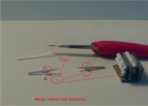

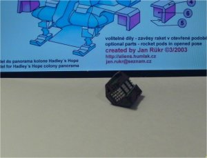

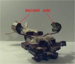

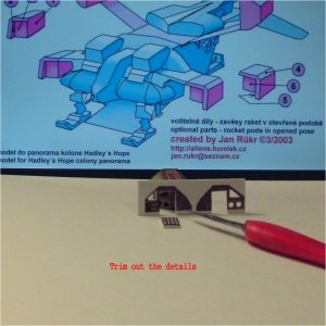

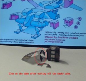

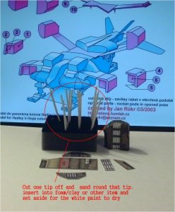

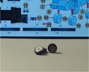

So on with some more details on the rocket pods.
The rockets are made from a section of a tooth pick and the bigger rockets are from paper stick from an ear swab (Q-Tip)
The lettering and lines on the missiles, are made with a drafting pen
The rockets are separated by a laminated wall and painted slate gray.
The pads are attached to the short wing by pins into holes drilled into the wings and pods.
The pods are attached in the deployed position but you can place them in the closed version as well.

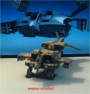

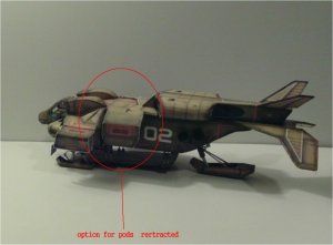

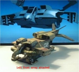

More updates on the Cheyenne and its weapons array. This is the closed pod version and you can build it straight from the plans. Do not glue it in place so you can remove it and put the deployed version in place.

Aliens Cheyenne Dropship

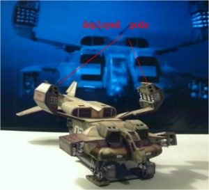

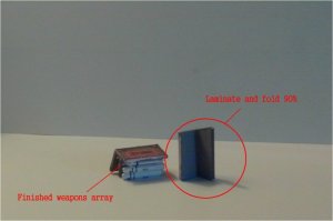

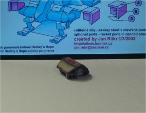

More on those weapons system and the deployed array.
For the deployed array, I Reworked it and cut and sliced the skin and built the pod up. Here is a finished pod next to the one to be made next. The last picture is of the main parts cut and sliced and a stack of tooth picks for the missiles.

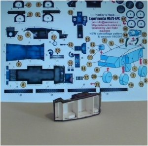

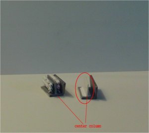

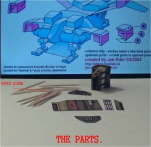

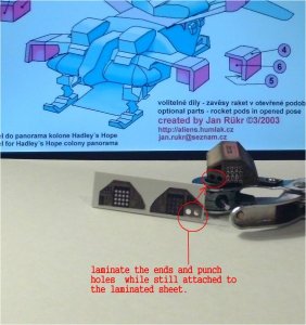

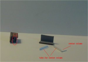

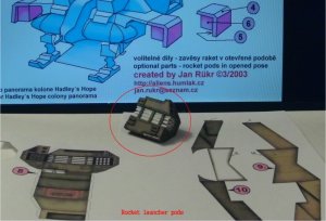

Now for the details on building the pods. Painted the tooth picks and set aside to dry. In the meantime, The ends of the pods are laminated and when dry/set, carved out the missile center section and punched, cut and drilled the openings. NOTE: cut, punch and drill the openings while it is still attached to the lamination sheets. The parts are too fragile to cut once the section is cut away from the lamination sheet. Glue around the end sections. The lamination allows for the removal of those nasty tabs and make a better seal. Once the part is boxed in, start to make internal bracing.

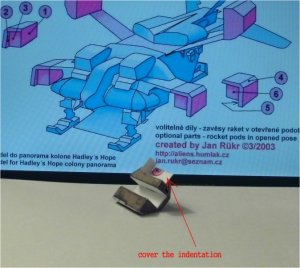

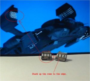

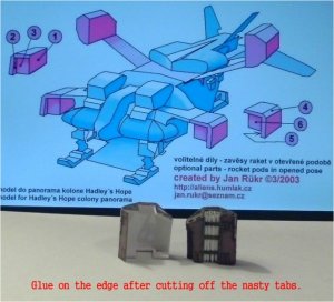

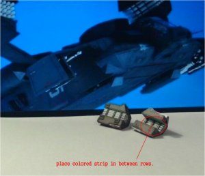

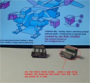

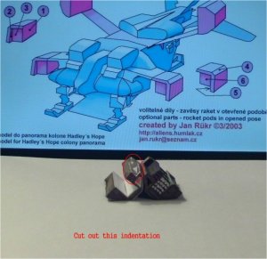

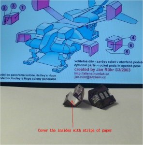

Still more info on those wing mounted weapons pod. Covered in the inside walls of the launcher pods. I colored the walls an apple green color but slate gray is also adequate.
There is an indentation on the bottom of the pod that is trimmed out and replaced with another covering and then painted a dark olive green.
The missiles are cut to the appropriate length and then placed one stack at a time into the well. There is a spacer placed in between the missiles the same width as the toothpick. Once the first stack is set. Place vertical separators and then repeat for another row of missiles. The sequence is simple, yet effective. See you all next posting.

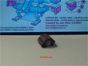

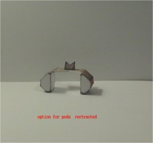

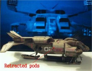

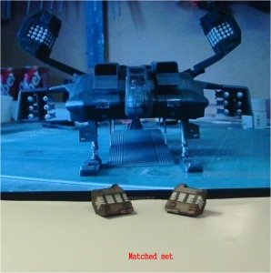

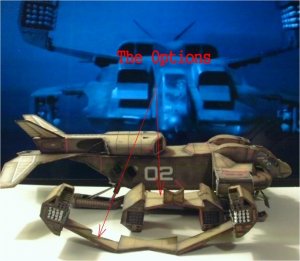

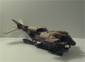

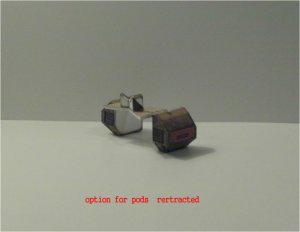

Almost done with the Dropship. The enhance pods are finished and the comparisons of the straight from the plans and the enhanced ones together. The pods will be interchangeable, so do not glue them if you want this option. Here you have the retracted version. The next posting will be on the deployed option.

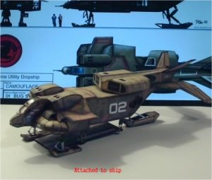

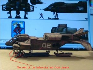

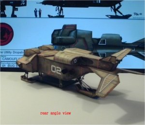

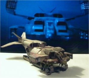

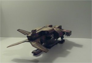

This stage of the dropship is done. Here are the final photos of the drop ship. There are a few more touch ups but that will be taken care off during the next phase of the APC.

This looks fantastic mate, props to Jan too for the original, but I love the extra detailing you have put into this, especially the cockpit.
This model is a great build. I just hope that this thread will help others build it as well. Jan's model is a great design, it is just me, that likes to build a bit of extra stuff into my builds.
beaatiful m8 o_O
Thanks for the comment Teg35. I am glad that you have enjoyed the build.

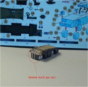

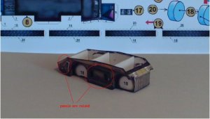

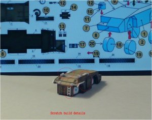

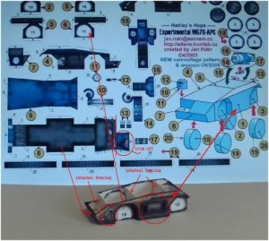

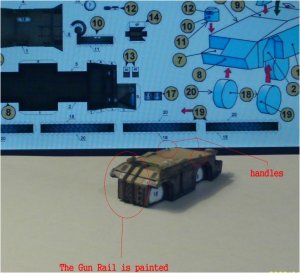

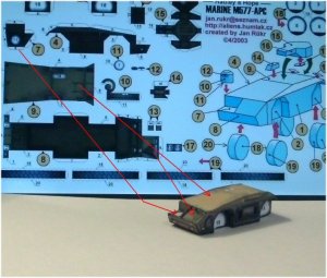

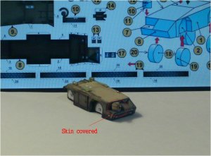

The next phase is the 1/72 scale APC. It barely fits into the cargo bay. It is almost finished and I added a few more details to the build. Here are a few photos of the APC.
The inside of the APC is strengthened with a series of internal bracing. I made a slight mistake in not folding the top of the side walls in, so as to make contact with the top cover. I made a slight angle cut to the bracing so as to allow for the bend.
There are a few small details added to the top side and by the door side. The doors themselves are also cut out of the plans and then laminated to card stock and then placed back into their respective positions. The doors now have a raised relief feature.

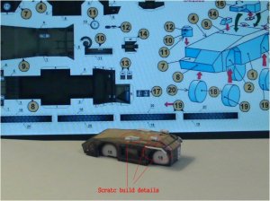

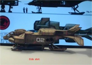

Continuing with the ALIENS project. The APC is finished, I just have to update the photos for uploading.

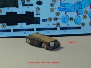

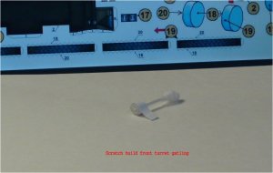

Here are a few photos update. A few more updates. Made some scratch build details for the aft section. The front turret is made from rolled thin strip around a paper stick. Sanded the top round and then placed the skin over it. The guns are made from pieces from a tooth pick.

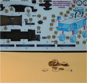

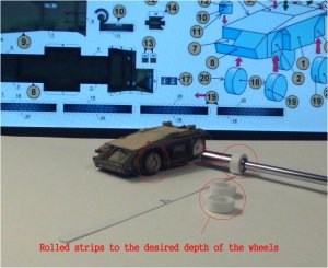

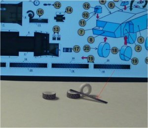

Here are a few more updates on the APC. Painted the rear details and added the front top handles made from a bent paper clip wire. The tires are done my way instead of the traditional way using the little tabs. I rolled a strip of paper the size of the tire width around a round object, in this case a socket. Rolled the strip to the size of the tire and glued the tire thread to the outside. Rounded the edges with sandpaper, painted the white edge matte black and finally the inner and outside hubs to the tire..
