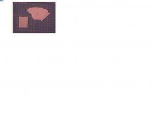

here is my start work on this projec :)
i start cuthing the main part but found thet no strip on it
so i make my oun way
as u can see on pic 1 is the main strip after cuthing the nois part
(i will esembel it later with super glue)

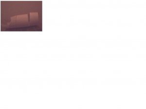

on pic no2 u can see the way i figer out the strip prob
at start i glue the interery part on card bord 0.5
after cut it out i glue som smol pices of card bord in the sheping parts
(what i do is like to make 2 copys of 1 part like in the maly models)
pic 1
(main part)

sorry for the poor quality of the pic its make by MSN webcome
