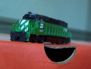

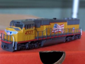

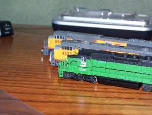

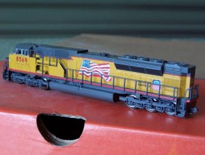

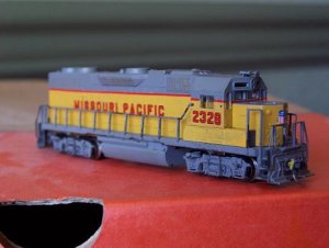

Here are some of the locos that I painted with Floquil. Notice on Missuri Pacific GP that the paint is chipping off the hand rails. Thats because I didnt use model flex.
