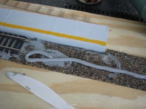

Photo # 1: The module before track and ballast is laid down. The cork roadbed is actually affixed to the plywood using latex caulk too. :thumb:

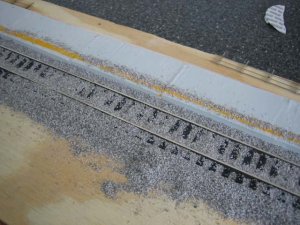

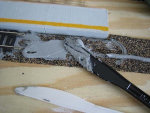

Photo # 2 and # 3:
Laying down a bead of the latex caulking, and spreading it out with a plastic buttering knife. The trick here is to make sure the caulking is REAL THIN. If the layer is too thick, it gets squished between the ties and leaves no space for the ballast.

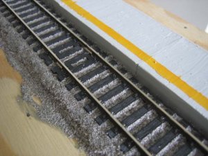

Photo # 4:
Sprinkling on the ballast. I used Woodland Scenics' fine ballast. The grains are all about 0.5mm wide, which translates to rocks about 2 inches in diameter in HO. It's actually a bit oversize, but I think it looks good enough.
The ballast is heaped on generously, then I use finger pressure to press the ballast into the caulking under it.

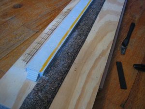

Photo # 5:
I then used a 1-inch paint brush to brush away the loose ballast (which by the way can be saved for use again later on). I gotta say I'm pleased with how it looked and how easy it was!
Before, I used to ballast using an eyedropper to apply the Elmers/wet water mix. It was tedious, it was messy, it took a long time.
To ballast the station module, which has 4 feet of track, it took me all of 20 minutes.
I think this is how I will affix track and ballast from now on. :D
