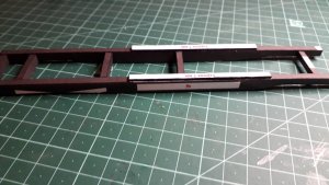

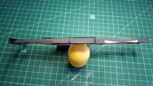

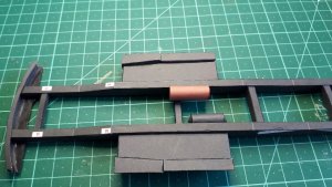

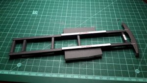

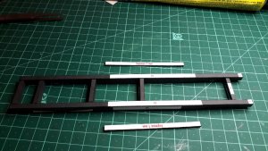

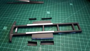

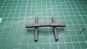

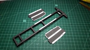

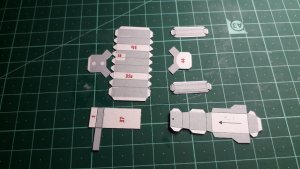

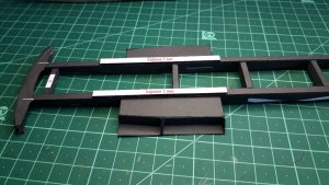

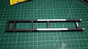

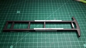

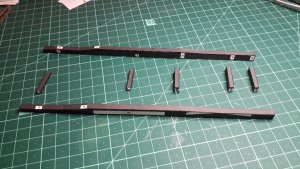

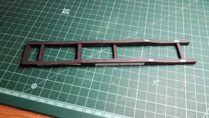

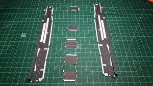

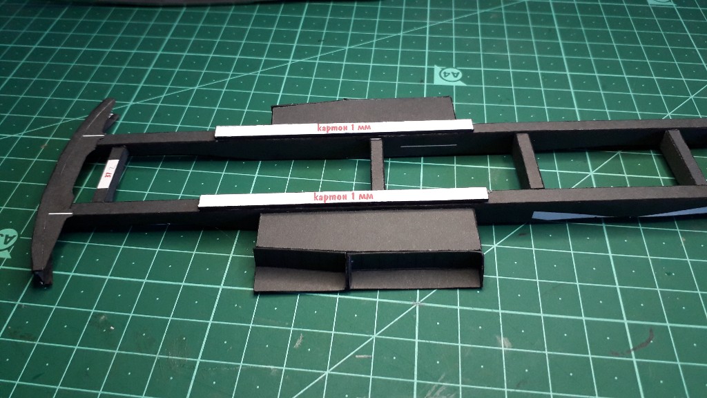

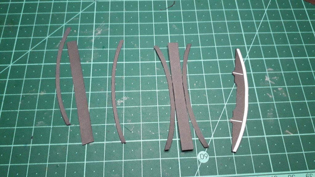

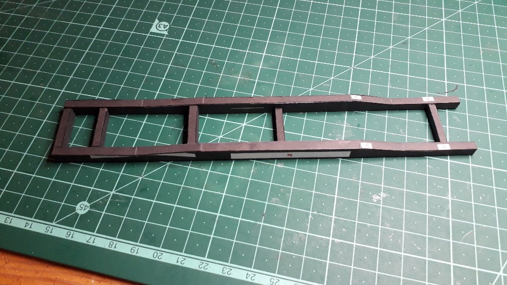

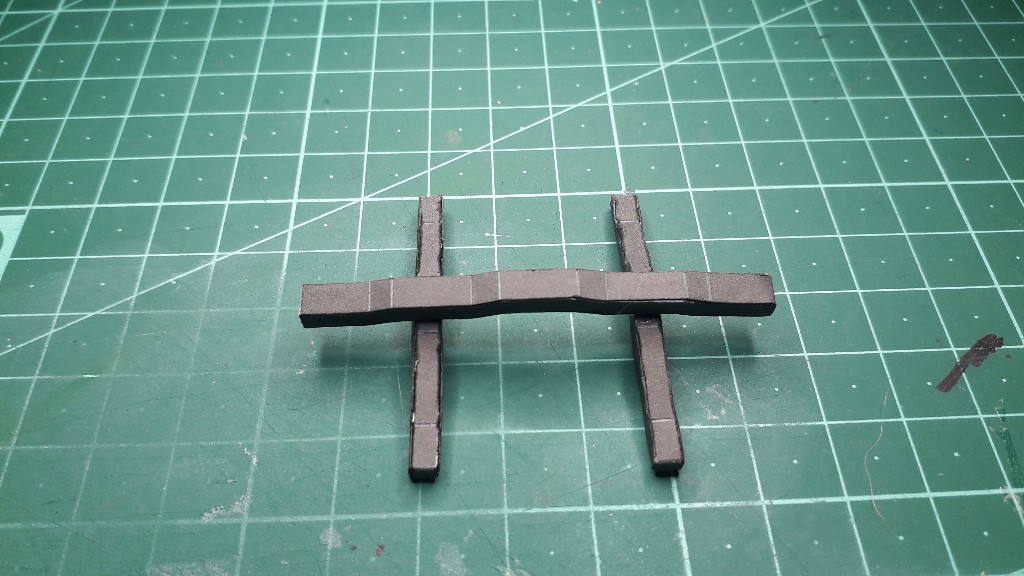

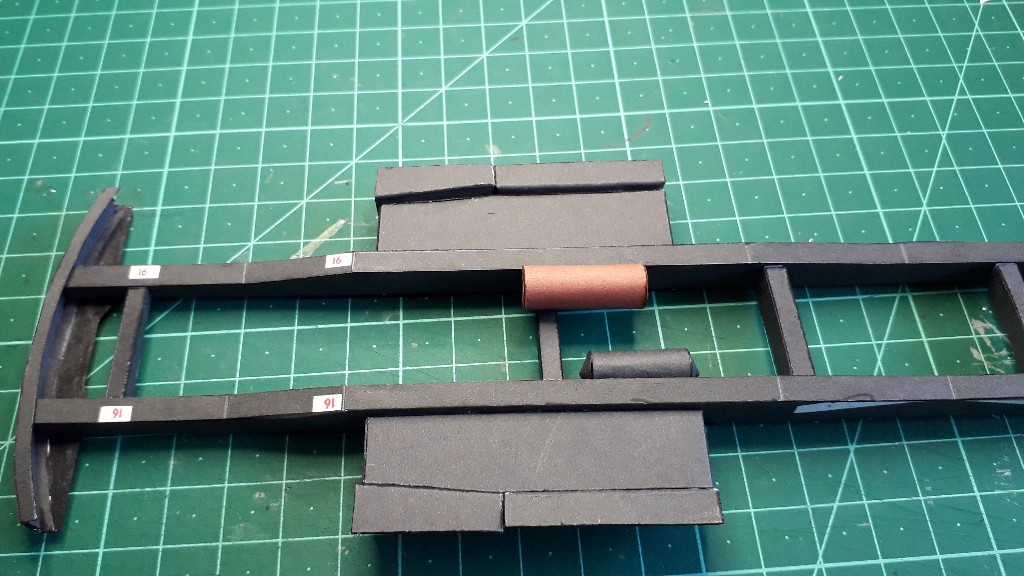

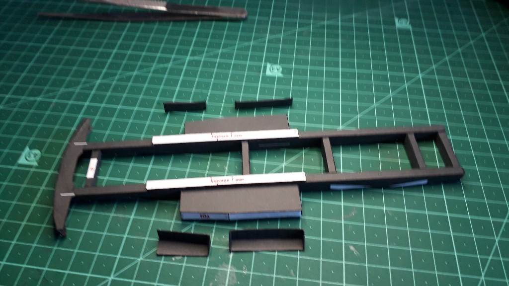

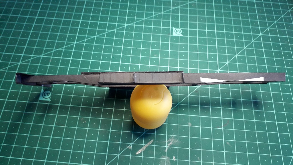

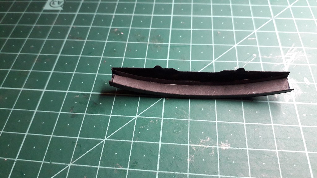

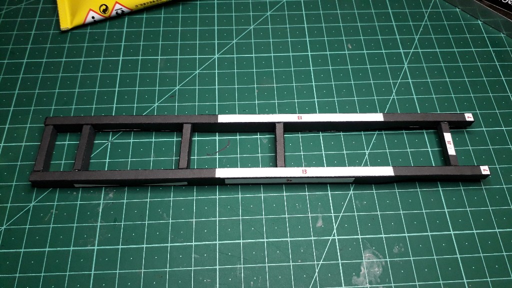

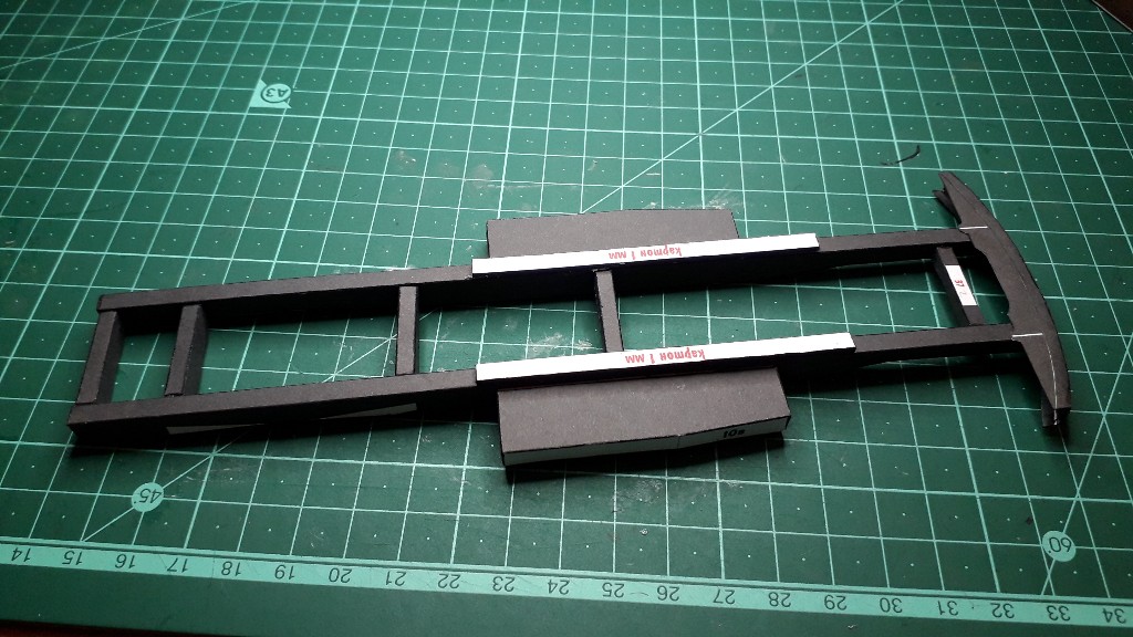

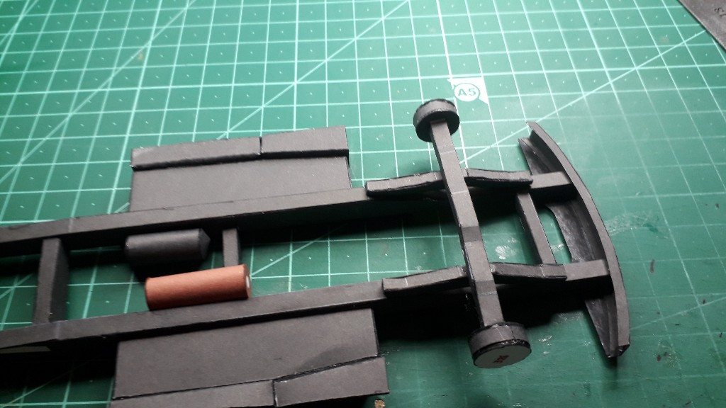

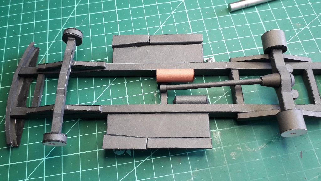

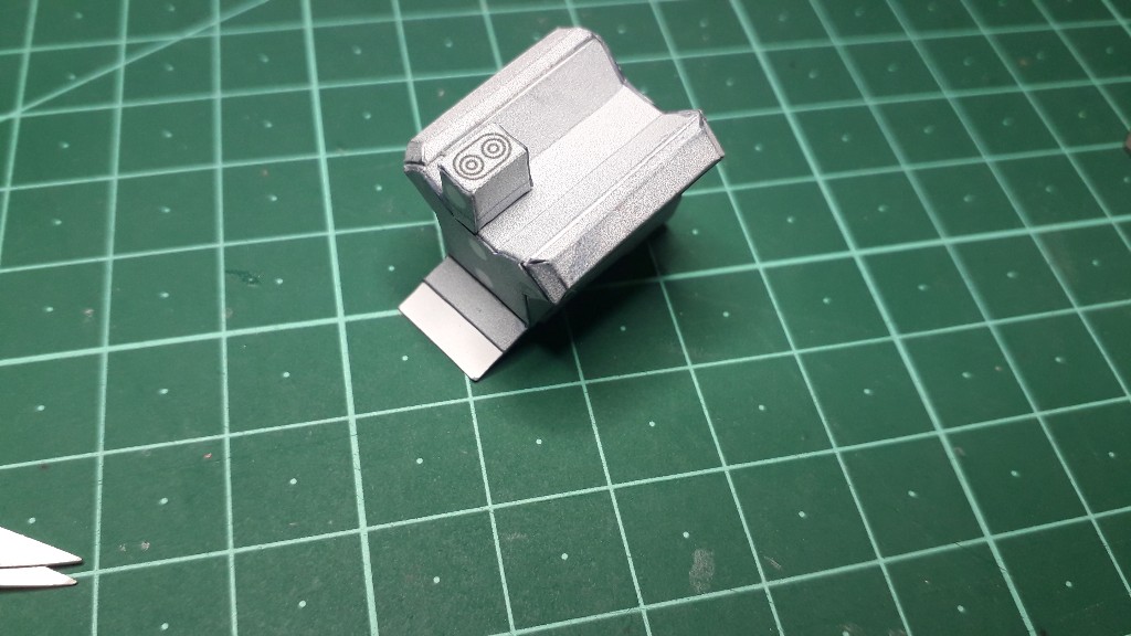

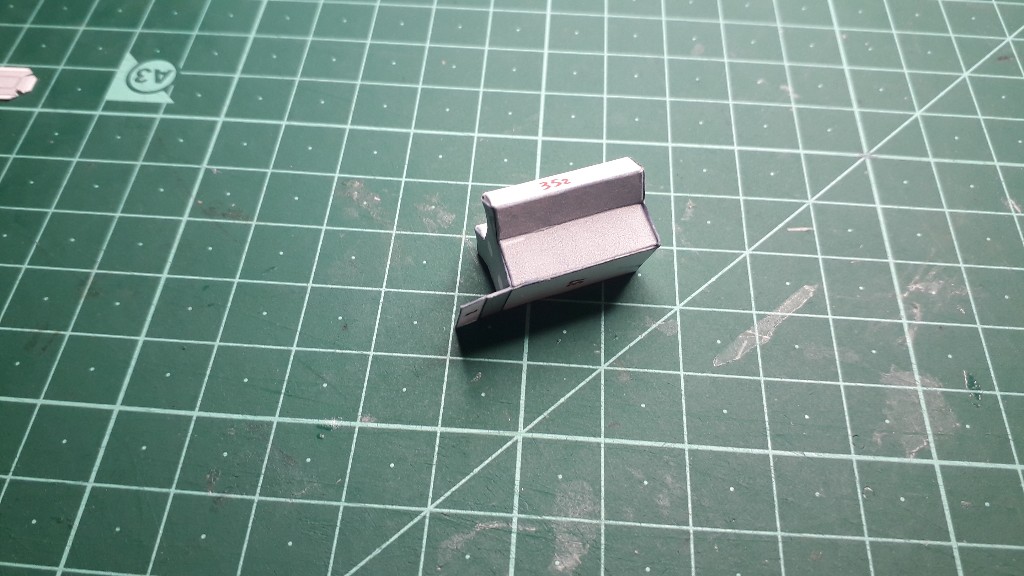

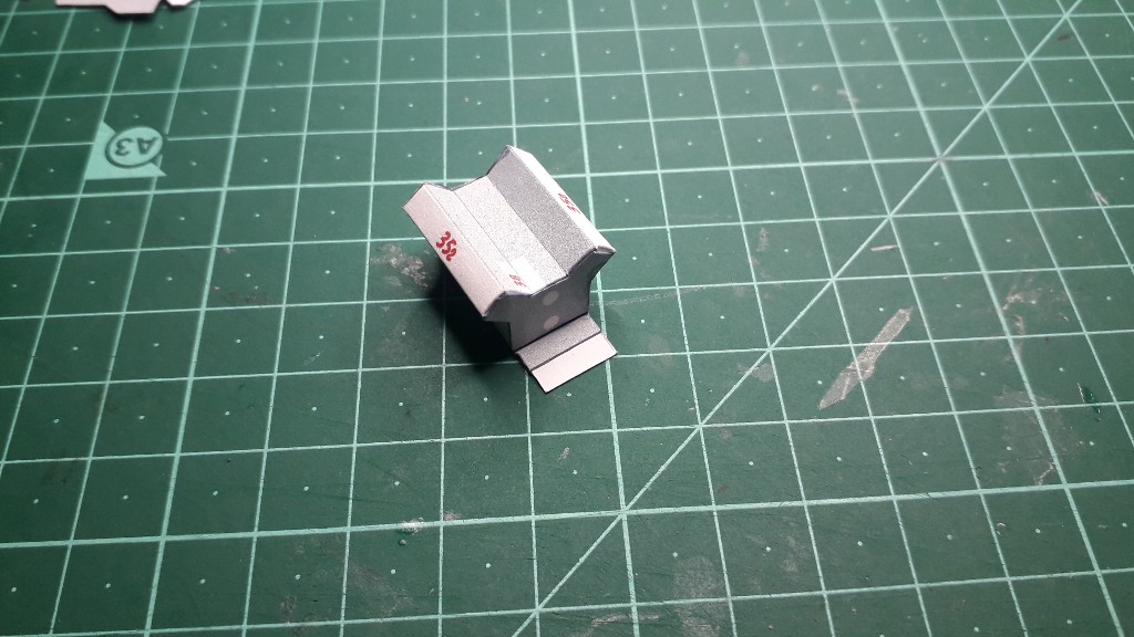

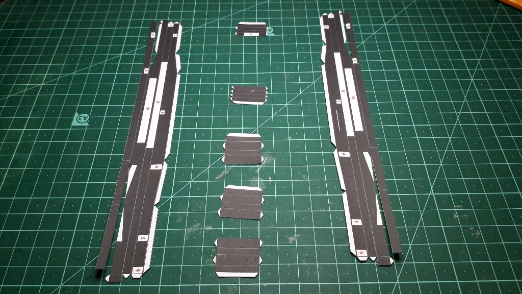

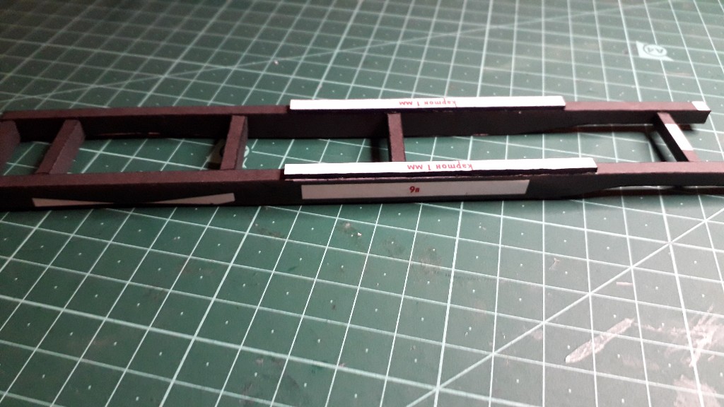

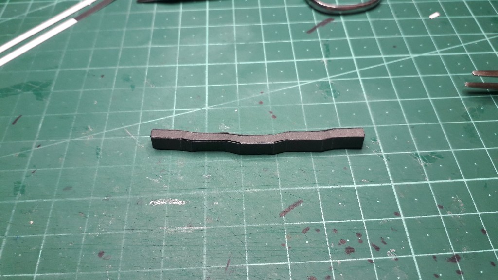

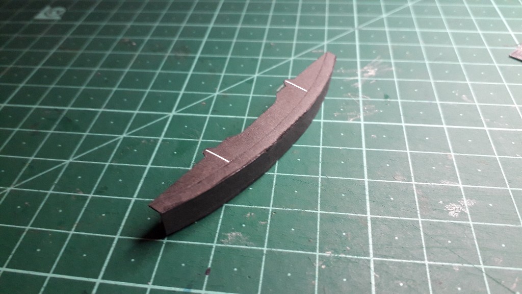

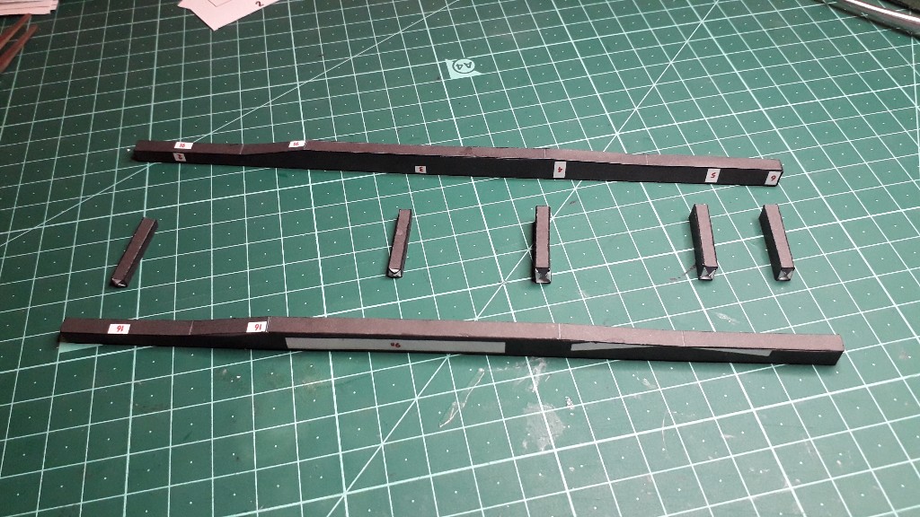

Instructions are 4 pages of drawings. I decided to begin from the frame. The beams and the crossmembers are made as closed boxy structures. I always had a problem making these long and narrow boxes straight. This time the beams look pretty much ok from the beginning. Then, I connected the clossmembers, making sure the frame doesn't become crooked. Need to be very careful here.

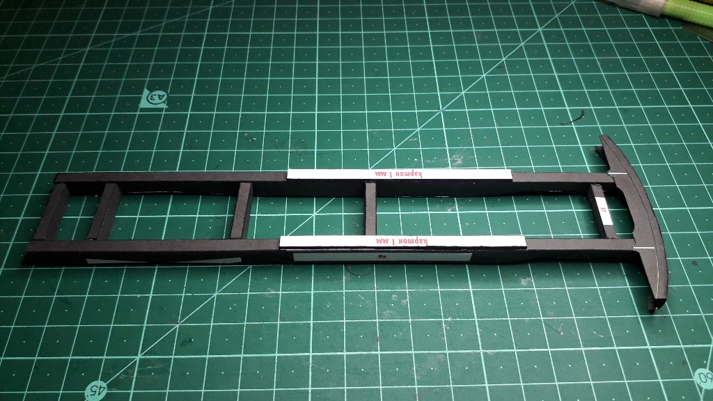

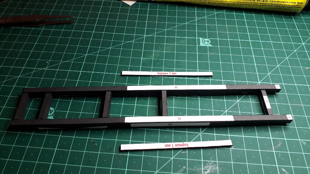

Then came the reinforcements on the top of the beams. These also exist on a real truck.

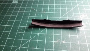

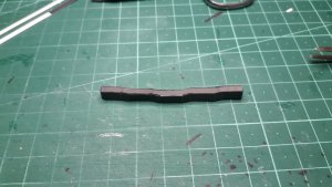

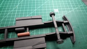

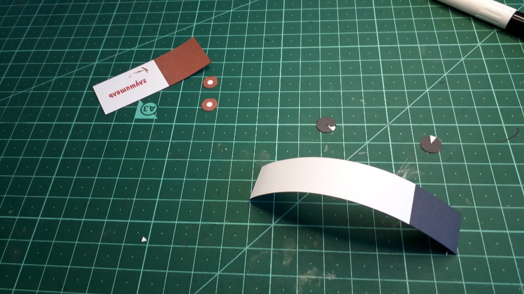

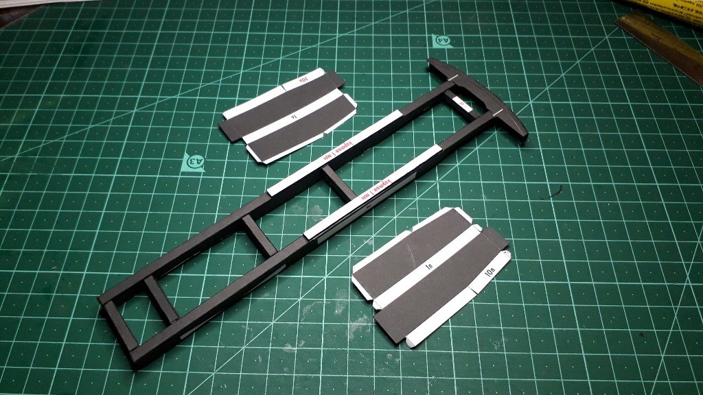

Then came the front bumper. The designer suggests installing the towing hooks at this point, but I am sure I am going to loose them. So I will install them later
Then came the side steps bases.
To be continued...

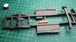

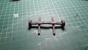

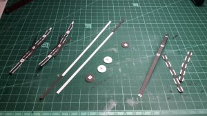

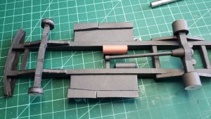

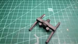

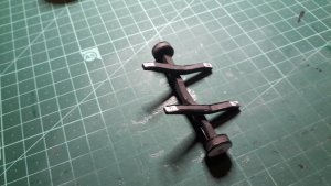

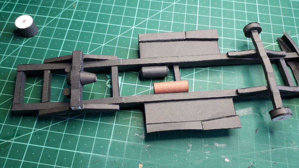

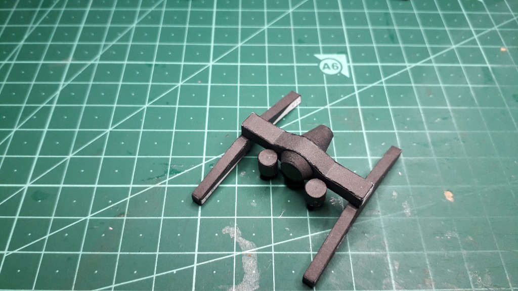

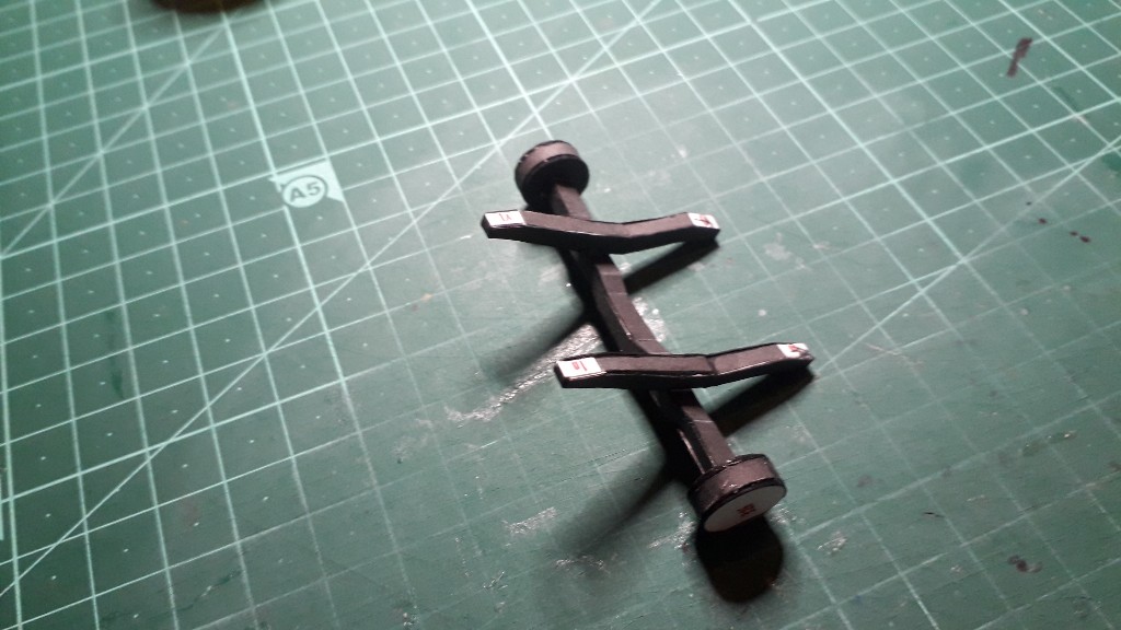

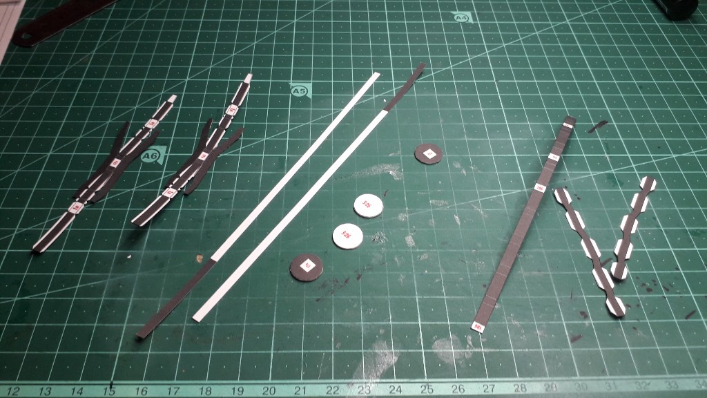

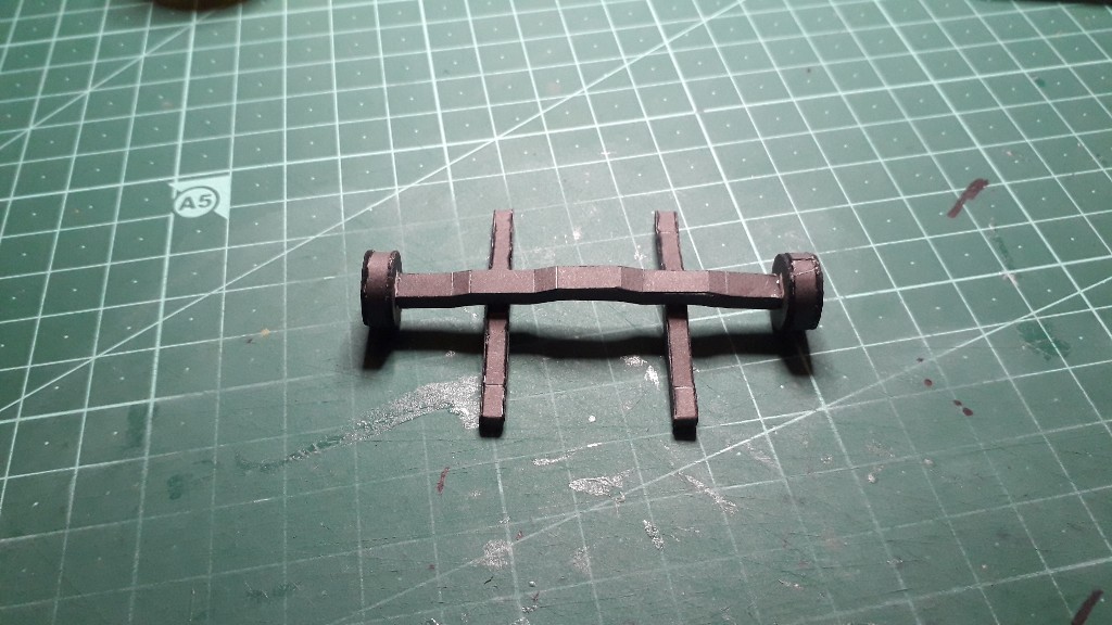

Suspension and axles.

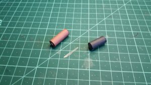

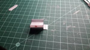

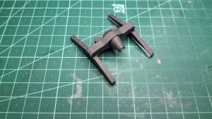

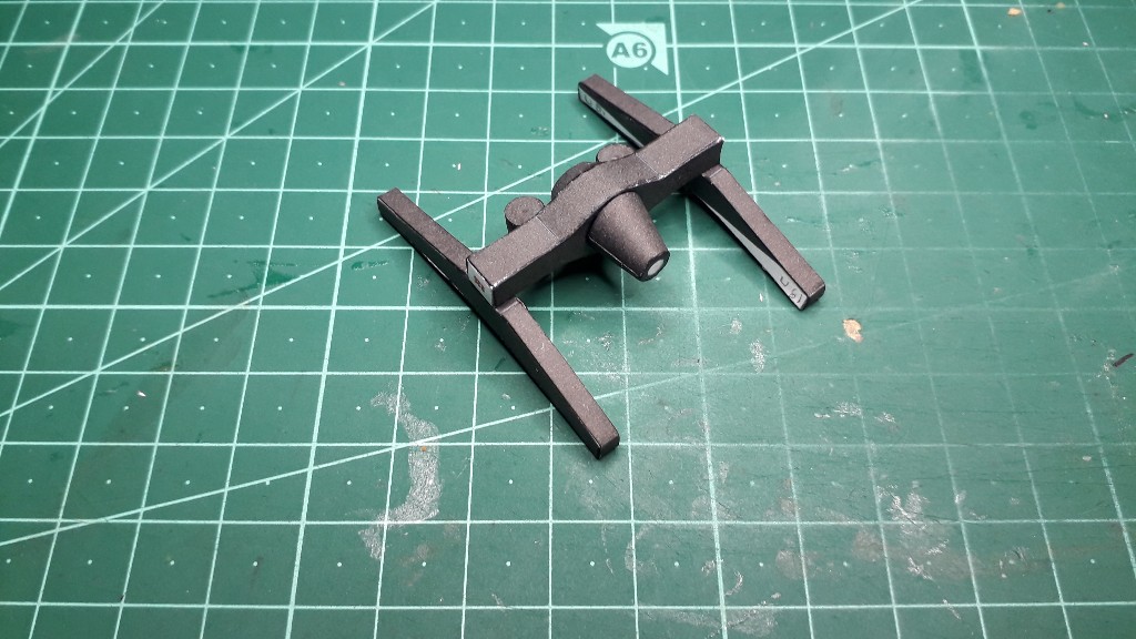

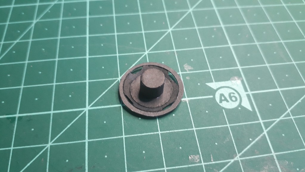

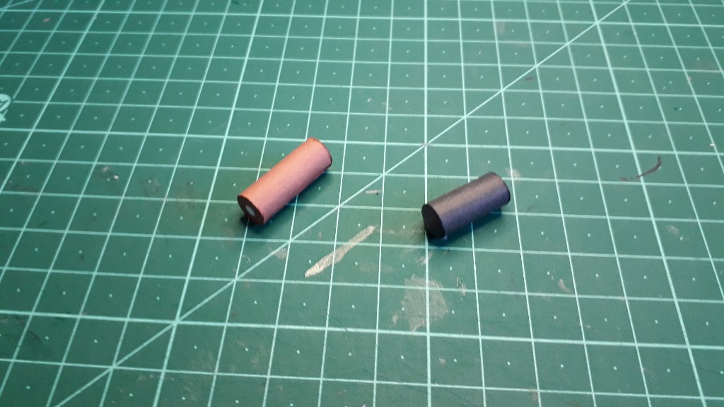

The leaf springs are represented by boxy structures with no gluing tabs, forcing to do but-gluing. Don't like this way, made gluing tabs. Everything else went smooth and without too many issues. Brake drums went along, differential case, brake cylinders - all was good
The final drive shaft was a bit longer than needed. This might designate that I am off with distance of the rear axle. Well, I will have to fix this when mounting the firefighting compartment, if needed

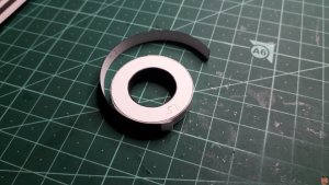

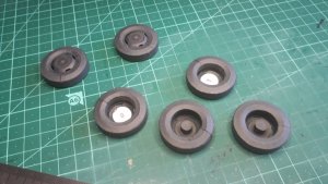

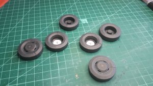

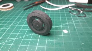

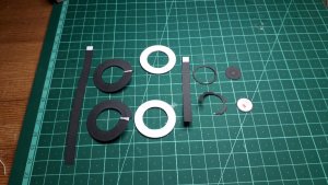

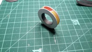

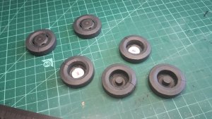

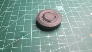

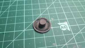

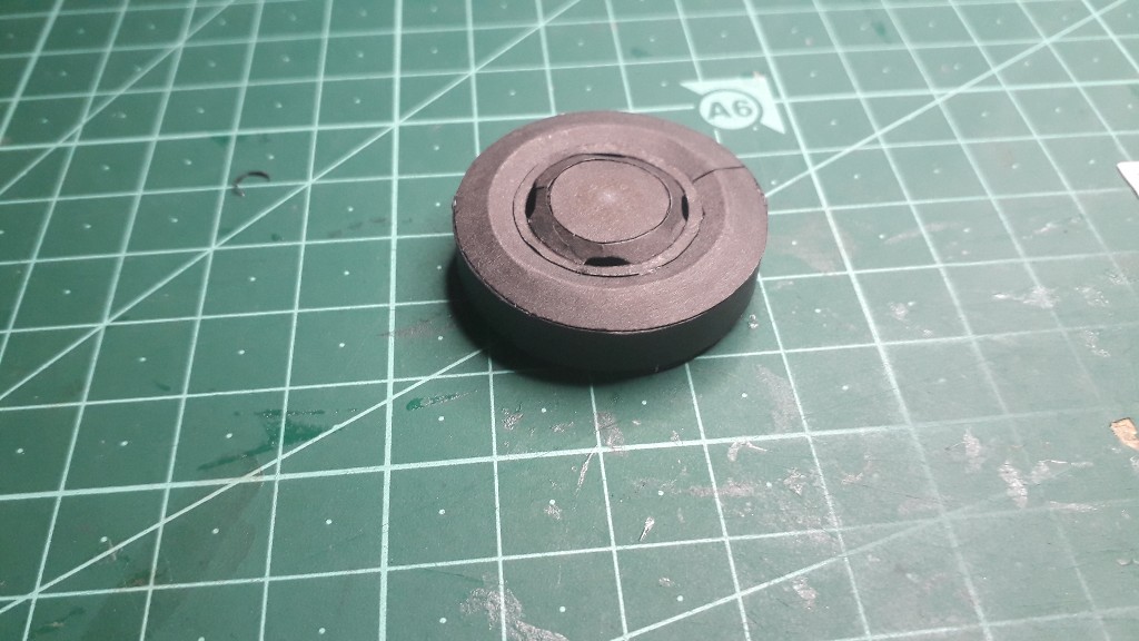

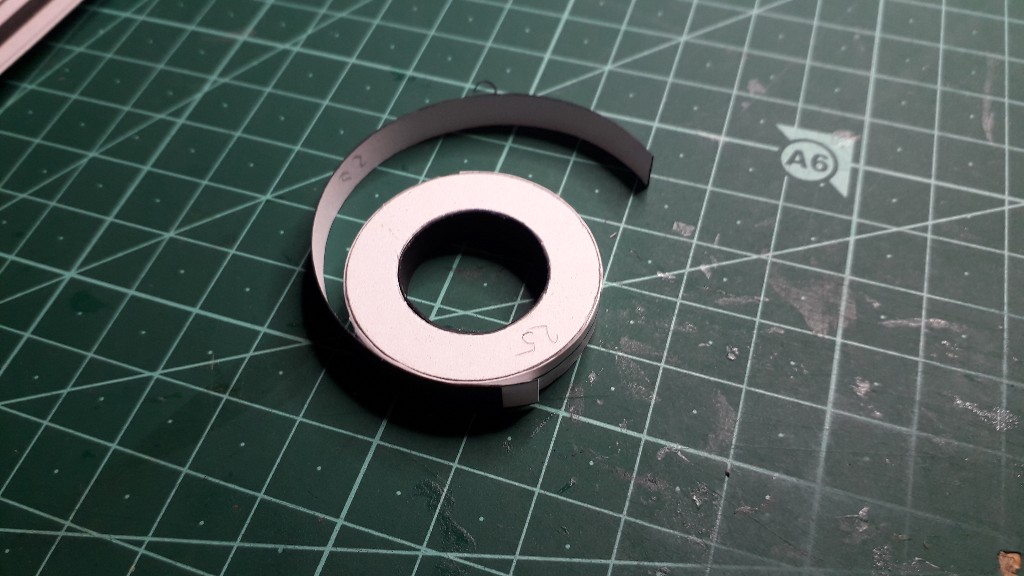

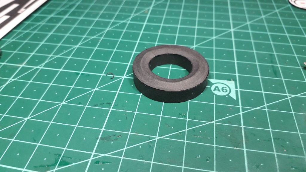

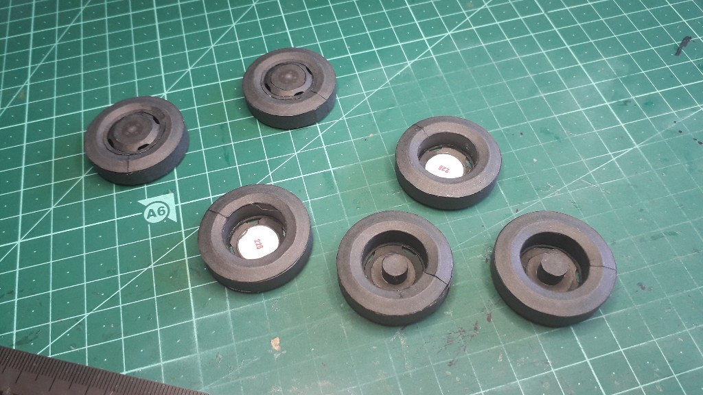

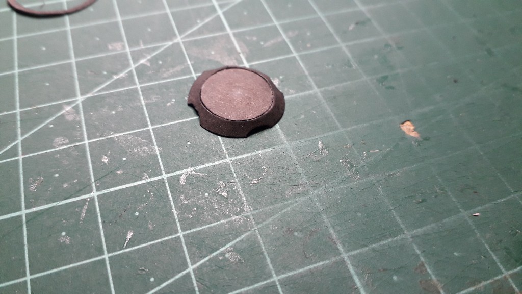

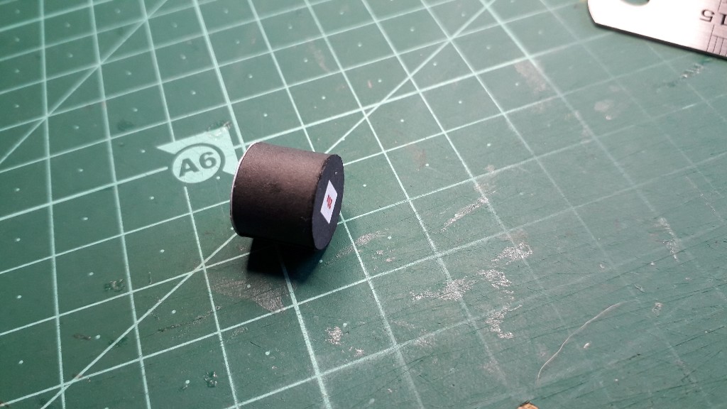

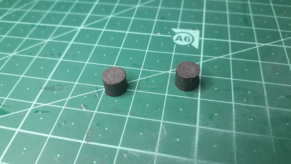

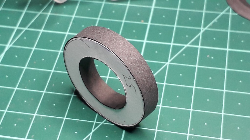

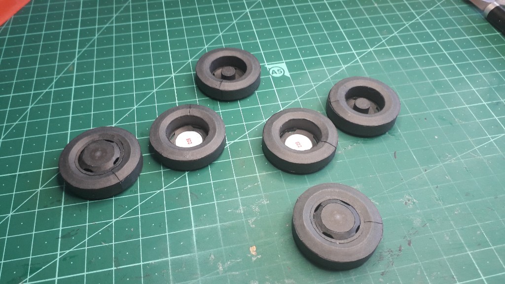

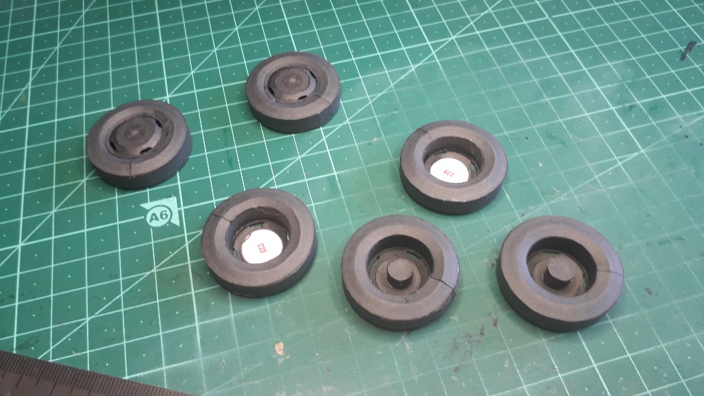

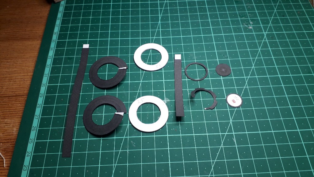

Continue with the wheels. Oh, boy... That took me a lot of time.

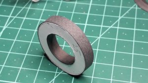

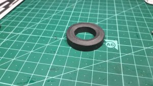

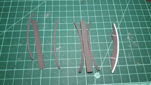

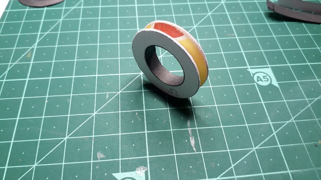

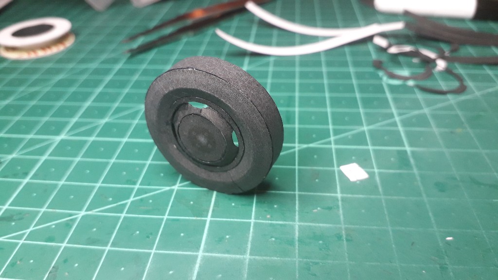

Each wheel is made from:
2 Tire side bases from cereals box
2 tire sides
1 tire thread ( the part that actually touches the ground)
1 tire bottom
1 rim (a parer ring 2 mm wide )
1 rim cone
2 rim center pieces for front wheel
1 rim center for internal rear wheel
1 rim center and 2 piece hub on the outer rear wheel.
Many edge-gluing. The threads are glued to side bases' edges. The whole rim is edge glued. A lot of small connections, hoping it will eventually becomes strong enough wheel to hold the model's weight.

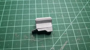

20200414_204032_copy_1024x576.jpg20200414_214145_copy_1024x576.jpg20200414_210832_copy_1024x576.jpg20200414_215226_copy_1024x576.jpg20200414_215347_copy_1024x576.jpg20200414_215759_copy_1024x576.jpg20200414_225500_copy_1024x576.jpg20200414_225546_copy_1024x576.jpg20200415_030449_copy_1024x576.jpg20200415_114723_copy_1024x576.jpg20200415_124244_copy_1024x576.jpg20200415_124246_copy_1024x576.jpg20200415_133835_copy_1024x576.jpg

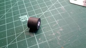

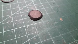

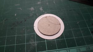

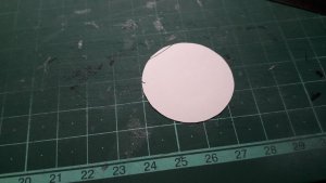

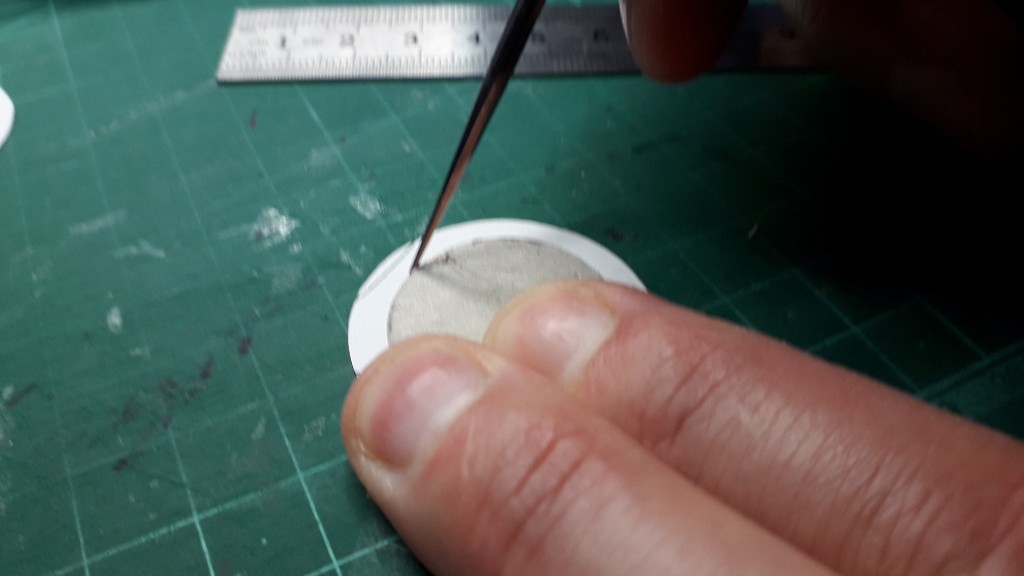

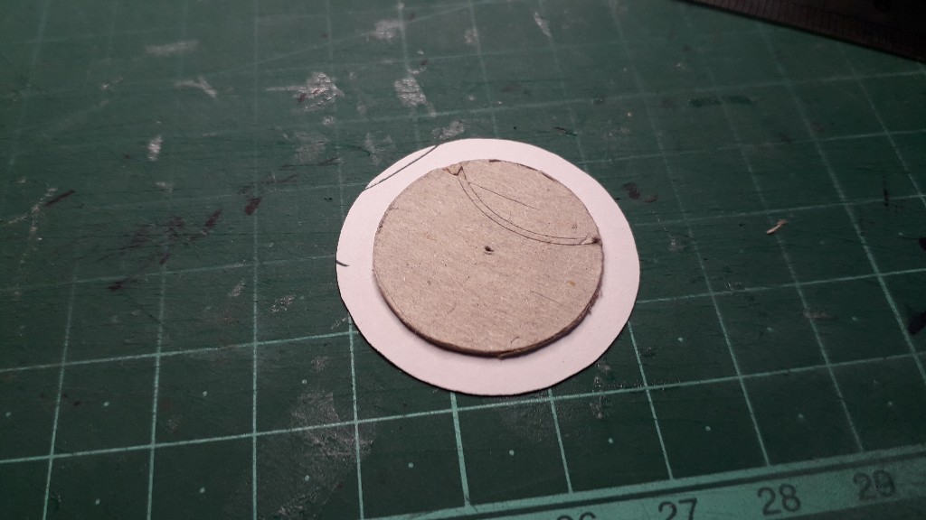

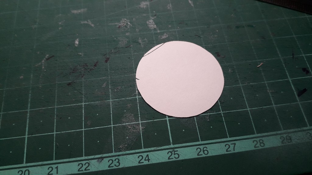

The tire sides are made round to simulate the real wheel tire roundness.

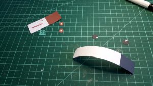

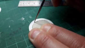

There's a need to strike a circular line on the middle of the tire side. Tried to do this by my cutting compass - the result looked awful. So I made a template from cerial box cardboard to stroke a line around it with my awl. I liked this idea, maybe someone will use it. 20200414_185230_copy_1024x576.jpg20200414_185246_copy_1024x576.jpg20200414_185326_copy_1024x576.jpg
Clean job on the wheels. I cover wheels with Liquid Electrical Tape. You can add fine strips of paper for threads. When it dries, the wheels look like rubber. I'm sure you must have something like that in your country. :)

Thanks Zathros for your advice
I am almost sure we don't have this liquid tape product.

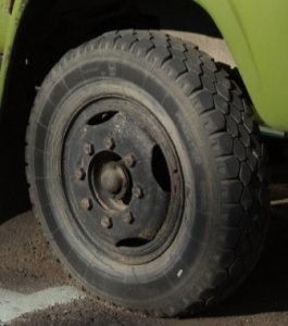

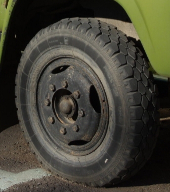

The most common thread pattern is shown in the attached picture. The grid on the cutting mat is 1x1 cm (around 0.4 inch). The pattern has many small rhomb-shaped items. Unless I find some creative way to make these rhombus pattern without cutting paper, I won't make these.

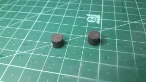

I am more into making nuts and bolt heads on the wheels. These are in real life 38x44 mm with 22 mm height. Scaled to 1:32, the nuts should be 1.4x1.1 mm with 0.6 mm height. 0.6 mm is the width of the cereals box cardboard. I am checking now a way of making these nuts by making my own punch. (Sorry, I am not too good with imperial units)
Reactions: Toutenkarton
I am sure you have some kind of liquid rubber product, and almost any one will work. :)

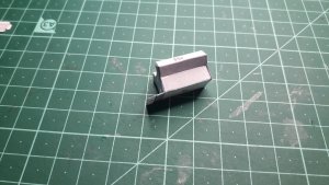

I tried to find a way of making the nuts for the wheels. I have in my toolbox a screwdriver with changing torx heads. The T4 size is the exact size of the nuts in-scale. Firtsly, I tried to make a punch using the syringe needle. I cut the angled tip off, and then I pushed the Torx screwdriver into the syringe tube. This, theoretically should have caused the syringe to become hexagonal. That didn't work, since the syringe tube simply broke lengthwise. Probably, I should have used a larger sized needle, but I don't know if there exists needle larger than 1.2mm ( I think it was marked as 20 gauge). Maybe for veterinary use, I will ask my dog's doc.
Then I tried to punch out by simply tapping on the screwdriver head against the cutting mat. That was a bad idea, since the "nut" got into the mat very deeply without any possibility to get it out. That's a fail. On the positive side, the holes left are very clean. Then I tried to use this hole as a mold to fill it with solder. That didn't work also. There are more ways to check. Will do this next week.

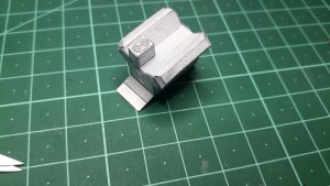

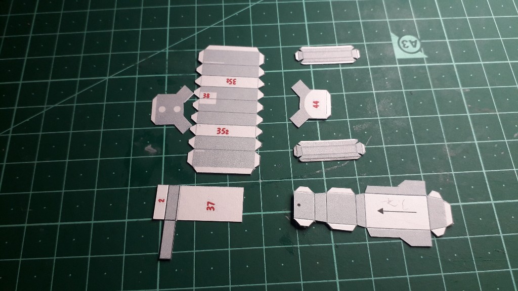

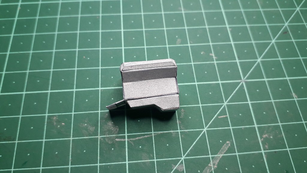

On that note, I continued with the engine. ZiL130 used a V8, 6l petrol engine. This is a very compact engine and it is very small in 1:32 scale. Hence it is not really detailed.
So I started with the engine block, then the oil pan and then the engine heads.
Next should come the accessories: pumps, alternator, air filter and so on. I managed to mount the pneumatic pump and that's all for now 20200418_023605_copy_1024x576.jpg20200418_031051_copy_1024x576.jpg20200418_031058_copy_1024x576.jpg20200418_031102_copy_1024x576.jpg20200418_040533_copy_1024x576.jpg20200418_042243_copy_1024x576.jpg
If you punch the Torx head into a Two Part Steel Epoxy piece to the depth of the nut you wish, do it a few time, then, after it hardens, put Vaseline in the holes, you can put more "two part epoxy" into the hardened piece and when the little bits harden, you can easily remove them as the Vaseline reacts as a release agent. You can make a lot of nuts that way. :)
