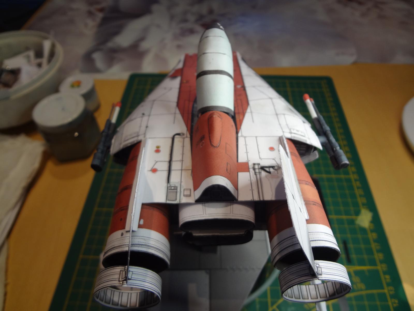

A-Wing

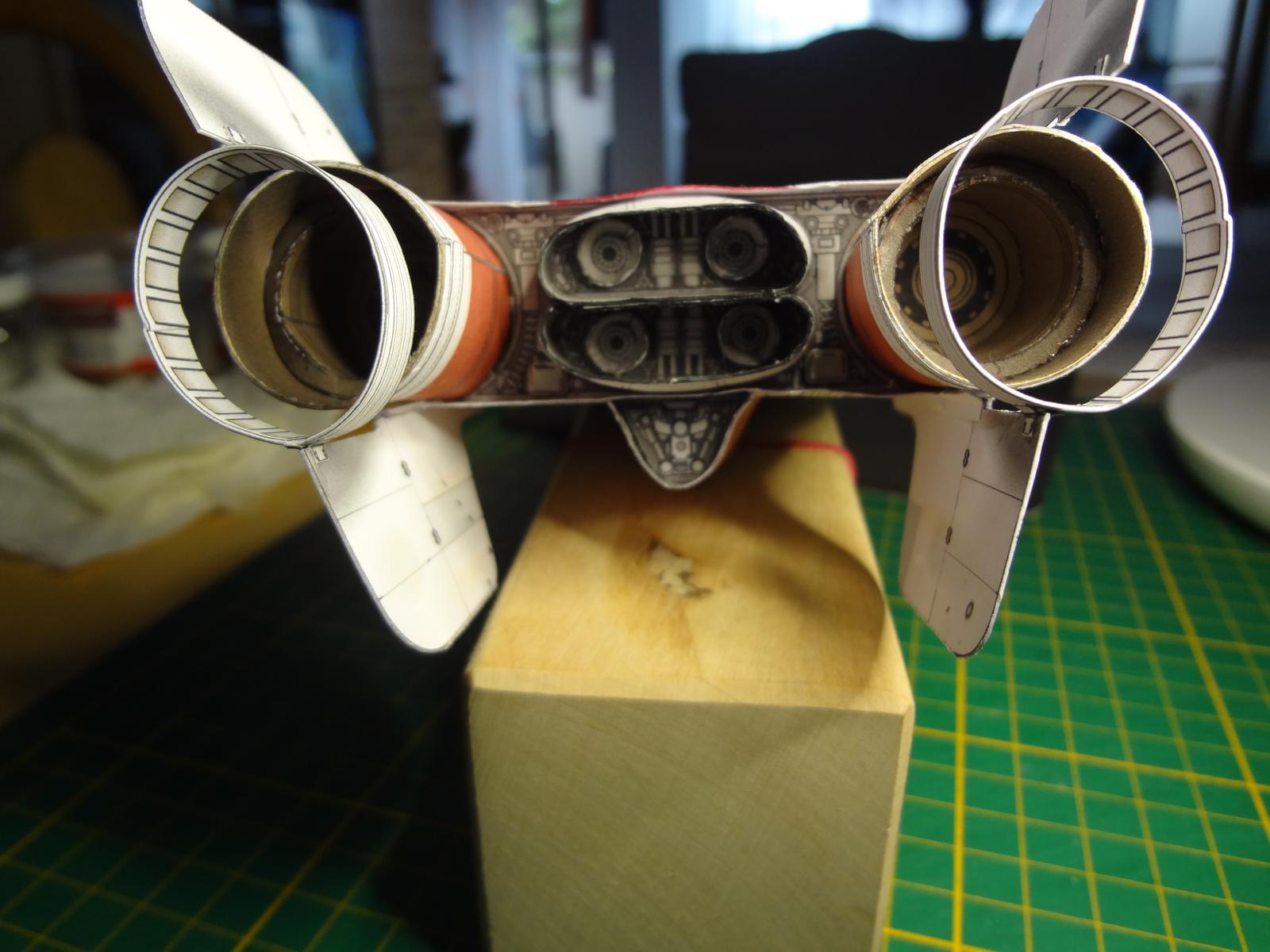

Engine and wing.

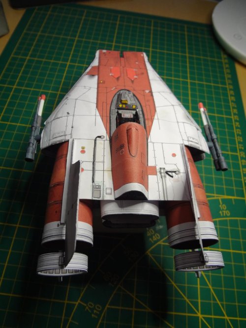

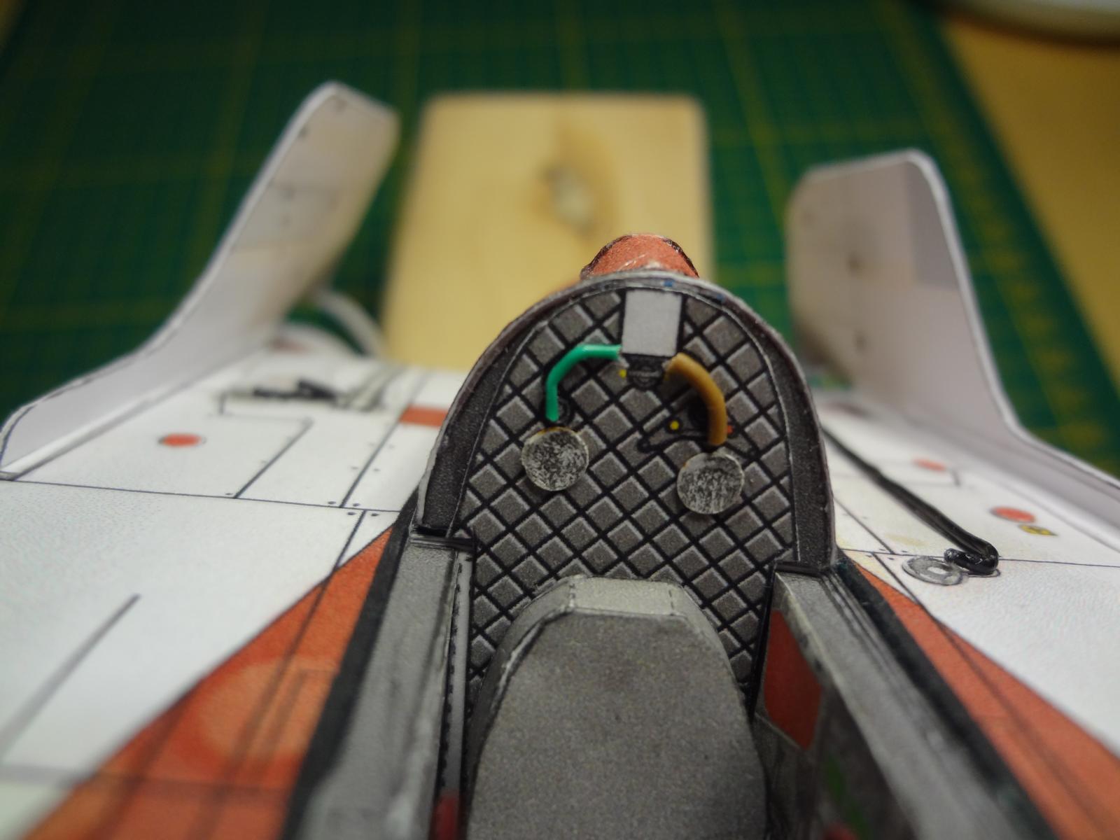

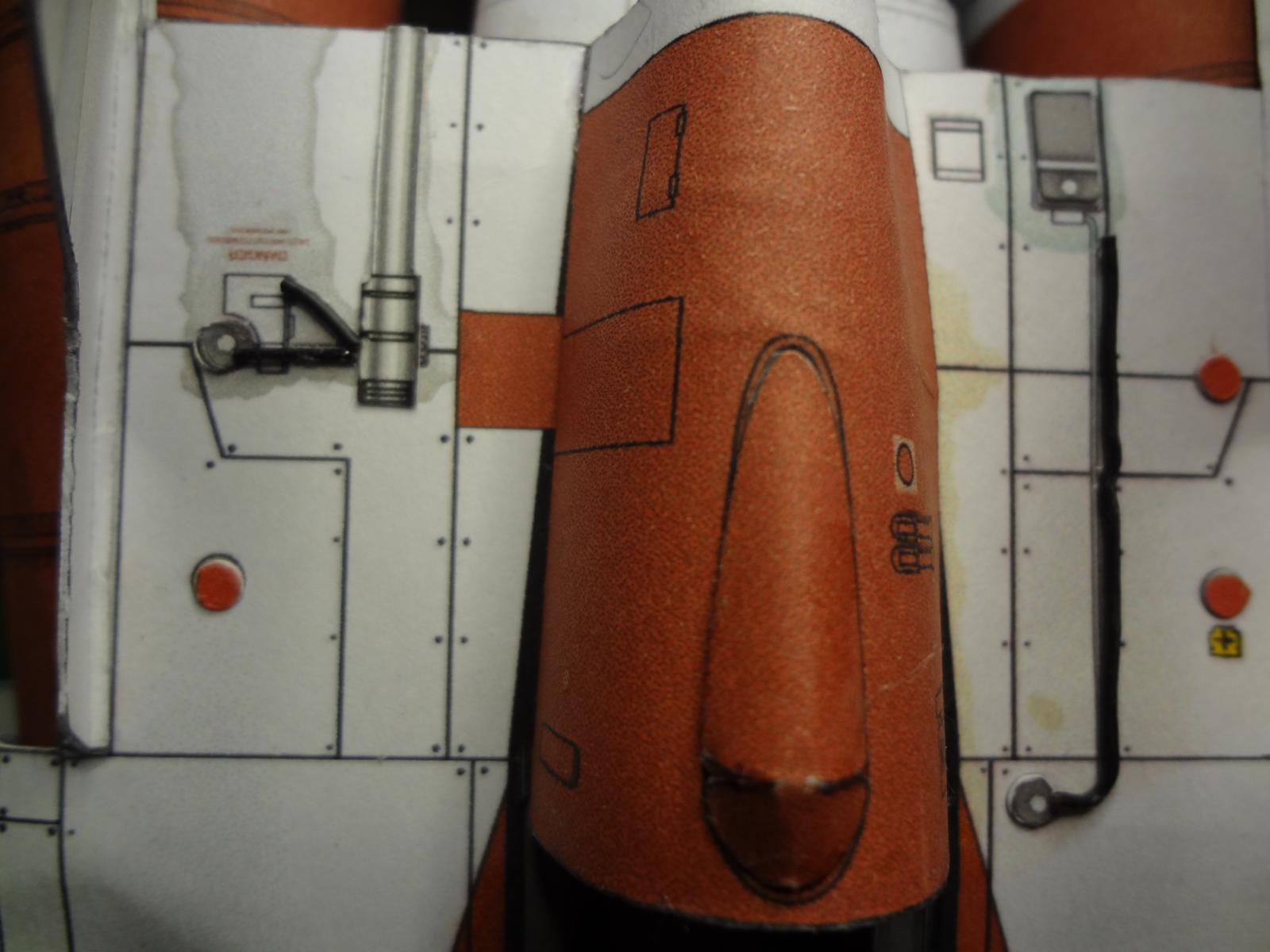

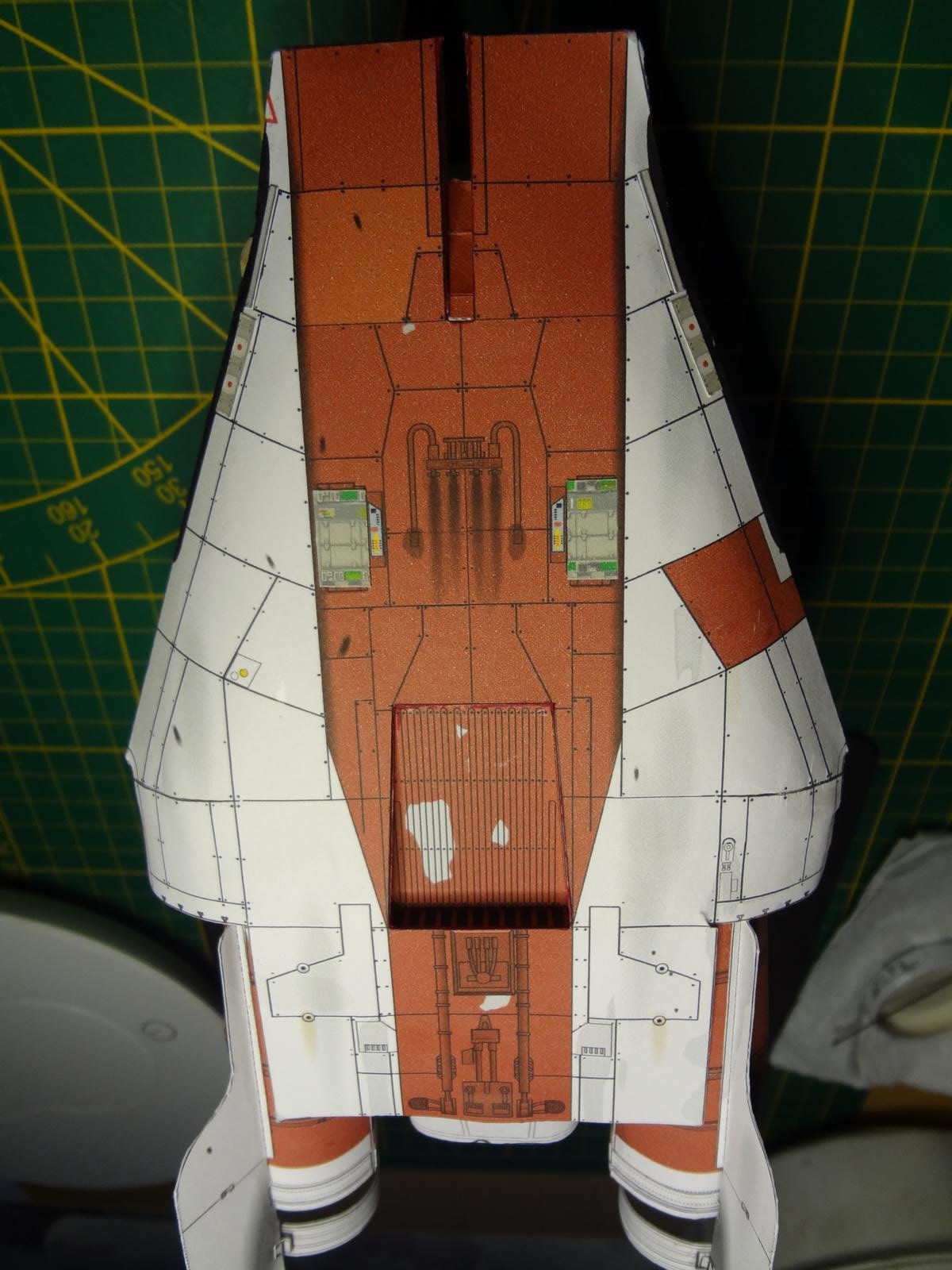

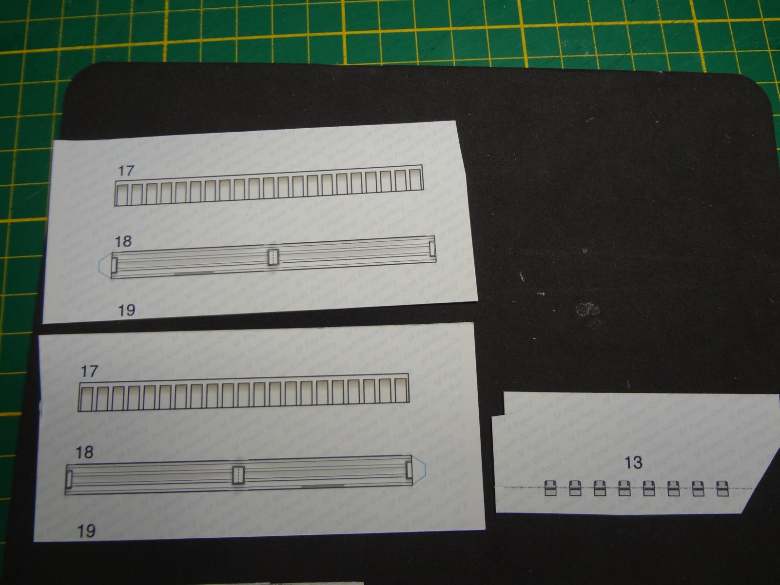

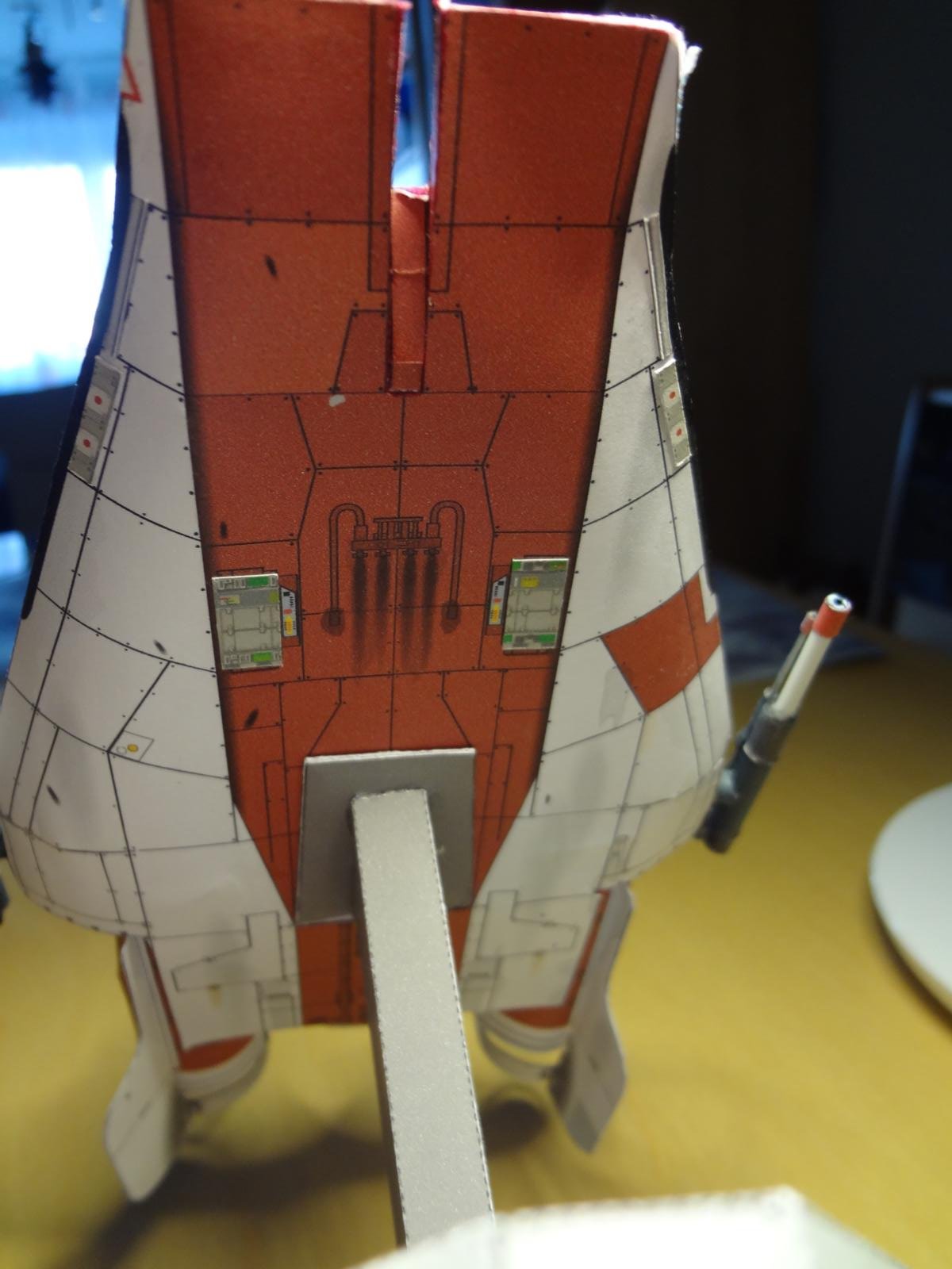

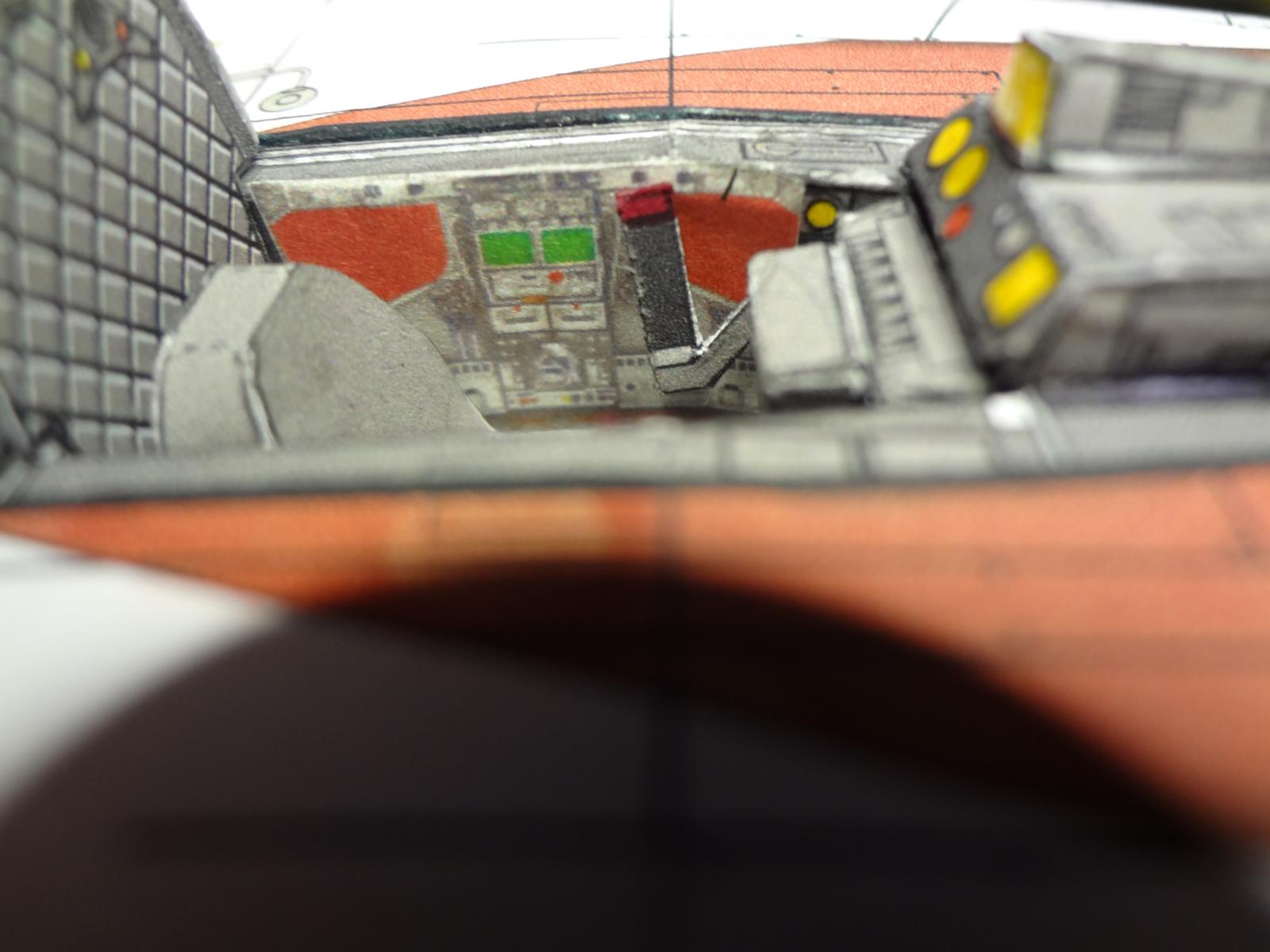

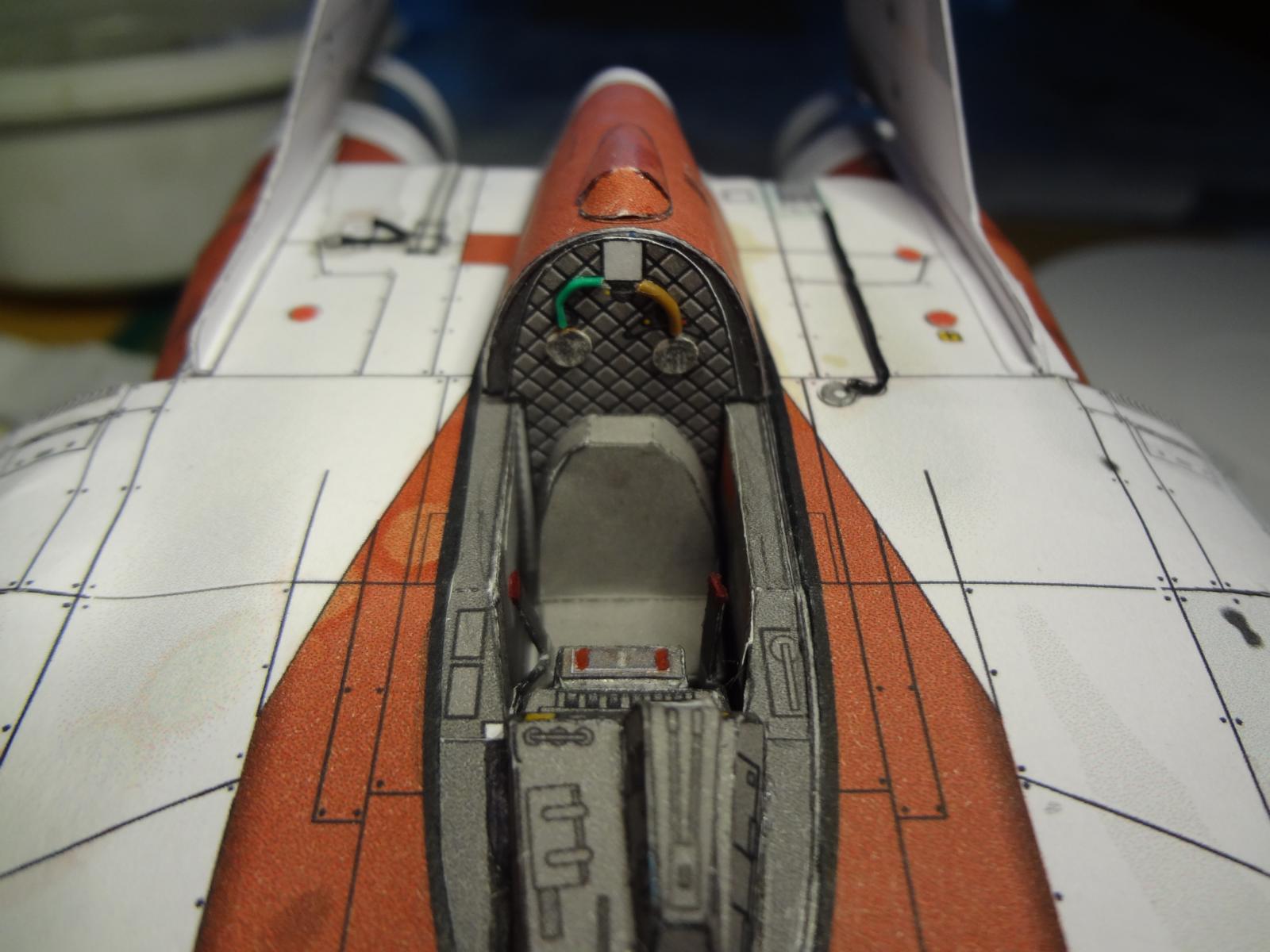

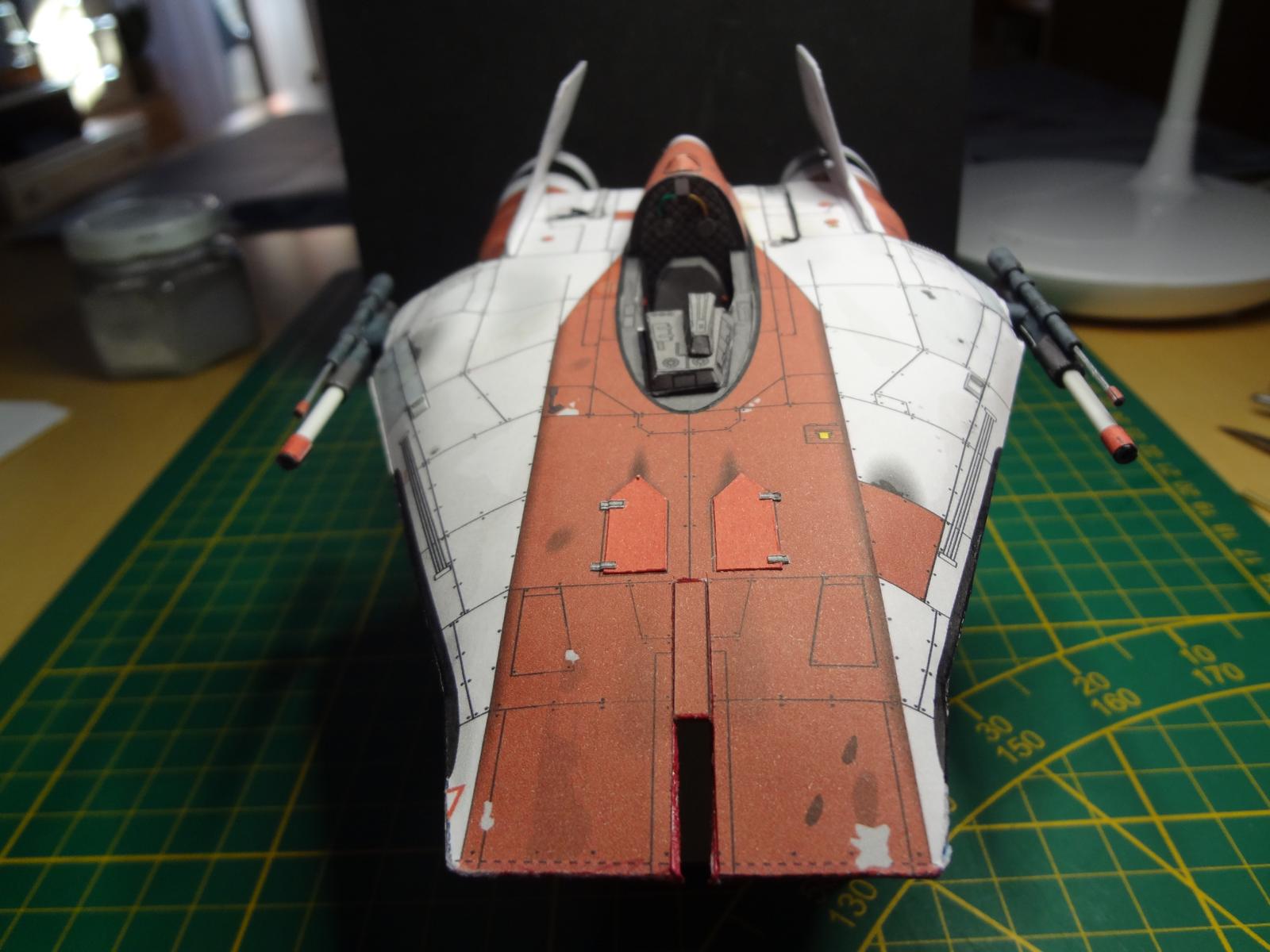

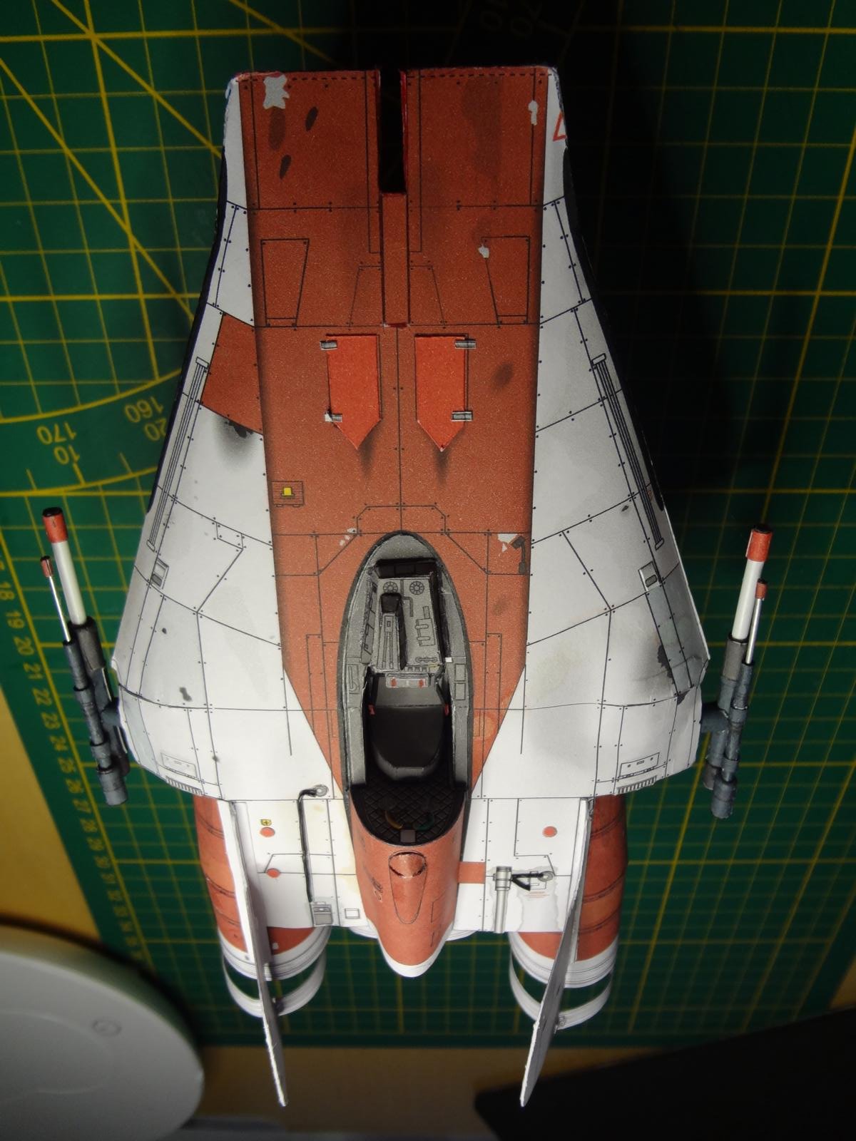

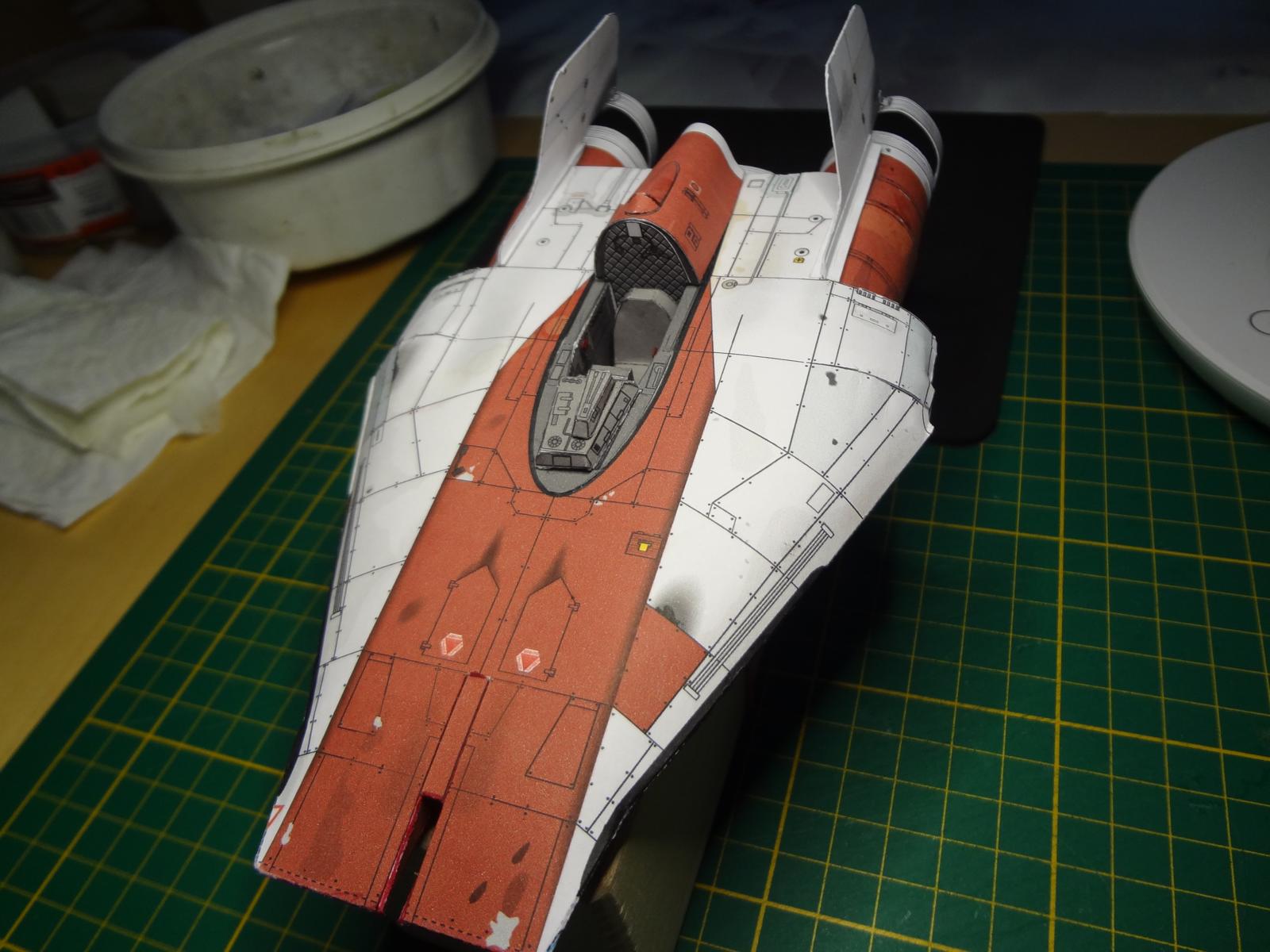

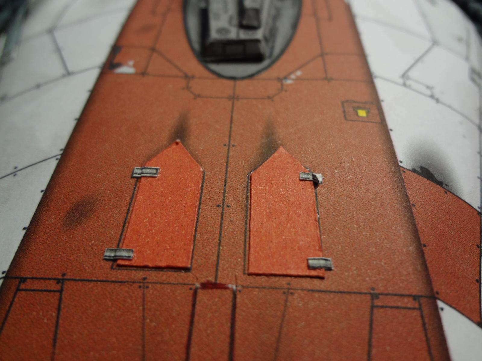

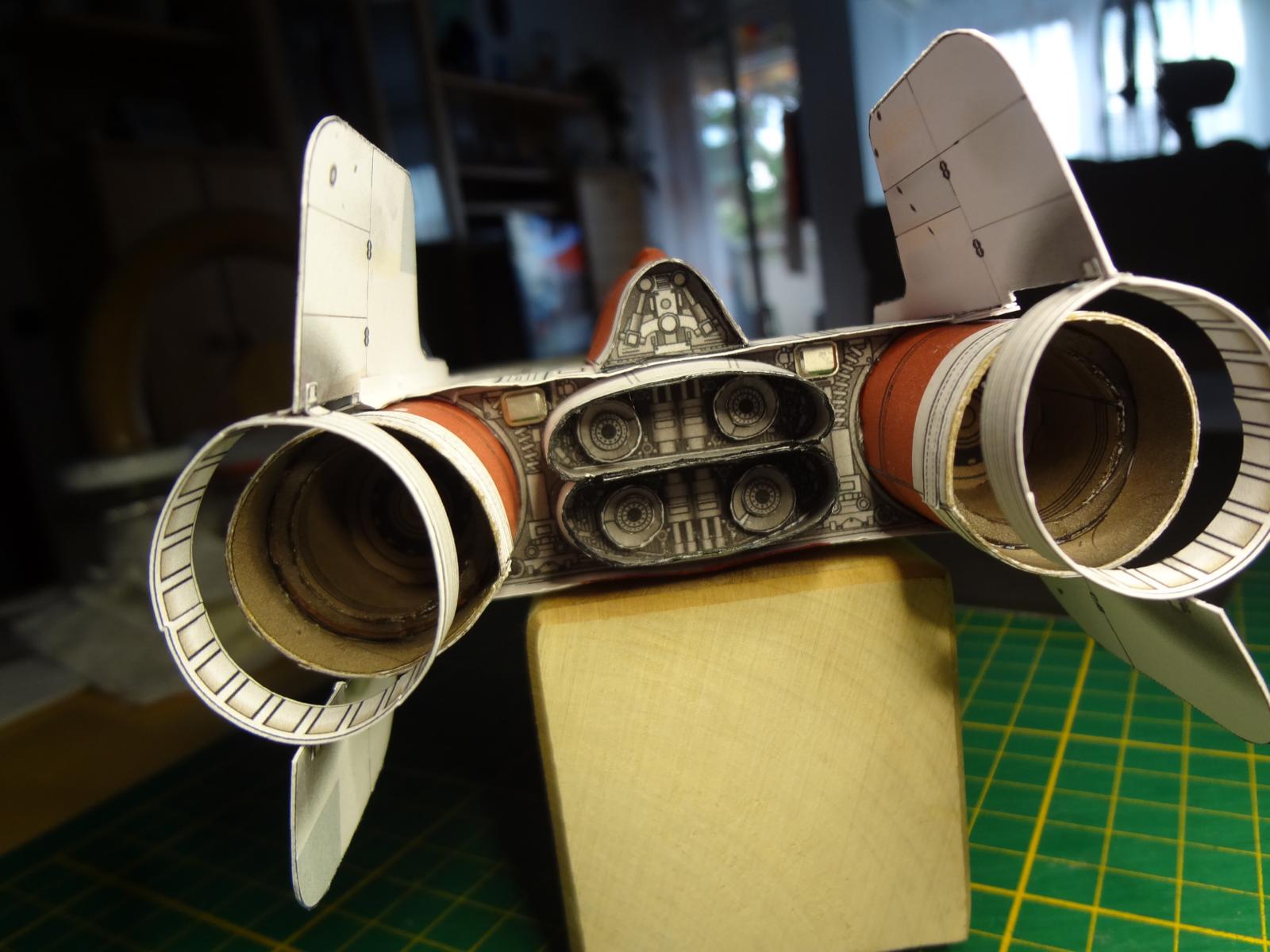

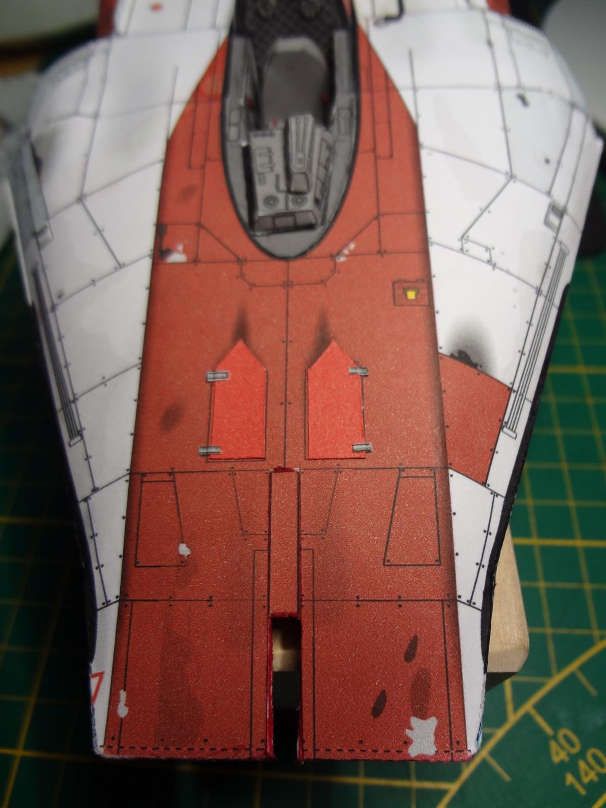

The instrument panel looks good, like Rhaven said, print those parts out twice, cut out the holes, and place the whole piece behind with a plastic film, that will give you a 3D cockpit instrument cluster. You know, only people who make masterful builds like this get recommendations. This is one my favorite Star Wars ships. I'd take my thumbs, or some kind of rounded tool, and make sure the two rear ovals in the back are symmetric, as they look a little wonky in the pics. Great build, and great build thread. ;)

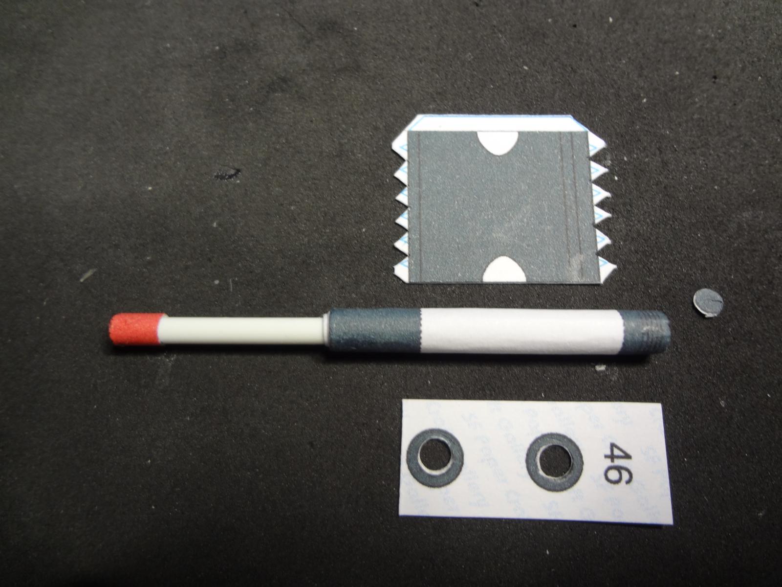

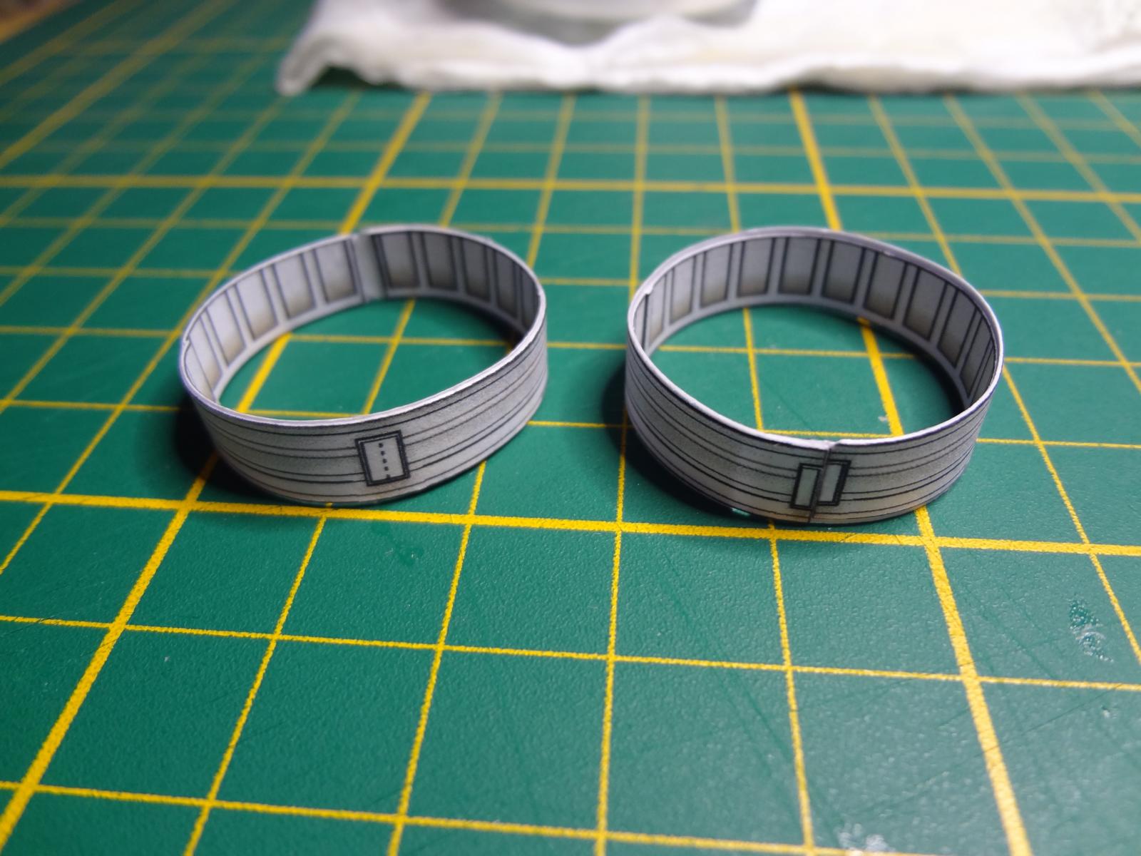

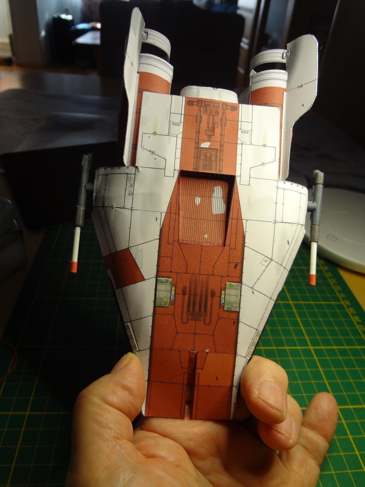

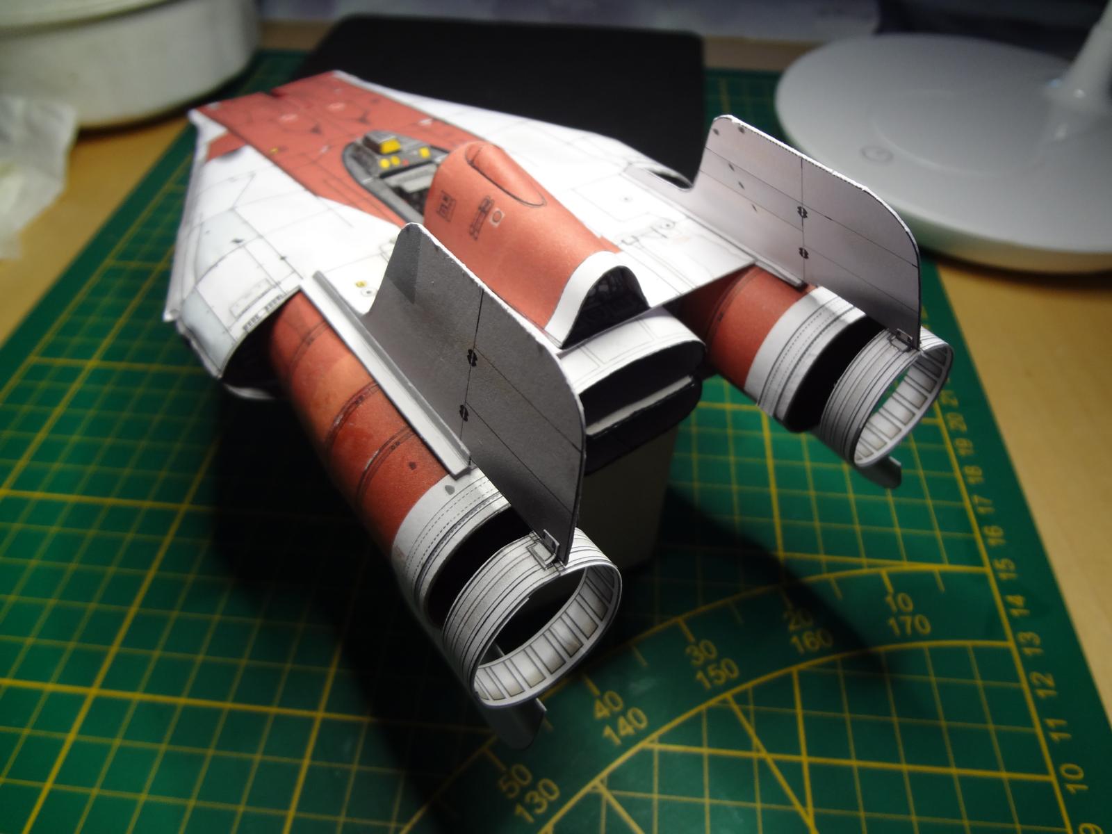

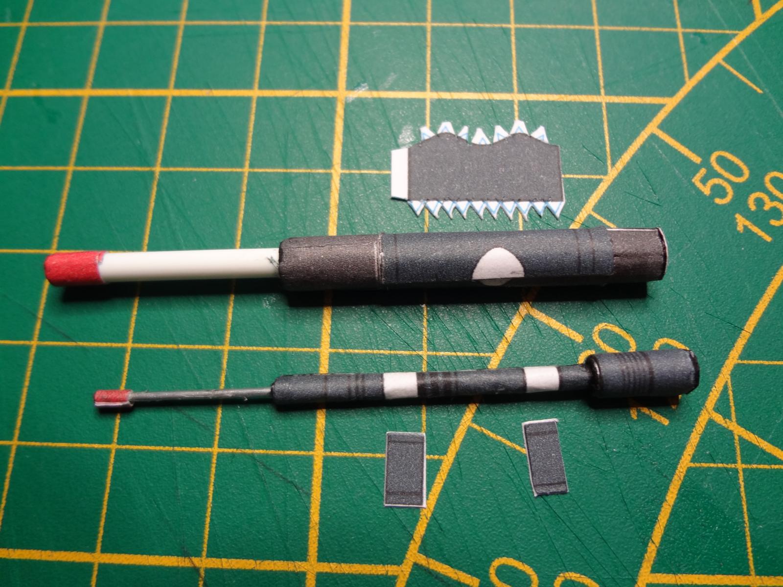

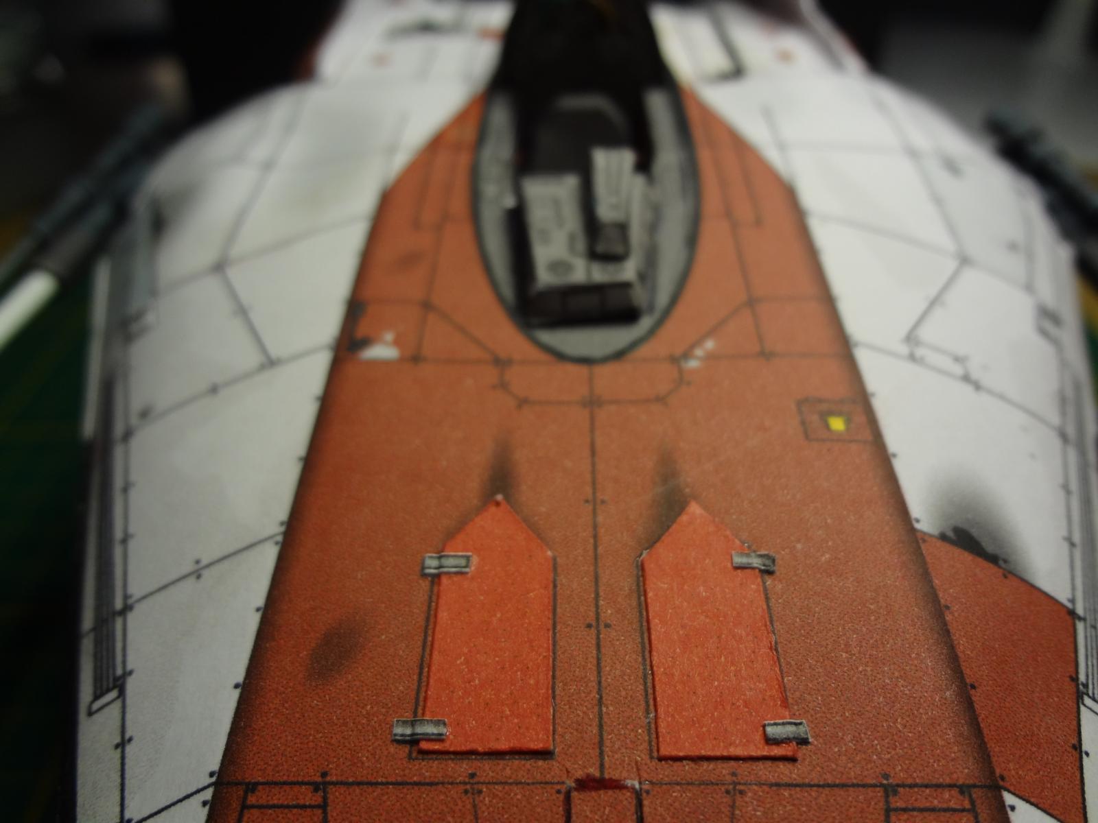

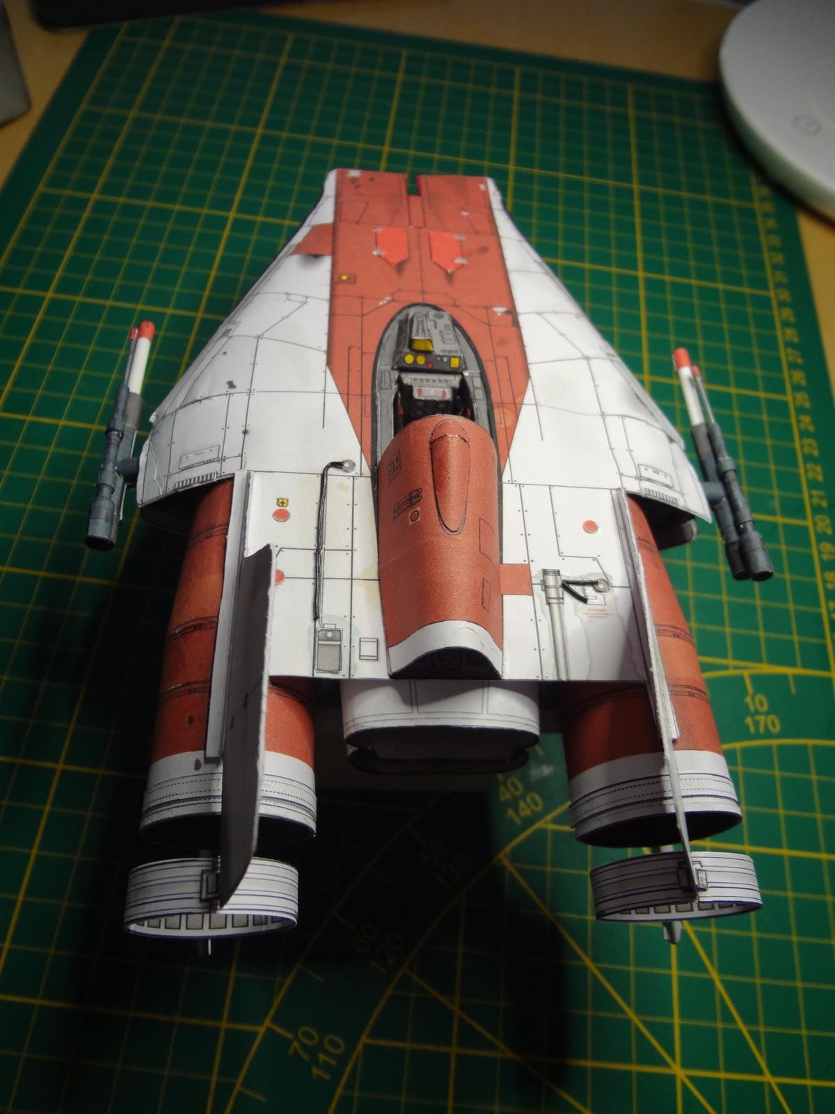

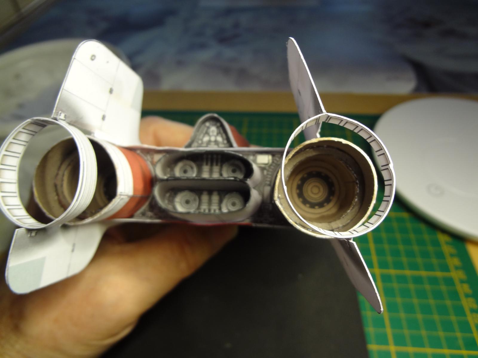

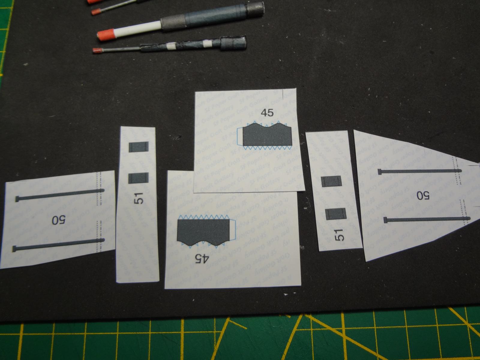

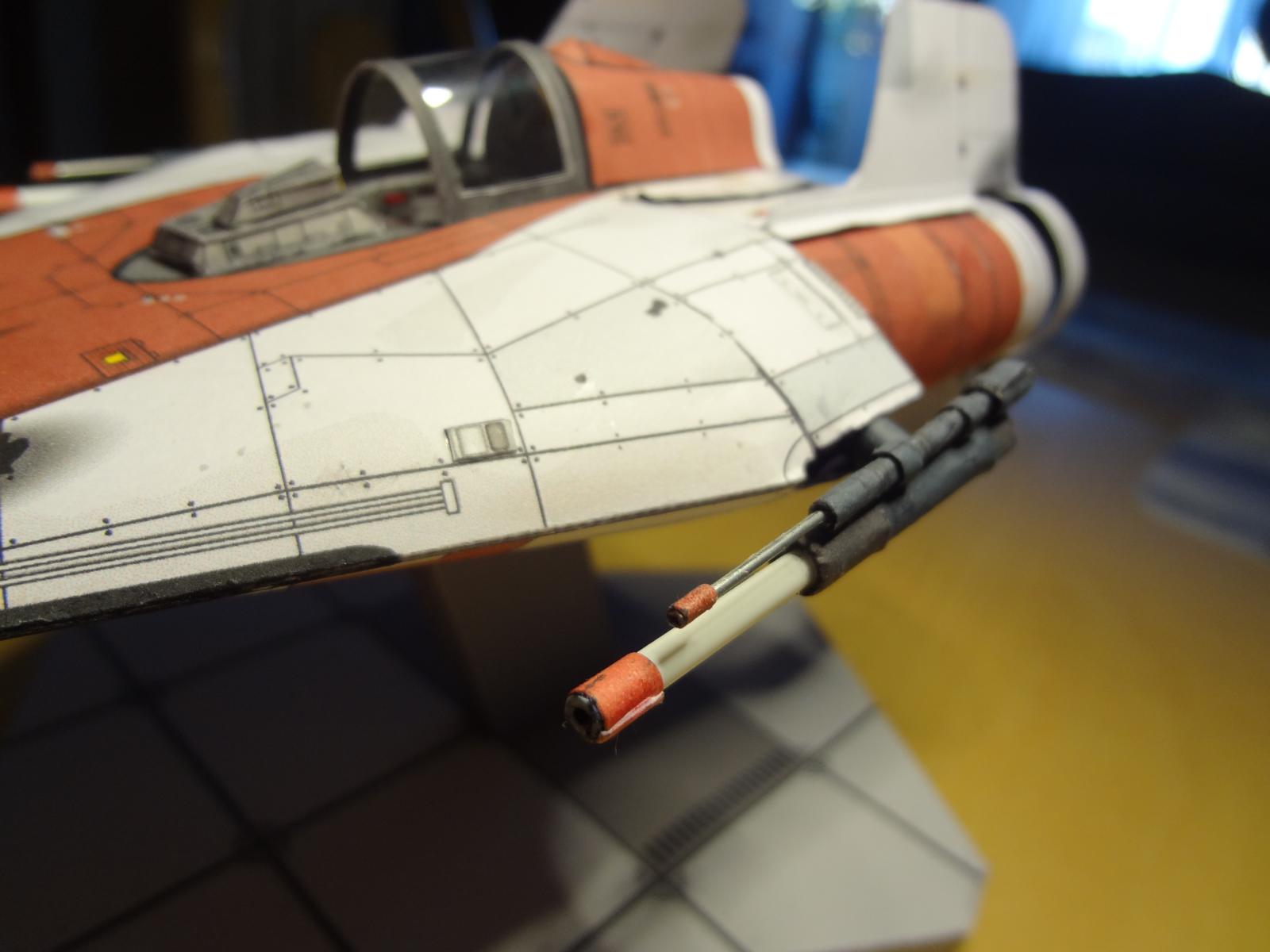

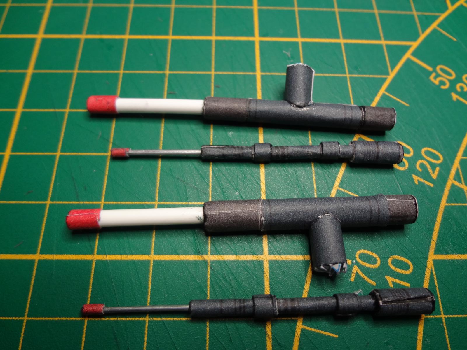

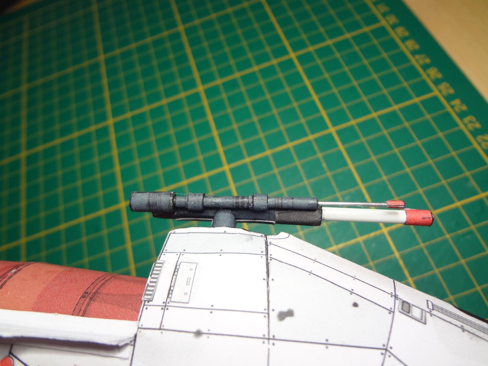

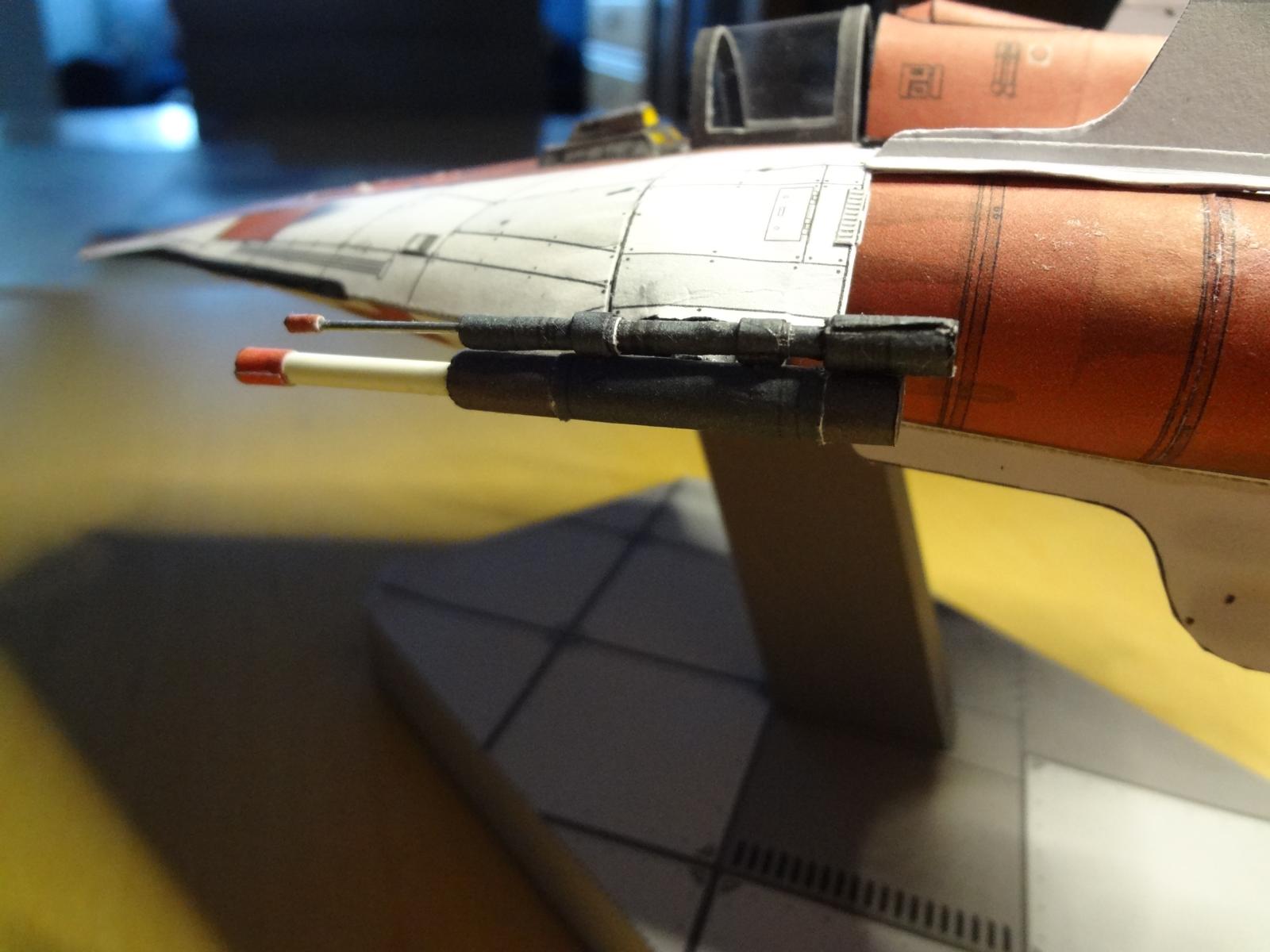

A little Greebling and the ship's cannons (very fiddly).

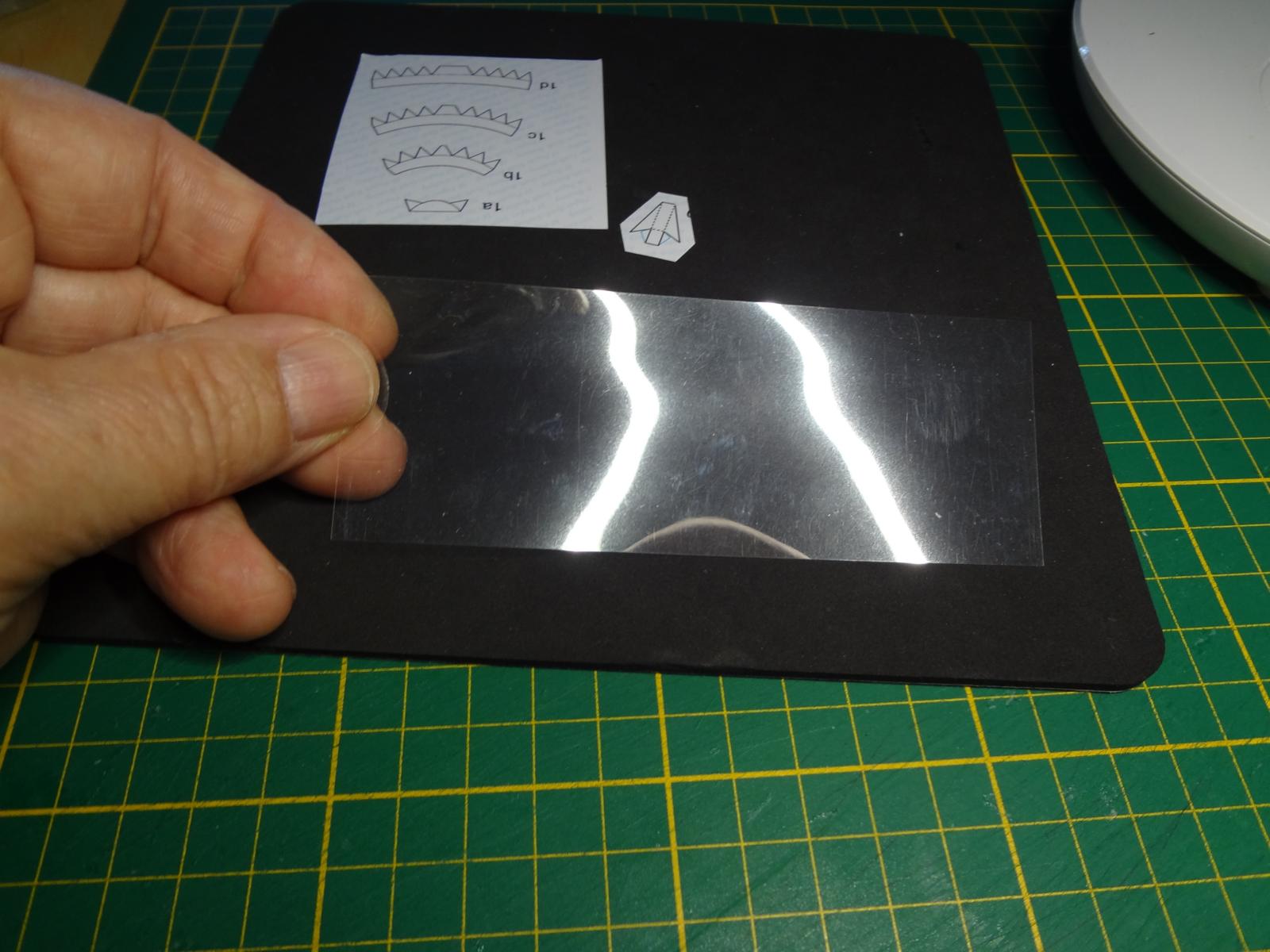

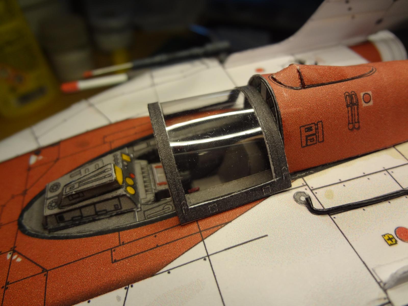

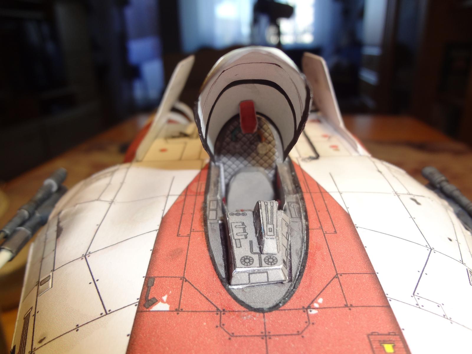

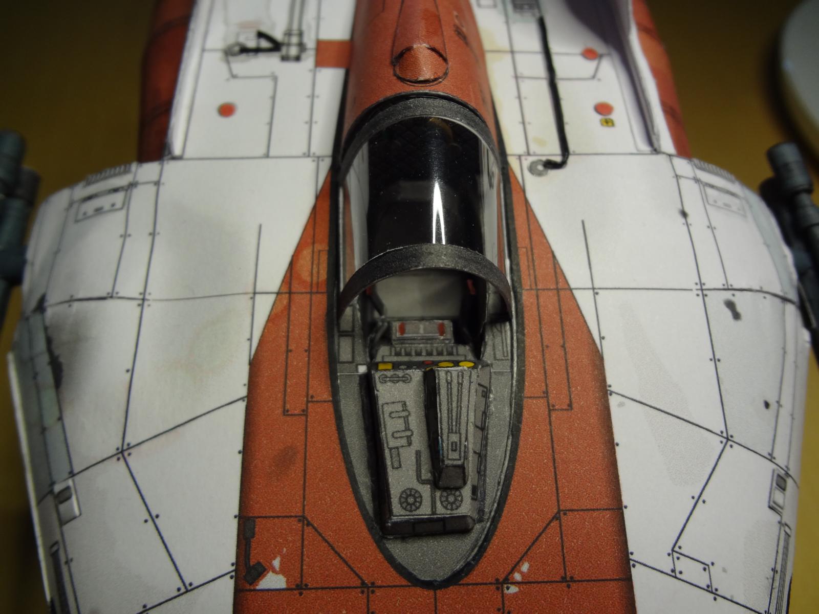

Now all that's missing is the cockpit canopy. I will try to build it using transparent plastic film.

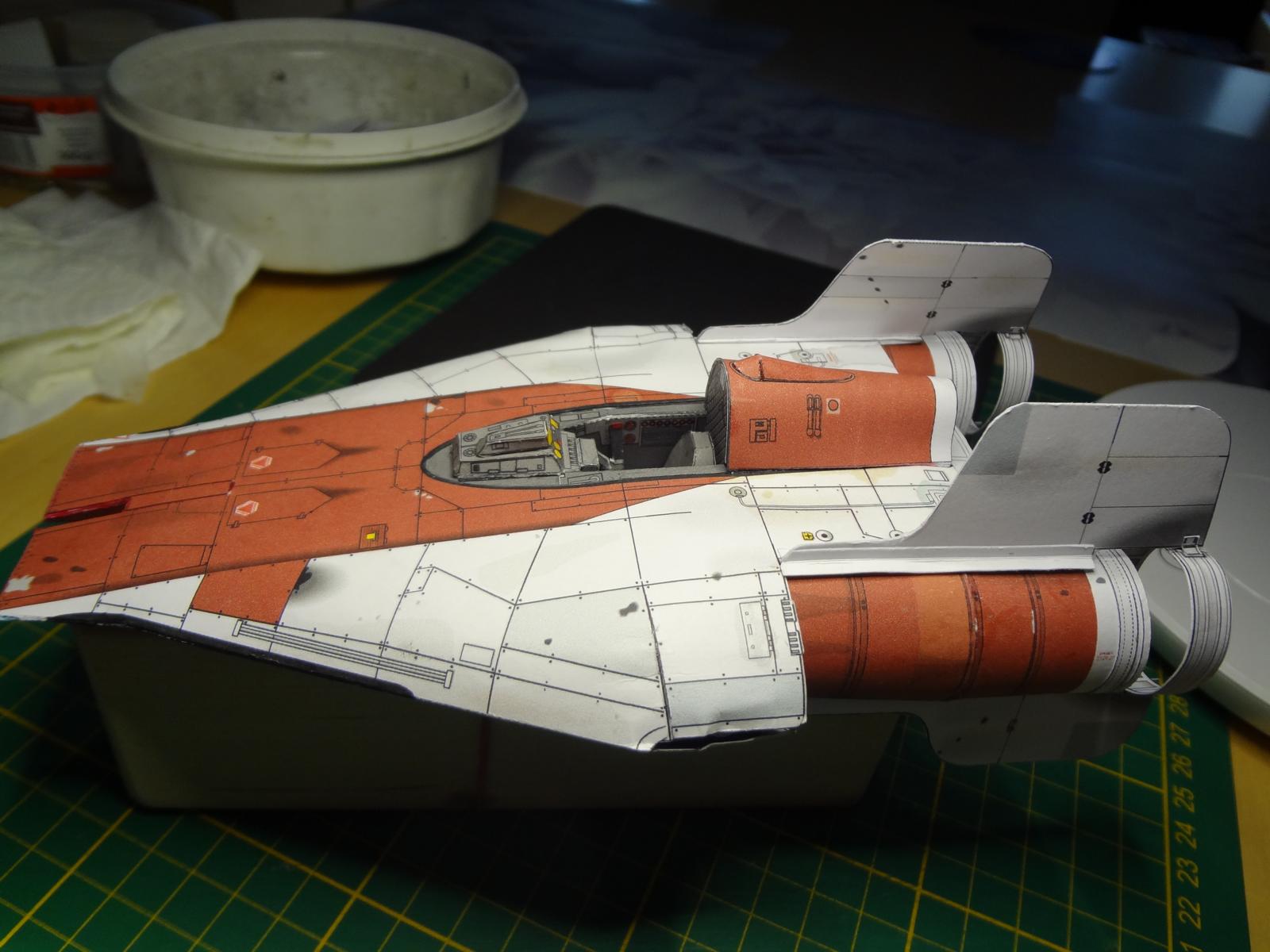

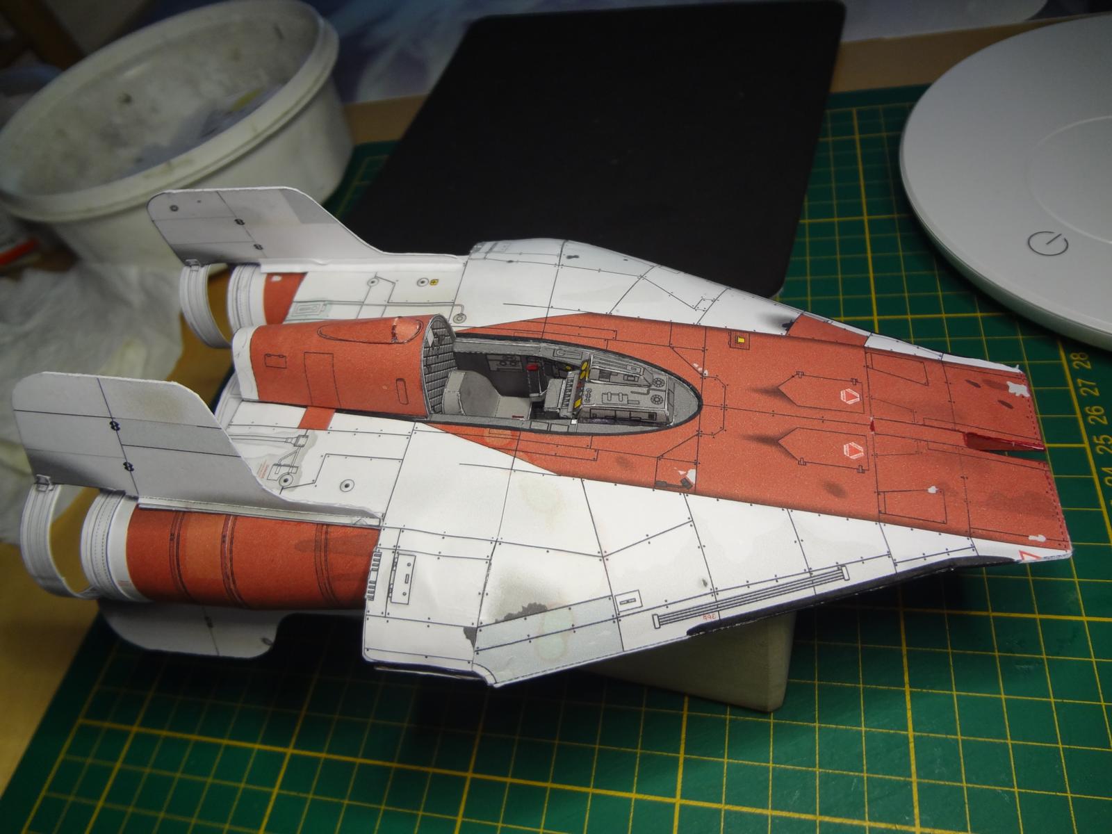

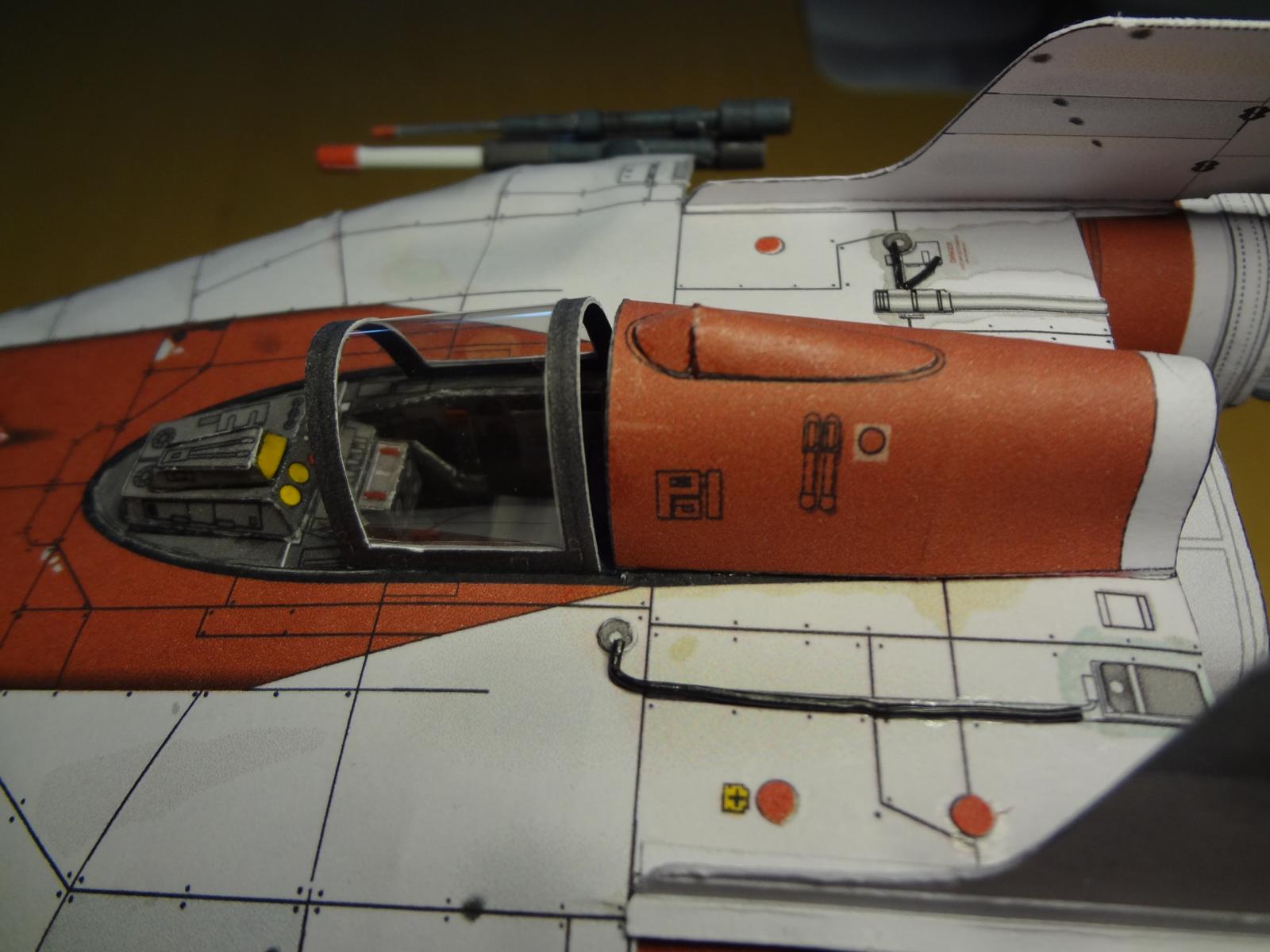

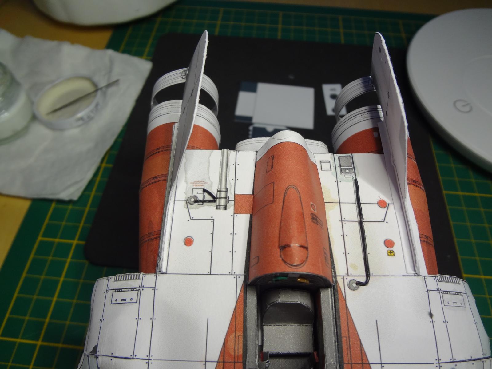

I never noticed how much greelin' could be done o this model. The fuselage is extremely straight and true. Lookin' real good. :)

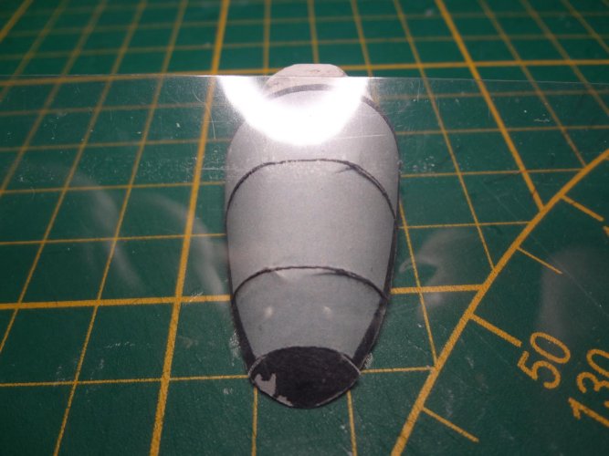

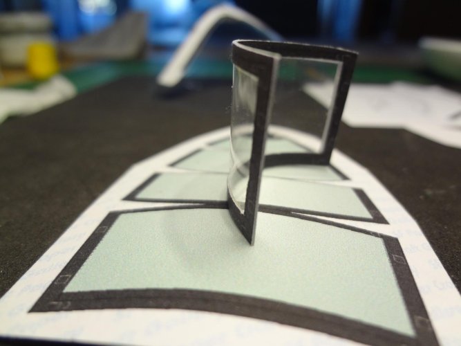

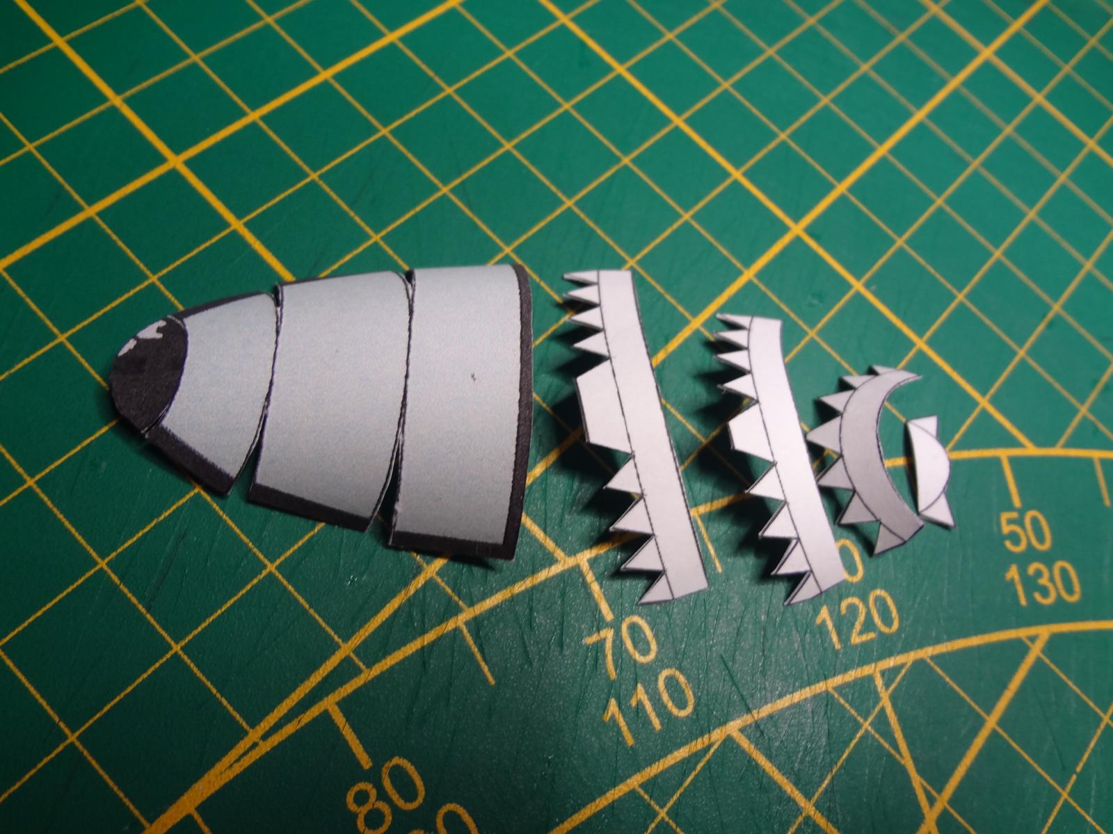

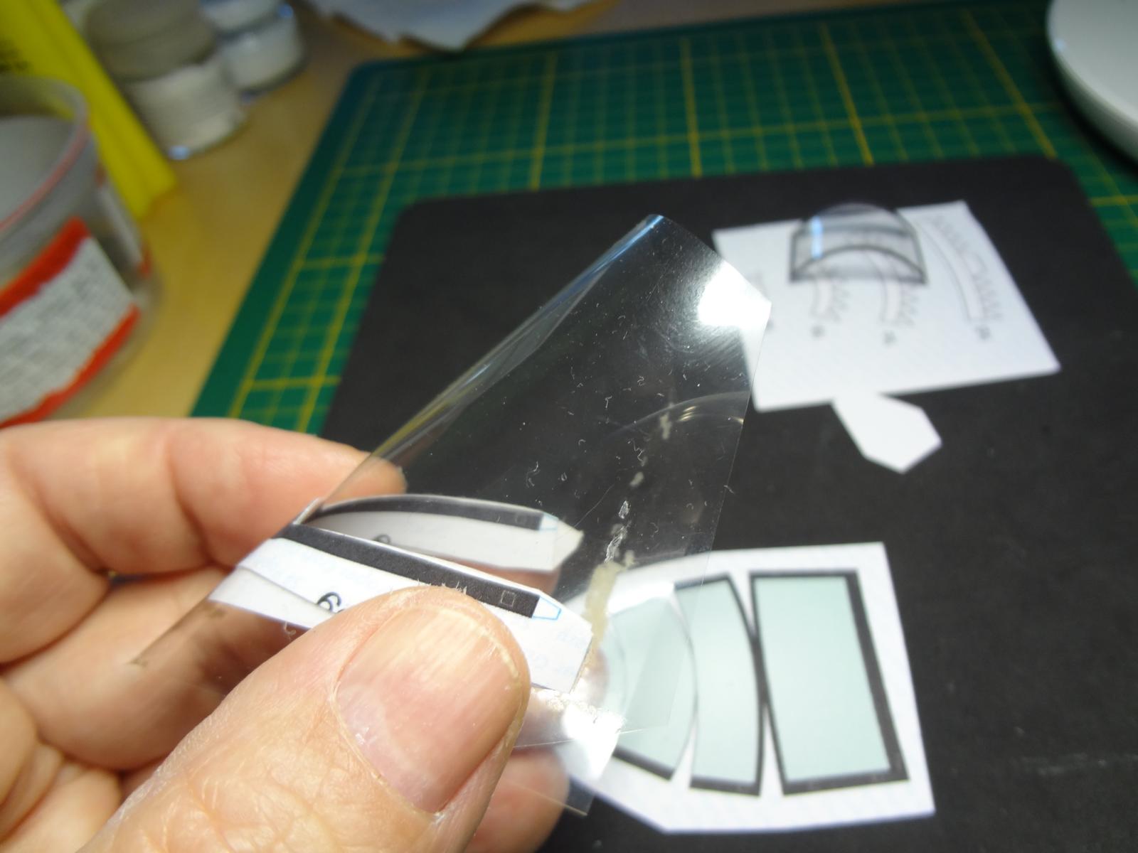

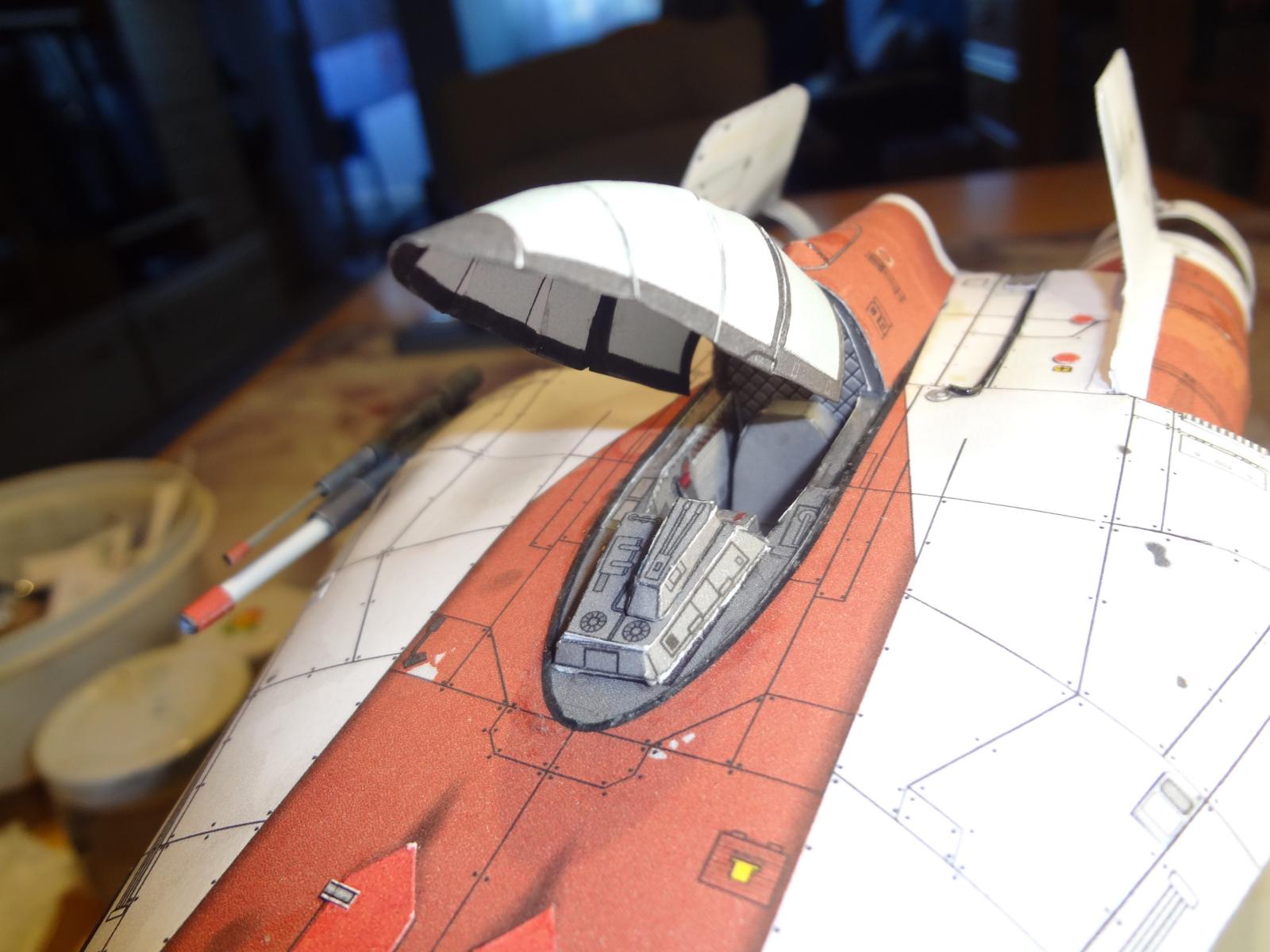

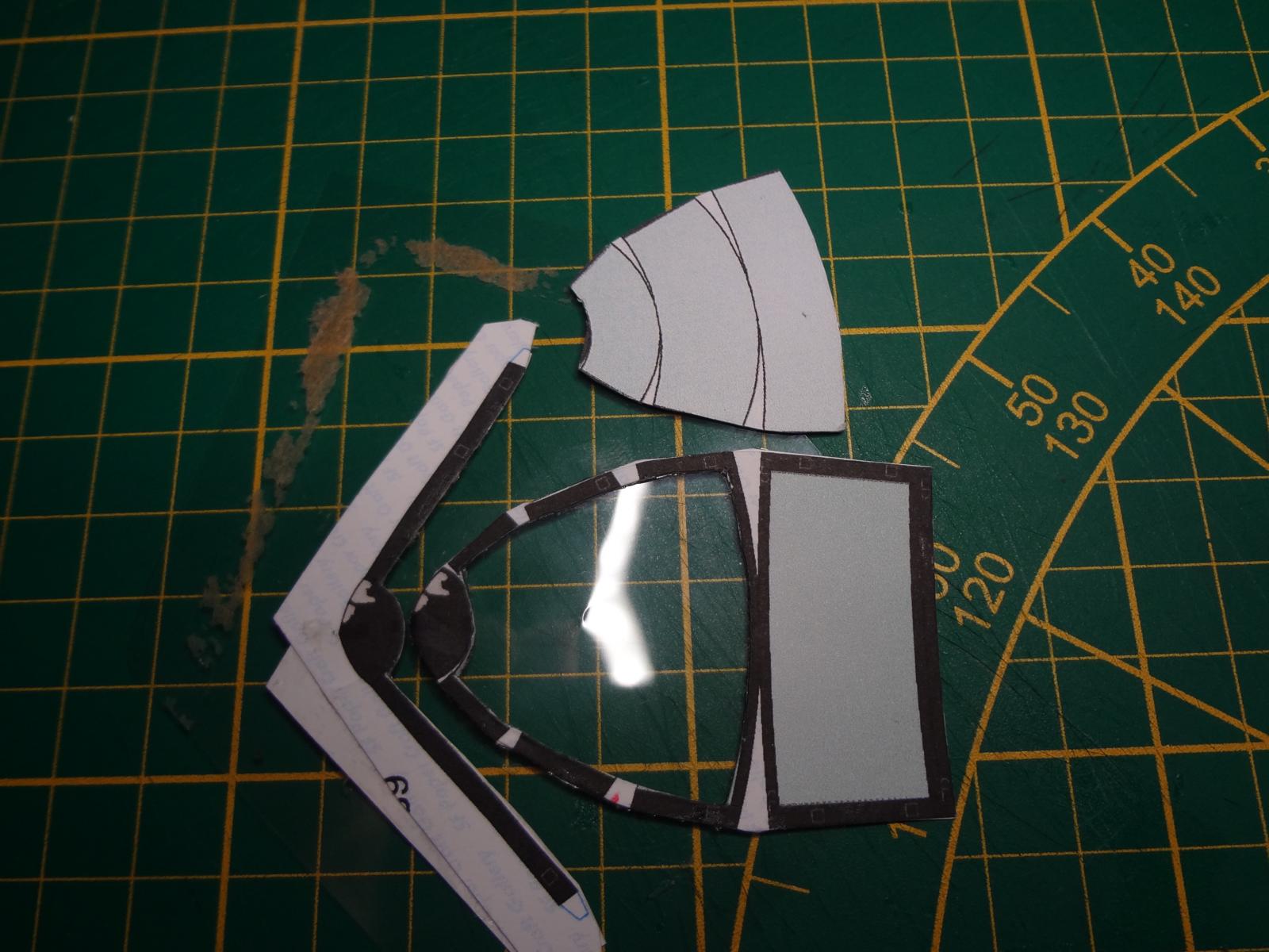

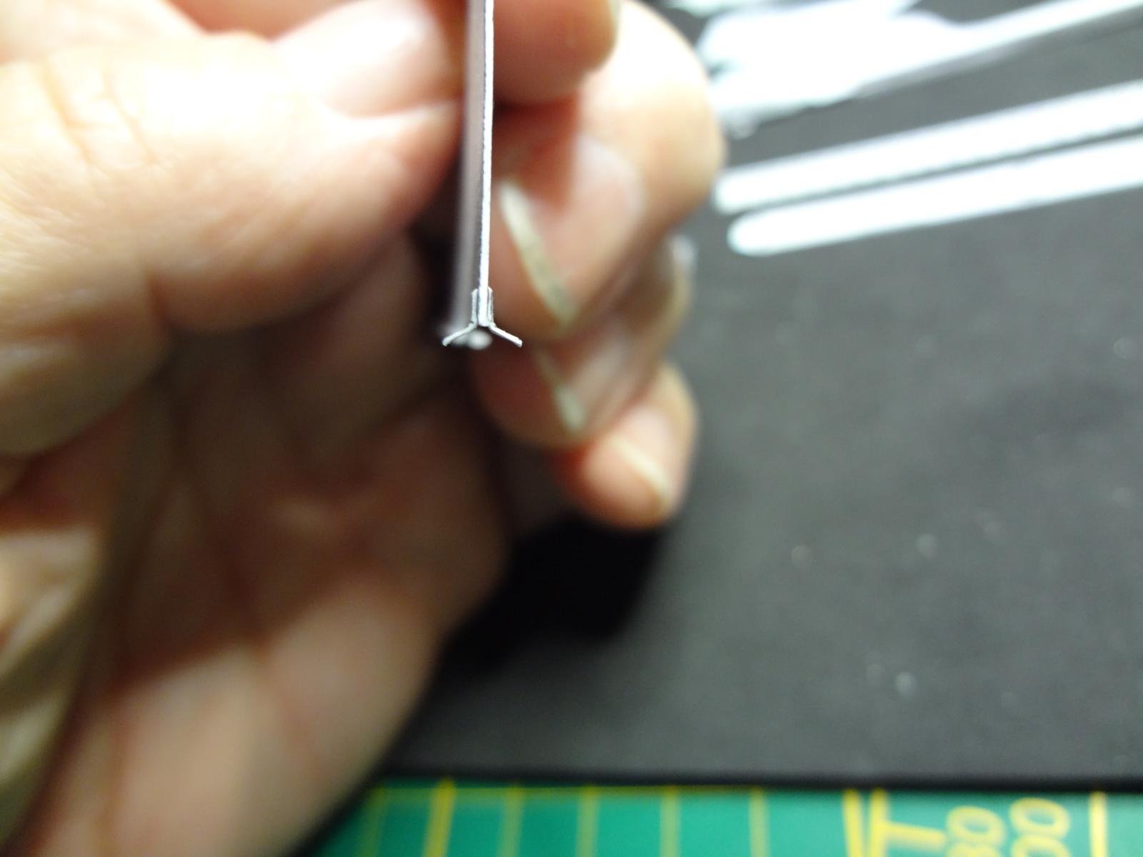

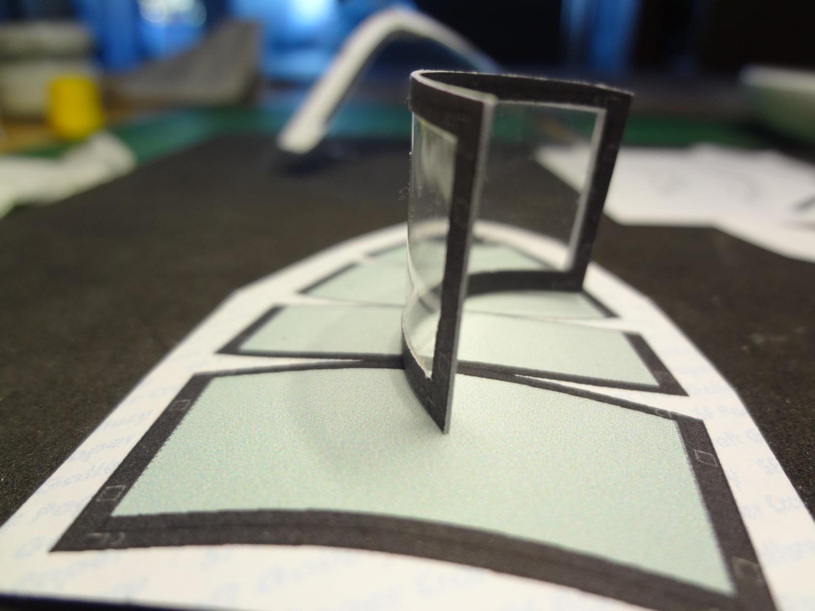

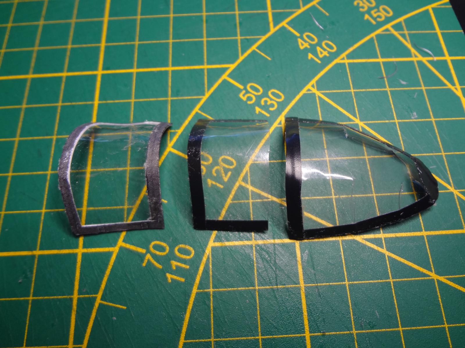

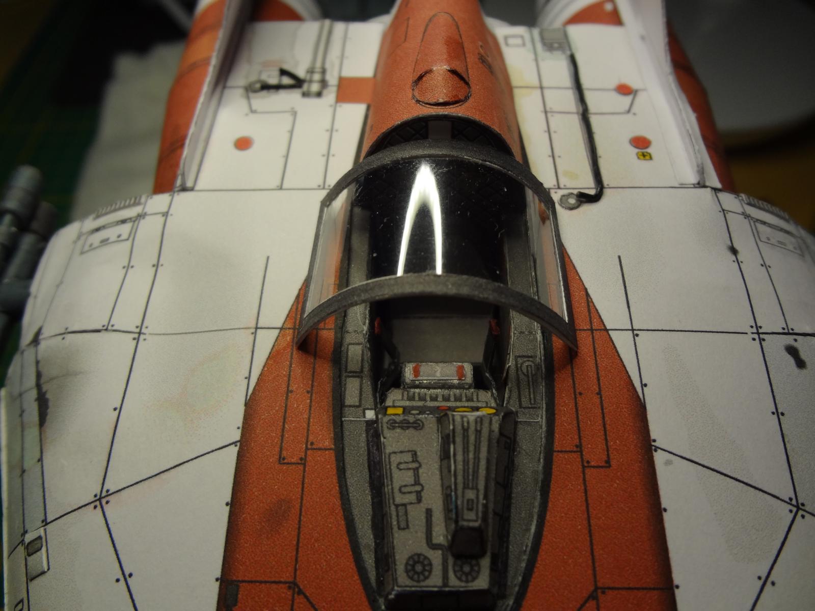

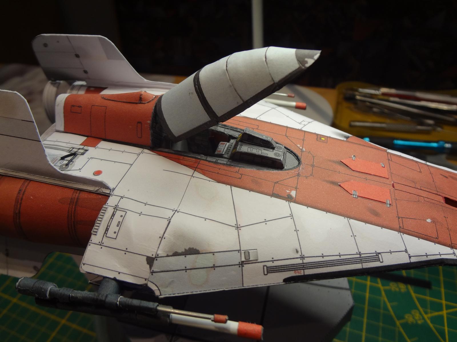

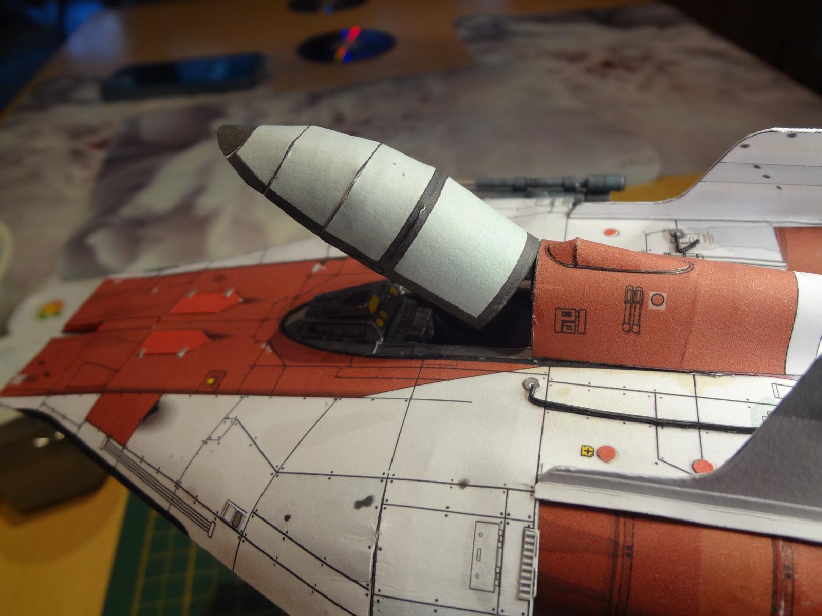

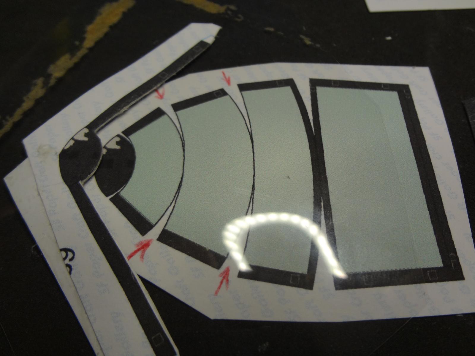

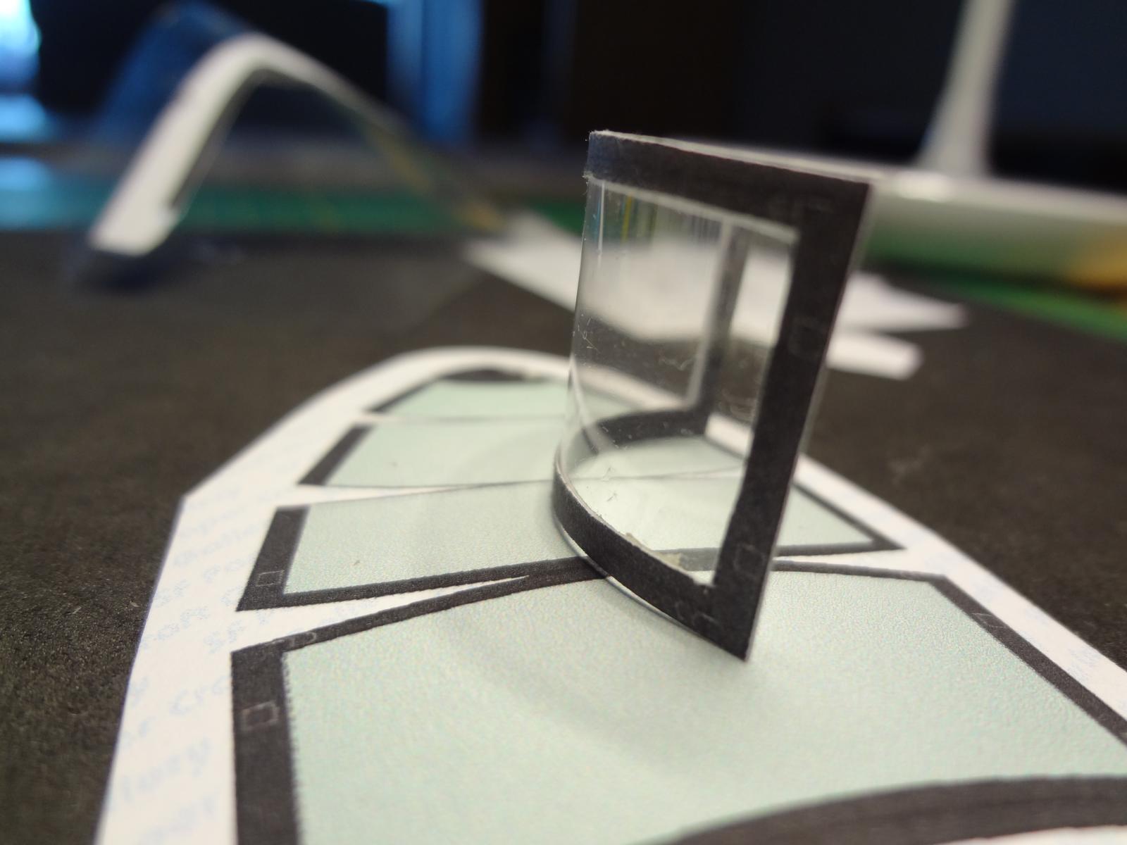

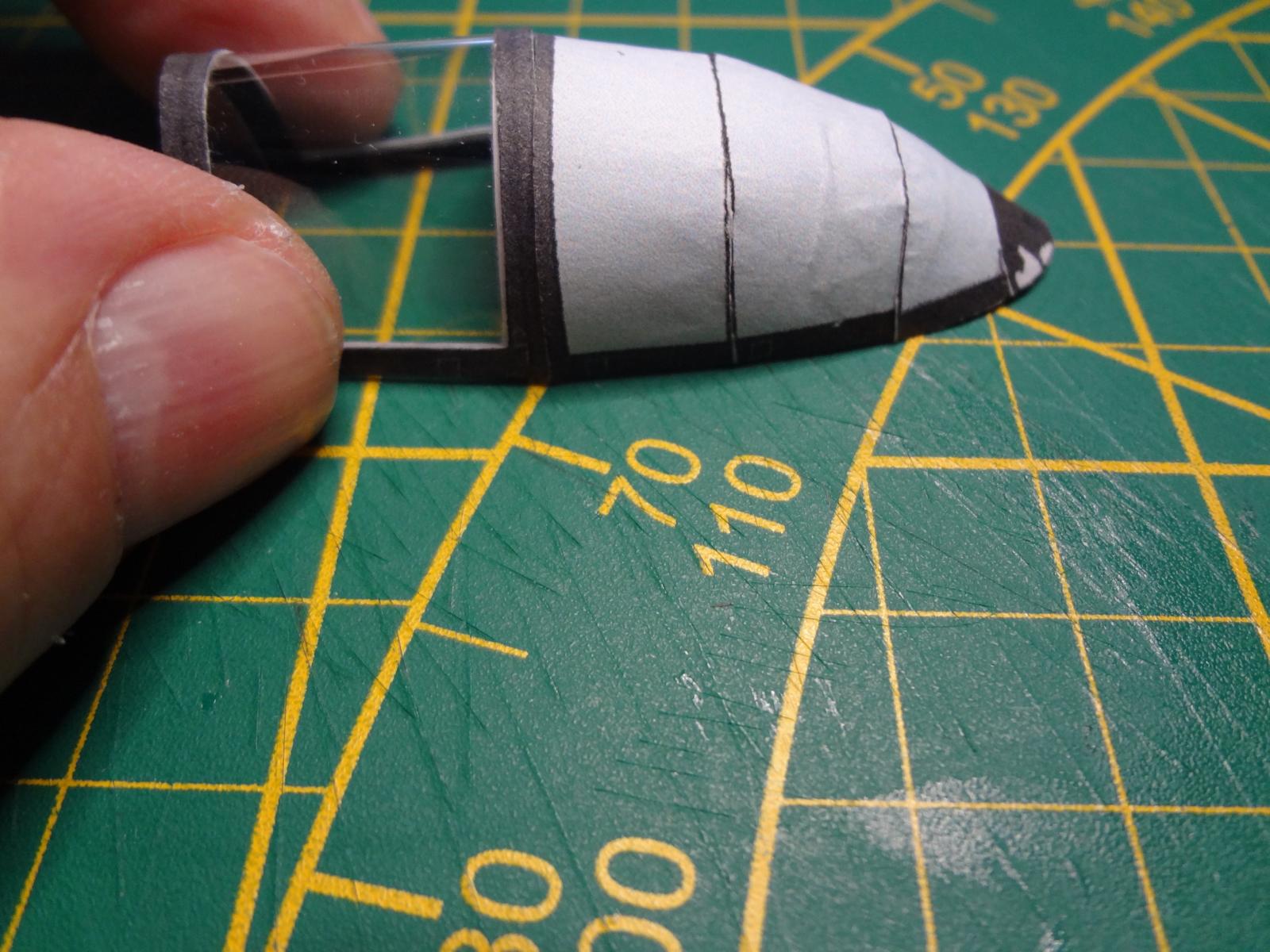

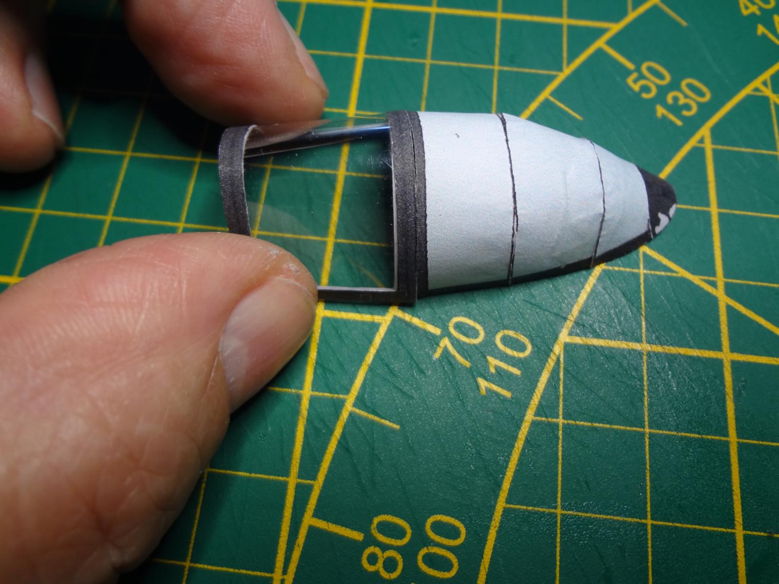

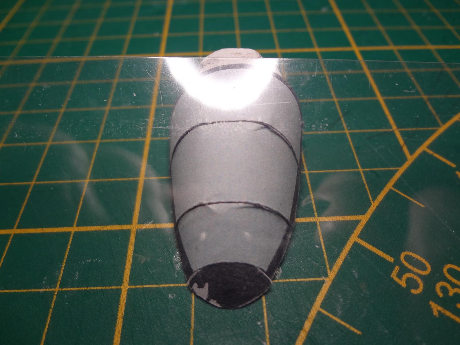

First attempts with the hood. The rear part works perfectly (bend is not yet finished).
The front part does not work in the same way because the curvature does not cooperate.

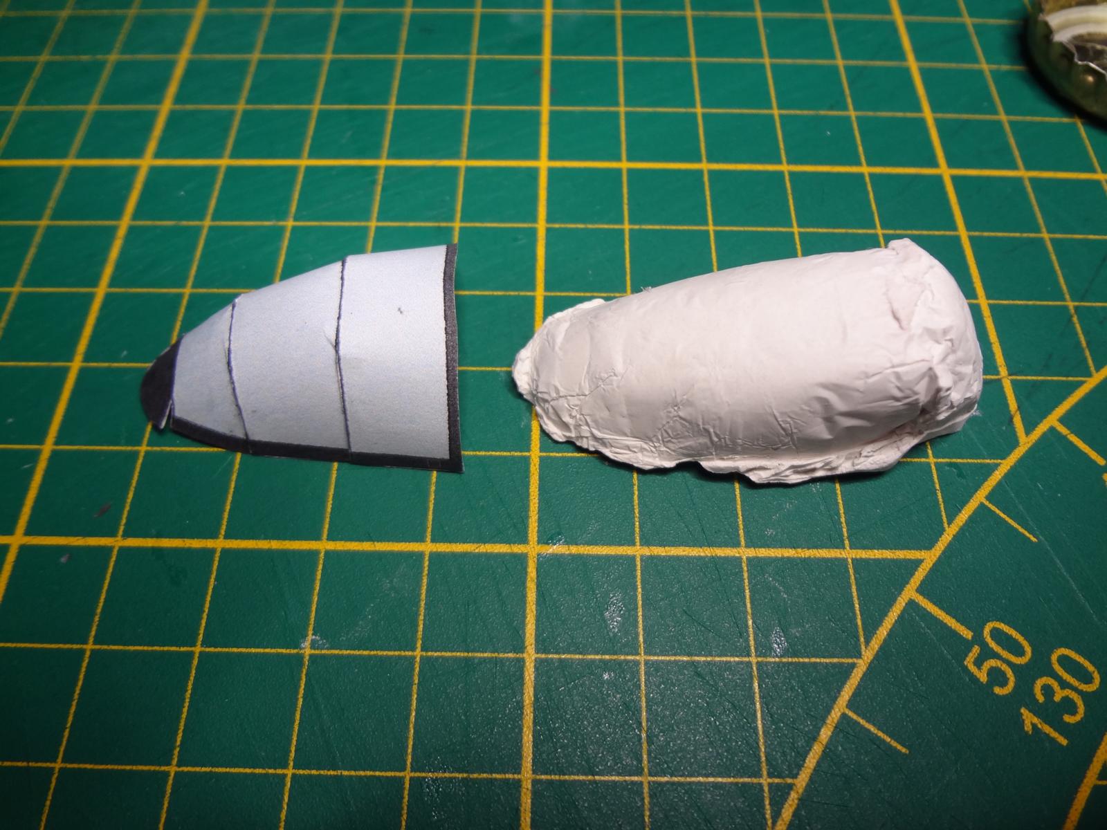

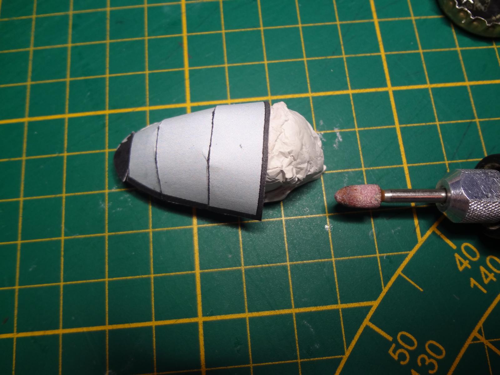

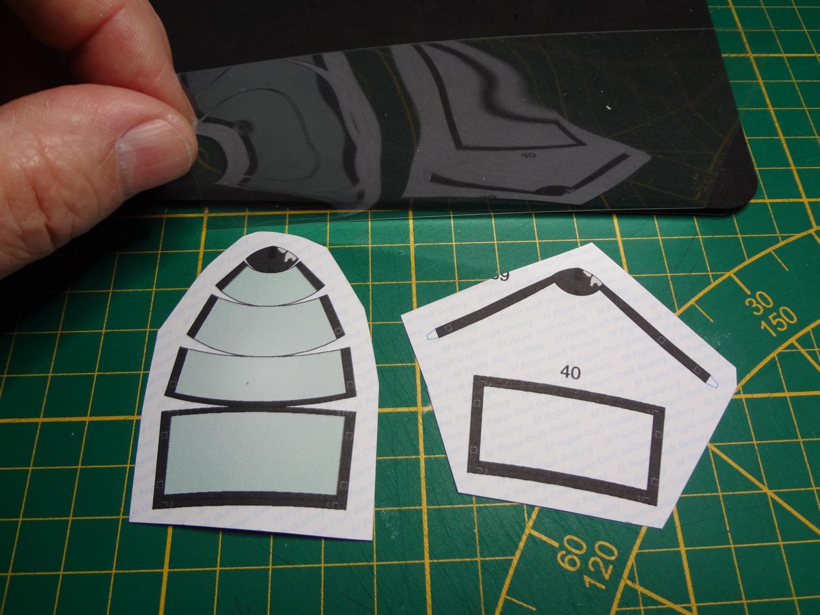

Therefore, I cut out the blue part from the original, placed it underneath, and transferred the cut lines to the foil. However, this means I have to add two additional bridges, otherwise I won't be able to glue it. I don't see any other option except making a plaster cast of the original and trying to bend it with a hair dryer, but that probably won't work.
Unfortunately, I forgot to blacken the inner edge.:realmad:

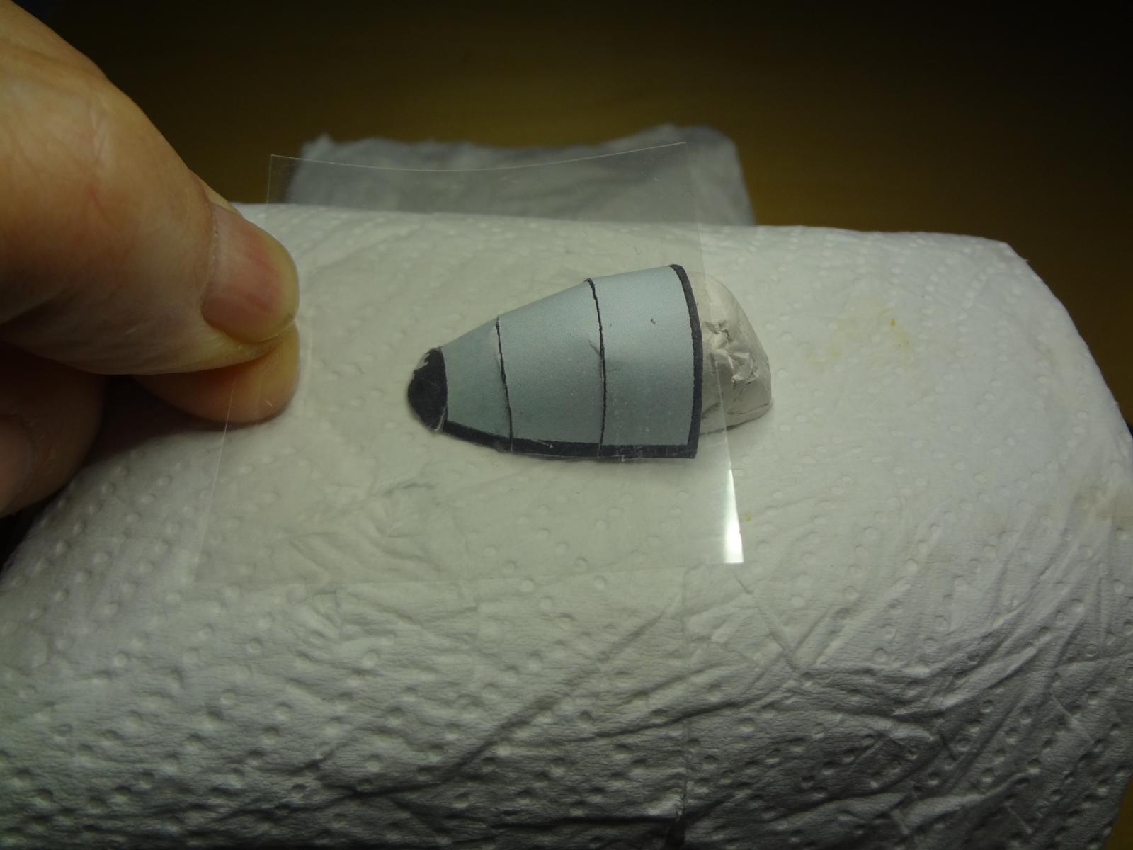

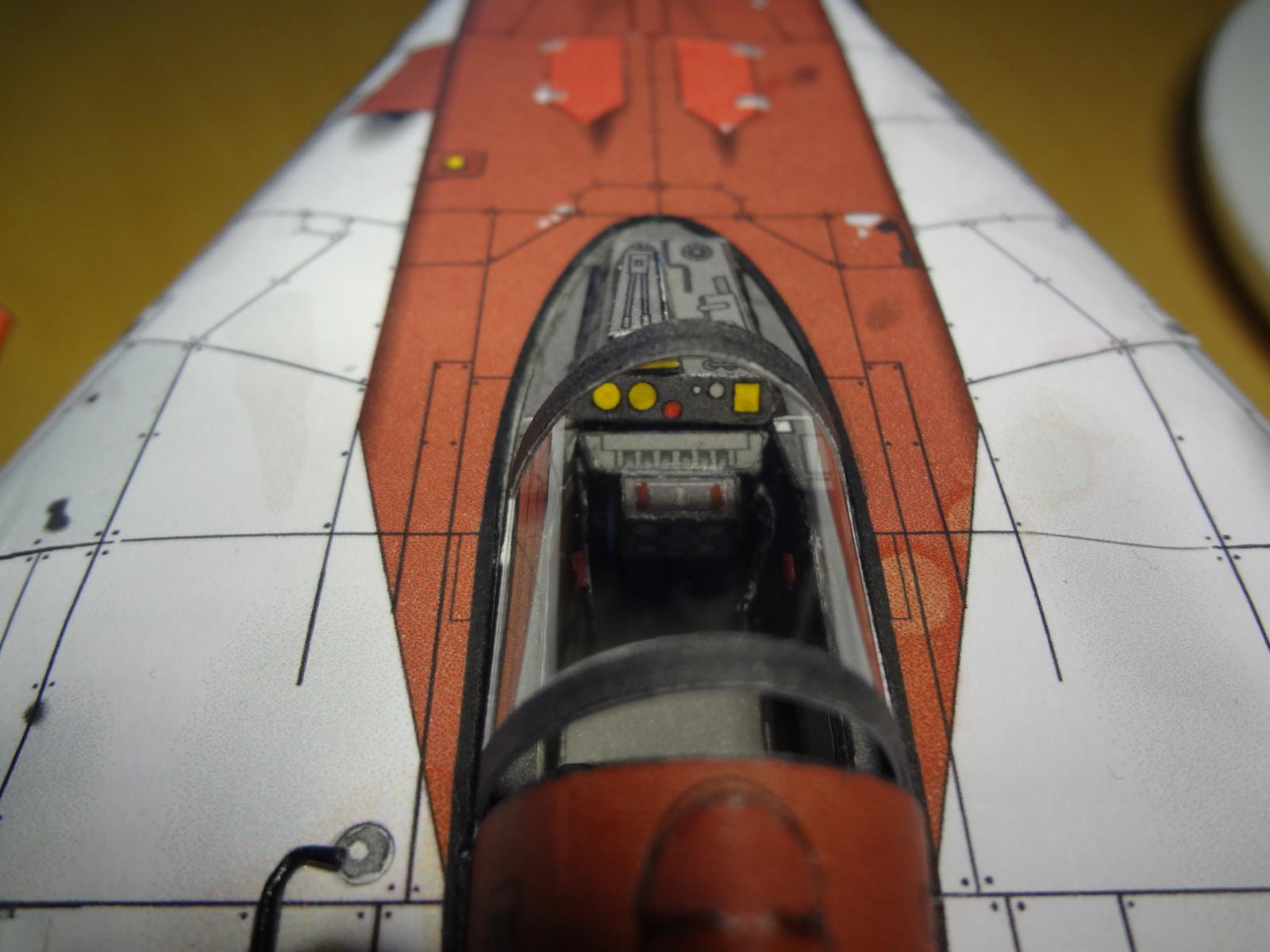

Heat works well for any plastic sheets to turn into a windshield, but you have to make a buck to pull it over. The paper windshield can be filled with foam and used as a buck. As far as the paper, you can moisten from the back side where you need it to contour and get the compound curves you need. A large moist sponge works best. ;)

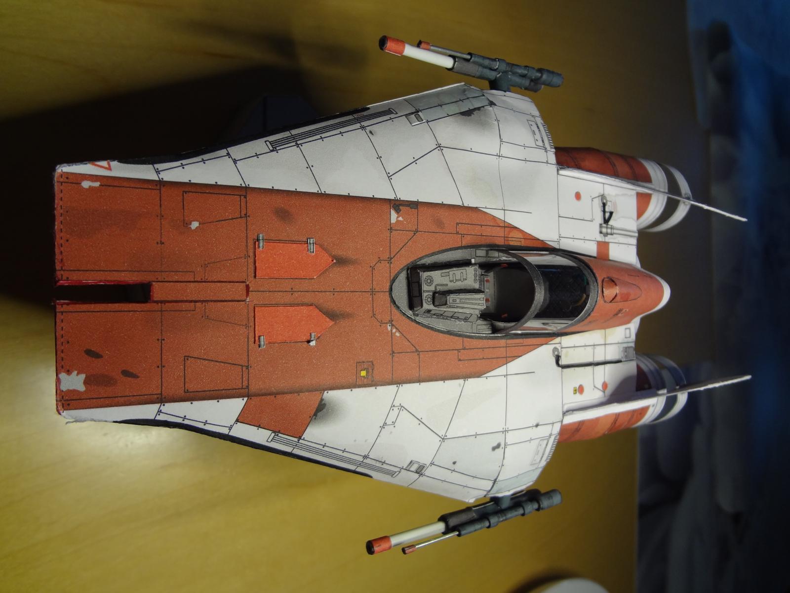

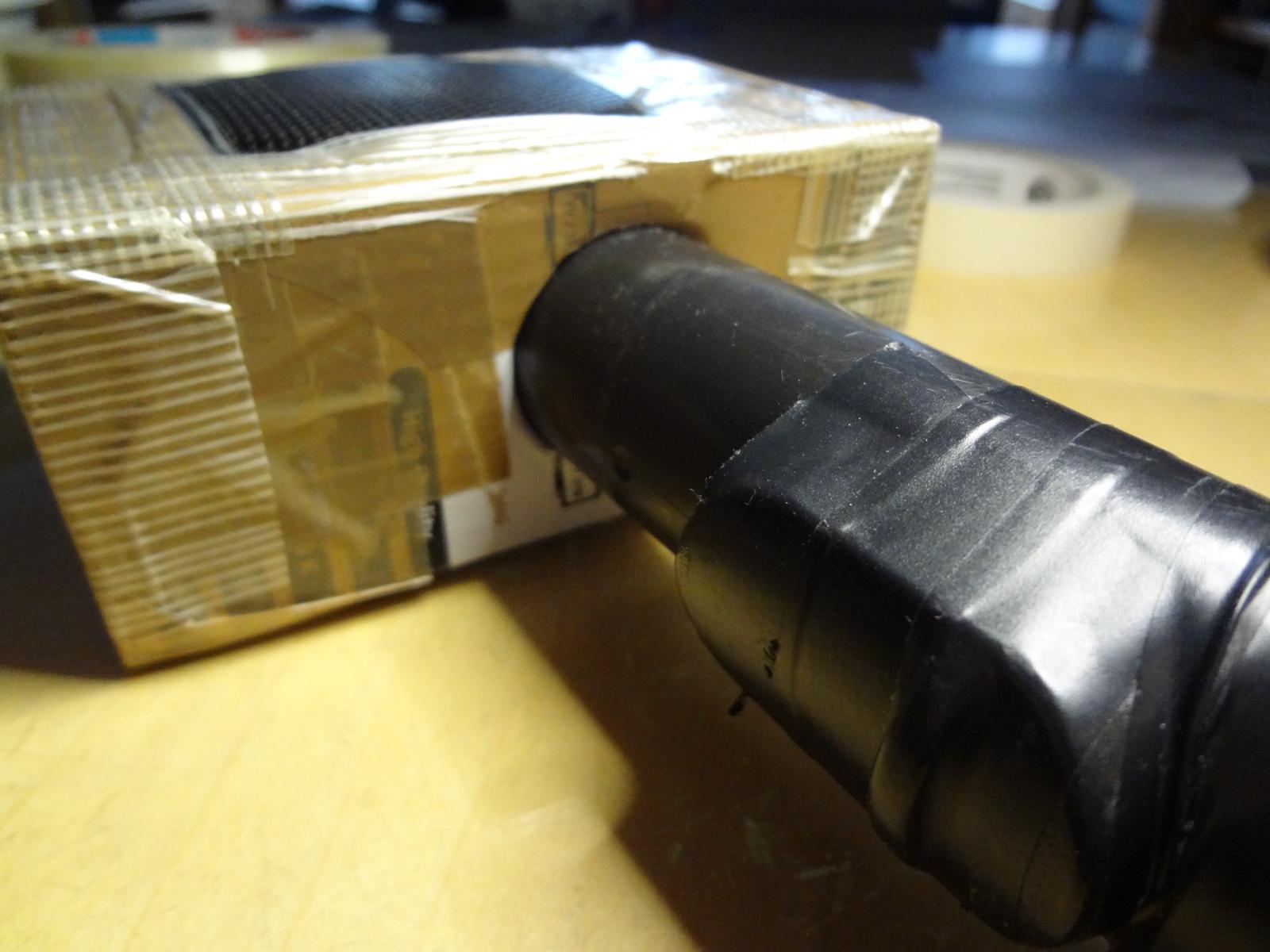

The A-wing is finished except for the front part of the hood. I tried to shape the plastic using a plaster mold and a hair dryer, but it didn't work; the plastic didn't even get properly warm. I'll probably build a thermoforming device out of wood (not that difficult), which has a connection for a vacuum cleaner that can be used to suck out the air and allow the hot plastic (heated in the oven) to settle over the mold. When I build it, I'll post the instructions (thanks to Raven Blaack for the link).
That's all I can do for now, but I'm happy with the model.

If you have a gas stove top, you hold the piece over that with some tongs, I guarantee you that it will soften into a sheet of plastic that, if you could take it, you could pull over your face and get the shape.. Never do that as the burn might make the plastic a permanent fixture on you. The other way is using a non stick pan, or making a 1/2" wooden frame, tacking the plastic sheet over it, stick if in the oven at 350F and the second the center of the plastic starts to drop, pull it out and pull it over the plug, using oven mits.
Paper burns at Fahrenheit 451F (Great movie Montag), so there is danger of fire, and you are watching it continuously. you preheat the oven. ;)
YouTube doesn't seem to be allowing video clips to be shared anymore, can't share video clips of the movie. :(

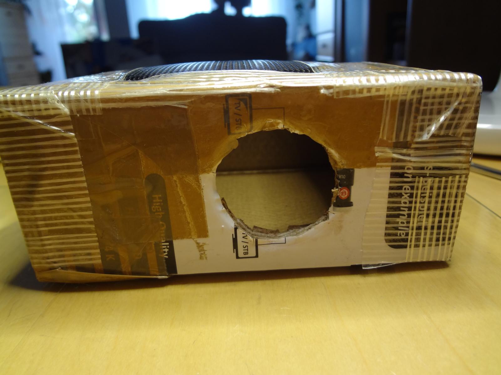

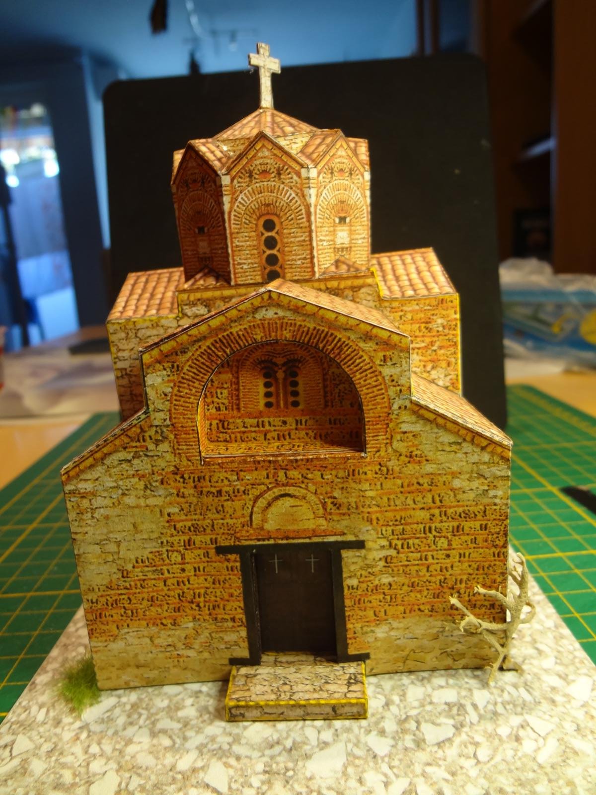

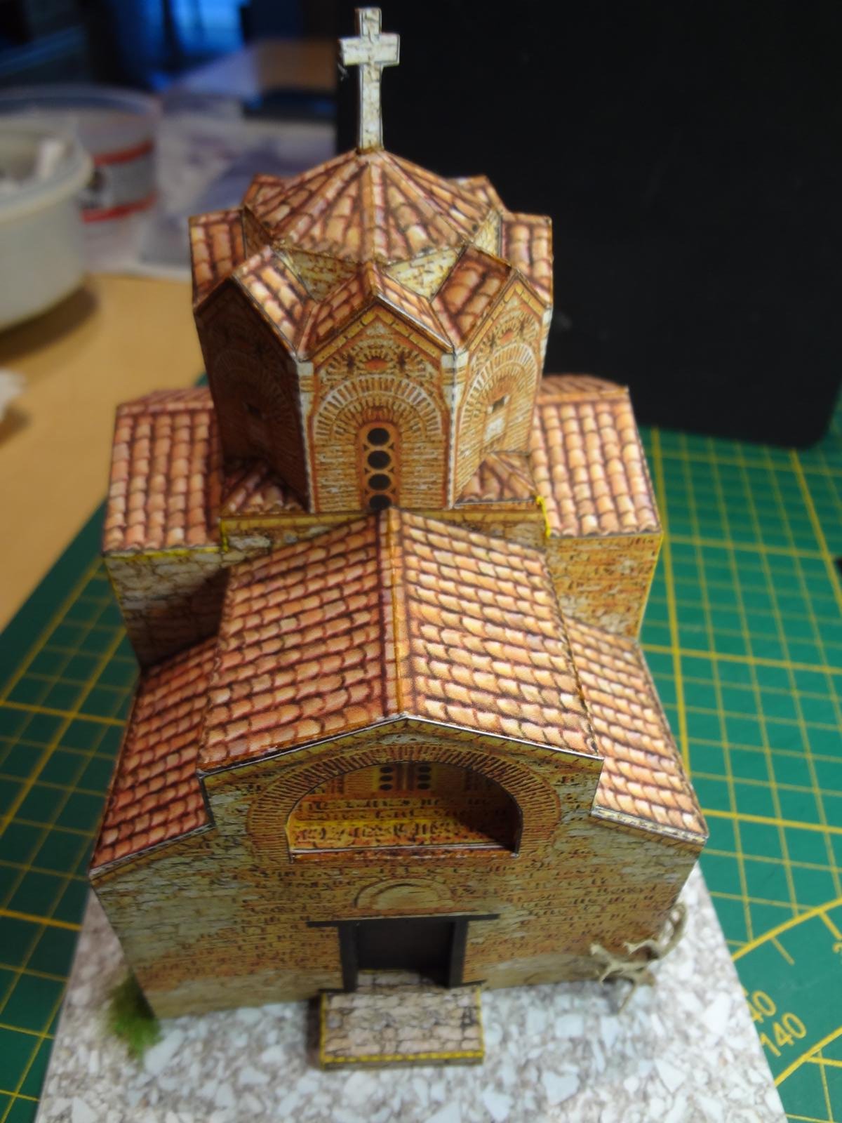

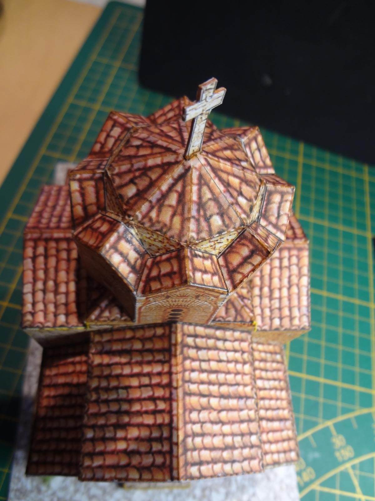

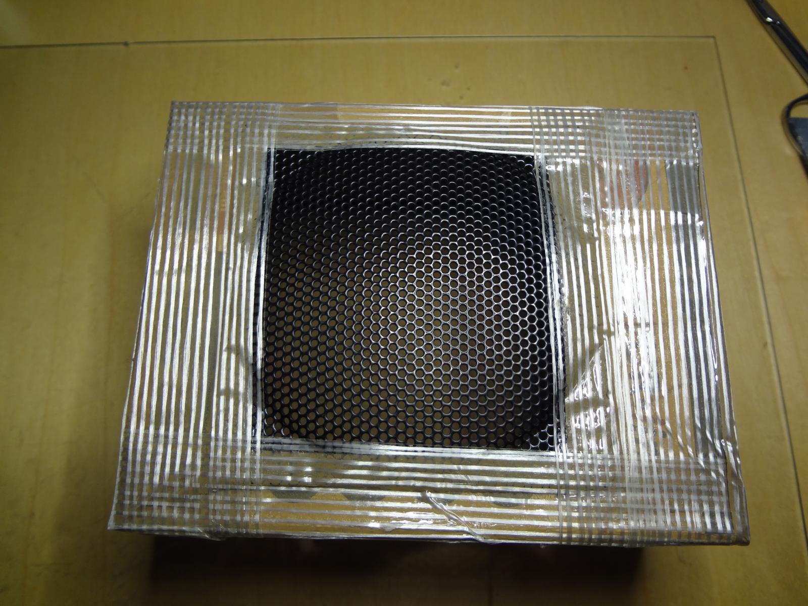

I built a thermoforming device out of a sturdy box, and it works perfectly. Unfortunately, my plaster mold wasn't the right material for the job, and the plastic didn't turn out very clear. I then tried the traditional method, but ended up with too many glue stains. So I decided to use the original hood “for now” until I can make a suitable mold.

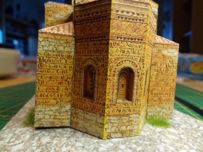

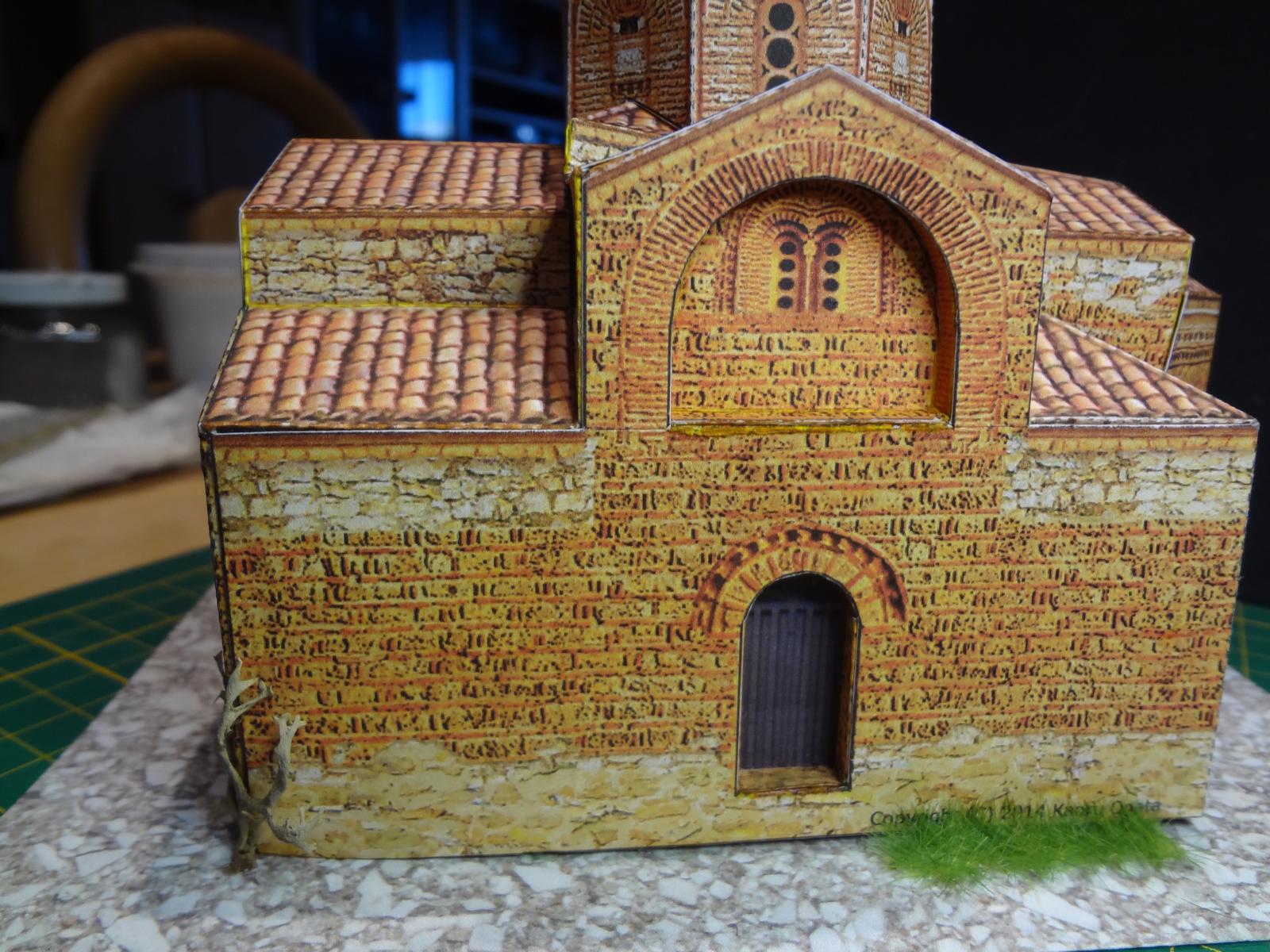

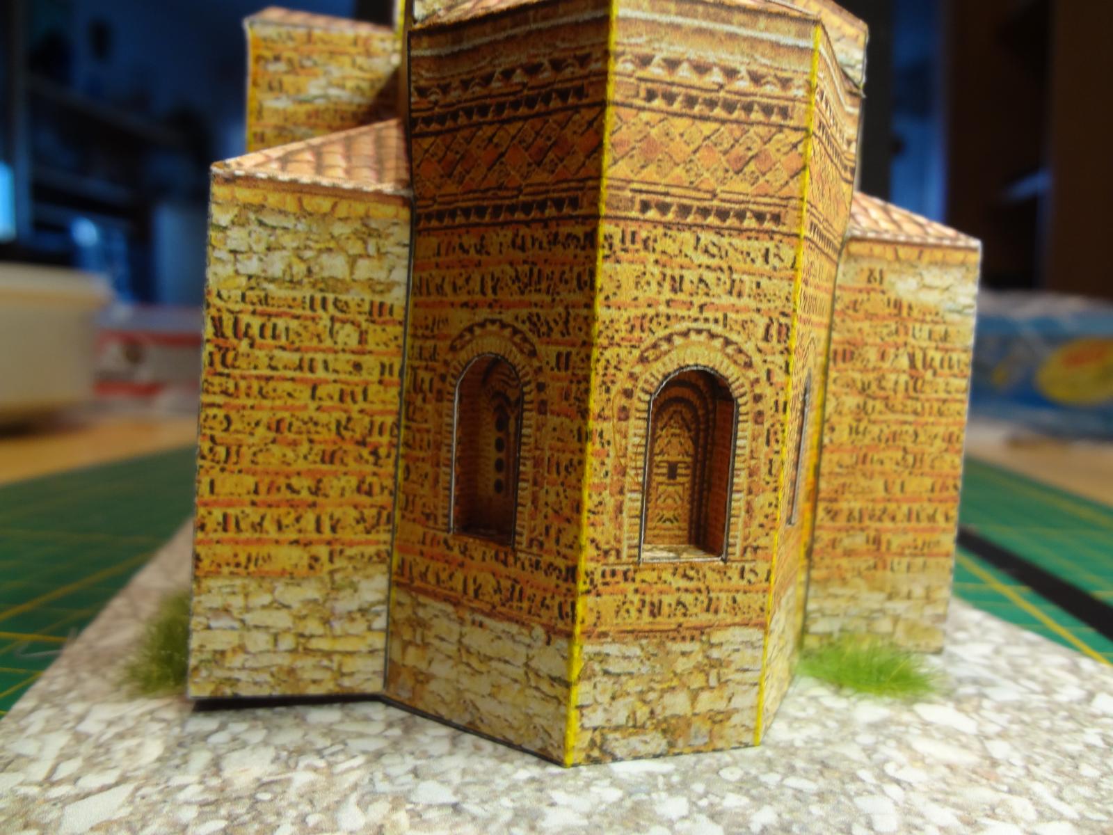

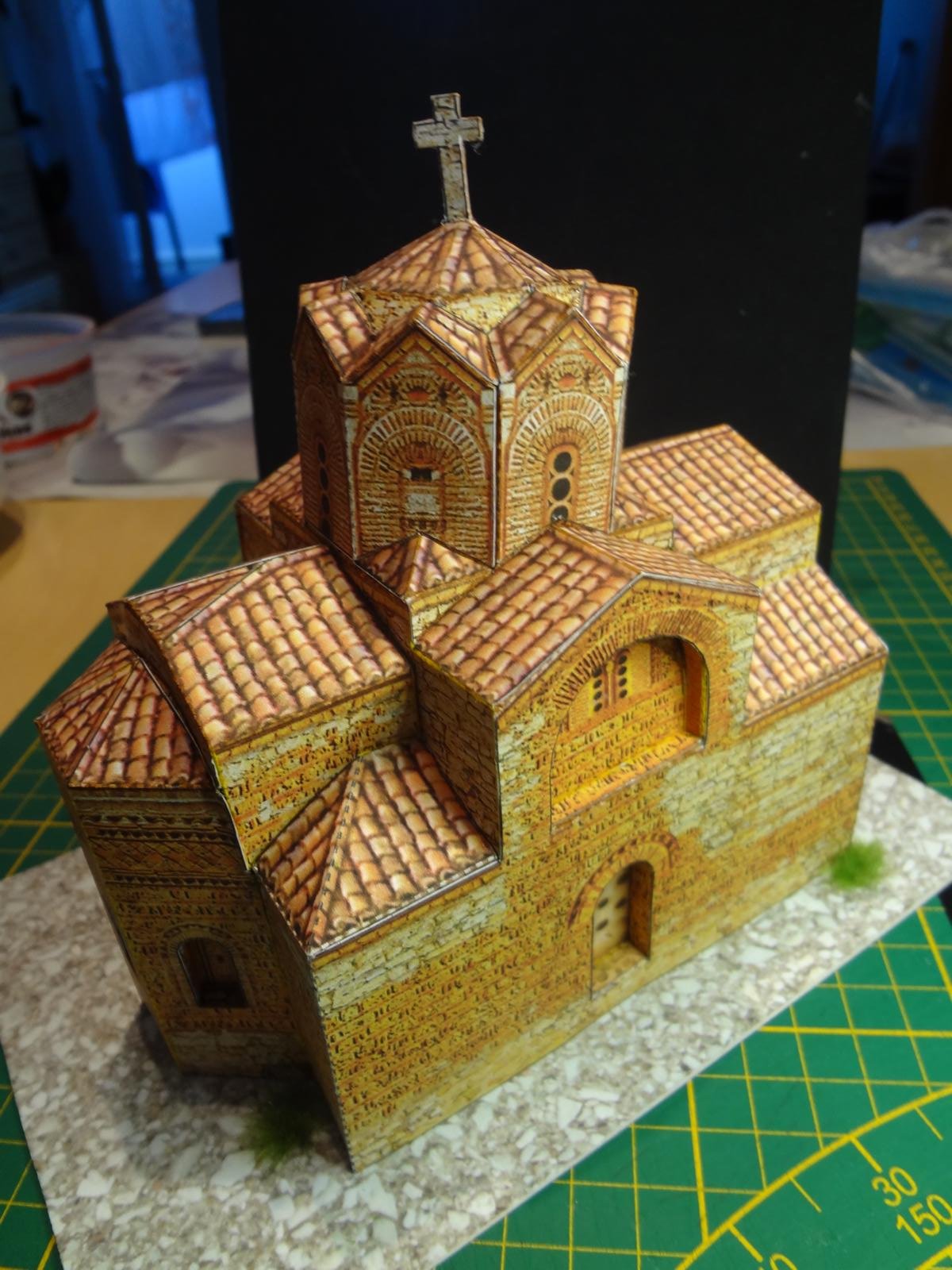

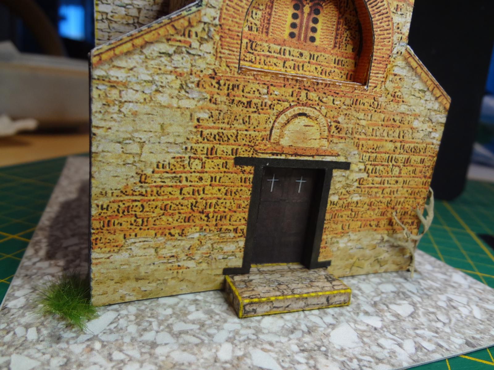

As a way to relax, I built a church from Macedonia (Church of Saint Jovan Kaneo) on the side.

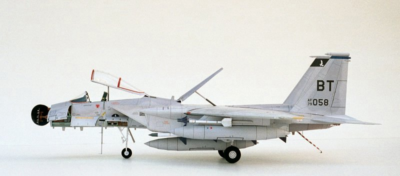

My next project will be either the Narcissus Shuttle or an F-15C Eagle with a technical interior view.
