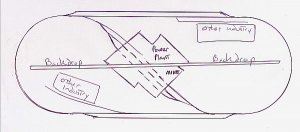

Guys,I am helping a very good friend design a N Scale layout on a 36" x72" hollow core door and as of now we are stumped and need help.
The wants.
1.A small 3-4 track yard.
2.A Small town area with 2-3 industries.
3.A power plant /mine loads in/empties out.
The first two is the easy part #3 is where we are stumped.
The givens.He would like not to have any steep grades and prefers to have no grades.
My thoughts is to have a Mountain on one end with the mine at one end and the power plant at the other with the main line passing behind the mountain while 2 hidden tracks connect the power plant and mine.
Any suggestions,ideas or plans is quite welcome.
How about a backdrop running along the length of the layout down the middle? Position the mine and power plant on opposit sides of the backdrop at an angle so a siding can angle toward the center of the layout, pass through the back drop and both industries, and then connect with the main on the other side. It'll likely need to be a reverse loop I'd guess to maximize the space....
Ralph
Ralph
you'll want two such sidings. One as 'load in' the other as 'load out'. I'd go one better than that though: in addition to the (cut out) backdrops, build out buildings on either side to give some depth for a load to be backed in at each side.

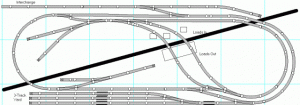

Good point SS. I'm imagining something like this....
A scenic divider down the center improves most possibilities. It is better if the divider physically divides the layout in half. The open ends tends to produce strange scenic problems.
The track going diagnally across the middle is a loads-in/empties-out track. That is 4x8 in HO.

This is a 27"x60" plan, which could easily be stretched for your door , or your could take the two tracks at the top and turn them into a huge yard. I should be able to modify this track and give you something by tomorrow:

Brakie, 3' will have an 18 inch radius hanging over the edge on both sides. To get an 18 inch minimum radius he will need at least 40 inches to allow an inch on each side of the track between the track and the edge. Second question, will the Sd70macs negotiate an 18 inch radius with cars in tow without derailing either the locomotive or the car immediately behind?
Personally, I would add a cross-over at the upper right corner. This will shorten the run-around distance for working either the yard or the industrial area at the top, and keep the switching more or less confined to a given side of the layout.
In my case, I might also seriously consider a single track LI/EO reversing section instread of the 2 track version you have shown. Harold's web site shows you how to switch/operate the single track version.
Otherwise, the layout is good enough that I'm considering recommending it to my father who is switching to an N scale door layout in his retirement home.
My 2 cents, YMMV.
yours in laying out
You are correct a crossover is needed by the industries and a engine escape for the yard and of course a mine on the other side of the divider.. :thumb: .
SS,Not bad..That layout is highly workable with some minor changes... :thumb:
