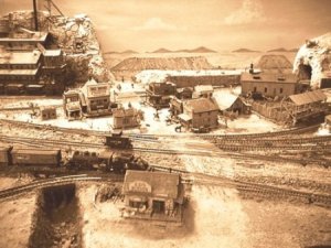

And at the other end of the main - Terlingua

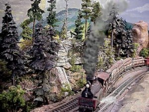

Guess I Can't Do That
Anyway, I guess it's one picture per post, but I thought I saw more in another post. That was Terlingua, here's my 250 ton "Shaymaxler" at the S.P. cutoff. Legend on the Edwards Logging lands are that this powerhouse can pull a one hundred foot Jack Pine out by the roots!

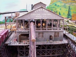

Gentlemen,
Thanks much for your encouraging words. Continuing up my first list here is the Edwards Sawmill #3. It's a Walthers kit-bash. I sawed the top off just above the window line, jacked it up and put an open sawing floor supported by beams. That was inspired by the "McCabe" mill HO kit.

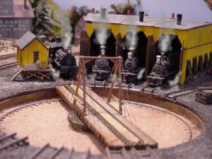

Alpine Roundhouse
This is the Alpine Roundhouse: scratch built with Evergreen styrene siding. The turntable is an "armstrong" scracthed from wood, plastic with a brass tubing "bearing". By the way these photo were taken by fellow modeler Marc Gast.

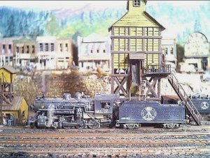

The Alpine Coaling Tower
A Bachmann 2-8-0 lettered for the A & T with "Rail Graphics" custom decals sits ready to take on a load of coal from a Bachmann Coaling Tower modified with a new roof and stairways. The picture does NOT do the decals justice. The A & T herald all "readable", even the lettering around the outside! They are excellent!

Trees & Shaymaxler
Grumbeast,
The trees are a mix of Kibri plastic pines "flocked" with Woodland Senics "grass" and W/S kit pines.
Ray,
The "Shaymaxler" is a scratched body over a GP-7 drive unit which makes one HUGE logging loco. The name, of course, comes from all 3 types of logging locos; the Shay, the Climax and the Heisler. It is a strictly mythical loco, but Aspen's Climax's are way over my budget! Small Scale Logistics makes non-operating bodies that fit over some trolley mechanism, maybe I'll do that one of these days. At N Scale Supply they are saying that, of all people, !Atlas! is going to release a N scale Shay - wonder what that will cost?:rolleyes:

Hi Cinibar!
Great stuff there my friend! I love that sawmill bash!:cool:

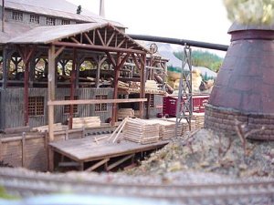

Edwards Sawmill #3
Thanks for the compliments gentlemen. And your 100% correct Tyson, Marc is darn handy with his digital.
That’s my “Art Work” on the backdrop Charlie. I bought one of those “How To Be An Artist in 10 Minutes” books and sort of followed along with that. I’ll tell you though these photo backdrops I see advertised are pretty tempting, they really look cool!
Here’s another shot by Marc. This is one of my favorites as the sawmill looks so big and seems to really justify rail service. The “burner” is cut from the top of a spray bottle I had laying around. I scribed it and put the screen top from the Walthers kit on it, the burner in the kit was too big.

The Shaymaxler
Thanks Ralph! The ol’ Shaymaxler normally collects a few chuckles when it roars out of the woods sounding like it’s going 120mph when in fact it’s top speed is about 15mph, it’s a geared loco of course. For now it works great for the A & T’s logging locomotive. As you probably know that Atlas chassis will creep along VERY slowly. 'Twas a fun project! :)
