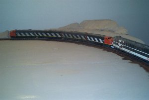

I have the Bachmann Plus F-7 AB units. Got them at a fire-sale price on a closeout. The only complaint I ever had was that the couplers were super hard to convert, and I wound up making drawbars to connect the units. I ran the powered ABs with a pair of dummy ABs from Athearn. They run very smoothly, and are nice, heavy locomotives. I personally have no serious gripes with them, other than the couplers. Here's a shot of them, (first two from the left) stripped from the original Pennsy colours, and repainted to CN stripeys. The third from left (dummy B Athearn) was repainted as well, and the last one is an out-of-the-box Athearn dummy.
