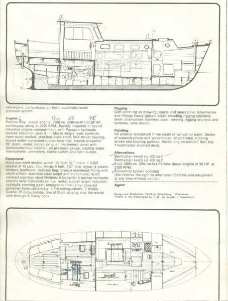

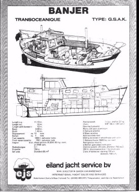

Here are some of Da Kine/Rendezvous. Also some from the manufacturer. Had to show the galley, and that contraption on the wall is the water heater. One of the repair projects. Ever try to find parts from 1972. Mike ended up cutting an old wetsuit to make some of thr gaskets.

Just realized, that cutaway is not Mike's boat. He has no cabin aft/below of the pilot house. The galley picture did not come through when I looked. Will resend. Let's try these.

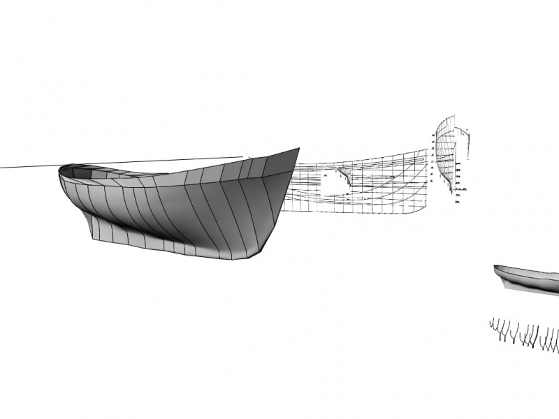

Did a preliminary Hull. Needs many control point adjustments, but the basic hull is there. I have found a lot more pictures and some kind of decision, soon, will have to be reached on this thing will be rigged and how the inside will look.

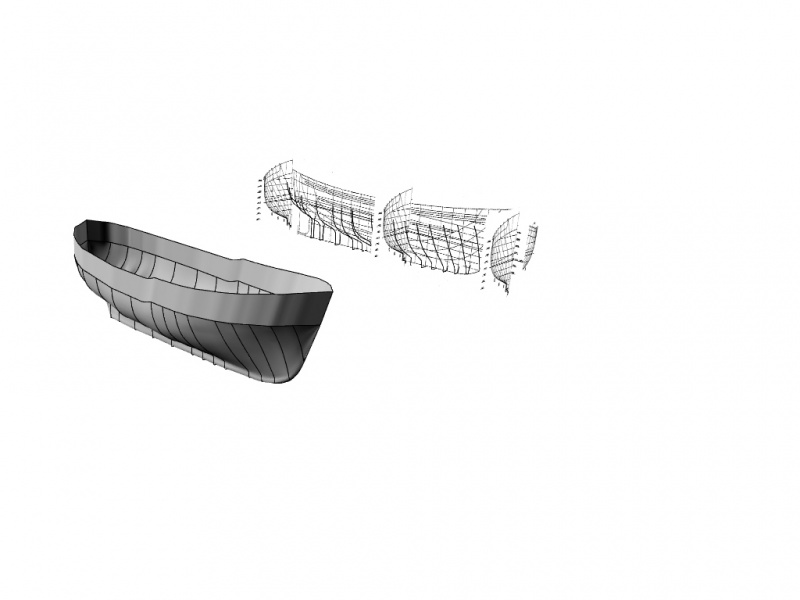

I think this Hull will work better for the basis of the final hull.
Those hull lines are the first step in making the shape. You will see it develop up. :)
