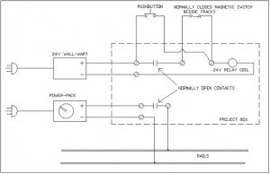

You know something that I have always wanted for my coffee table layouts but have never been able to figure out is how these people have it rigged so that when somebody pushes a button on the side of the layout, the train comes on and runs for a set period of time and then shuts off. How'd they do that?
Also, I'd still love to get together and work on that other RV idea we discussed but can't seem to find the time.
This is pretty much the circuit I used on the museum layout. This makes one lap after
the button is pressed and stops back at the magnetic switch. The magnet which operates
the switch isglued to the bottom of a boxcar. On the N-scale side I put the magnet inside
a boxcar. The power-packs stay turned on at a set speed during display hours.
All parts were obtained from Radio Shack, except for the 24V power supply. The relay
is a miniature type with pins sticking out the bottom, I don't have the number available
here but the relay type is not that critical as long as it has two isolated sets of contacts.
This could also be done by switching the AC to the power pack if you are comfortable with
wiring 120 volt circuits. If you did it that way your momentum switch would work.
You can also wire a timer in here to break the circuit after a set time,
or to bypass the magnetic switch for a set time so that the train would
always stop back at the switch. I'm looking for something inexpensive
to do that with.
