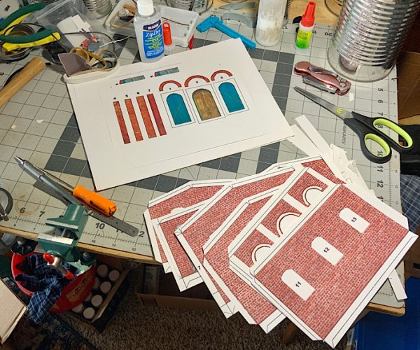

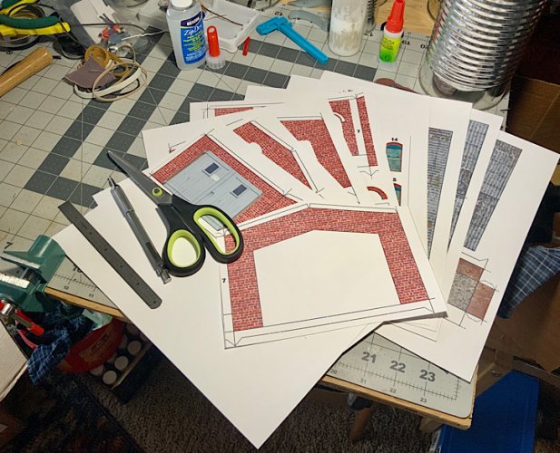

I’ve rescaled and modified this Papermau Warehouse to be the house and garage. It is ready to print now, I printed a test page today and I think I have it right. All this will be in 1:48 scale. It will be mostly paper (110 pound card stock) with a few added bits of wood and plastic.

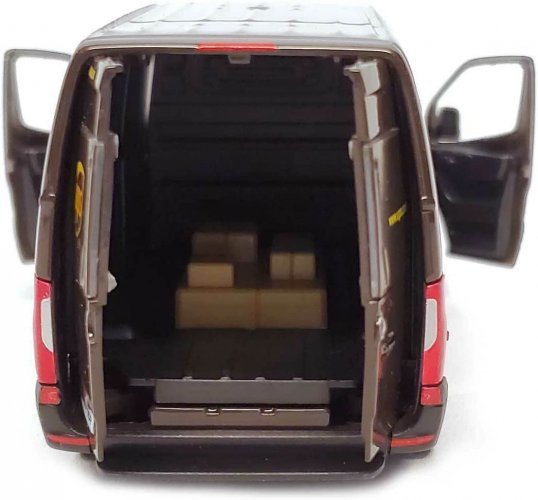

The Sprinter will be represented by this UPS delivery rig. It is a VERY cool little model, with opening doors and a pull back spring motor.

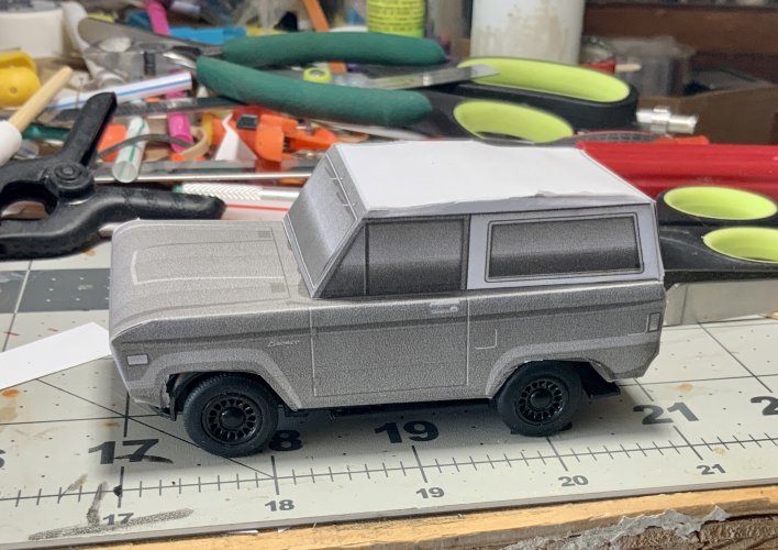

The original intent of the diorama was just to have the UPS driver piling packages on the porch. Then the Bronco came to mind. I searched and searched and finally found the perfect paper model on Papercruiser.com. When I told them the story, they sent me the paper pattern for FREE! Great folks. He has some nice models there.
After getting the model, I quickly printed a scaled (at about TLAR scale… that’s That Looks About Right) on ordinary printer paper. Since the old Bronco is now painted flat black and is quite rusty, after checking the scale, which was JUST RIGHT, I printed a grayscale photo quality print on card stock.
Then I snipped out the prototype version in a hurry and glued it together. PERFECT! After that, the Sprinter gave up it’s undercarriage (wheels/chassis/motor) and that was shortened to fit. Again perfect, IMO. (The Brown truck is bringing a replacement Sprinter today)

I printed 9 pages of parts this morning and started working on them.
As usual, with my attempts to scale individual parts and pages, I had to reprint 2 of them. No worries, there is always need for more building materials. I use an app on my iPad called ‘Print to Size’ and it allows adding individual bits of images, cropping and all sorts of neat things. But, I still don’t have a perfect way to scale things. I finally managed to get a doorway opening height onto a bit of clear plastic and I use that for a lot of things… just hold it up to the screen during the sizing exercise. One of these days, I will come up with a good ‘ruler’ to hold to the screen,

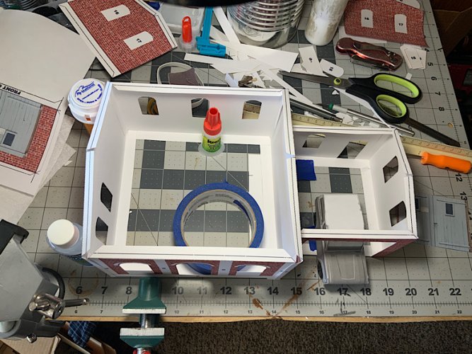

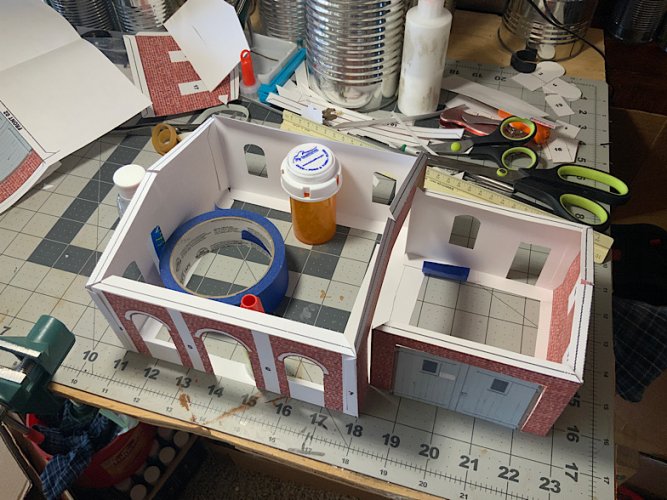

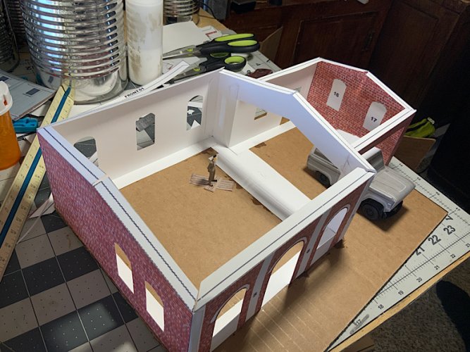

So, then I cut out the main building walls. I will score these and fit them together next. The house and garage will probably be glued down to a cardboard footprint to make handling easier. I want to make the roofs lift off and have wooden structure inside them so we can look inside if we want.
Looks like it will work fine. Now I think I will glue the basic structure together. Only the corners of the garage are glued at this point. I want to put it on a cardboard footprint so I can handle it better while putting in the windows and interior decoration.

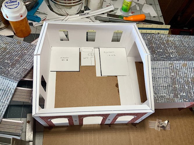

Once it is on the base, I can decide how the interior will look and design the roof structure. That will probably be stir sticks.

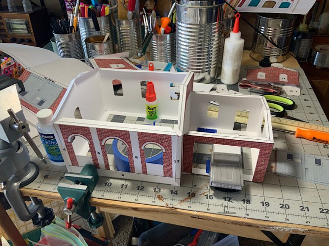

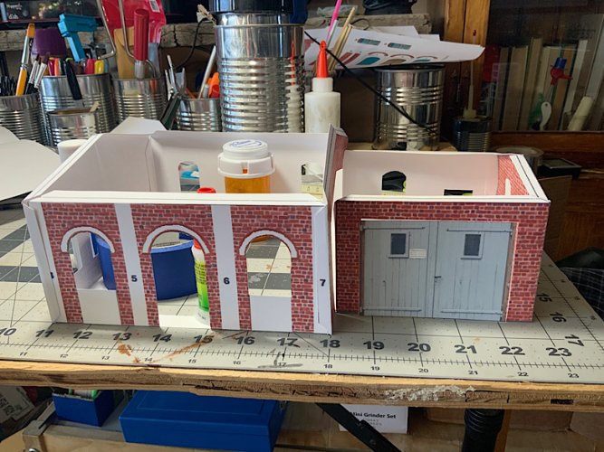

After looking at this in the partly assembled form, I think I will cut the main building down… that is, lower it. We don’t need the loading dock, and it can be a porch at ground level. Makes more sense.
A major change order came in, just in time. Since this is an old railroad warehouse, it is being moved to a more suitable location. That means that the loading dock and raised floor aren’t needed. So, the entire building is now on one level, much more accessible.

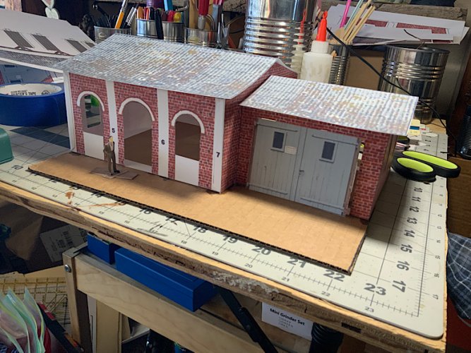

Now it can be attached to the ‘foundation’ footprint.

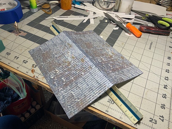

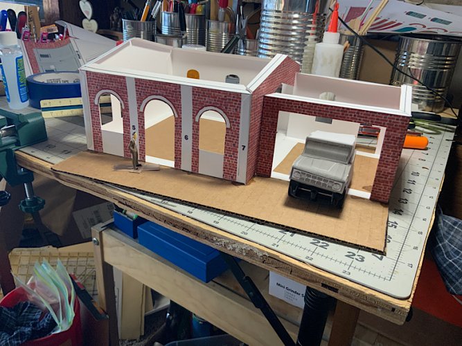

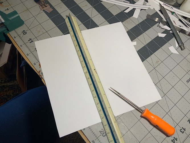

Then the roofing was cut and bent. I like to use my engineer’s scale as a straight edge and a pointy ice pick kind of thing to score the bends with. Then the top edge of the scale can be the ‘brake’ to make the bending even easier.
And, here is the model with the roof flopped on. The base being attached makes it MUCH easier to detail the rest of the build.

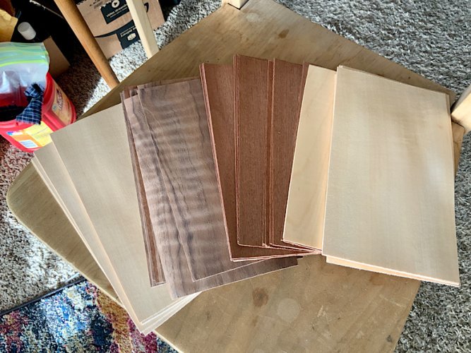

I have a box of wood veneer that I think I will line the roof with, then install the ‘trusses’ or whatever appears there. The walls will get lined and I will probably print that on card stock too. I’m working on the interior layout… kitchen, bath, bedroom, living room now. I do have a huge pile of stir sticks that work great for reinforcing walls and such.
Thanks for the suggestion!
The veneer is a little thicker than the 110 pound card stock. With reinforcing from stir stick beams, it should be fine.

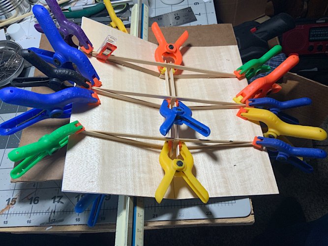

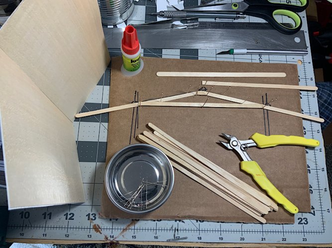

The main house roof is now lined with a light colored veneer. While doing that, I was looking for a weight to keep it flat while the glue dried, and found my ream of legal size 110 pound card stock! And my sizing/printing program allows for that size paper too. Good news.
So, we have a lined roof and a truss jig for building the trusses. During the test run, I discovered that I have two widths of stir sticks. ARRGGG! I bought a thousand, but there were some hotel sticks mixed into my tin sitting on the bench. So those got sorted out. Of course, the jig and prototype are made from the narrow ones, but I have enough to make the trusses I need now.

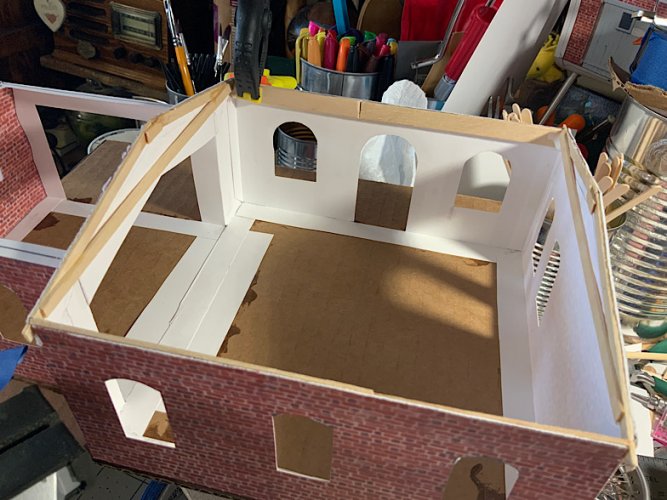

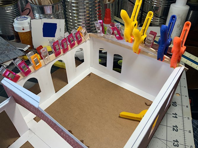

I decided I need 5 trusses. One will be attached to each end wall and 3 to the roof itself. 3 are made now and the one end is glued in place.
There is a header beam across the top of the front wall and there will be one on the back wall too. I folded the tabs that were made for attaching the roof down onto the walls and glued them in place, for more strength. (Two sides done, two to go)

The reinforcement is in place around the top of the walls. I am also going to install a round beam under the truss level to stiffen the house from end to end. I want people to be able to ‘raise the roof’ without being afraid of hurting the model.
