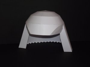

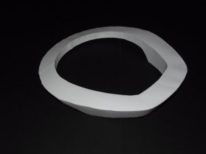

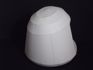

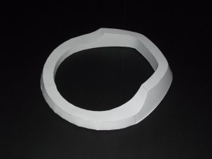

A quick and dirty test build of the mockup. I have two dimensions available. The efx helmet is 34 cm wide, the auction catalogue says the original prop was 30 cm wide. I printed a 2D image according to these data to check out which one looks better. The 34 cm version looked a tad too big, the 30 cm version a tad too small. So I rescaled the mockup to 32 cm.
No, this is no toilet seat..! :D

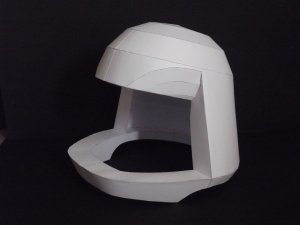

The light bars are still to come but at the moment I am really content with the result. :)
Thank you - the dirt is added in the next step. :D

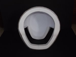

I have added the light bars. Unfortunately I noticed that the back edges of them hit my temples, so I guess I'll have to rework these areas. Other than that it looks fine. ;)

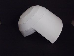

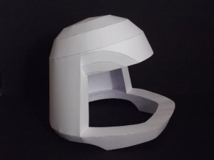

I have tweaked the mockup further and reduced the polycount to make the foldings easier and the flaps larger. So far I have built two versions in different sizes to check out which one looks better. The main problem I have is that different sources state different sizes of the real prop. Amazon says, the efx helmet is 34 x 30 x 30 cm (which can't be fully true because the width and length are not equal), the Hollywood auction catalogues say the original prop was 30 cm high. So I took a value inbetween (32 cm) and find it a good fit for an "average" head (whatever that means ;) ). I do have a certain advantage as I have a similar statue like Dirk Benedict. We are about the same height (+ / - 1 cm), thus I assume that our heads are of similar size, too. So I'll have to compare some shots of him and me wearing the helmet to be sure.

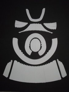

In the meantime I give you a sneak peak at the kit. I have attached the 32 cm version of the mockup for you to check out. Feel free to toy around with it - but please keep in mind that this is a simplified version which cannot be used to produce a good-looking prop replica. The final (good) one will come with the final kit, including a proper texture and the detailing. The mockup is designed for fast and easy assembly to check out if you have to scale up or down the final plans to make your prop fit on your head.
Strangely Pepakura has produced some zig-zag lines in the unfold (I have no idea why it did that and I was unable to get rid of that). Ignore that and imagine these lines as being straight. To save ink I recommend to print the pattern in white.

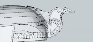

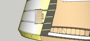

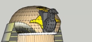

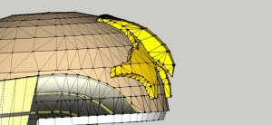

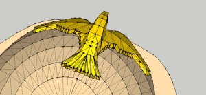

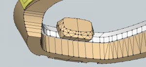

I have put the three main crests onto the helmet to determine the size and location of the anchor.

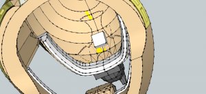

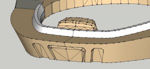

A view from the inside shows the anchor. It seems that the heron crest requires a few more magnets in the front to hold it in place. It will show when the first prototype has been assembled. :)
