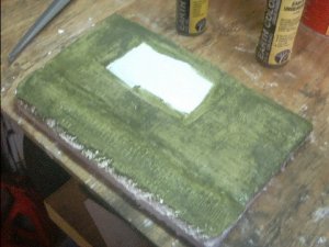

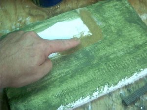

Started scenicing the base. First thing I did was paint the base with Woodland Sceneics Undercoat. This is a paint like stuff that you can use to paint plaster. You can also mix it with the plaster, turning the plaster from white to green. In case you drop something and chip the plaster, you won't get a white spot on your scenery.

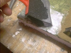

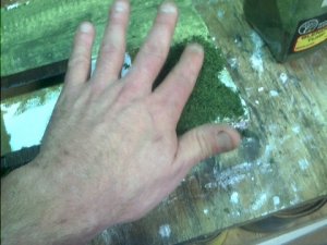

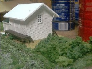

Next, Using WS fine brown Gorund foam, I made dirt walks, and sceneiced under the docks. I use the "splat and pat" method of appling ground foam.
Using a cheap foam paint brush, I "splat" Elmers glue down, spread the ground foam, then "pat" the ground foam into the glue. I blow the excess off when finished. After finishing the walks and underneath the docks, I applied Woodland Sceneics fine and course green ground foam I mixed myself.

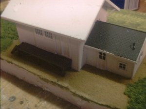

Heres the "blindside" of the depot with the basic scenery done.
Next: Ballasting the track and fine tuning the scenery.

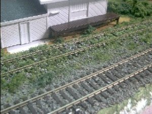

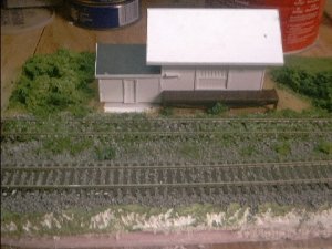

Anyway, this is what I did after work today. Unfortunatly, in my hurriedness..I forgot the camera, so these are the finished pics.

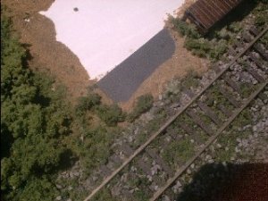

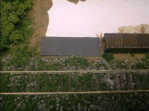

This first one shows the ballasting of the track. The near one is the mainline, so I ballasted it as if it was maintained ok. The one closest to the depot is the siding, this one I made to look less maintained, by lightly ballasting and appling WS ground foam to the top. Ballasting was accompished by the tried and true method of 50/50 mix of Elmers and water with a couple drops of dish detergent added.Before appling the glue I sprayed the ballast til it was soaked, with 70% alcohol.

Here's two more pics with some of the scenery done.
Next: Keep going on scenery, paint and add details to the depot.

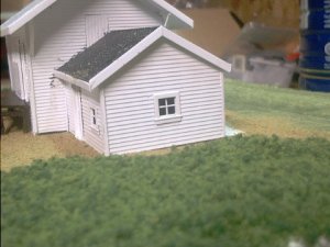

Ok...This weekend I did more on Ore Hill.
First, Looking at the pics from 1928, there looked like a stone "porch" out front. I first cut some N scale "stonework" shaped plastic. Then I sprayed it primer gray, and lightly sprayed flat black over that. Glued it in place, and sceniced up to it.

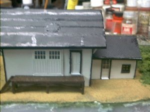

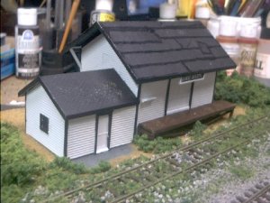

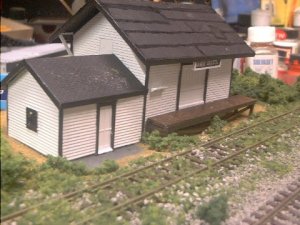

While that was drying, I did the tarpaper roof. First I spray painted masking tape flat black. When that dried, I applied the tape to the roof, in as close to three foot scale width as possible. I then painted the seams with engine black. Little scraps of tape made good patches.

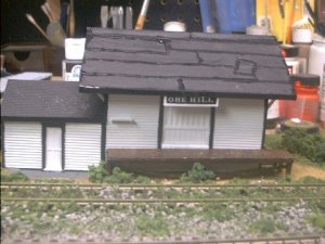

And The Finishing Touches!!!
Its done!!!

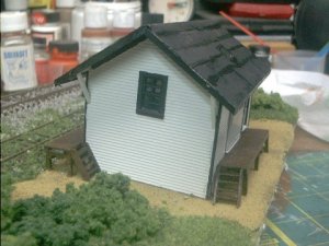

I spray painted a piece of plastic flat black and "Diced and spliced" the depots name. Glued Evergreen strips around the border, cut around the border. Then glued the sign under the eave.
After that I added glass to the windows, glued the depot to the base, and declared this project DONE
