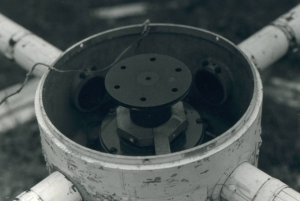

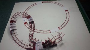

But, before we begin, I think we should bow our heads and give a minutes silence to commemorate the fate of the original filming model...............
I sad sight indeed. :sadno:

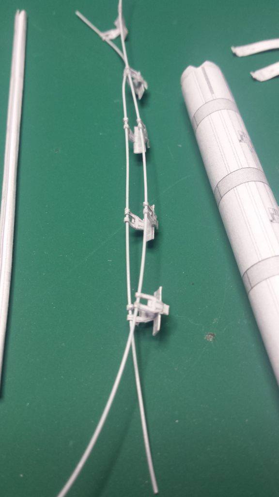

One of the attractive and functional parts of this stations design are the spokes and associated tension cable systems.

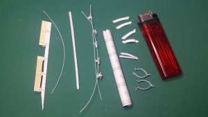

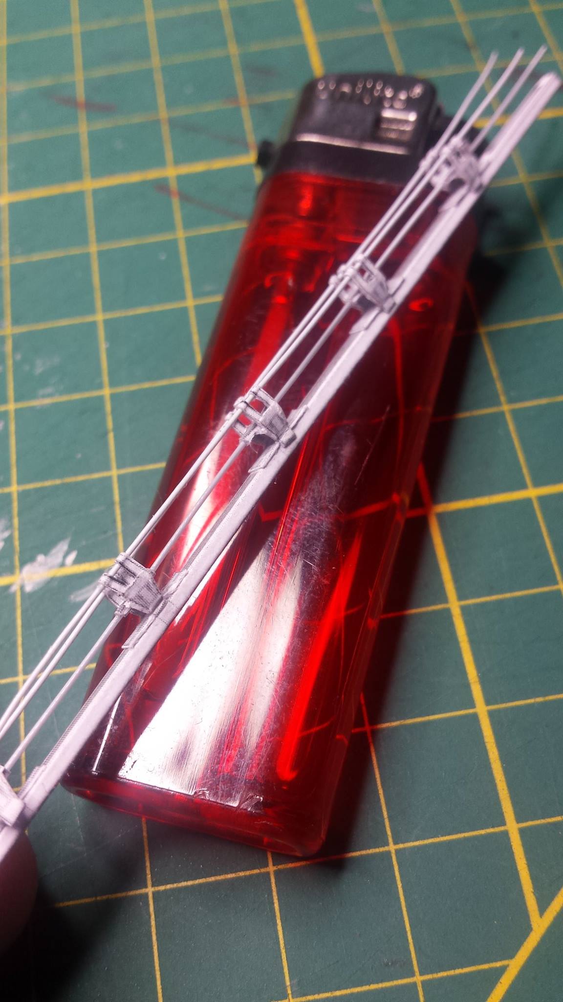

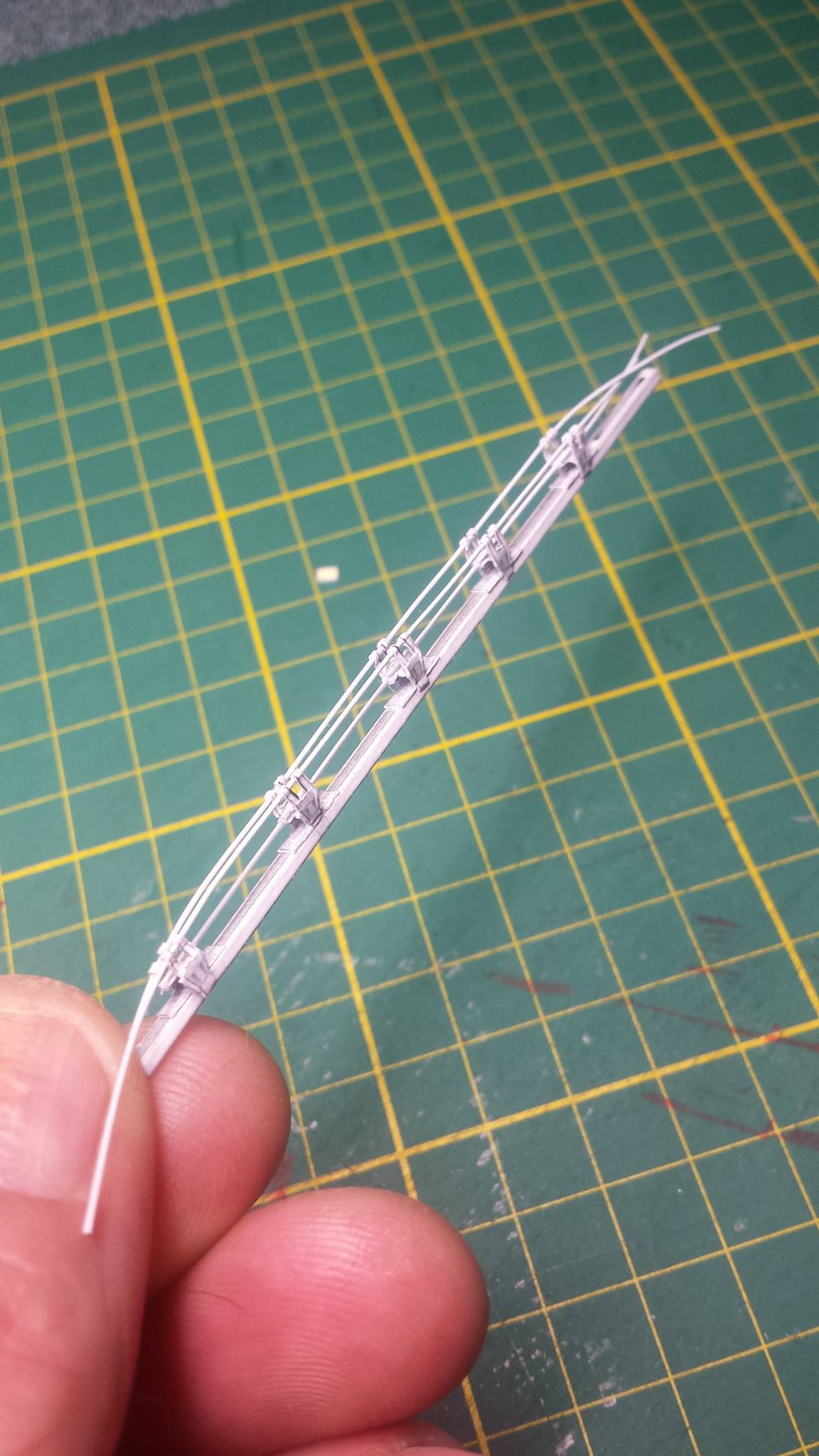

For this model, Uhu recommends using stiffened thread, achieved by using glue and weights, for the cables themselves. At first I was not sold on this idea and sought an alternative for the thread. I went out to the shops (pre-Covid times,) and found a white plastic coated wire at 0.35mm diameter.
So, before diving in and starting the model, I decided to build one spoke assembly with one set of cables using the 0.35mm wire as a test bed.
I will explain the build process of these a little later, but for now, I'll show you what I came up with.
I also learned a lot from the build of these, and realized jigs were needed to be made, for accuracy. More on these a little later.

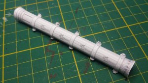

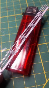

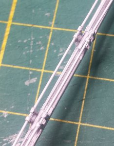

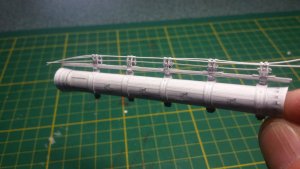

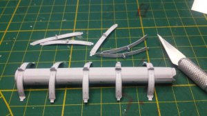

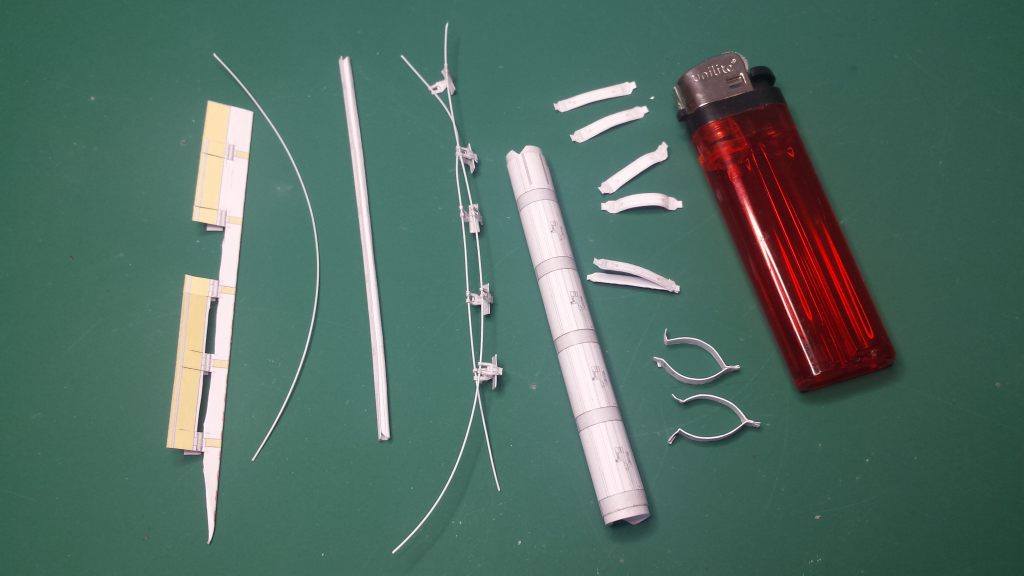

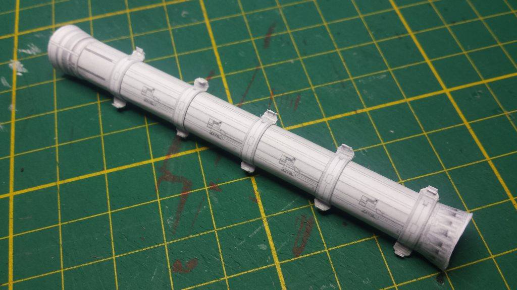

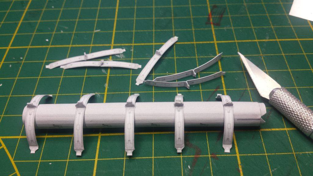

The spoke was rolled, the mounting rail made up and the 0.35mm wire was attached to the cable frames, as per the instructions.

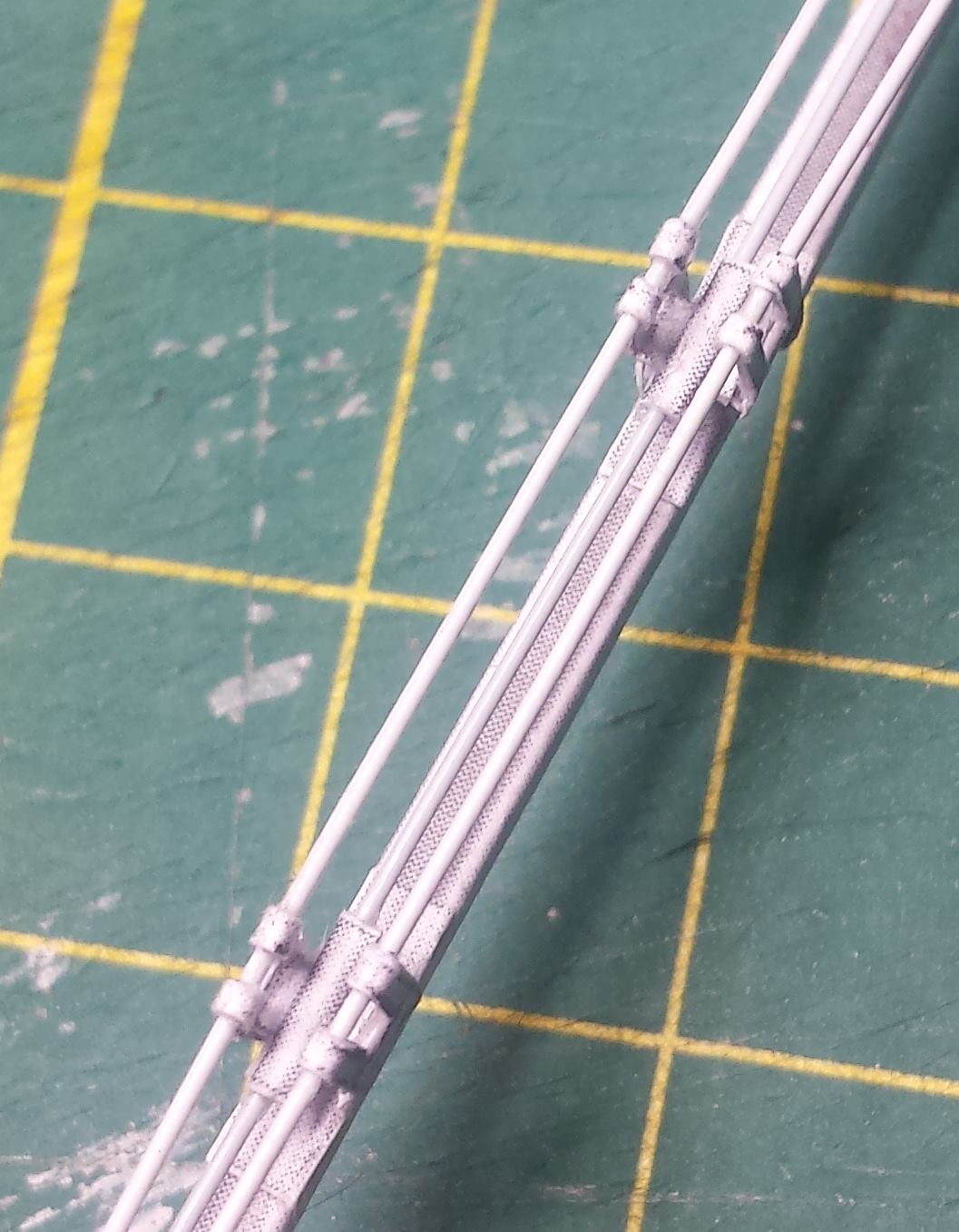

The cable assembly attachment brackets were added to the spoke..

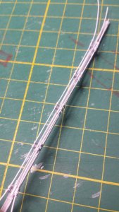

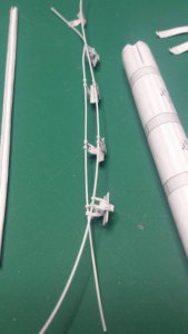

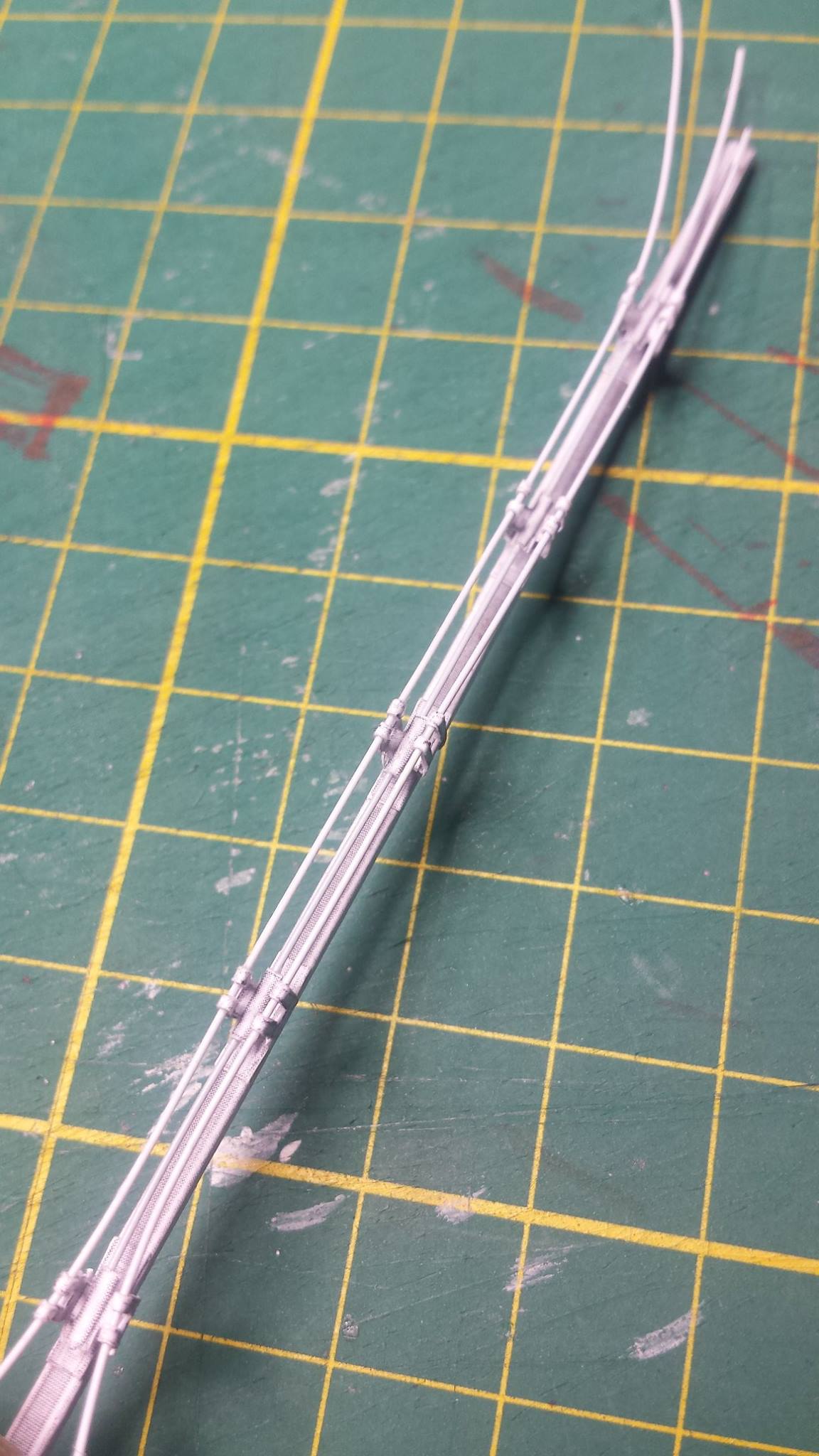

The cable assemblies were attached to the mounting rail .....

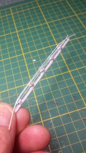

And finally the assembly was attached to the mounting points on the spoke, and not very well, I might add.....
I liked the look of the finish of the cables, but due to the stiffness of the wire, it was difficult to align the mounting frames.
For my feeling the 0.35mm wire looked out of scale and could of been doing with a diameter of between 0.20 mm and 0.25 mm, instead of 0.35 mm.
What do you guys think?

Looking great so far!
I wonder if there isn't some secret graveyard where studio and movie models go to die after they are thrown out. It's sad the model was discarded. If I had been involved with the movie I would have wanted to bring it home with me.
So, when are you going to do the Orion planes?
Reactions: DanBKing
I think that you did a great job on this test. Everything looks FANTASTIC!
As for using thinner wire (or stiffened thread), you can always do such. I think that it would work well too.
Reactions: Awry_Chaos

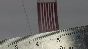

Anybody that is going to attempt this model, I strongly advise to stock up on cutting blades. On the UCR alone, I used a total of 22 #11 blades .... :eek:
Start the cutting process with a new blade and change it, as soon as you feel the cut begin to 'drag'. The blades only wear at the tips, so they can always be reused for more 'robust' parts, or for your future projects.

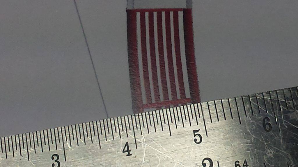

Some of the rails are only around 0,5 mm wide..... A sharp blade is essential!

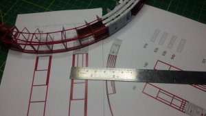

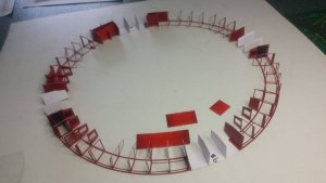

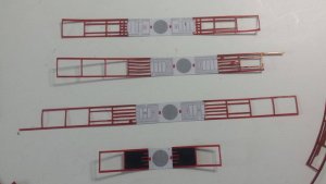

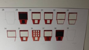

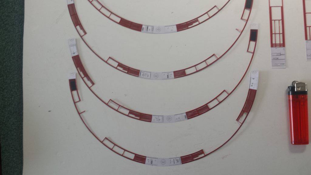

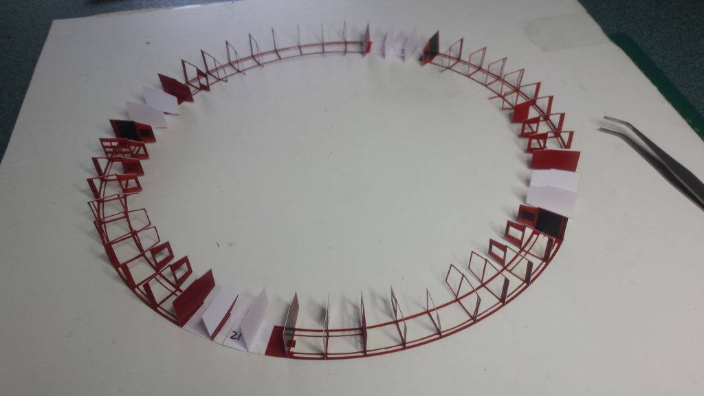

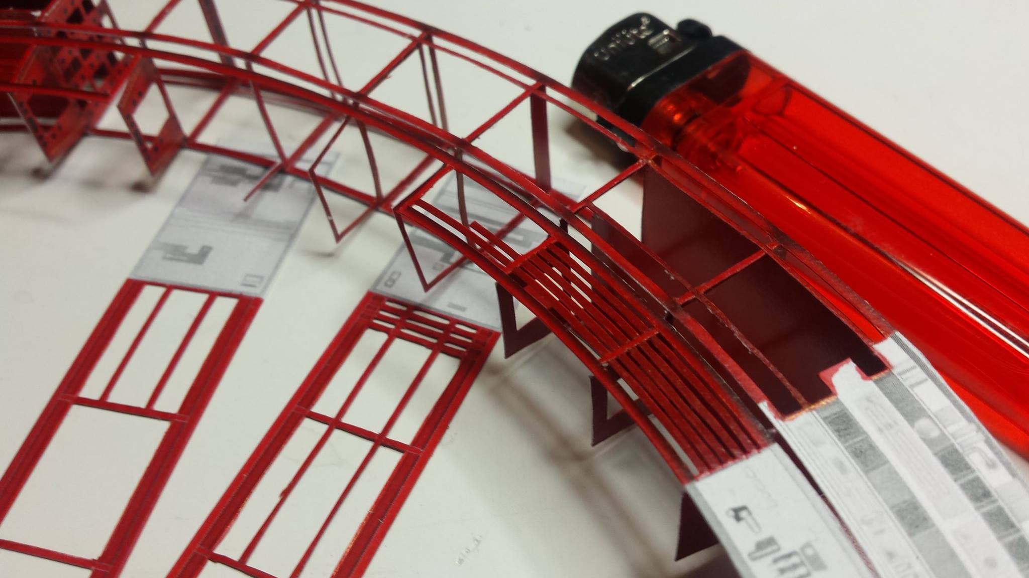

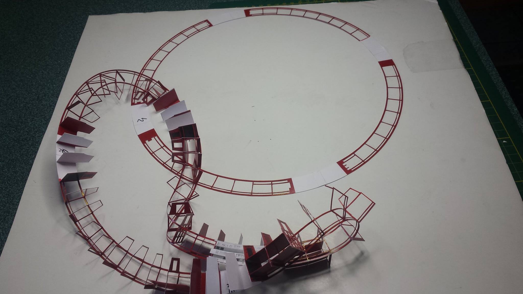

I started off by cutting out the internal sections of the cross frames....
... along with 4 sets for one of the ring sides. Everything was done in 4 sets of quadrants.
I edge-coloured the cut-outs where required.

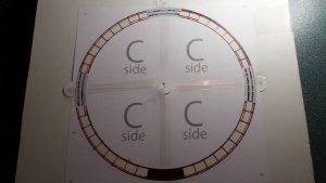

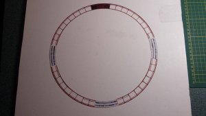

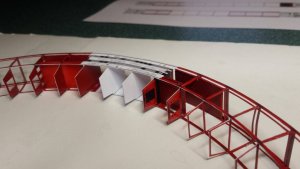

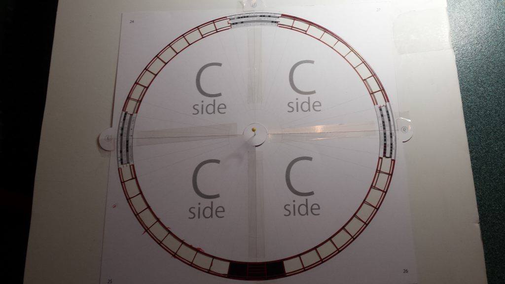

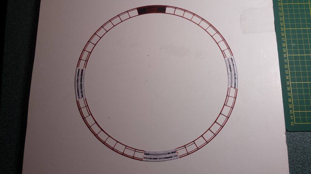

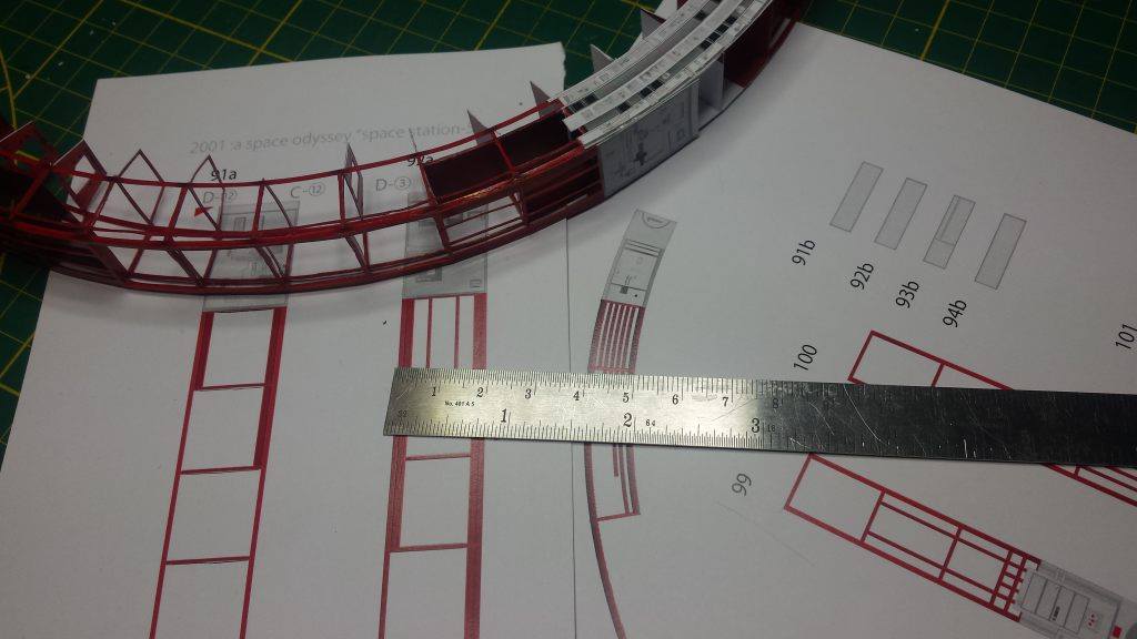

Using a flat piece of 10mm thick foamboard as a work surface, I taped up and glued the 4 ring parts together. I used a pin to keep the center perfect
Once dry, I first cut out the outer circumference of the ring, followed by the inner. Job done....
And now the fun part..........

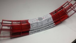

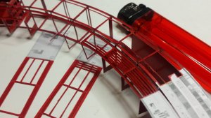

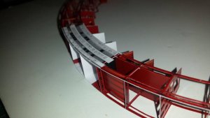

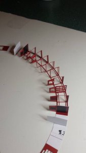

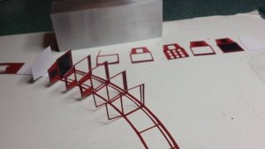

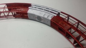

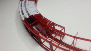

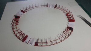

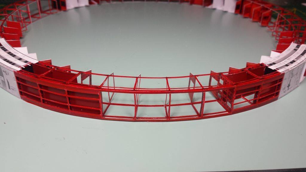

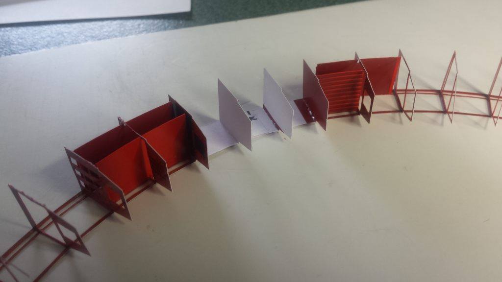

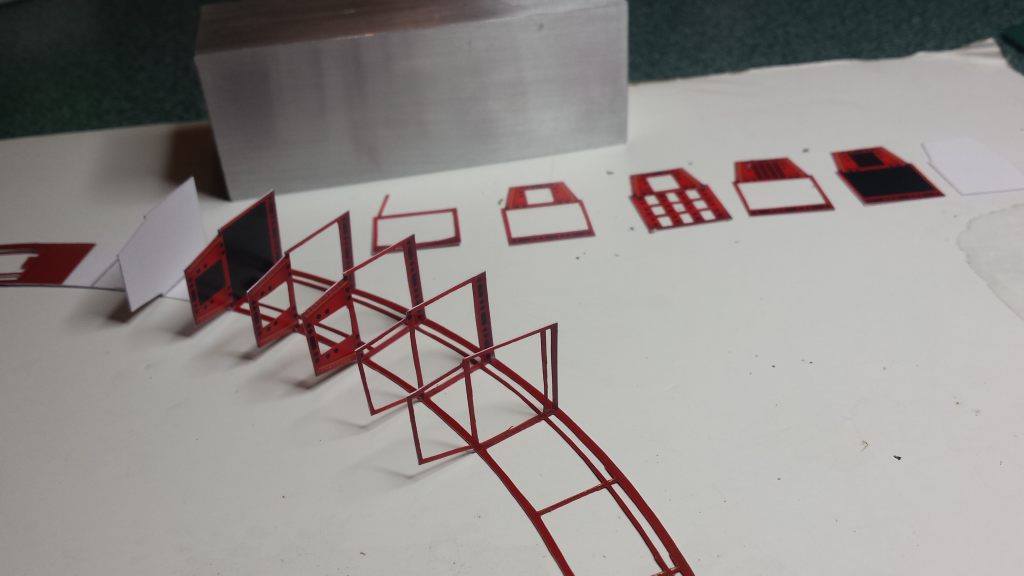

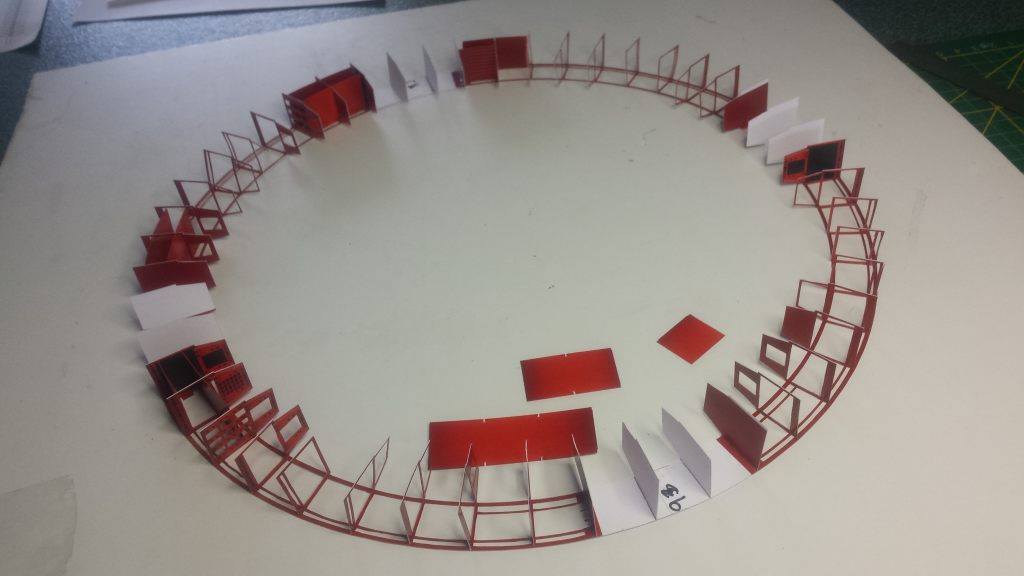

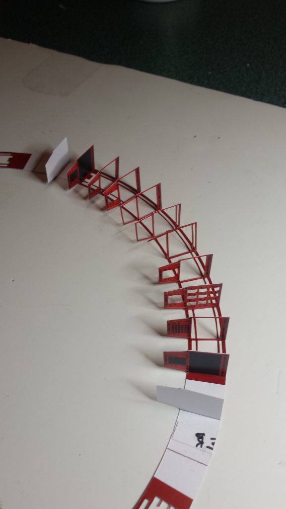

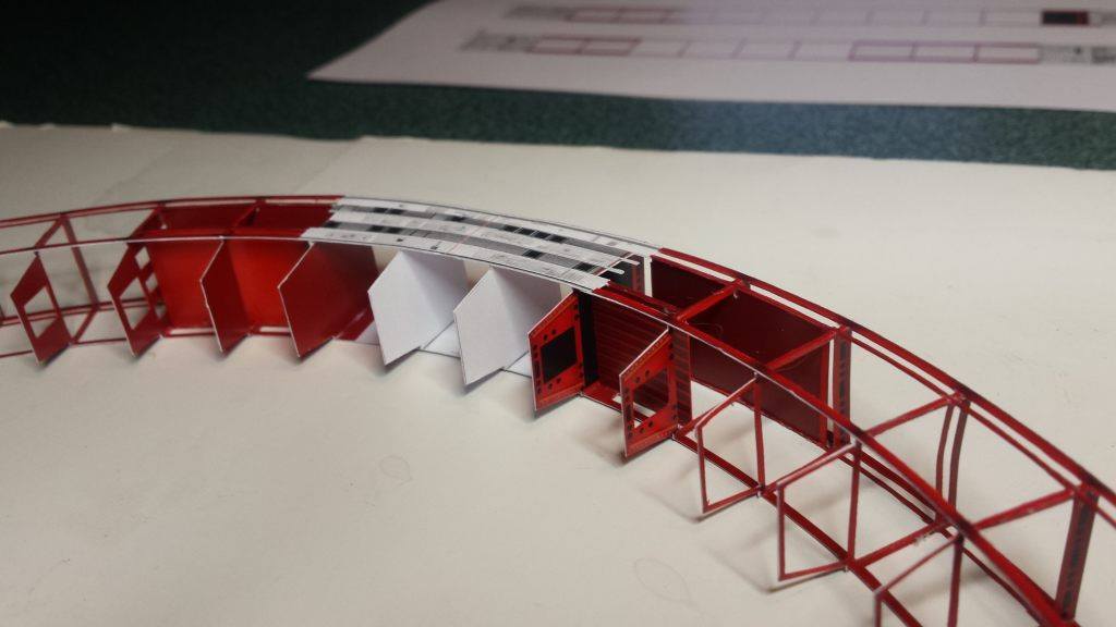

The cross frames were cut from the carrier and using a thin bead of glue on the frame edge, each frame was glued to the side, keeping the order correct. and ensuring the outer edges line up perfectly.
I used a machine-squared block of aluminum to hold the frames as vertical as possible while drying.

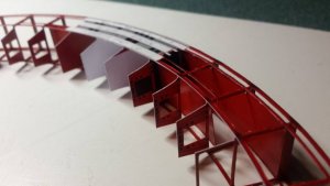

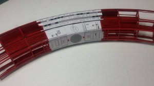

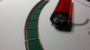

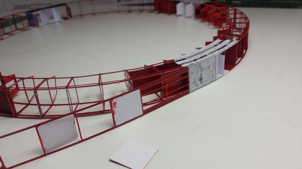

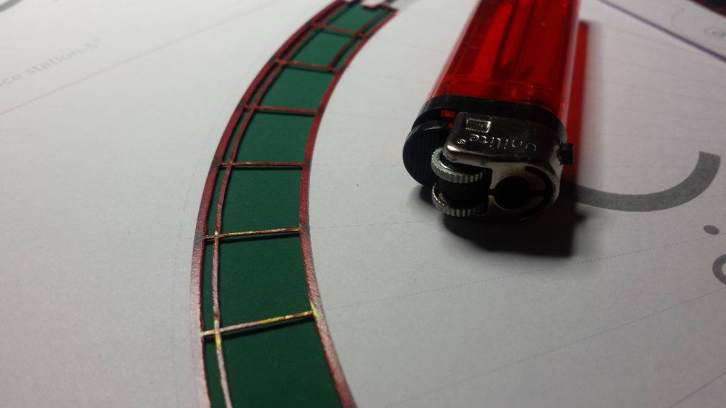

Next up the flooring panels were fitted... I curved them slightly first to aid in fitting.

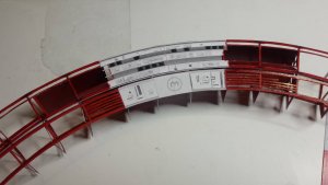

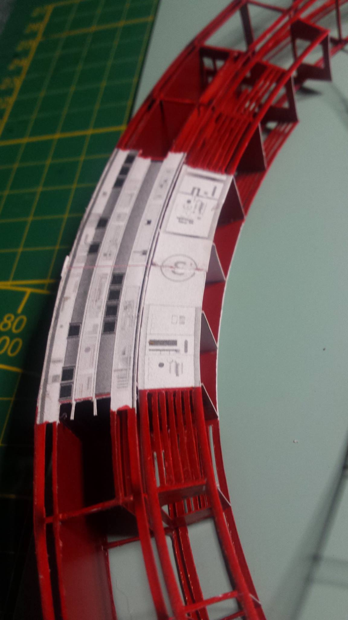

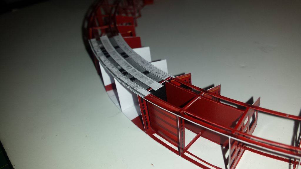

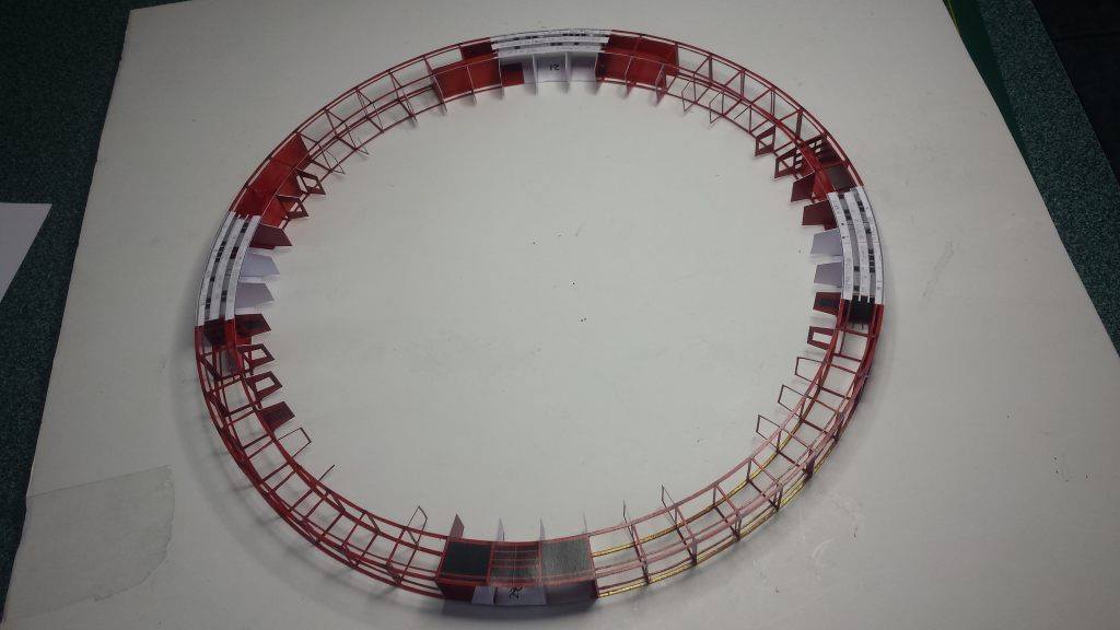

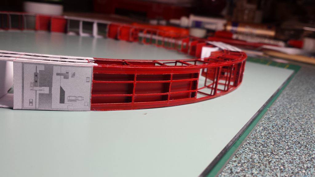

Next up the same process was used to cut out and assemble the other side pieces of the ring.
The earlier made section was then attached to the new ring, using the same method as before.
The assembled first half of the ring is quite sturdy, even at this stage.

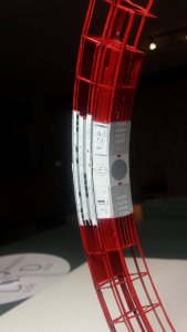

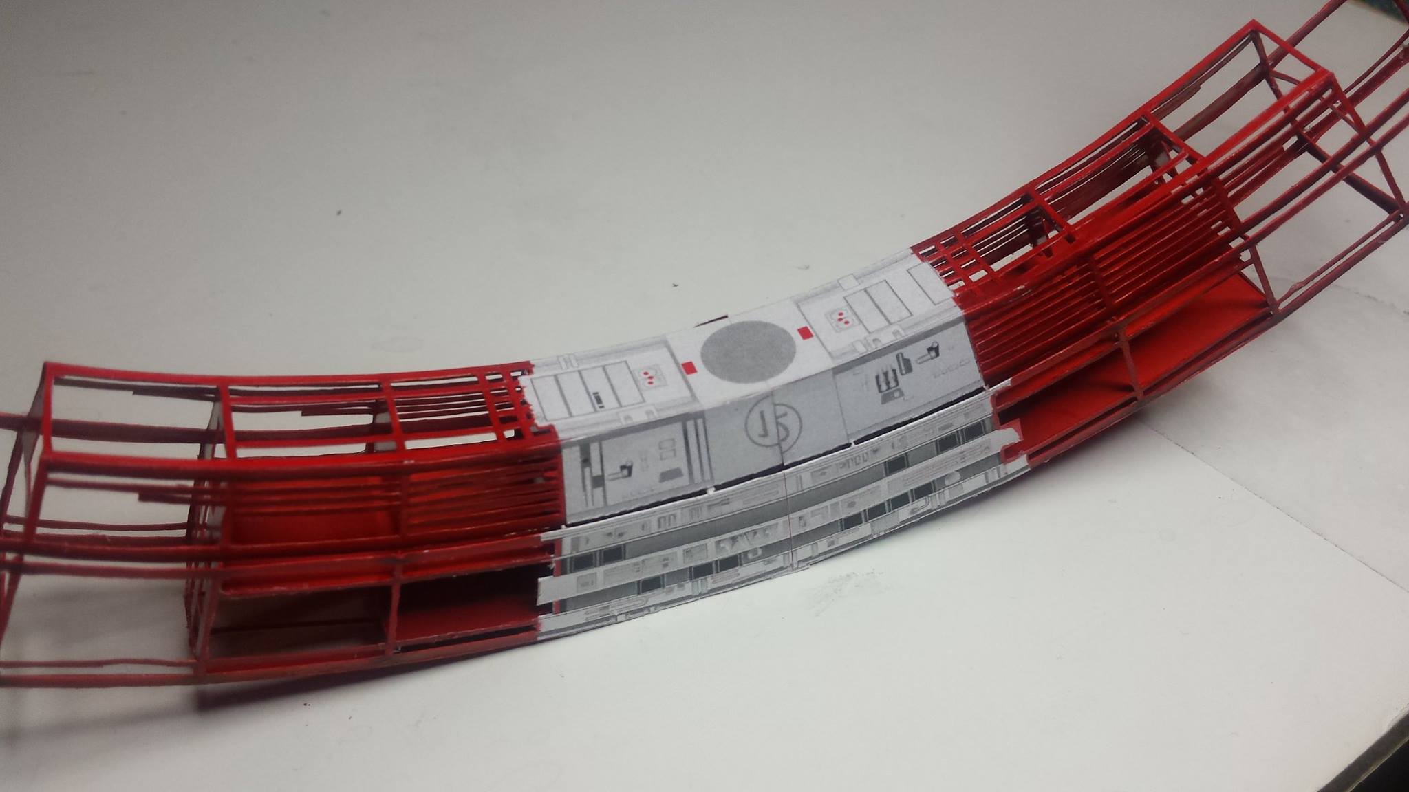

So, that completes the first section of the UCR. The ring has now become quite sturdy and stands up on its own!

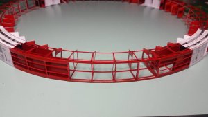

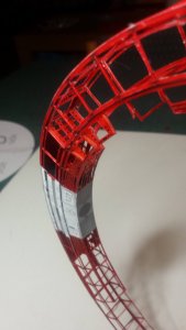

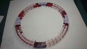

With the main structure of the UCR completed, it is time to assemble the rest of the parts, starting with the outer circumference.

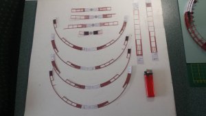

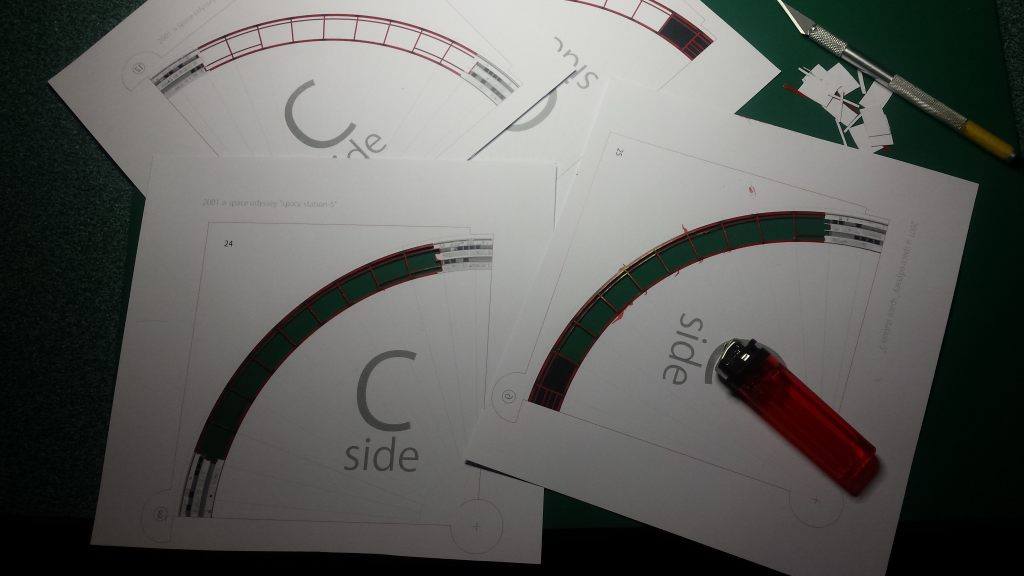

But that, of course, requires more cutting....

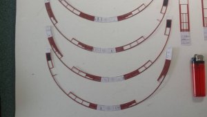

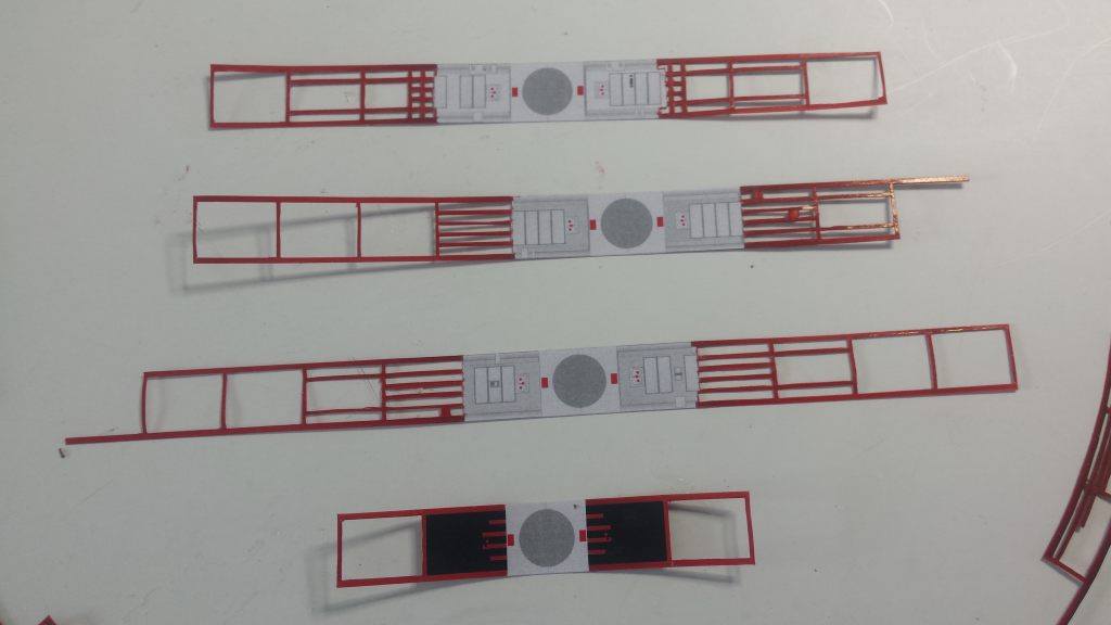

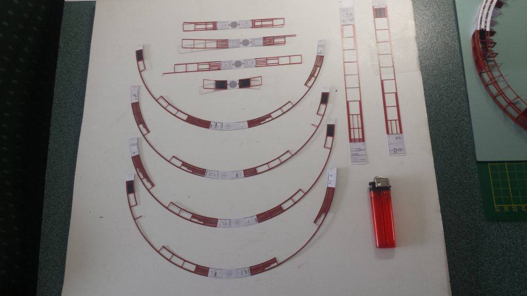

As all the remaining parts for the UCR were on the same pages, I decided to cut out everything in one sitting. That's about 4 hours straight right there......

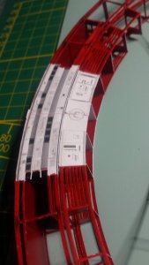

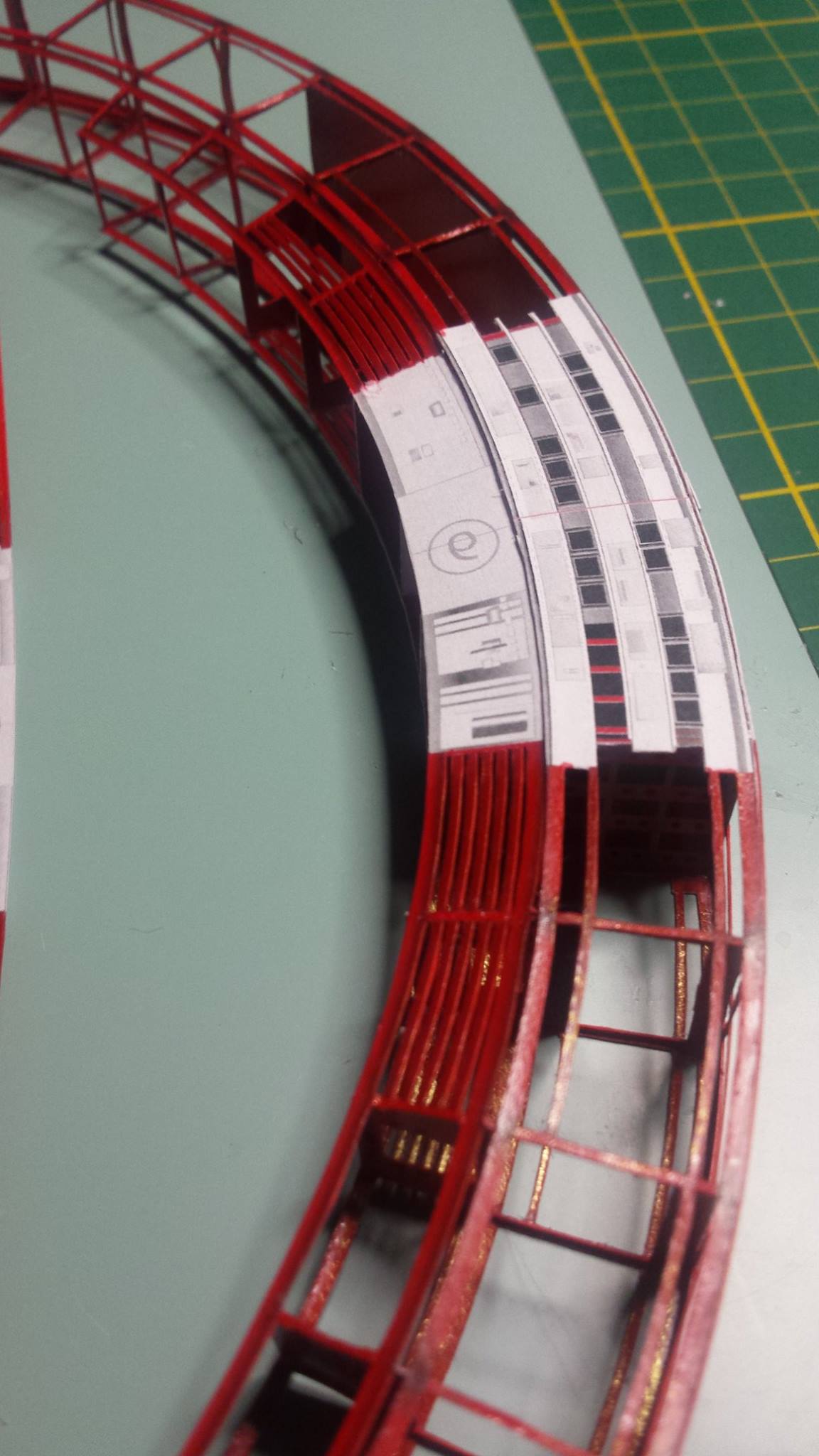

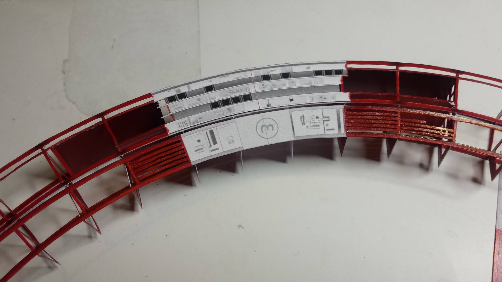

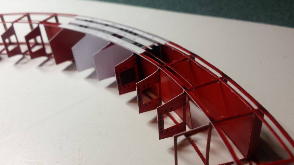

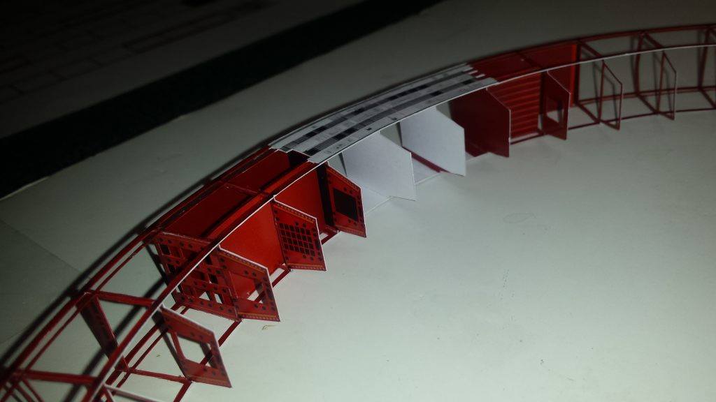

Once I had rested my aching fingers, I couldn't resist the temptation to see what the model will look like, with 1 of 4 pre-cut inner ring sections laid in place. It's getting exciting now! :biggrin:

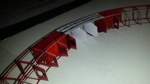

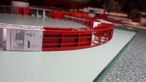

Attaching the parts for the outer circumference is are the most difficult part of the assembly, in my opinion. Any wavy bits here will not look good in the end. It is just a matter of taking your time and working on one block at a time.
When I cut out the larger inner sections of the outer frame, I left a tiny sliver uncut at each corner, thereby holding the offcut in place. My idea was that this would help in keeping the frame square during assembly. Seemed to work relatively well, but some fell out, due to over jealous cutting. Any remaining after assembly were nipped out with sharp pointed scissors.
Next up, the 4 side pieces for the inner ring..... These are a little simpler to attach, but still, take your time, making sure nothing is twisted or bent.

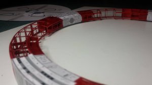

And finally, the parts for the inner circumference were attached. I found it easier to assemble these parts with the ring standing on its outer circumference.

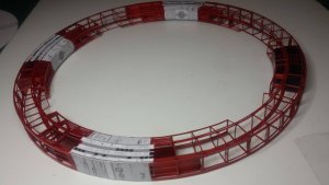

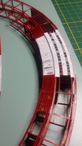

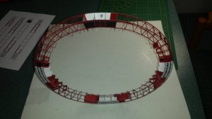

So, I am pleased to say, that is the main assembly for the Under Construction Ring complete! :laughrolling:
Here are some beauty shots of the completed work, so far..... I'm not worried about the red bleed from the edge colouring on some parts, as that will be covered by detail parts later on, and won't be seen. A few touch-ups and repairs required here and there, but I'll do that later.
Enjoy!

You really are a Master builder. These bigger than life pics prove it. The assemblies look flawless!! :Bravo:
