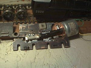

I tried Loc-tite stud and bearing mount on one to glue it in place, it hasn't come off since, but I don't run it much either.
I repaired another by boring holes in the drivers on the lathe, installed insulators on half of them and installed them on a steal axle. I also regeared it too. Absolutely more work than the loco was worth, (just had to see if I could do it).
I guess I don't understand what's happening here. I read where this is a common problem. If the drivers are being forced out of quarter, then it would seem that the geared driver is moving, and the rods are not turning the other drivers, as they should be. A loco should be able to slip its drivers w/o getting out of quarter. I would think that the screw stem in the non-powered drivers is not holding the rod in place, allowing the rod to move w/o turning the driver. Therefore, either the rod "key" on the driver stem is not effective, or the eye in the rod is not maintaining a positive hold on the stem. Joe at Bachmann is a good technician to speak with. I would like to hear what the solution is, if they describe it to you.
I opened up the under carriage and found the problem. The plastic doo hickies (or axle) that is supposed to hold one of the non-powered drivers had broken free of both drivers. I presume that it was somehow glued to the inside of the wheels, but since it was broken it was not holding them in place. So as the wheels turned, the first driver would sneak out of place and jamb up into the break rigging and throwing everything off as the rods are pushed further. I am hoping that by glueing the axle back into place, that it will fix the problem. I really like the engine, but I haven't been able to run it because of that. What kind of glue is best for gluing plastic and metal?
