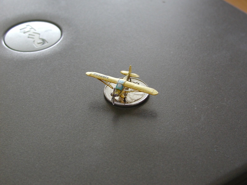

It depends what your "normal" copy paper is. Many use a 20lb all-purpose paper which would be too light in my opinion. If I get something printed at Staples their normal paper is a high quality 28 lb paper which might work for modeling. I've had excellent results with a 32lb cardstock I bought at Staples. It's a nice in-between weight for very small models/parts. I'd recommend that as a minimum. I used to use 67lb for everything, then changed to 110lb for sturdiness and durability, employing lighter weights for small parts and details.
Steve
