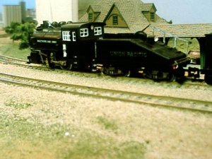

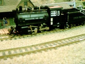

Medicin Man's 0-6-0T Dockside
Medicin Man asked me to post these here.
:thumb: Nice one MM:thumb:
