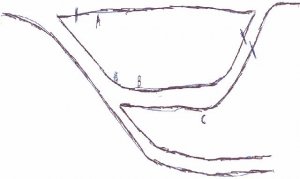

I'll take a swing at this. As I recall the basic rule for gapping power routing turnouts is you need a gap in every rail that joins the frog side of two turnouts. So, you need gaps in the rails I've marked A,B and C. Anywhere along their length is ok electrically, operationally you want to put them where it suits you desired operation. I'm not sure why my scan of my quick drawing cut off the top and bottom, I scanned twice with same result, but you can see enough to know what I'm referring to. Assuming the two turnouts on the main can be thrown independantly of each other, rails A and B need gaps, or there will be a short when one is thrown and the other is not. Having one control throw both may elimainate the need for gaps, but if they don't throw at precisely the same time, you will have a short. And being able to thow independantly is desireable. Where you put those gaps is up to you, I think I would gap A at the left side frog, and B at the other end. C would also be at the right hand side. This allows the turnout on the main leading to the stub to control the thru siding and the stub, by the way the two turnouts on that side are thrown. Either the thru siding or the stub will be powered. The main between the two mainline turnouts will only be powered by the turnout at right.

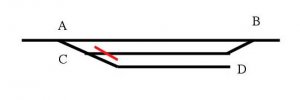

I'm going to give it a try too...
If you put a gap in both rails just to the right of "C", it turns "C" into an off-on for track C-D. Turnout "B" controls the power for track B-C. With "A" and "B" set for track B-C, you effectively turn off track A-B as well.
Have I got that right? Running with DCC gives you the bonus of all track on, all the time...
Andrew
