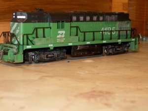

I was putting a decoder into an old Kato that has the one bulb in the center. I was thinking that if I could glue a couple of white LEDs into the carbody and then run wires down to the decoder....
Any thoughts on this idea?

Hey Andy, I been using a 560 Ohm resistor on mine....I like 'em bright!!:D Course I don't uses any DDC and don't what output you may be dealing with. 73
Drew....be sure to attach the resistor to the positve lead(s) of the LED. That's the long one.:)

Well Andy, I'm just not sure about things like glueing the LED's into the shell. What type of glue? Then I'd need a couple of inches of wire on each lead to reach down to the resistor and decoder. I'm just not sure that I could shove all that loose wire safely under the hood!! I have an Athearn SW1200 that I want to do as well, and there is even less room under it! I just don't want to get the lights nicely installed, and then I can't get the carbody back on!!! :mad: :mad: :confused:

Doesn't seem that installing the LEDS in your switcher would be a hard job. Just need some real flexible wire so you can keep the wiring out of the way of everything. I use 30ga "flexwire" for lights and sound in my locos but its real hard to find.:(
While thinking about this I went over to one of my junk boxes and found an old flat cable that was used to connect the controller card to the motherboard of a computer. I cut the connectors off and pulled the individual wires apart and BINGO!!...nice 18" pieces of real small flexiable wire!!!:) :) Sometimes I amaze myself!!!:D :D :D
