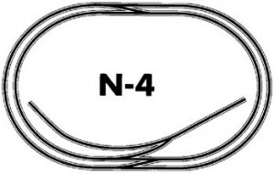

I am still working on creating version of Atlas N4 track plan, but now that I am actually doing the wiring I require some help.
In order to creat the blocks, would it be prudent to place the insulators opposite the + terminal connectors are located? The only place where this would not work would be at the siding, and I am guessing that the insulator would go at the enterance to the siding just after the switch. This turned out to be more difficult that I realized.

Hi,
I believe you need to insulate both rails at your three crossovers (right between the turnouts), and both legs of the blind sidings, although here you only need to insulate one rail. I presume you'll be using two packs (or DCC) to have at least two trains running at the same time.

You can use one insulator on the crossover going from the inside oval to the stub sidings, you will need to insulate both tracks on the other two crossovers. A couple of other things to remember is to make sure that when you use one insulator to wire what we call common rail, the same rail needs to be the common rail all the way around the railroad. The other thing that is a good idea is to put a locomotive on the track, and hook up a throttle. Install the insulators before wiring the layout. Then as you wire the layout, run the locomotive after you install each wire. That way if you do something wrong and create a short, it is easier to find it, since it will always be the last wire you installed that created the short circuit.

For DC, you probably need insulation at the crossovers. You may also need to insulate some more sections to hold trains -- possibly each of the curves could be a separate section. Then you wire them up so that they can be switched between the power packs or shut down.
Trace out some operations on the plan and see how you would do things like change from one oval to the other.

The only places that it is critical to insulate both tracks are the two crossovers that run between the inner and outer loop. If you try to run two trains on two separate throttles at the same time in opposite directions without insulating both rails between between the two loops, you have a good chance of damaging one or both throttles. The Atlas switches have insulated frogs, but the switches are not insulated. The rails are "hot" all the way through except right at the frog.

Here is my suggested gapping/insulated rail joiners for the electrical blocks.
Because common rail was desired, I show the gaps on the inner rail only. You could choose the outer outer rail instead.
Why 4 blocks in each loop? Because you always need an unoccuppied block for a train to move into. If you have less, one train will be constantly stopping, waiting for the other train to clear the block in front.
The normal 1st approach is to have a separate power pack attached to each loop. But this gets very ugly when a train tries to switch from one loop to the other. It's almost impossible to exactly match settings on the power packs for the train to switch from one to the other. Even if you do, when the train wheels are spanning the insulated rail joiner or gap, you have both power packs feeding the same train. The goal of block wiring is to make it possible for the same power pack to control the same train, no matter where it goes on the layout.
