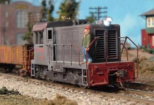

I just scrape the sides of pastel chalks to get what I need. Placed in a water color pallete and then applied with a stiff bristle brush, I seal it with Krylon Matte Finish.
