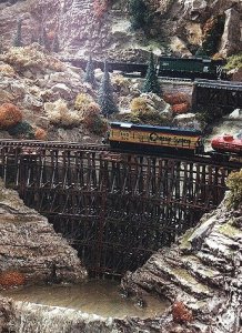

Hi Bill,
When I had my N-scale layout, I created a waterfall using Glass fibre (Car stuff) it turned out okay. I just scraped a knife down it all before it went off. Here's the pic of it.

Thanks Pete, that is some of the information I was looking for. Was going to combine the new stuff with the method Shamus discribed. Checked several crafts stores tonight but could not locate any spun glass fibers. (Simular to that stuff you use on Christmas trees to fake icicles) Have a large box of misc. fiber optic cables, will cut some of that up and give that a shot. Nothing ventured - nothing gained. :rolleyes:

The stuff I used was glass fibre matting (White) and a bottle of
glass fibre (Liquid) and hardener (Blue) it is used to repair car bodies with. Stiinks abit while going off, but well worth the effort in making a waterfall.
