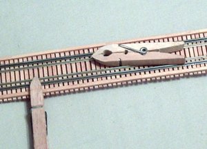

Get some really small clamps too - clothes pins work great for most joints.
I modify my clothes pins by carving the ends down for better control. I also use plain Elmer's white glue or Aleene's Original Tacky Glue, found at Wal-Mart. Have at it and don't forget to post pics:thumb:
