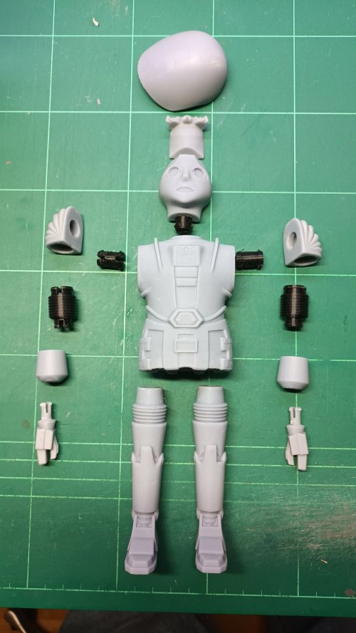

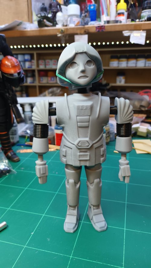

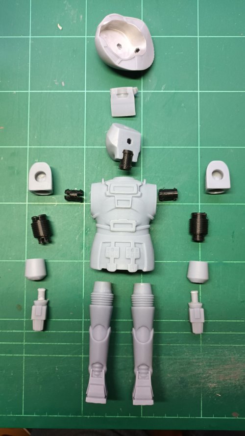

Comprising of relatively few parts, the build of this little model shouldn't take too long, I say little he's just under eight inches in height, possibly 5th/6th scale.
The black parts which join certain parts are made of a slightly more flexible material, looking quite possibly of PLA as they have whisps of plastic strands to remove.

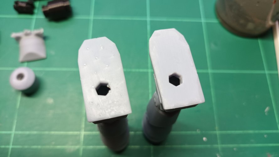

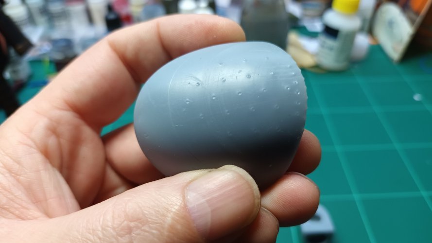

Overall the the parts are brilliantly rendered, however some parts require a small amount of clean-up to remove marks left by supports.
One end of the wrist point had some blob-age going on, hopefully not a part of the suit, but this was made to disappear.
Although you won't see the soles, they were very slightly bumpy, so they were sanded smooth and the feet sit a lot better.

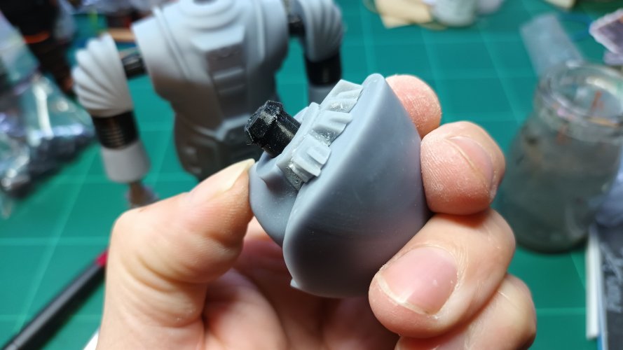

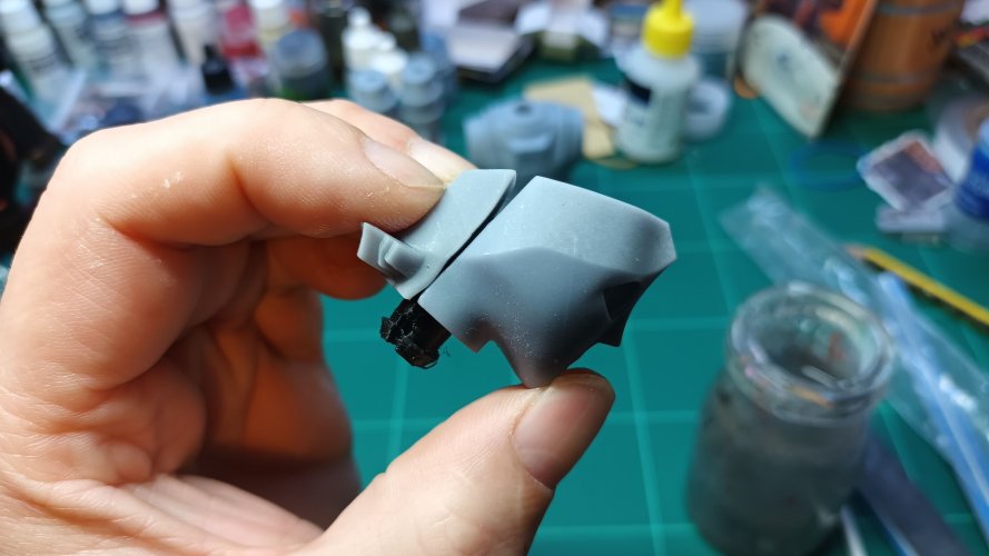

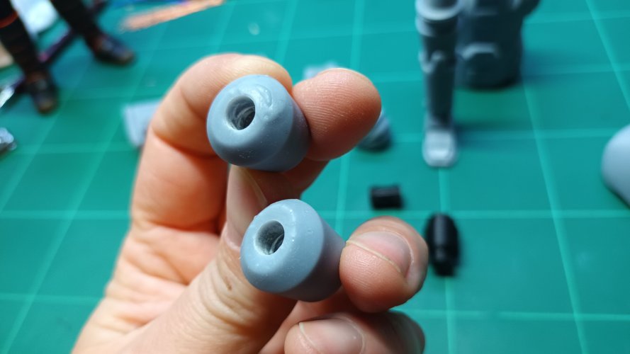

The worst join on the whole kit is the seam at the back of the head and neck, plus those splines or whatever they are would not sit flush to the underside of his helmet/dome.
It took a bit of fiddling with files and sanding sticks, but this was the best result for me. Unless you pick him up this area will be for the most part hidden from view.
After no more than an hours work Twiki is prepped for primer - sadly the rainy British weather has put paid to any further work today.

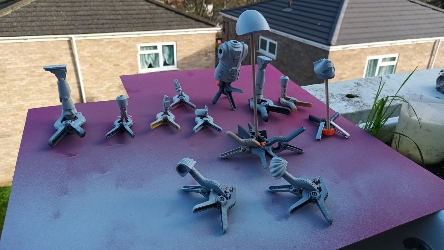

Still very cold here in good Old' Blighty, but I manged to get a few coats of paint onto Twiki.
Unfortunately, due to my old age I'd forgotten to check what I was spraying... I thought it was Fine Surface Primer, but not the case, it was one of my cans of Insignia White I had bought for my Millennium Falcon kits years ago.
I had bought three tins of White, and two Primers, but it would've appeared I'd used up the Primer on something else and as an old man, I just grabbed the nearest can and sprayed away!
Ah well, it needs to be used up & lets hope it does the job.

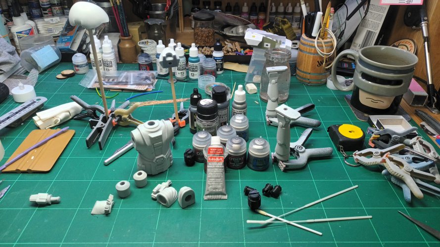

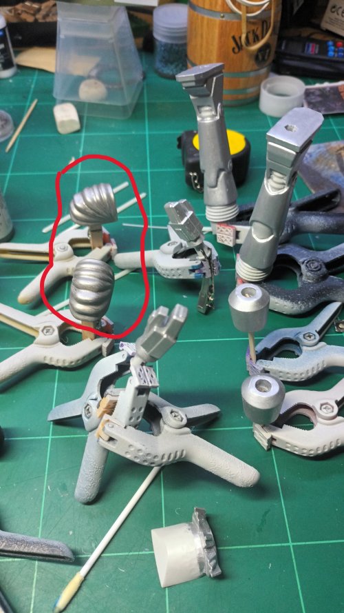

Time to add some colour to our little robotic cheeky chappy.

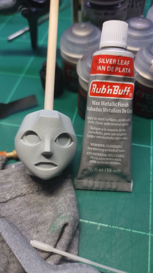

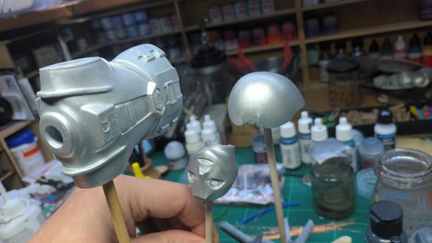

Pulled all my silver paints out along with pigments and some Rub'NBuff
Have been wanting to try this ever since I saw a certain Mr Savage use it on his models

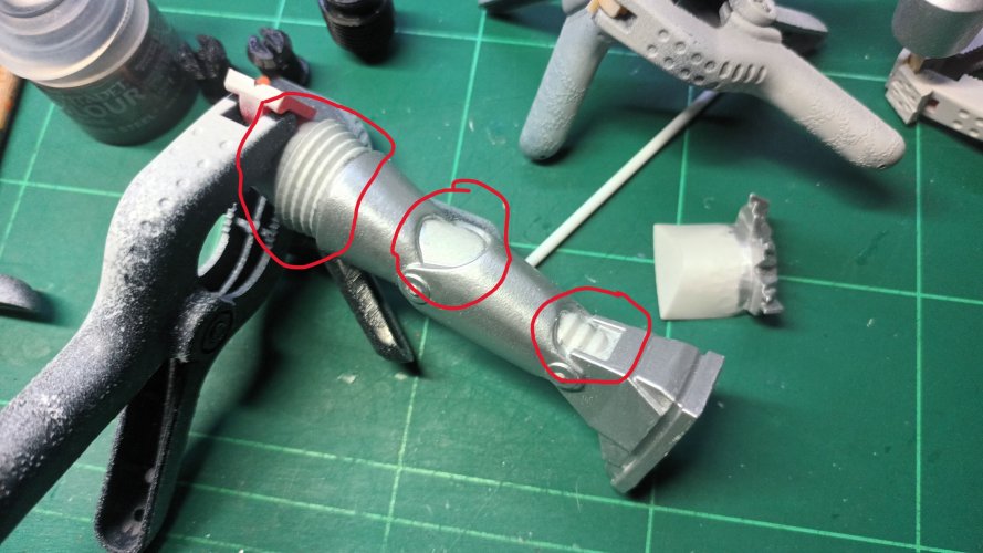

All parts received a first lick of the Buff - circled parts had paint to roughly replicate the rubbery material used on the tv shows suit.
Circled areas will receive paint as per the above picture, after a second application of the Buff
First application of the Rub'NBuff was a pleasantly pleasing and therapeutic affair - tools used were some medical covid swabs, cotton buds & an old paint brush.
HAPPY WITH THE FIRST APPLICATION OF THIS PRODUCT WHICH IS GIVING ME THE DESIRED EFFECT
THANKS FOR WATCHING...
He is slowly coming together nicely!
Yeah, fairly simple affair this one, apart from drying times, it fits together within a minute
Yeah its looking great.
Cheers matey, he'll look a lot better when I remove the sticks!
