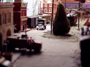

In this shot of my layout you can see the dowel overhead.
I drill 1/16th hole in both at the right hight and the use a 1/16th brass rod to span it then solder the hanger followed by the 25gauge phosphate/bronze wire.
Hight of wire from the top of your rails should be about 20scale feet so allow for the hanger the span 1/16th should be about 21 or22 scale ft from rail.
I hope that the info can help and it`s not to late .:( :)

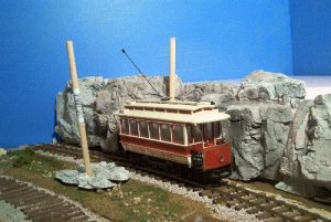

Okay, here's a mockup. The dowling is a scale 12 inch diameter, and a scale 24 feet high. The little tram is a Bachmann unit, and I just couldn't resist.
For the time being, I'd like to use this under the pretense that the logging line got a great deal, had lots of leftover poles and wire lying around, and are using him to ferry loggers to and from the logging area.
Eventually, I'd like to scratchbuild some sort of box-motor type body for the power truck.
What I'm wondering is this; do the poles look to be about the right size? How far apart would they usually be? (actual feet)
Here's the first shot...
The overhead isn't even going into the logging spurs, where the tram is positioned now. It will pass by on the "main" line, from one tiny burg to another. These pictures do, however, indicate where the poles would be in relation to where the trolley is, where the trolley pole is, etc.

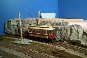

I'm sure that the usual trolley poles are taller, but this is supposed to be a rickety narrow gauge "make-do" thing. Also, the trolley's power pole will not be positioned so high when attached to the wire.
Look okay? Ideas?

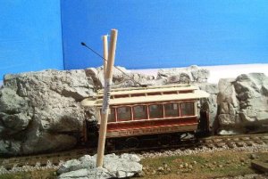

Hi Steve,
The poles look a bit to thick to me;) I would use 1/8 dowel .
POSITION:)
On a stright run you can space the poles every 10 inch /12inch you can soon work out the scale feet.
Remember to hang the over head WIRE 20scale ft from the top of the rail. Steve you can`t hang the wire slack you`ll just dewire the power pole:( .
When you meet the curve in the track thats when it will eat up your poles.
When you plant your poles do not go to near the track especially on the curve allow enough room in case you obtain a unit with a bit of a overhang (I use me thum:D from end of track sleepers to pole hole:D ) hey it works for me:D :D :D
SO Poles 1/8 dowel
1/16th brass between the poles 22ft above the wire.
Make z hanger 020gauge wire.
Solder the z to the 1/16 in place over the track.
Then solder trolly wire 25gauge phosphate bronze
