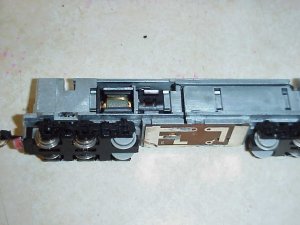

More Info
Enclosed are pictures of the engine. The top part of the chassis has a different polarity than the bottom. The motor is sandwiched between making contact with both halves. I cannot figure how both neg and pos currents get to the motor thru the wheel sets (without taking it apart further)?
Again the has motor run and the circuit board is not shorting out. The circuit board has a wire connected under it that goes to the headlight and the motor (this is still connected).
Any ideas as to how the power is getting (both pos and neg) to the motor thru the wheel sets if they both connect to the track the same way? It makes no sense (but it ran up until the other day).
Am I missing something (obviously but the question is what?)?
HELP!!!!

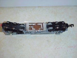

More Info
Enclosed is a picture of the engine (one of the copper connectors is not shown on the right wheelset). The top part of the chassis has a different polarity than the bottom. The motor is sandwiched between making contact with both halves. I cannot figure how both neg and pos currents get to the motor thru the wheel sets (without taking it apart further)?
Again the motor runs and the circuit board is not shorting out. The circuit board has a wire connected under it that goes to the headlight and the motor (this is still connected).
HELP!!!!

Foxman - you do have the copper wiper for the front truck, correct? The top and bottom of the frame should be different polarity as that is how the design is made.
FWIW, mine's been doing the same thing since I popped the shell off to do some cleaning on it. :( I just wrote it off as it was a fairly cheap loco that didn't have a usuable roadname for me.
1) You didn't say if it was fully assembled when it no longer runs. ie, top shell and fuel tank clipped in place. (I hope it's an open circuit, they are easier to find and put right).
2) When it's on the tracks ready to roll, does your throttle see a short or open circuit?
3) Using flying leads from your throttle (set at 1/4 or 1/3 of full) apply the leads to the top and bottom chassis. If there is no short circuit the motor should turn.
4) If the motor runs, leave one lead in place and wipe the other lead against one set of uninsulated wheels then the other to establish which set of wheels feeds the opposite part of the chassis. I suggest while doing this that the copper strip on the rear truck is held against the circuit board.
5) If none of the wheels result in the motor running while doing #4 above you will have to dismantle more of the chassis.
6) If one set of wheels in #4 above makes the motor turn, you will have to find how the other set of wheels can get power to the chassis member you had the other wire connected to.
Your trucks have metal side plates forming the top part of an axle bearing. This might transmit power to the chassis via a springy metal strip or even through the truck pivot pin! Some makers have real sneaky ways of distributing power inside a loco!
If the above doesn't help, try and describe (even with more photos) exactly what you do.
Do keep in touch, either in here / pm/ or e-mail.
Errol
foxman,
looking at the loco (and that's all I can go by), you may have done what I did once when I pulled a loco apart. I put the wheels in the wrong way round.
The loco had pickup from the wheels on the left of the front bogie, and pickup on the wheels on the right of the rear bogie. I put the wheels of one bogie in the wrong way round, and had both the front and rear bogies picking up current from the same track. Took me ages to work it out. Perhaps you have done the same or similar????
Dunno.... just a suggestion.
the answer
It was the wheels. Getting a magnifying glass there is a difference in the wheels and the way they were attached to the axle. Installing them the wrong way just shorted everything out.
