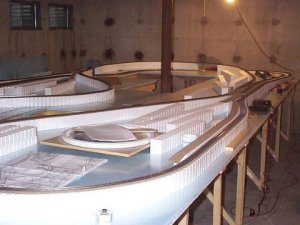

I have used only glue to put my track in place. All track is mounted on cork roadbed. I used map tacks to hold the track in place while the glue dried. The cork is either glued to the blue insulation board or to the Woodland Scenics risers that I use. The picture isn't the best, but gives you a sense of what I have been doing.
The ONLY challenge I have had with using the glue is when I needed to take up a turnout it came up fine, but I had a hard glue residue to deal with. I finally just dampened it well and let it sit for awhile and them wiped it off! So really no problems.
One caution if you use map tacks to hold the roadbed or track in place while letting the glue set... use lots of them, particularly on curves.
