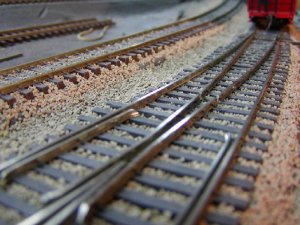

This thread is so old I had forgotten about it, I had built the curved superelevated turnout I mentioned in it. Everything seemed to run well thru it, then a SD7 derailed. Upon checking, I found the SD7's 3 axle truck was having difficulty negotiating the difference in elevation as the routes diverged beyond the frog. I removed one rail, slightly sanded a couple ties and all was well. This was important to me as in a couple years I will upgrade the four track main of the NYC portion of my layout to use superelevated curves and I want (need) to install crossovers there. It will be an interesting project and now I know it is possible. I do agree with Tyson and Catt and others who state that flex track looks better than handlaid and have reached the point where I only handlay turnouts because I can have them conform to my requirements. The ballasting in the photo is not finished, I do that after scenicking the rest of the area.
