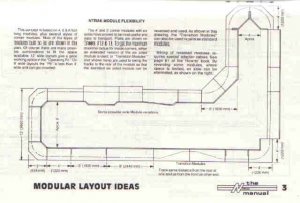

Ntrak rules allow a module to run the tracks at the back which will give room to build that magnificent station Arlaghan.
The only thing is we will then need two transitional modules. One to move the track to the back then the other, to move the track back to the front.
Also, I saw somewhere that the front can be extended 6 inches
out from the 2 foot edge. The biggest thing is that if the track is
an oval you have the same length on the opposing side. What I
mean there is that the width is playable, just as long as the tracks
at you areas end match the next guys.

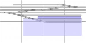

Ok, folks. Here's what I came up with:
Judging by Robin's post, it looks like I can make a module like one of the ones on the far right: Being a module with the tracks towards the rear, and the space for building towards the audience. I'm not sure if there is a backdrop there on the audience side?
At any rate, assuming this adheres to the standards, and is Ok with all parties present, here is my proposal. It kind of takes into account all of your suggestions: Part of the tracks inside the building/structure, and re-allocating the given space.
The top branch could serve as a place to load freight - perhaps put an industry up there, half-way into the backdrop, or maybe an empty area to park unused passenger cars until they are needed? This branch is optional... opinions welcome!
The bottom branch is where the station would be. The bottom two track enter the structure and would be completely covered by the building, while the third track would be accessible from a loading area which is the smaller blue rectangle. Possible a stairway/ramp going over the other two tracks (or from an upper floor) and leading down to this loading area where passengers/crew workers could get to the other two tracks without having to cross any rails.
Please, tell me what you think? As I know very little about prototype operations! Thanks! :D
EDIT: The turnouts on the mains are shown as #6, because that is all the RTS software has, but I left space there for the #8 Peco switches which I have already purchased - the short straight pieces inserted in between would be removed to make room for them.
Arl, why are you adding turnouts to the blue and yellow lines? I see your plan for the red line and the turnouts for the station but I do not understand why you would want the cross over capability. I think you would also be inviting a wiring nightmare to your module when you throw a turnout or switch to another line. Think I would just add the turnout into your station and siding and then add a kill switch to those tracks to isolate it from the entire module. This way you could park an engine and leave the red line open. If you are going DCC, in that case, disreguard my comments?
I see your point Bill about crossovers between the blue and yellow lines but there are a number of module plans that show crossovers between them. The two lines would be electrically separated by gaps in the crossover but there could be very different voltages on each of the tracks making a loco doing some funny things as it tries to cross over. Any experienced Ntrakers out there that can talk to this?
Blocks? Cab control?
I'm not sure what those two terms are... but isn't there a method where a layout that has two independent loops with two separate power packs... then to run a train from one side to the other, you would set the power pack on the other loop to the same setting as the one it's currently on, until the train completely crosses over?
But Bill. I see your point too! My reasoning was to supply our group with a means of switching from track to track using left hand switches, in the hopes that some other module would do the same with right hand switches... it hadn't occurred to me that one track could have reverse polarity and cause a short-circuit!
I second Robin's request... any professional NTrakkers here who could step in?
The only real concern with the crossovers is to be sure that the track power is going in the same direction on both tracks.
By the way if your planning it so that you can cross from the outer most track to the inner most track in one shot DON'T!! What you have created is one very nasty S curve that will cause nothing but trouble.
My suggestion would be to put the crossover from #1 to #2 at one end of the module and the crossover from #2 to #3 at the other end of the module.Be sure that you use insulated rail joiners between the turnouts where they connect.

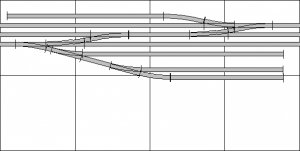

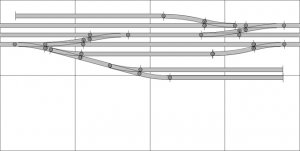

Which do you think is better?
Thanks Catt! Your comments are well heeded!
Now my question is: Which is preferable:
This one:
Personally I would prefer the first one as to me it doesn't look so cluttered and busy.
The first one aslo allows the train to switch from track one all the way to track three.
Hopefully you will get some input fgrom other members of the Gauge on this.

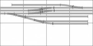

Bikerdad, I like your idea... see it incorporated below. This gives me an excuse to get those double decker tri-rail commuter cars that Athearn put out a while back. :D
Catt, I like the first one too. I did some research on the #8 switches that will be used in that area, and found that between cross overs, I will only have a 6" section of straight track. I was told that this would be fine. What are your thoughts?
You can see the data I found concerning the #8 cross overs here.
Here is my updated track plan. Please keep the comments coming! I think it's nearing finalization, a couple of thumbs up and I can move on to construction. Thanks again, everyone!
Arl,is that six inches between crossovers or between the #8 turnouts making the crossovers?
Either way should actually work just fine.One thing to concider though is your going to have a lot of trackwork in 48".I know we discussed making the module a two parter to make it easier to carry on the plane but I have another idea for you to concider.
How about doing it as a 6'module but in three pieces.You would need some way to key the sections so that they would sort of at least align themselves automatically.
If your interested let me know and I will build a 2' module to balance out the other side.(or maybe build two 3' modules for the other side.
I would also suggest that you contact the intended airline about their carry-on rules.
