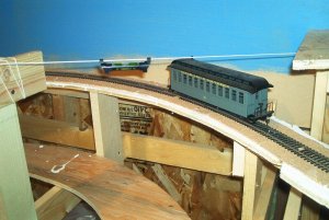

Here's a useful addition to the 3 foot ruler with the inset level...a string level. I suspect that this is "old hat" to most of you experienced folks, but why not share anyway?
I'm finding this quite useful for winding along my branchline as it curves its way through the as yet unfinished mountains.:)

Hey Bill, Astring level is a small level, the one I have is about 2" long. You use a lenght of string stretched tight from on point to another and hang the level on it ( it has small hooks on top) then you can move either end of the string up or down till it is level. Comes in handy over large open spaces in track work where you can't fit a large level!!:eek:

I messed up, having planned to include a picture, then messed up again by double threading...so here is a shot of my windy branchline under construction.

Thanks Steve. i thought maybe the grade measuring device was like a 6" level with gradients on it.
Looks like your right into your layout. Looks good :). i like the looks of the On3 cars. This year i too have a small On3 Train Set. The cars are all decorated and lighted on the inside. i'm still waiting for the rest of the set to be delivered.
