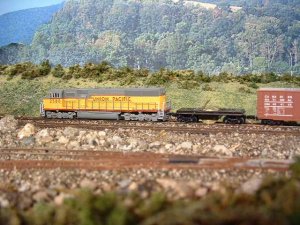

For track cleaning after painting track and ballasting, I use a bright boy. For regular track maintenance I use a Centerline Products N scale rail cleaner #D12. I saturate the absorbent roller with goo gone. Haven't tried anything different so far. The fluid that remains on the track(before evaporating)loosens built-up crud from the wheels of any loco and cars that follow. After several passes, the rails and the wheels of all rolling stock are electrically clean and free from slippage. Now I only have slight grades on my main line so grades aren't an issue. My locos pull 20 cars OK. Haven't tried more yet as so far thats all I have changed to kadee wheel sets and set weight to NMRA standards. More cars to be re-done as time goes by.
Here is my SD-60 pulling the track cleaner as well as 19 other cars.
