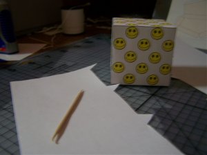

Gathering the Materials
Alright, so the attachment below shows you what your desk or workplace should look like along with the materials placed onto it. In the next posts I'll make sure to go over those materials and their uses, and what each one should be used on.
So, let's get cracking! If you don't have the materials here, grab a little pencil and paper, list the ones following these posts, and go down to the store! What are you waiting for?

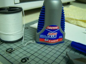

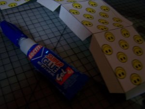

-First Glue, Needle-
Loctite Super Glue Gel Control
Why? Well, this will be great for small areas in which there will be MANY in this Gundam. It'll clog up a few times, so you'll need to keep caping that glue after you use it. Use a sharp object and pierce the nozzle if glue starts to "Crust" Around the nozzle. This costs, at Target, at the STORE $2.69. Preety expensive, but it's worth your money...
Needle
Why? Well, first of all, you'll need this for 'clogage'.
Aka, Clog. The Loctite Glue tends to clog up after a while if you don't cap it and or smeaer it with the nozzle. And TRUST ME, you will do it and you won't even know it.
Also, you'll need it when piercing the JOINTS.
Yes, it gives you a sort of marker when you have to actually cut the hole with your X-acto knife.
Go get these things and come back for the rest!

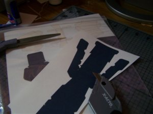

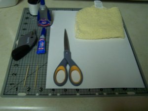

-Scissors,X-acto, Glue Squeeze, Cardstock, Rag-
Scissors
Preferably, for all those who can't handle the X-acto, like I, I would say use the scissors.
Why? Well, this way you get more grip and can hold the Model without accidentally cutting off the edges. Again, this is optional.
X-acto
Prefereably, for all those who CAN hande the X-acto knife, go ahead, by all means, use it. But that means you'll also need a RULER.
Ruler- For Lining up the X-acto Knife's path.
Why? Well, obviosuly with the X-acto knife you want professional cuts, so you'll need something to keep your cuts going STRAIGHT. Again, the X-acto knife is Optional, it all depends are what you're most comfortable with.

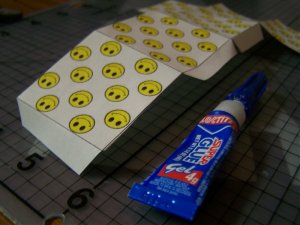

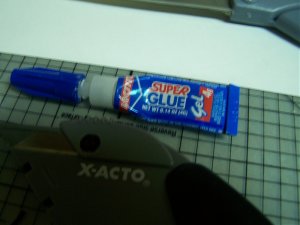

Glue Squeeze, Loctite Super Glue Control Gel
I know, I know, why would anyone use this when you have a bottle already?
WHY?
Well, this one is Special! It doesn't clog up, however, excess glue does form around the nozzle...But it does not affect the glue's performance. Each time, all you need to do is give this a Teensy weensy squeeze. Let's put some emphasis on that. All you have to do is give a TEENSY, WEENSY, SQUEEZE, every time. Plus, this'll be alot of help when you're doing long tabs....
Cardstock
Obviously, you'll need this for your model because....WHERE ELSE WILL YOUR MODEL BE PRINTED ON?
I highly suggest, White Cardstock from Staples,v 67 lb, and 148 grams.
Rag
Well, you'll see why.
Why?
For joints.

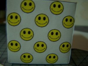

SMILEY CUBE!
WHY?
You may be asking yourself...why not a different cube? Well, like the description says, this cube is uplifting! So USE THE SMILEY CUBE.
Dowload link is here: http://forum.zealotmodels.com/downloads.php?do=file&id=44

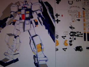

Alright, so let's start off by opening up pepakura. Oh! That reminds me, here's the download link to the pdo file of Hazel Gundam.
papercraft
Scroll all the way down until you see Hazel Gundam. Click it, and save the file. Wait for the download to finish, then procede in opening the PEPAKURA FILE. there'll be the JPG files, but only use the PEPAKURA FILE.
Why?
Well, this guide is basically focuse ON the pepakura file, however, if you wish to use the more decaled, but low resolution JPG's that's fine. Just apply these instructions to your build.

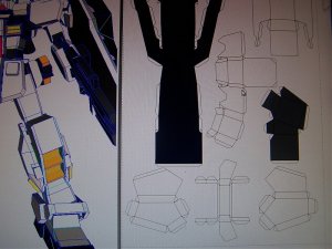

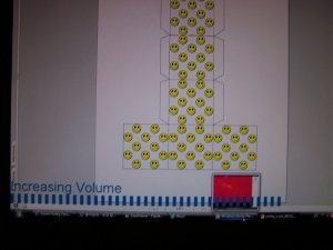

So: After you've opened up the file, locate the page with the foot. NO. Do not print out the page of the foot that is scrambled. I'll instruct you on what to do with that later.....
To print, count the number of pages there are pieces of the model on them. Locate the page in which the unscrambled foot is. Click print, and arrange the retype the page number in it. This all depends on how your printer menu looks. After, get ready for some modeling.

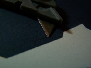

Step 1: SCORING
Definition (In my opinion) I think scoring means to shave layers of cardstock off of your model to allow easier folds.

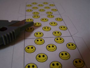

So, now, grab your Smiley Cube that you printed, and let's do this!
Why the Smiley Cube? Well, like it says, it's uplifting!
Why the Cube? Well, it provides an assumption of measurement without using a ruler. I think it's simpler.
I suggest, for somethingas such, that you score HARD and FAST. Make sure to use the X-acto knife, I've picked up form Lex, a moderator here, or admin, that a wasted Ball point pen works nice too.
So, to score, follow the valley/mountain lines, and run the blad over it, also go over the tabbed lines.

Almost there, now use the LOCTITE SUPER GLUE SQUEEZE GEL, give it a little squeeze and meduim sized glue should come spurting out. Apply glue to each tab. After, glue each tab to it's corresponding side. If you didn't get that, just look at the beginning of log 8, where the pictures are!
Log 8: Let's model! Part 2
Step 5:
Toothpicks?!?!?!Of course! This is where they finally come into play. Use the toothpicks to smear any excess glue off the sides of the cube.

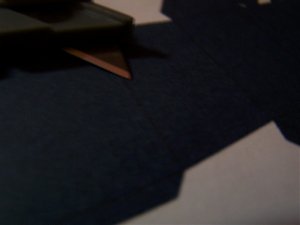

In modeling this foot, you should begin with the Blue piece which the X-acto knife is pointing to.
Why? Well, this piece is the beginning of your model, it's what it stands on. So let's do that first.

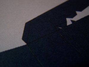

Step 1: Using your X-acto knife, score LIGHTLY on every section of the model. This means score lightly on the Valley/mountain Lines, and even the Tabbed ones. To see what I mean, view the second attachment in this post, and look at it very carefully. You can practically, see no line that left a scored mark. This is what you want for this section.
Why? Well, If you compared this finished foot to the Hazel I'm currently working on, you'd see the major difference. There's a white line producing after you fold a mountain or valley line IF you scored it too hard. Otherwise, if scored lightly, it'll come out with most of the color still on it.
The first image points to a Valley/mountain fold line.
The Second image points to another Valley/Mountain Line.
The Third image points to a tabbed line.

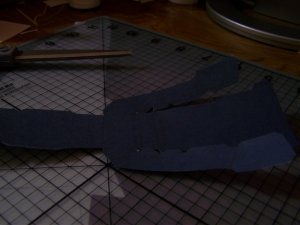

Step 2: Cut the piece out of the paper. What does this mena? Exactly? View the attachment shown in this log.
Semi Step: After removing the foot piece from the rest,finish scoring the piece, and you should have scored lines end up like image 2.

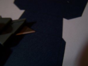

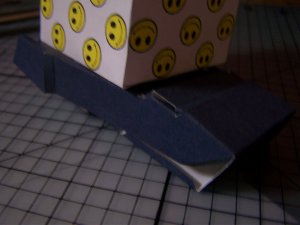

Step 3: Cut.
Like before, cut around the piece, using the outlines of tabs and sides for guides. Your ending mark should end up like the image shown in this piece of Log 9.
Log 9- Hazel's Foot
Step 4: Fold.
Not really much description I can really can go into here, but just fold what you scored. Use the lines , in which you scored, I should say. You should end up with an object much like the one shown in the attachment. Here, the Smiley Cube! Is used to portray an assumption of size upon your mind.
