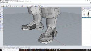

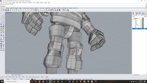

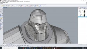

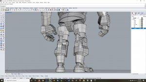

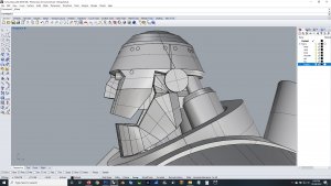

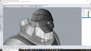

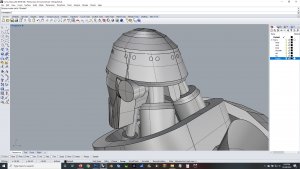

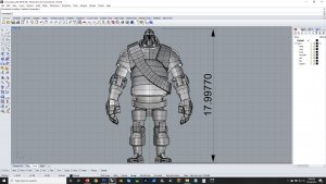

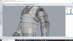

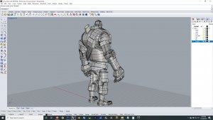

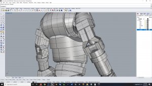

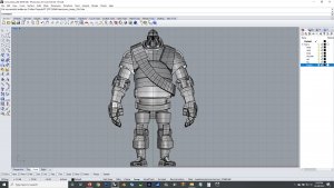

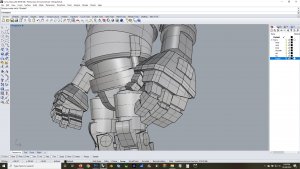

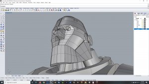

It is my most favorite character in TH2 next to Pyro. I don't know what scale it is. But right now, it is a lot bigger than my plastic 1/6 Three A Heavy action figure. Most of the parts are rough out, but the hip joints. I am planning to make it completely poseable. And the gun too, I still need to do. I got a long way to go with this guy.
I'm blown away already..! Always keep in mind the thickness of the paper when you make the joints. The connector tubes must be a tad smaller than the holes they are put through to make sure the part is moving. A rough estimate would be a decrease of the diameter of 0.4 mm (depending of the kind of paper used; at least that was what worked best when I built my 1/6 scale Crichton ). You can always stiffen up a loose joint by wrapping some layers of tissue paper around the tube.
