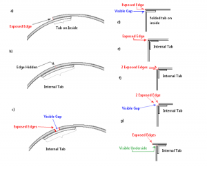

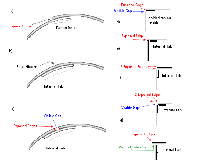

I just found this thread and felt like putting my 2 cents in because I'm not totally anti-tab. Undoubtedly using internal tabs will generally result in a nicer finish, however it is possible to make an argument in their favor particularly where novices are involved. Actually on some level it's akin the argument for trimming off location pins on injection kits.
The attached image illustrates the typical situations. In figure "a" you have joined skins, where one has a tab that fits under the other. This leads to an exposed edge and a visible step. The thicker the stock and the more colorful the model the more noticeable this is. It is also hard to blend with a pencil or pen without marking the other skin. The solution is figure "b", an internal tab to butt join the edges. The edges are hidden and problem solved. Unfortunately it is possible to introduce the problem shown in figure "c" where the edges didn't quite butt against each other when the glue set. Now you have exposed edges and a visible gap which might be of a strong contrasting color. For a beginner, getting a long seam to perfectly set with the edges against the edges may be difficult so the builder needs to judge for themselves which method for this join they prefer.
In the second situation (figs d,e,f,g) is a corner join. With a folded tab ("d"), there will be an exposed edge and likely a visible gap where the tab folds in as the card stock will have a very slight curve at the fold and not set flat against the opposing piece. This gap can be ameliorated by scoring the fold point ahead of time and is less noticeable on plain paper as opposed to heavier stock. The other solution is the usage of an internal tab as shown in "e" which while still leaving an edge can hide the gap. Typically this edge can be easily blended in with a color pencil or felt tip pen. Unfortunately there are 2 possible problems that this solution can introduce, particularly for the beginner. One is placing the internal tab flush with the edges which will result in exposing both edge as shown in "f". This might not be serious as you may still be able to blend these edges in. The second problem is actually bad placement of the internal tab and the edges don't meet in figure "g". You have either exposed edges and a visible gap as shown or an even worse situation if the tab is short from the edge exposing the under surface. While the problems of "g" can happen with folded tabs as well it does limit the problem to only one edge.
As I've said on other threads, tabs make life easier for the novice, but there are many situations where things will look better if you do use internal bracing instead and set edges on edges. A novice may also consider if the benefit outweighs other issues they might consider important like build time. From my point of view when designing a model, the builder can always cut the tab off.

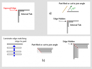

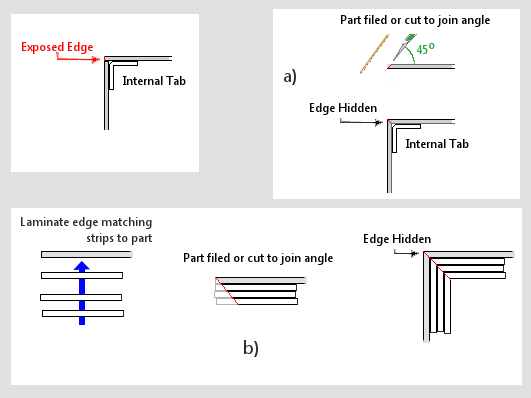

I think figure "a" in the attached image illustrates what zanthros is talking about. It's akin to the kind of thing you would do in wood joinery to hide the joint. For a simple right angle you need to get both edge parts to 45 degrees by filing or cutting with a sharp edge. The parts are then joined edge to edge, preferably with tacky glue that sets relatively quickly. The join angle will vary if the corner is at something other than 90 deg.
Cutting and controlling lightweight stock can be tricky so another version of this I've seen on build threads is to build up the edge by laminating strips of stock on the edge (figure "b"). This edge is then cut or filed to the right angle for the join. The thickness of the lamination might preclude usage of additional tabs or reinforcements.
These methods do require more time for prep and execution, but the results may well be worth it in the improved finish. Some burnishing techniques can go even further in melding the edges together, but I haven't tried that myself. It can be practiced on scrap before trying it out on an actual project.
From a design point of view, the best is to eliminate the visibility of the join in the first place. By this I mean consider the possibility of hiding the edge behind an obvious detail. A lot of the stuff I do are SF subjects which have visible paneling, "greeblies", or other parts that can be conveniently aligned or placed on the seam. In these cases a seam is not a bug but a feature. Join issues in these hidden edges then become less important.
