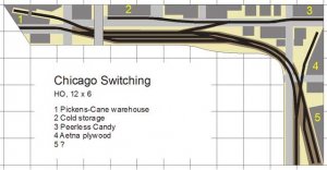

Hello cyclingshane, your layout has the same size as mine before I had to remove the shorter leg of the L. Here is the trackplan for the layout I wanted to build. Perhaps it might act as a starting point for you to develop some ideas.
I really like that. There is a lot going on, and lots to do. I'll see what I can come up with. Maybe I'm looking at this the wrong way.

cnw1961 - If you don't mind I'm going to "borrow" that track plan. Everything I come up with is close but not as neat looking or stinks like road kill on a hot day in July. I may vary it some when I start to lay down track, however I see all the elements I could want in a switching layout. Did you do that yourself? Thanks for posting it up.

Feel free to do what you want with my track plan. I only hope that you post some pics of what you are doing. :wave: I made this plan myself. It took some time – it must be version #62533215 :D . I think a track plan for a small switching layout is a real challenge. I was inpsired by this web site on Chicago North Side switching operations: http://www.mannresearch.com/chicagoswitching/v4/ .
I am building a modified version of this layout without the short leg of the L using Peco code 75 track. All turnouts are #4s. My biggest engines are a P2K GP9 and a Trix Mikado. Both can handle these turnouts without any problems.
