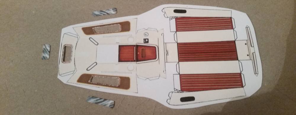

Next I started to glue the cabin and deck part in shape, one glue flap after the other, cautiously not to glue to early some of them, always checking with the cut out deck part.

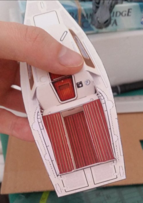

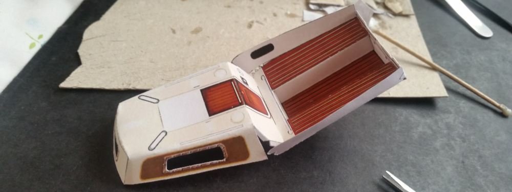

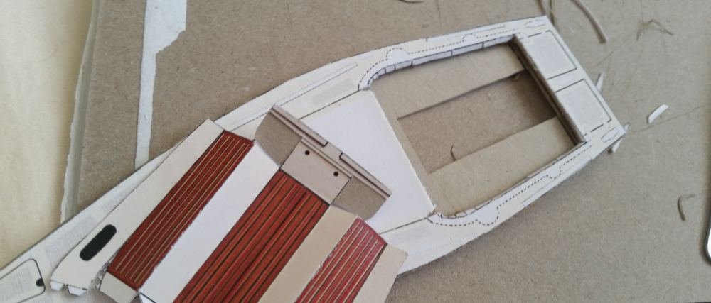

And now I'm confronted with the first problem. It seems like the bench part/rear part of the deck is too narrow for the cut out hole in the deck piece. Maybe you can see what I mean in the picture below. I'm not sure but I think the outer egde of the brown bench part should sit on the thick black line on the deck piece:
I am sure I printed every page with the same scaling in the printer option. And also the spare prints I made are the same scale, so that problem could not occur because of mixed up prints.
Does anyone here already built that boat? Perhabs I glued the bench parts too tight and narrow but I aligned the glueing flapa properly

I managed to get past that misalignment. I cut out another spare cabin and did not glue every glue flap together in the first place.

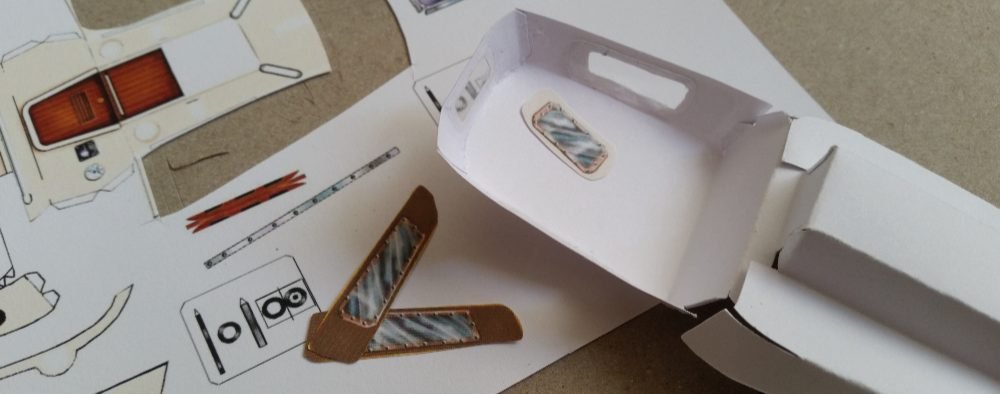

Instead I took some grey board piece, cut out the space for the part in the middle that will go down below the deck level. This way I also have a surface to put and glue on the seats of the "bench" (I don't have a proper name for that space on the rear deck, which is for the people on the boat to sit down there; hope you get what I mean).
In that instance I also glued some plastics for the windows of the cabin. The plastics I you use doesn't hold with the regular glue, so I had to use fast glue.

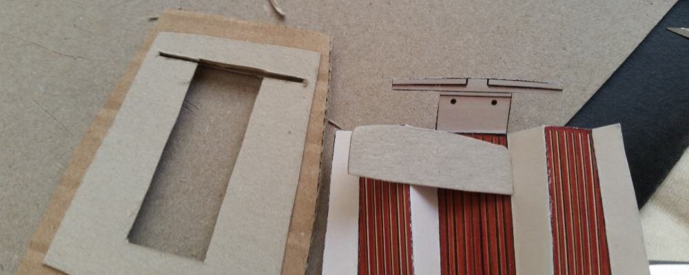

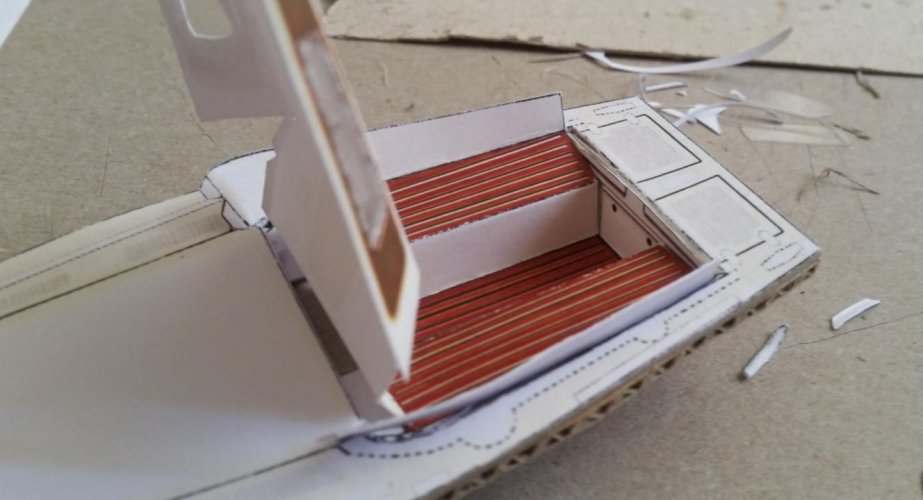

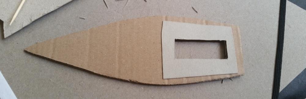

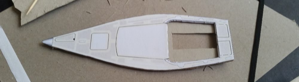

The rear end of the cabin/deck piece is really thin and delicate. In the first try I wasted it completely while trying to put the whole piece together. So I decided to strengthen it with grey board. The board with the rectangular cut out on the bigger deck piece needs a slot for this to work (see picture below).
I also got rid of the glueing flaps on that rear part and on other sides too. Building Fabrizios locomotive gr. 691 almost completely without flaps to glue assured me that they are not necessary everywhere.

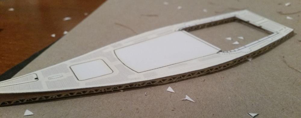

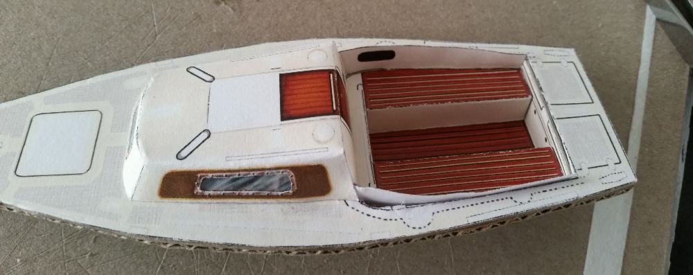

The two deck parts glued together look like this. Fitting almost perfectly
I took the third and last spare print, that I brought with me, to cut out window parts of the cabin, glued them on the inside on the plasticpieces to achieve a recessed window look, retaining the original window glass drawing

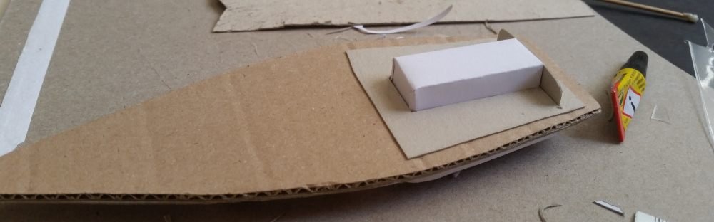

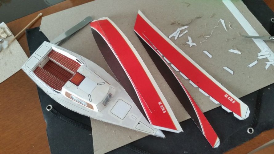

After that I went on with the sides of the hull. I got rid of the glue flaps on the upper edge because I don't need them anymore. The deck is now thick enough with one layer greyboard and one layer corrugated board. That will be sufficient to glue the side parts of the hull to it. Now it really starts to look like a boatXD
This looks great. You did a nice fix.

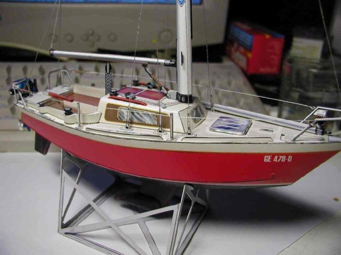

Nice. I have a bit a hard time to make out the details of the pictures. I have a few of another building thread, the low res ones from fabrizios page and a high res of fabrizios from somewhere else (found with google). But I have to think about where all the parts fo tht I cannot see. And how to build the takelag properly. I don't know nothing about sailing
Here is one high res of fabrizios:
With that I can make out many details but not all.

Oh no, you might misunderstood. The last picture is from fabrizios page, found on another website. I just posted to show as reference. That's why I wrote "here is one high res of fabrizios" , should read " ... of fabrizios pics. Sorry for not to be that clear. Just wanted to show that reference, the details that I can make out and what I cannot make out because it is obscured in the foto.

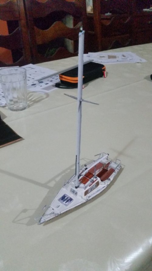

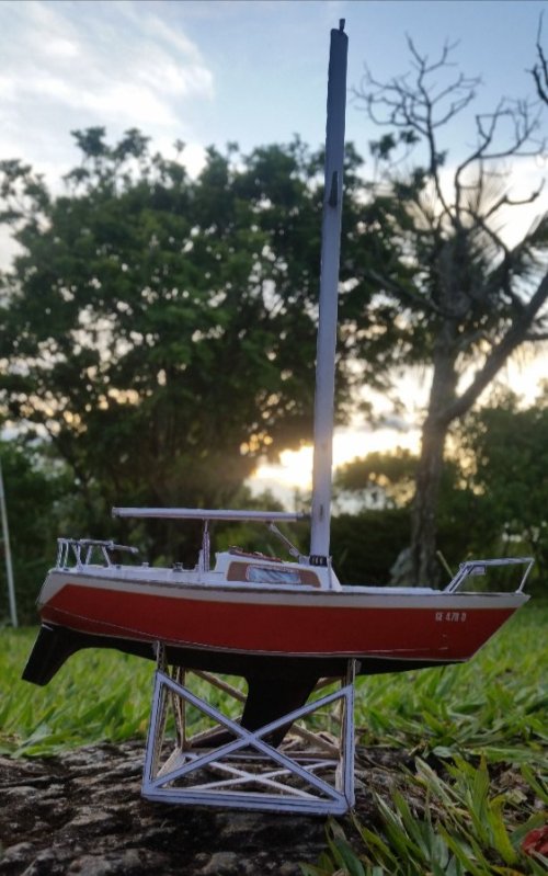

I'll post pics from my build a bit later. Today I did much and it is nearly finished

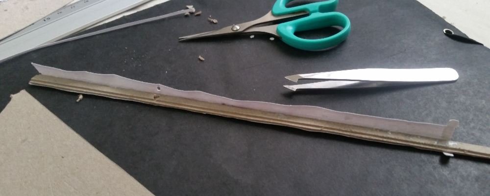

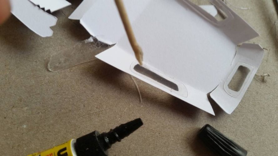

For the mast I laminated three stripes of grey board as a core to stabilize.

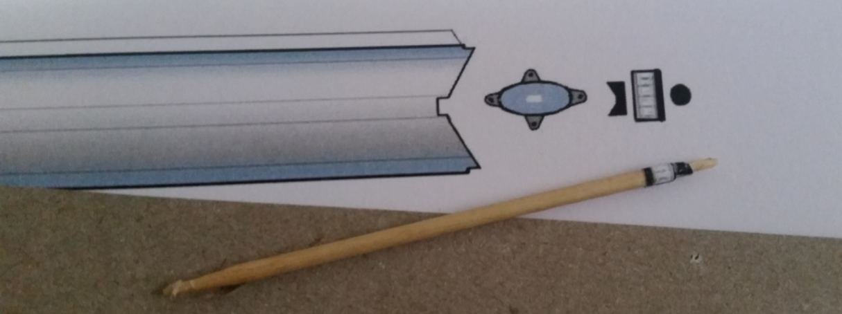

The tip of the mast I glued to a thinned out toothpick tip.
I cut a hole through the cabin and the base of the deck to put the mast through it. For that I made the core of the mast a little bit longer. The idea is to have that mast detachable for transport. To endure multiple attachments and detachments I hardened the base of the mast and the hole in the cabin with fast glue.
These works I did the last days.

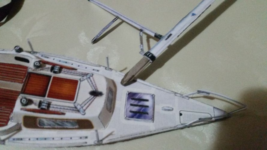

Yesterday I did much of the details on deck:

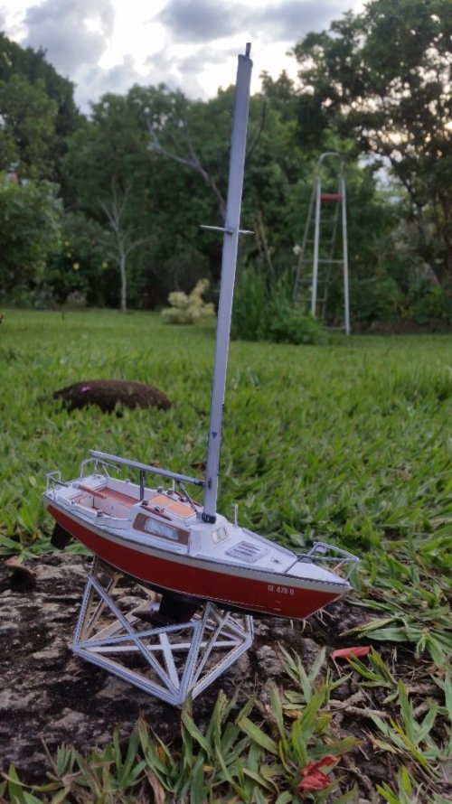

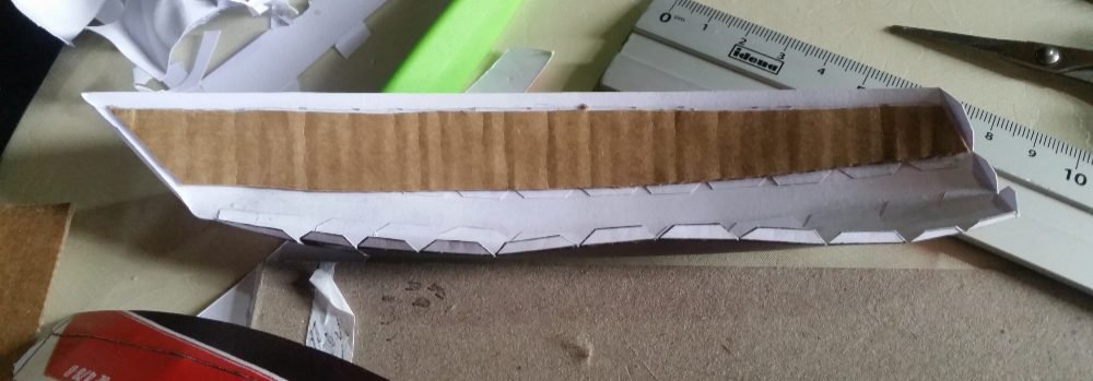

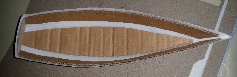

Today I did the hull. I stabilized the sides with corrugated board.
The underside with three layers grey board (now I definitely ran out of it^^) and one corrugated on top of them. That way I hope the center of mass is located low enough to not let the boat flip so easily. Because with all that board in the deck and the mast it was quite unstable on the stand.
Now the only things that are missing are the engine at the rear and some takelag.
