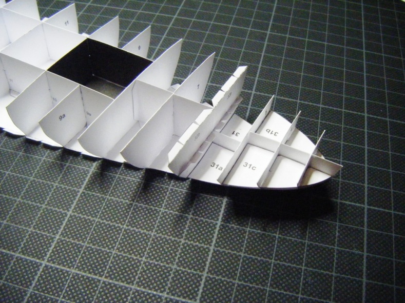

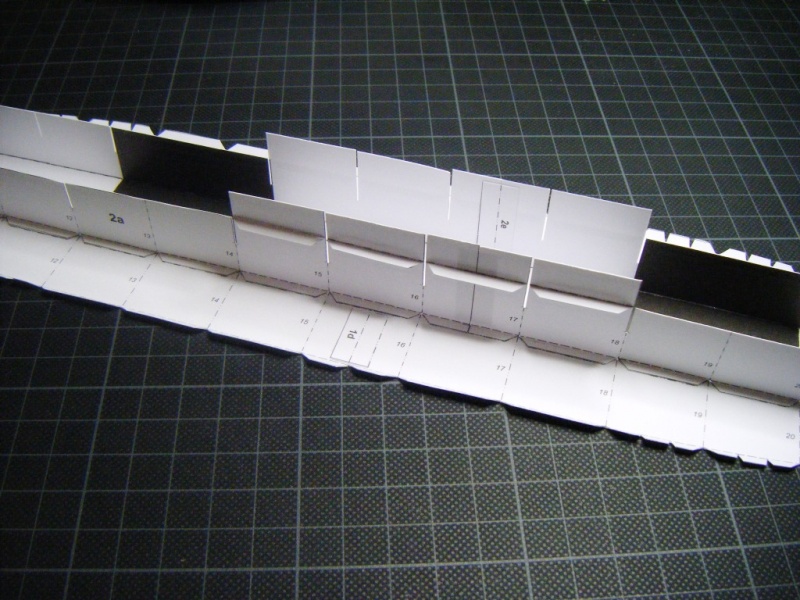

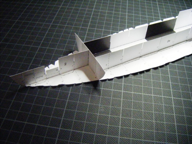

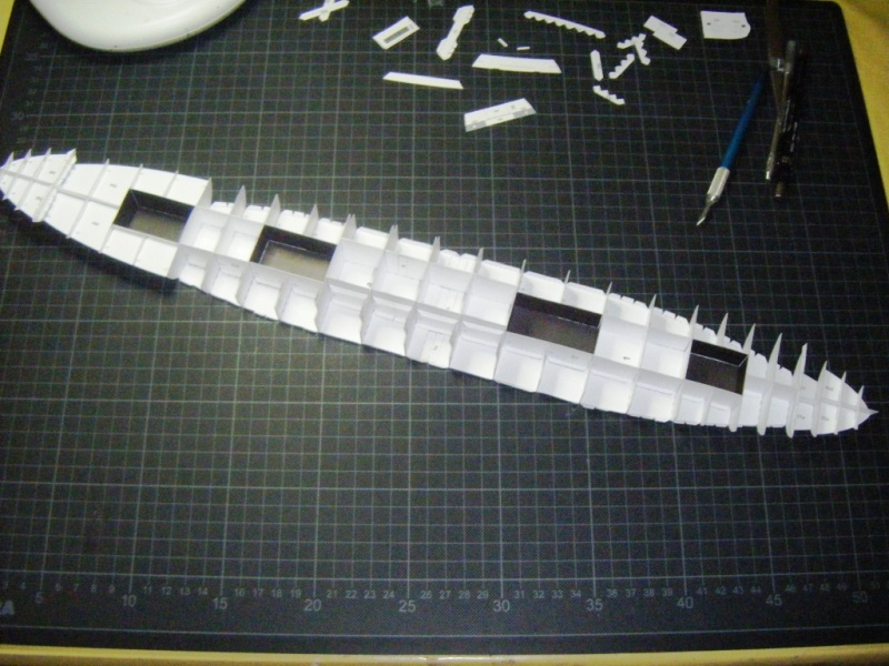

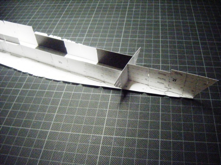

Hello Friends,
Progress on the framework.
Kind Regards,
Cris

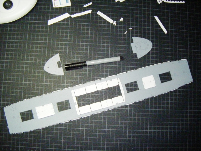

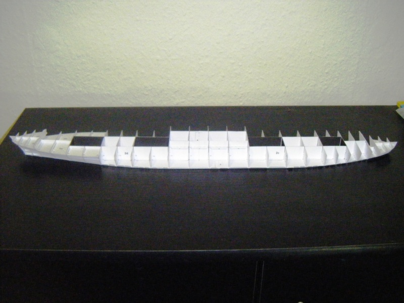

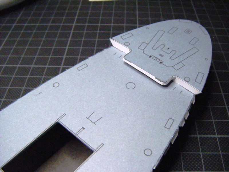

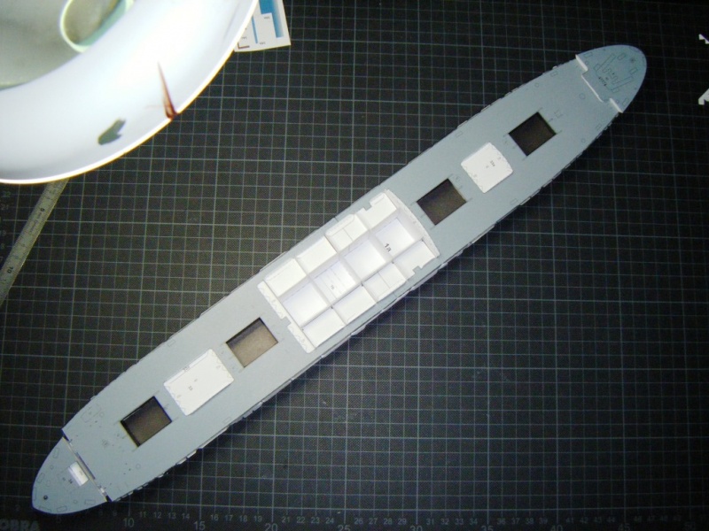

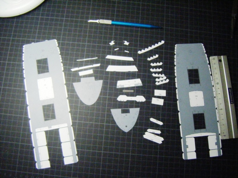

Hello Friends,
Completing the Framework and starting on the decking.
Kind Regards,
Cris

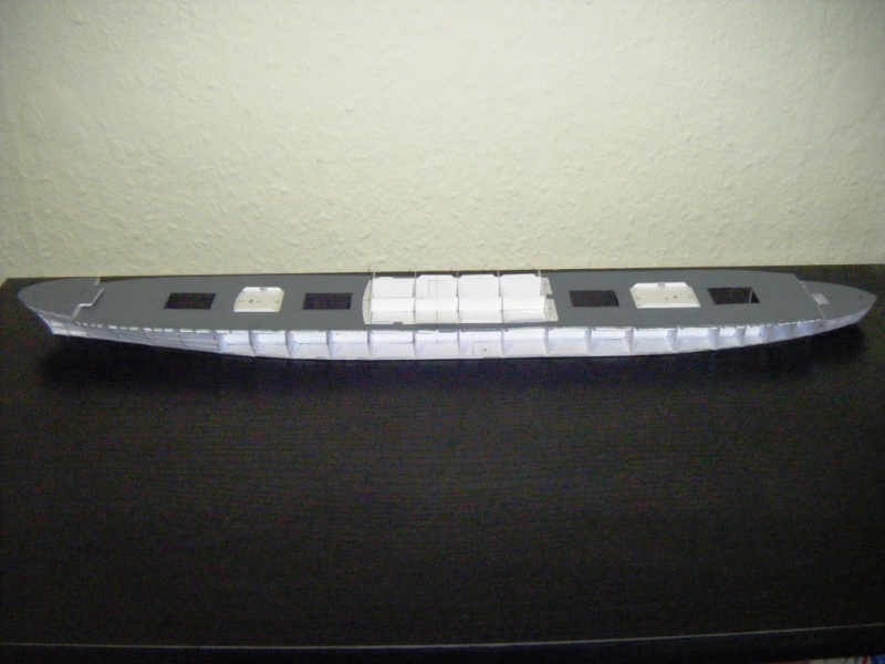

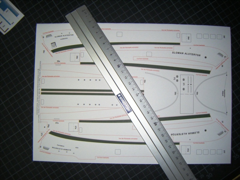

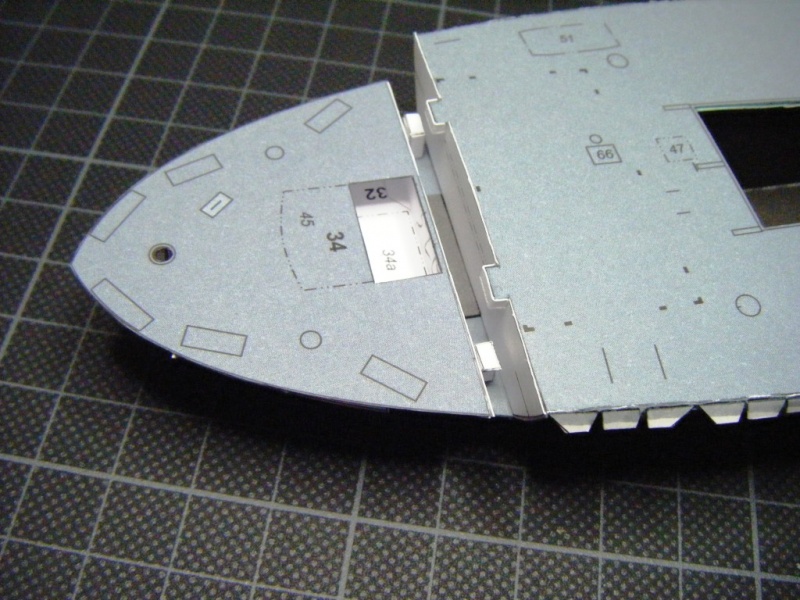

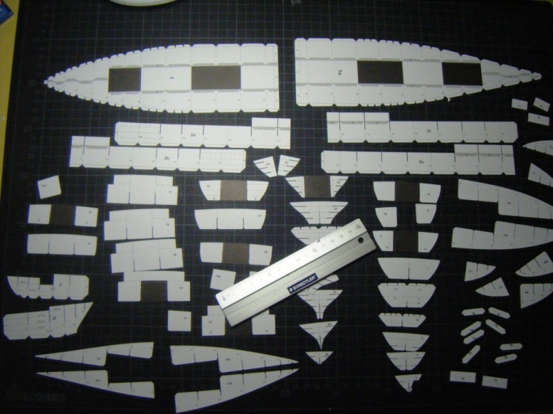

Hello Friends,
Thank you for your kind words!
I neglected to mention that the model is comprised of 1645 parts with a completed length of 56cm or 22.5 inches.
The additional lasercut set has about 65 parts printed on colored medium and heavy cardstock.
Offhand I am guessing around 300 parts for the Canal base.
So the decking is complete. The last picture shows the hull plating prior to being cut out.
Kind Regards,
Cris

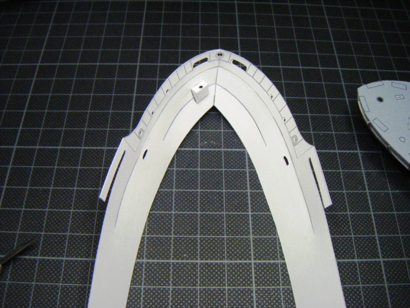

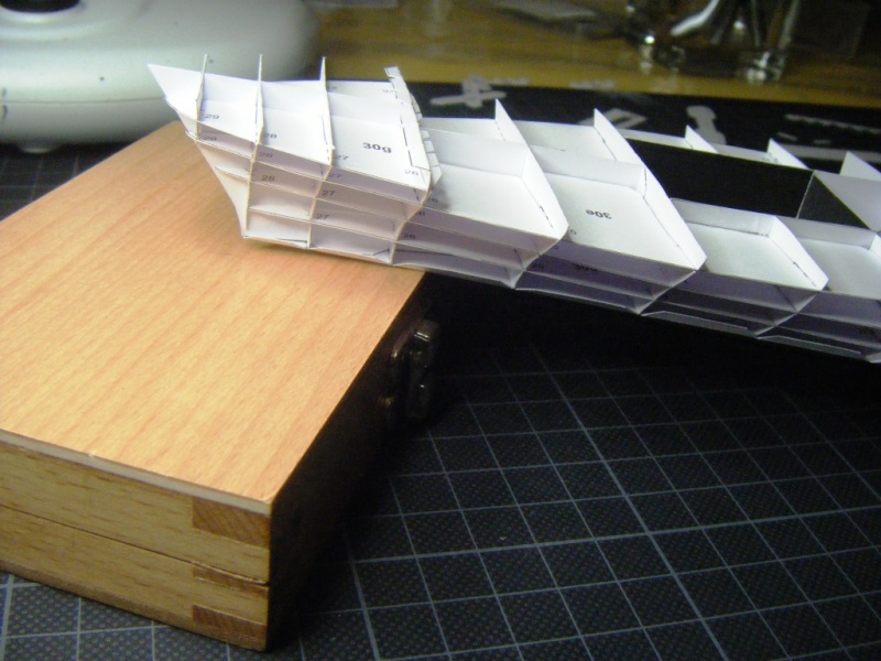

I believe, as the formers look thin, you will have to glue strips on the end to prevent the bulkheads from giving the "skeleton" effect throw the sides. Or you will have to use thick hull skin sidings. You could "sister" the ends of the formers to allow the distribution of the glue and create a wider surface for the skin to hold onto. In any event, it's something to watch for on such a beautiful model! :)

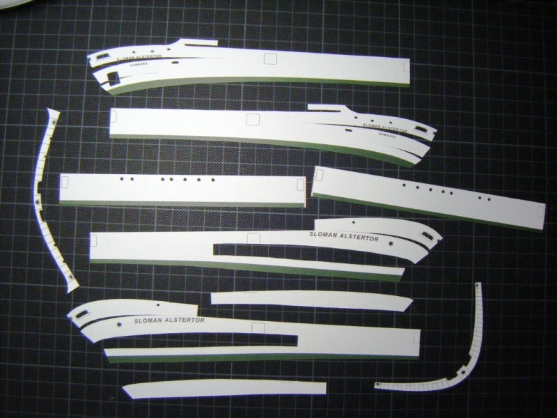

Hello Friends,

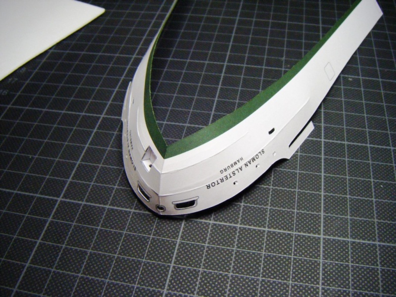

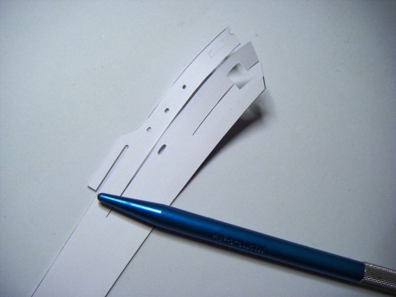

Some progress on the hull. The most nerve wracking part of the entire model lies just ahead...
@Zathros: For waterline models nearly all of the German publishers use a technique where the angles formed by the base plate and the decking form the hull bond line. The hull rests against the frames but no attachment is made. For full hull models below the waterline generally the hull plating is perpendicular to the main axis in which case the hull does attach to the frames.
Of course none of that will prevent me from making a right disaster of the hull :)
In the second picture even though its very hard to tell, I use thin foam sold in stationary stores or large discounters or craft stores in the Scrapbooking section to assist in forming the hull sections. This technique also works well with small cylinders.

I have done models that call for the same method, but I always use a very thick, high viscosity glue so that while the formers may not be pulling or pushing through the hull, they are aiding in the rigidity by binding to the surface.
The lines looks so sharp and clean. It's going to be a beauty. Dust is the great enemy of these creatures. You going to have to get a display case! :)
