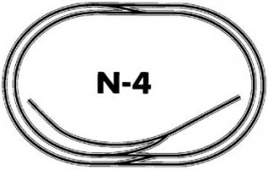

When using atlas terminal connectors to the common track, do you need another one on the other side that would feed back to the transformer. I am using the N4 atlas layout but it is not clear to me how to wire.
Secondly the N4 layout has 5 sections but it claims that it can be controlled by one selector(215) and I am not sure how this would work.

:) In the original post you mentioned the "common track." This means that one side of all the track sections or blocks is common, connected together, also called "common rail." Disregarding any voltage drop or poor connection issues with rail joiners, etc., this means that only ONE feeder is required from the common side of the Power Pack to the common side of the track. More feeds aid only with power loss issues, as decribed above by Jim and Don. Only the other side of the track requires gaps or insulated rail joiners. I think you only have about 60" of track from the transformer to any one point on the rails.
I don't see that one selector would do the trick, unless groups of isolated blocks are connected together as one. There should be some indication of how to wire this layout wherever you got it from, or it should be included in one of Atlas' wiring books. Did you ask Atlas? They are very responsive.

I don't know how you plan to run on this layout. If you plan on being able to run one train on the outside of the layout in one direction and a second train on the inside track in the opposite direction, then you will have to insulate both rails at both crossover tracks. In addition, only one rail can be the "common rail", the other three rails need to be insulated. When I mention one rail and the other three, I'm talking about the four rails on the two mainlines. The two spur tracks don't count. Also you have a trailing point and a facing point spur. If you don't fit a sceond crossover track in the bottom area of the layout in the drawing, the only way you will be able to get the locomotive behind a car to push it into the facing point turnout is to back 1/2 way around the layout.
The folk at atlas came through with an answer 4 days after my inquiry, which I consider quite good. Here is their response.
Grotto,
I believe that you discovered an error in our parts list for layout N-4. Thank you for bringing it to our attention. We will be starting to update Book #6 in the next few months and will correct the error at that time.
Since Atlas last printed Book #6, we have changed our recommendations for DCC wiring. Atlas no longer suggests having the program track a part of the layout. The [program track should not connect to any of your layout trackage and need not even be mounted on your layout bench work. Hence, you don’t need the double-insulated rail joiners that isolate Block #5. However, if you want the two sidings to be a separate block, add ONE (in the non-common rail) insulated joiner between turnouts #5 and #6 and also add a terminal joiner to the non-common rail that you isolated.
