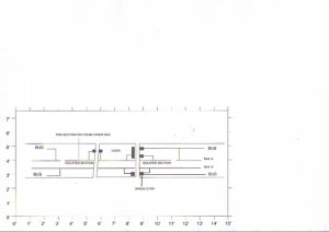

T TCH New Member Apr 30, 2007 97 0 rosebud,victoria,australia Dec 9, 2007 #4 wiring diagram Attachments Untitled.jpg 69.6 KB · Views: 37

B b28_82 New Member Jan 25, 2004 419 0 Midwest City, OK www.geocities.com Dec 11, 2007 #8 I love the contacts idea!!! Its a simple way to drop the power when the door is open instead of a switch. "solid state" if you will.
T TCH New Member Apr 30, 2007 97 0 rosebud,victoria,australia Dec 12, 2007 #9 thanks b28 82 I must admit I like to do things as simply as possible. doesn`t always work out but this one did.
