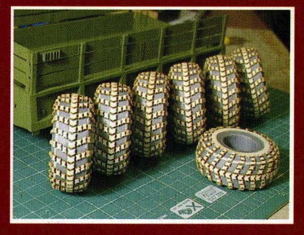

Not the cheapest tool in the arsenal..but they do offer a package deal, that was what my wife gave me this last Christmas. At first I was skeptical, having looked into laser cutters and every type of cutter out there ( was real tired of cutting repetitive parts like tank tracks!) There are some great products with blades on the market that will cut up to 2mm board as small as a tank tread, not to mention the laser cutters available..but the cost is very high..and unless your going to turn it into a business I could not see the expense, then there is the problem of converting whatever you need to a cut file since you will not have access to the original vector in most cases ( there are though a LOT of times that the PDF can be opened in lets say Inkscape ((Free)) and converted to a usable format but that is a topic for another thread!) The cameo I kinda ignored as it had a sticky mat that you use to hold your paper, and I did not like the idea, since I live in the desert and dust is always everywhere!
So I first used it to cut some stuff for the wife, figuring she would get more use out of it then I would, but as I worked with it and learned more, and how to tweak things I tried it on my Scammell Pioneer SV2S tire treads, and it did GREAT took some doing, but saved a lot of work.

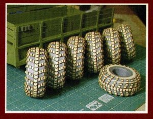

So I decided to see how far I could push it in that direction..if you have seen Renova's Kraz 255b it has some crazy tread pattern! I could never see cutting it all out by hand and having to repeat it 7 times out of 1 mm stock!! Ackkkk!!

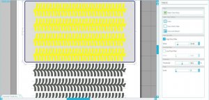

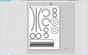

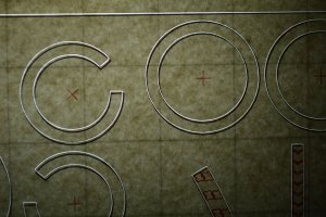

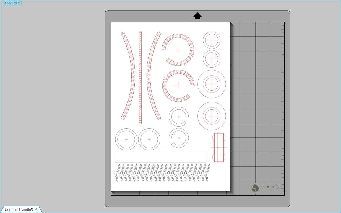

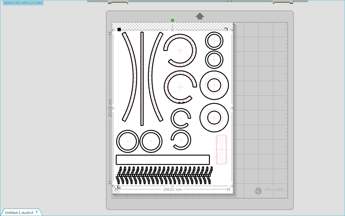

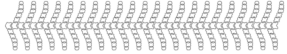

so I created a Cameo file for it..
black is for the cut lines and red is just for placement...
Marks in the corners are registration marks..

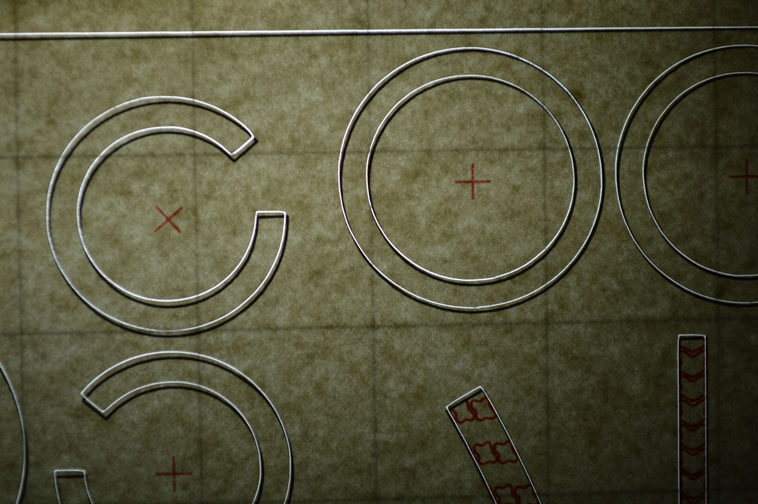

Crossing my fingers...sent to the Cameo...
View of the finished cut held up to desk lamp...some of the pieces got moved out of alignment so they look messed up but all in all I am happy as can be!!
You can see that the cut does not line up with the print..but that was my fault, and a fault with my cheap printer and can be corrected easily! I will keep working on things and perhaps up-grade as the next level of software loads SVG files directly and uses layers...also I have been working on sending the file directly from Inkscape! Will keep all informed! If it will do 1mm bolt heads I will be ecstatic!!
The Cameo will line up exactly. I just found having to do the outside profile lines all over again tedious. I would be interested into what you find that I can directly import and use. I have had my machine 2 years, used it three times, and go really frustrated with it, as the first one was a dud, and they did not recognize that, though I did, before finally sending me a new one.

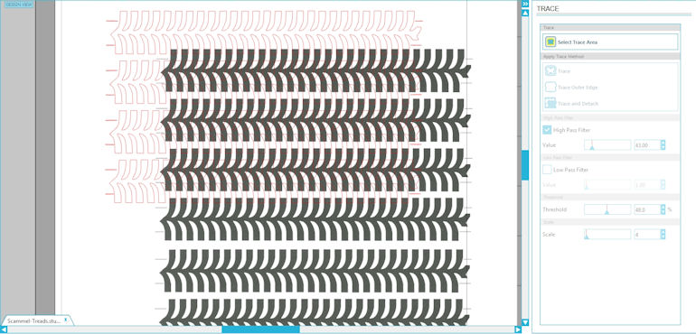

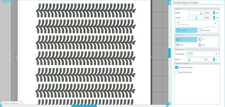

Several things... and I am speaking to all now...If you do your own design, and save from your software as DFX then you have to do nothing to get things to line up, as it will use that data as cut line! The problem is when most people expect it to import a raster image and get the same quality...I have Version 3 of Silhouette software ( also the free version) and it will import .dxf .png .bmp .jpg .jpeg .tif .tiff and .gsd which I am not familiar with...I know the upgrade 45+- $ will do some other things as well as import .svg. I have loaded pdf's into inkscape moved deleted etc and saved off to dxf, and it works great! Just wish inkscape would load more than 1 page of the pdf at a time! The trace function takes some getting used to!
As you know, raster images are all jagged on the edge, and the trace follows what-ever it wants along that edge. Those that wish to color their models will need to use vector images and it will work great..personally I prefer black and white and I'll color on my own!

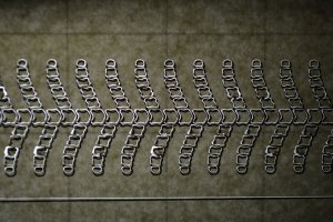

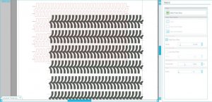

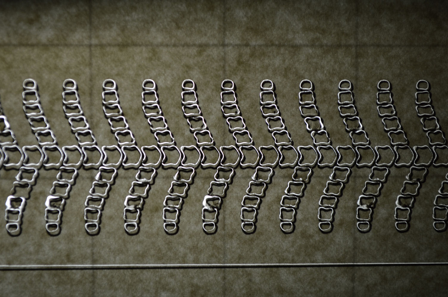

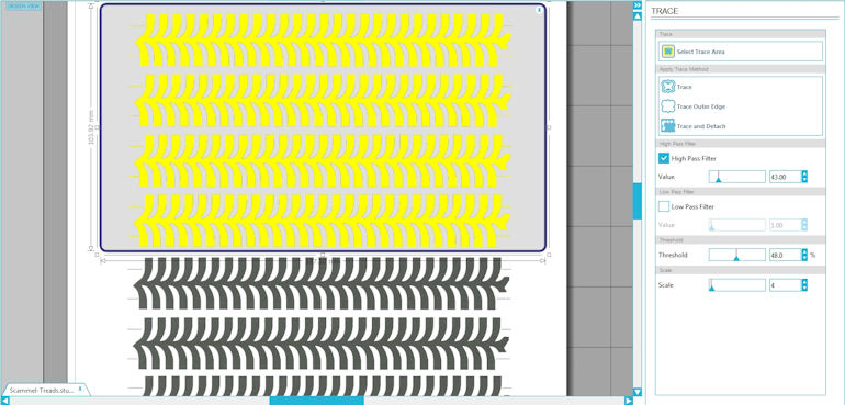

I did have to scan the treads to my Scammel....and import to Cameo

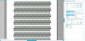

then I selected the are to use the trace function...
Then told it to trace the outer edge...( I have the scan of the treads pulled out of the way so that you can see the trace..but in reality they would overlap..then be sent to the printer with registration marks and then back to Cameo for the cut...
s-treads-trace-outer-edge.jpg so even with a raster image..it is possible to work with and get some good results! The next level of befor going for a laser cutter I looked at was this....http://knkusa.com/introducing-the-knk-maxx-air/ but could never justify the expense!

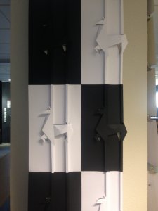

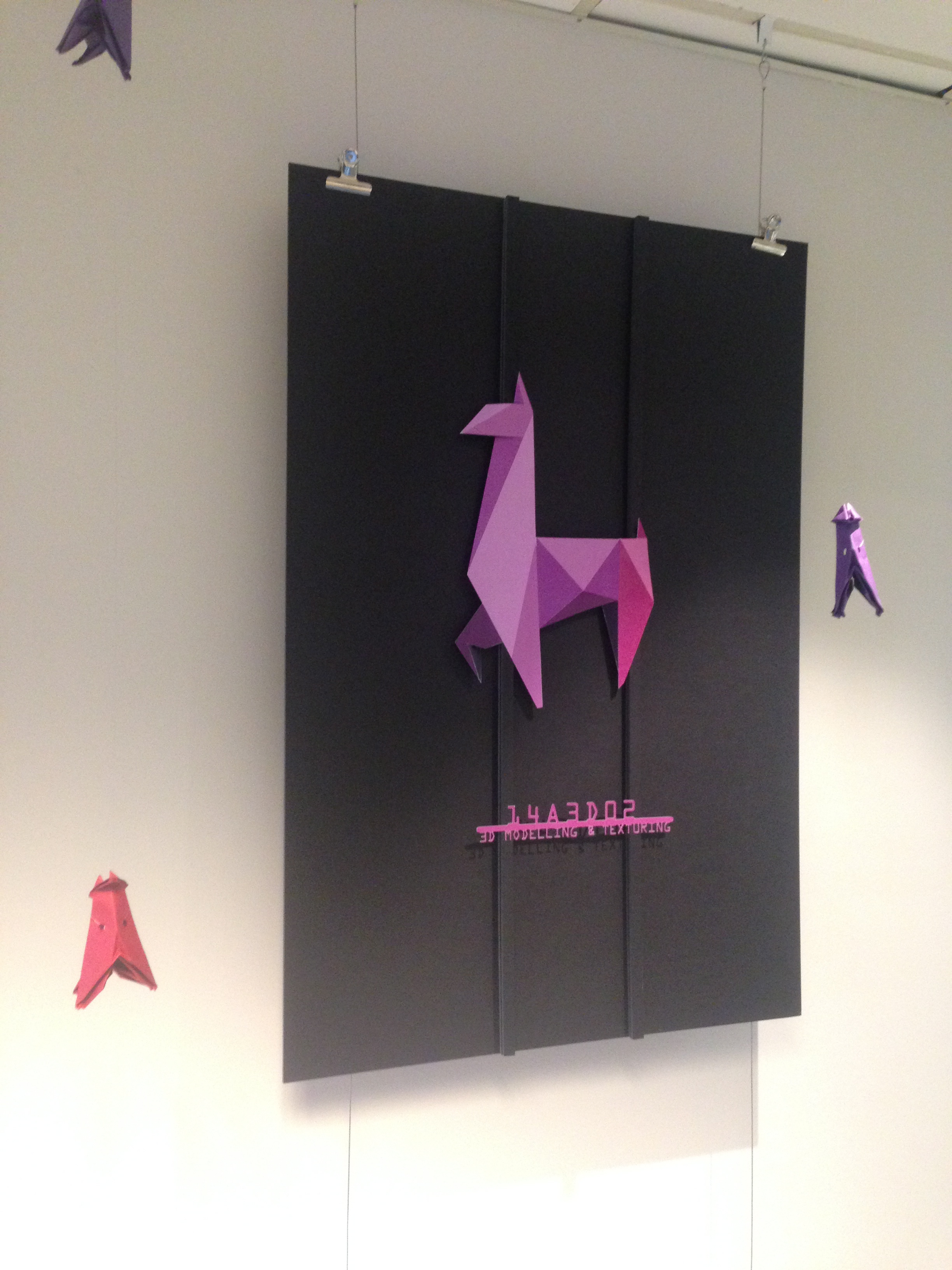

These are some completed projects that I worked on:

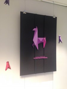

IMG_5574.jpg These were A3 sheets wrapped around a pillar. They were simple but for a 3D student exhibition at the art school that I work in.
IMG_5578.jpg These were posters and the objects were cut and folded by hand but the type was done using the machine.

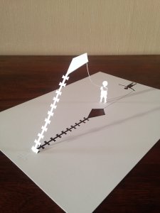

Last year I did a 100 days project where you set your own task and post it online [ http://100daysproject.co.nz/project/2014/2540 ]. Mine was making one thing out of an A4 piece of paper every day, I posted some of the earlier ones on Zealot. Here is an example of my finest ones:

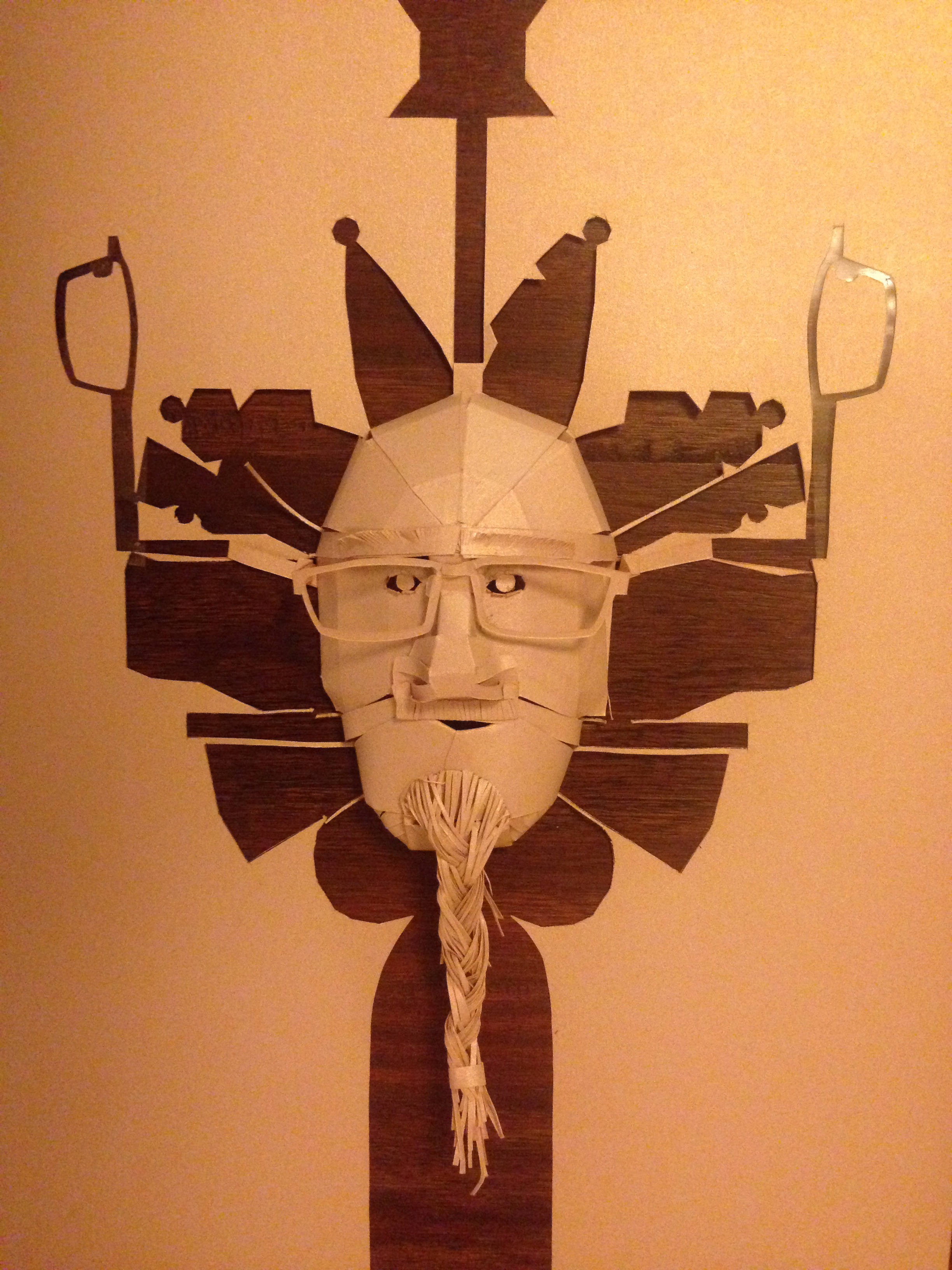

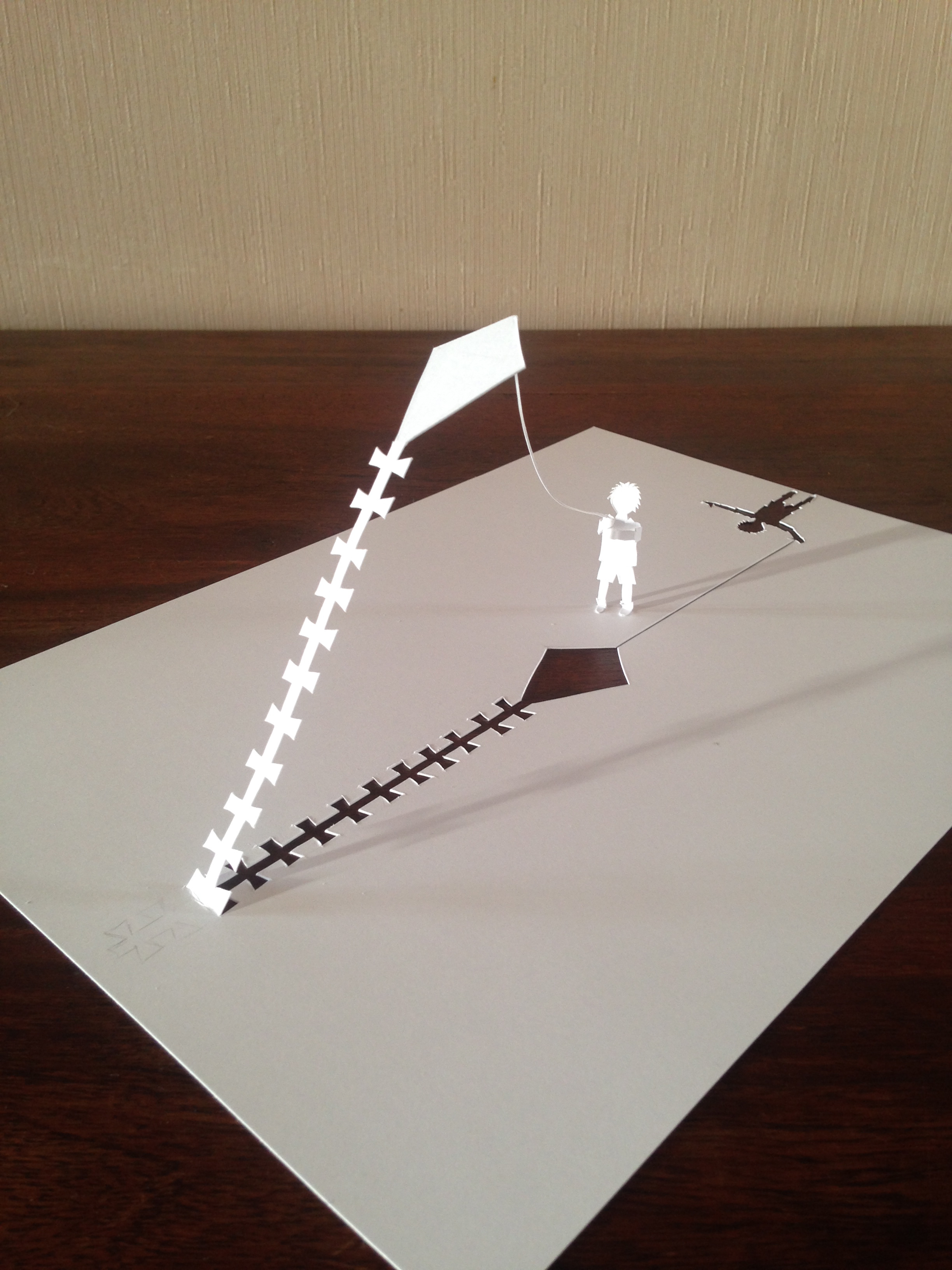

IMG_5265.jpg Kid flying a kite

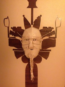

IMG_5344.jpg Self portrait. you can see a stop motion of me making it here:

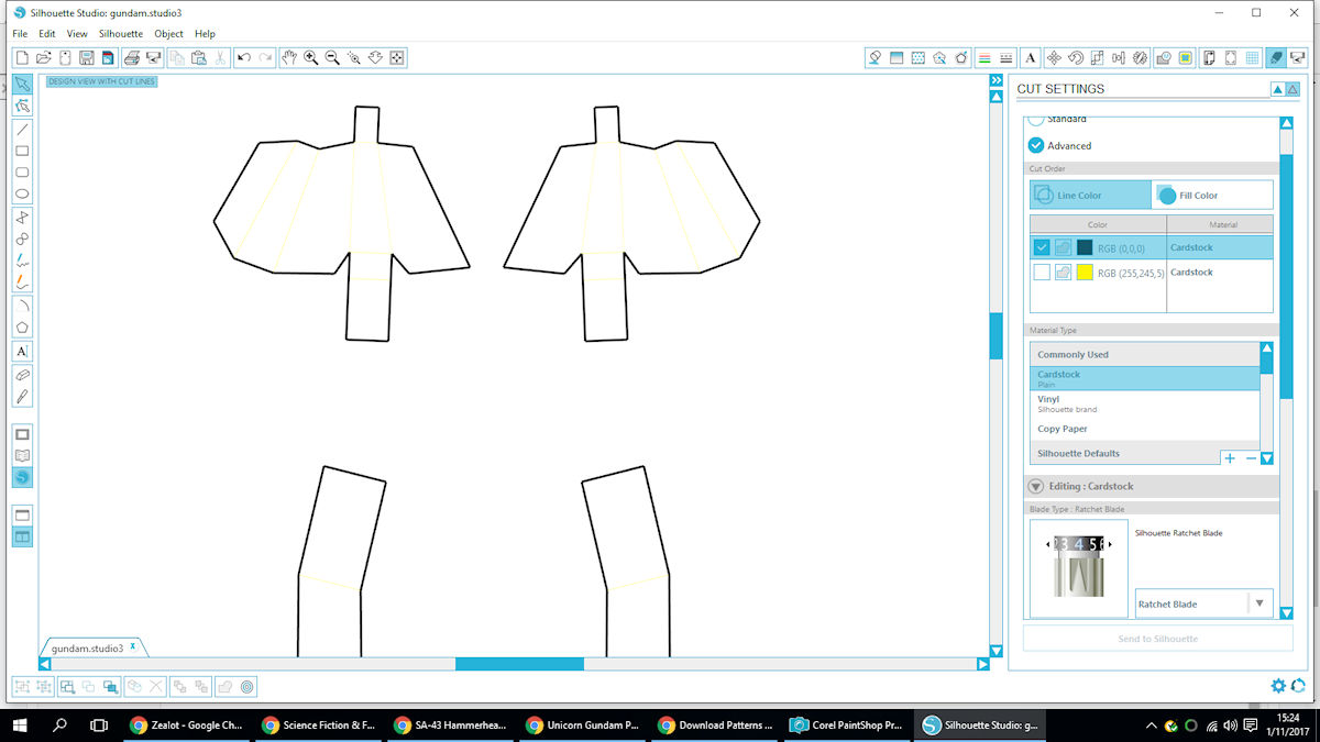

Oh boy..you had to be doing one of those..well ok... I can do it but I will NOT explain HOW I do some things..as this is a password protected file! Anyway..

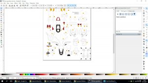

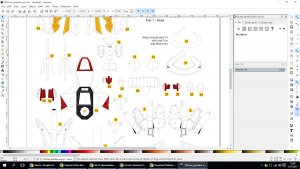

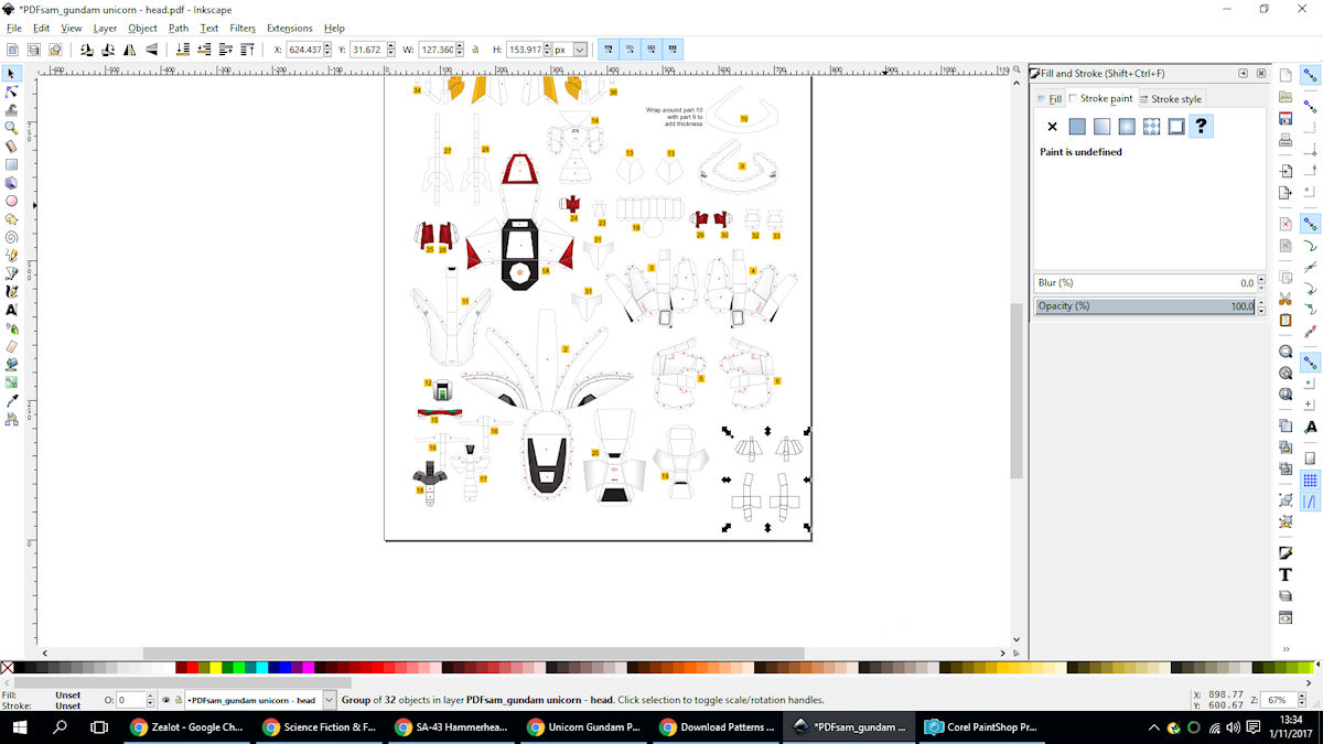

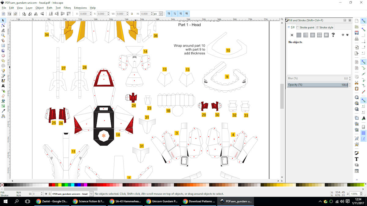

Most PDF paper models are in fact vector files saved in PDF format... not all..but at least 50/50 ..in this case I had to HACK the file...and I apologize for doing so, just to show, my point with the cameo.

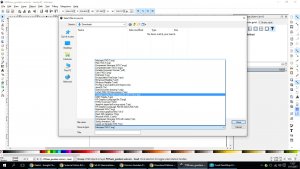

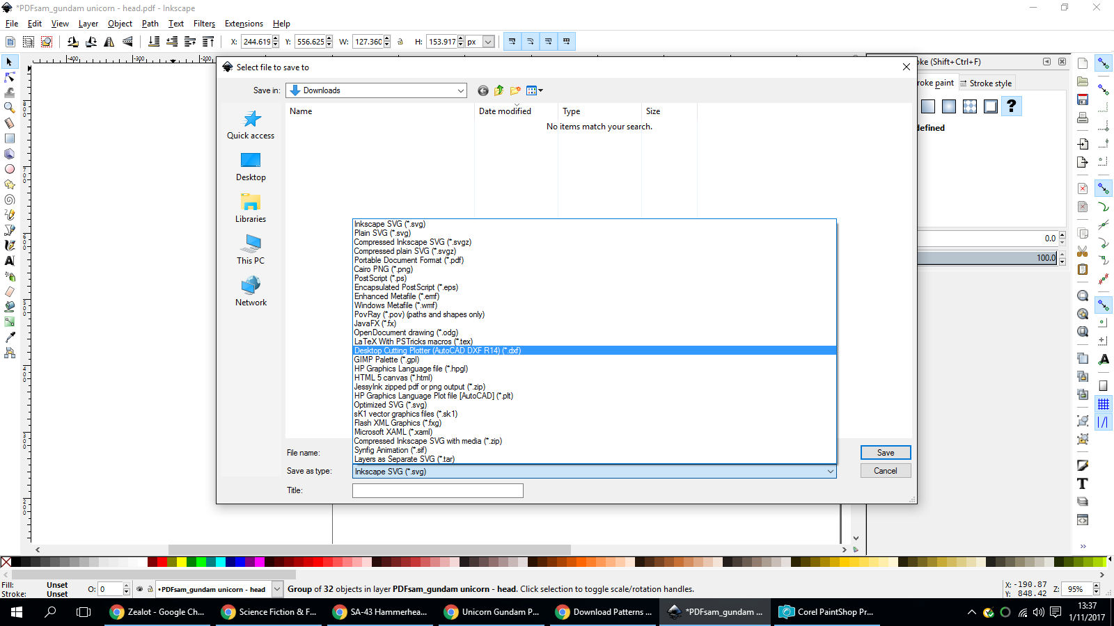

Using inkscape I have imported the PDF Unicon.
Once in inkscape..you can do what ever you want to! Re-color, reshape..what-ever...

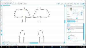

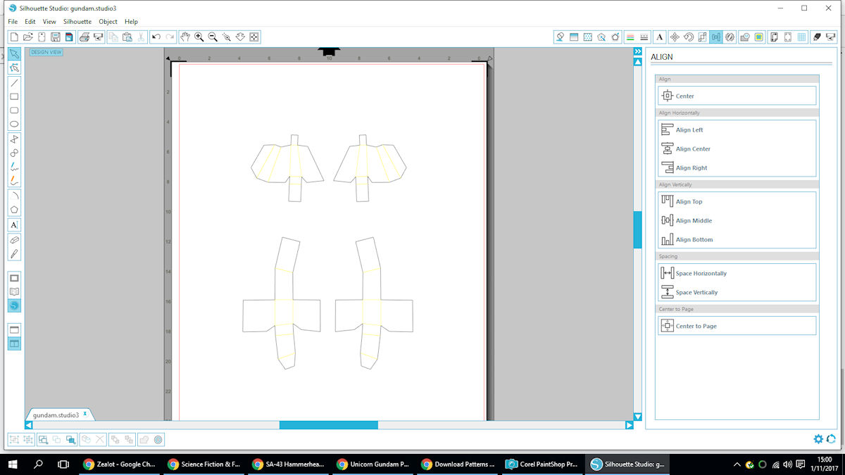

with the cameo..there are several things you have to do..1. make all outlines a single color (black for example) 2.Make all fold lines any other color (dark grey for example)
Here in inkscape I have just grabbed a small section and stripped the fill...changed the out line color to black ... in lower R corner..
then save as dfx..

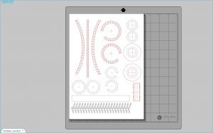

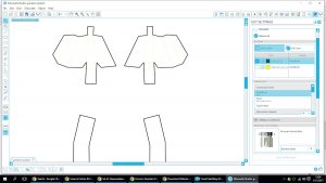

You can then import the dfx into your cameo, which I did here...note: you can do this with all the textures intact..I just took them out for clarity.

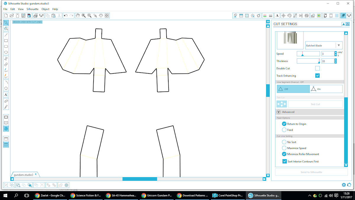

Gundam4.jpg I did enlarge this to see better... You can see the outline (black) and fold lines (yellow)..I mention this because Cameo has the function to scan a bitmap image , add registration marks, you then add your cut lines, load up in the cameo and it will register to the marks and cut out around you cutlines!
Then go to the cut settings, pick advanced and select line color, your outline color, material, and blade/speed/overcut and under advanced again...return/minimize and sort.

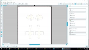

Assuming you have the card stock on the mat and loaded up...then send to cameo. Last is a view of the objects moved slightly to show the actual cut line that is around the outline.
Gundam6.jpg More to follow!:)
