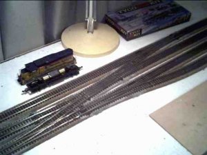

Pictured is part of the 3 track main module I am building for GATS in December. I would like to place a signal bridge in such a way as to show at a glance in either direction, whether a route is open, especially with that double slip switch. I know that LEDs are polarity sensitive and am hoping that that can factor into a cure the is easy on the budget. Any help would be greatly appreciated and would be acknowledged when entered into the NMRA Regionals in May '04.

To help, the turnouts are Peco power routing type with the exception of the Shinohara double slip switch. I'm not looking for a true-to-prototype signal set-up, just something to let the operators know that the route ahead is clear.

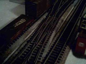

Three factors govern this particular setup, one being the audience. For the most part, the average attendee could care less for prototypical accuracy, they just want to see the trains running. Second is operation, because it is part of a show layout, operators simply want to know if the route is clear. Trains travel 'round and 'round and are swapped out for new ones as members assemble and send them out. This module leads directly into the yard throat, To what part of the yard they will be heading is based on the final setting of no less than four sets of switch points. Third and final, it is my home layout, based on a simple but effective hairpuller designed by the late John Allen. My only change was the addition of my favorite piece of trackage, the double-slip switch, found in the center of the plan.

The swithches will remain manual, the Pecos are well designed and lock into position. The Shinohara does not so some kind of mechanism, perhaps a DPDT slide switch mounted under the layout, must be provided. Maybe using the poles of the DPDT switches to route power to dwarf signals mounted near each switch point would be one idea. I do appreciate your input into this, thank you very much.

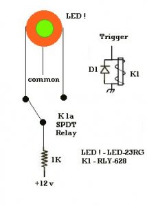

The easiest way that I see to do it is to set up block detector units on each of the lines. Then use them to switch your LEDs. They make dual color LEDs, Red if the polarity is one way, and green if it is the other way. A few el cheapo DPDT relays and you're in business. If you need them, I can whip up some simple schmatics and part #s and sources. Hope this helps.

OK, this is your basic diagram. The LED has three legs, one of which is the common cathode. The part number I gave is for an 8mm high intensity light that could be seen from a distance. The relay is your basic 12v DPDT and the other parts are a common diode and resister.
I got the part numbers from All Electronics www.allelectronics.com . I've bought from them before and have had good luck with them. Prices are good too. The LEDs run 2 for $1.00 (smaller ones are a little cheaper but I figured you wanted showy rather than proto, and the relays are $1..25.
All you need to do is supply +12v to the trigger and depending on how you want the LED set up it will switch from one color to the other.
You can use your point routes to determin if a relay gets a signal or not.
Hope this helps.
