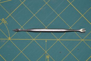

I actually have a cuticle tool for doing your nails...its old...has hexagonal grip a rounded spear oh never mind...I'll get the camera and send a pix...hang on a sec...
back... Sharp point is dull enough not to cut your cuticle (paper) and the flat end to push your cuticle works very well to flatten your folds..or in my case..after an initial fold I hold the piece against a steel edge and use that end to "sharpen" flatten the fold for a 90º angle etc... that's easier than trying to explain this thing...finding one is another matter!
